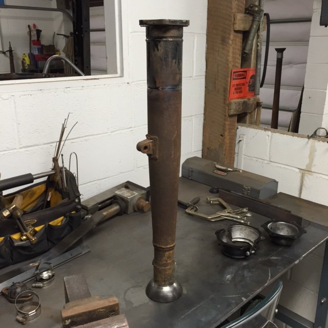

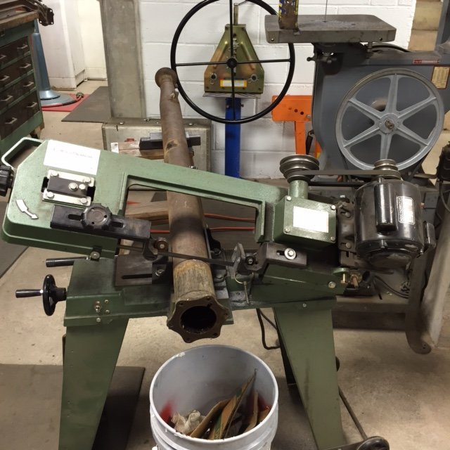

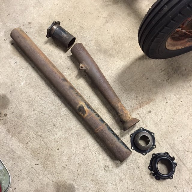

  3. So, back to the driveline. I used the '34 driveshaft that came with the rear and deliberated for a couple of days on how to shorten the '34 torque tube as it tapers most of the way down. I went up to the chicken coupe (where I currently have parts stored from the move :rolleyes:) to dig out the steering gears I knew I had. Well, I also had the TT from the '39 rear that I converted to open drive for my Chevy. The '39 tube is darn near straight the whole way down so I cheated and decided to use it!
    Some careful measuring I was ready to cut!
    36" out of the middle...
    Tacked together. Ain't it cute?

  4. Tim
    Joined: Mar 2, 2001
    Posts: 20,168
    Tim
    from KCMO
    You should use the left over 36 inches as your exhaust lol
  5. Actually I have an 'A ' TT that tapers all the way that I plan to use for that!

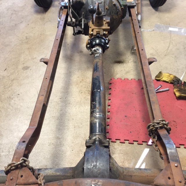

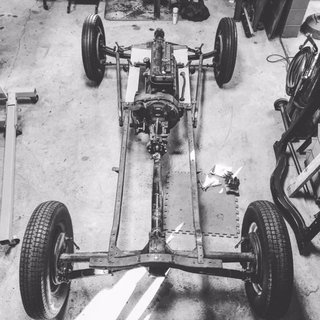

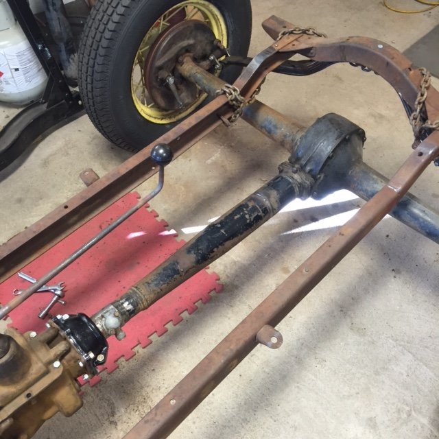

  8. Bolted up!
    Dropped in place.
    The TT is just tacked for now ( in case I screwed it up!) I will weld it up when I take everything apart to put the clutch and flywheel on.
    Next up is to figure out the radius rod placement. So many options!

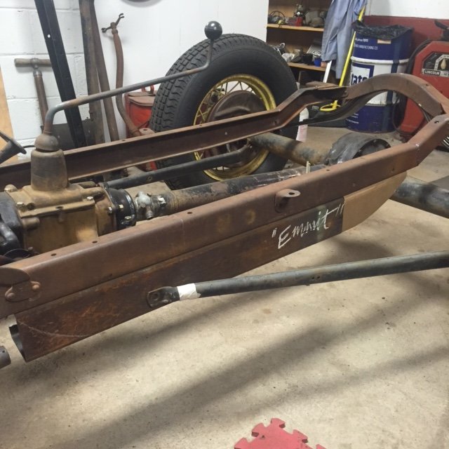

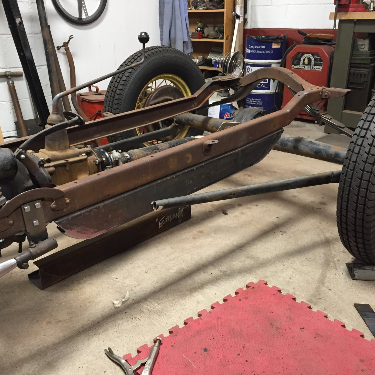

  14. Here is a mockup of a little frame rail extension I'm working on. It will catch the shortened and pie-cut radius rods and also the brake lever actuator cross shaft. The tubing is the leftover piece from which I cut the front crossmember. The RRs will simply bolt to the frame in a manner that lets them pivot. Seems strange I know but this seems to have been done on a lot of the early cars I have seen. While I don't think I would do it on a car that gets street driven regularly I think it will be fine for the occasional blast around the farmette or racetrack (or up Guanella P*** in Georgetown even!)
    It is loosely based on this fellow's car and a few others I have seen.
    Anyone have a hand fuel pump that they don't want an arm and a leg for? I plan to modify a bicycle tire pump or the like rather than spend a fortune on one.

  15. Tim
    Joined: Mar 2, 2001
    Posts: 20,168
    Tim
    from KCMO
    Dig the swoop you added to the frame extension/world's beefiest belly pan in the back. Really starts pushing the ch***is the right way :)
    cactus1 likes this.
  16. Perhaps you could use a thin sealed, or torrington type bearing between
    the radius rod and frame.
    Just throwing a thought out there
    brEad and cactus1 like this.
  17. Thanks man!
    Tim and I had discussed the use of a sleeved oilite type bearing, but the Torrington is a darn good idea! I'll have to look into that. Thanks Kelly!

    Even though there seems to be a precedent with split rear bones on the early racers, could you still fit yours up to the TT like they are supposed to be? Do you have room? I think the original racers did it because there was something in the way, but you seem to have enough room.
    On my T modified I am going to go out of my way to make sure my wishbones have room to mount to the TT. I'll design my frame around the axle instead of the other way around.

  21. I'm sure I could put it back to the TT. I think the belly pan is what made the early cars put them at the frame. I really want to try it this way but it is nothing that can't be undone. I've looked at it a lot and the pivot will be in the same relative plane as the TT union which rotates on its ball (as you well know) and does not grow in length as it goes through its motion. That is the reason I have convinced myself to try this out (though it is as I said, not something I would do on a regularly street driven car.)

  22. It was cold AF yesterday but after working on stuff in the house all weekend I needed to get out to the shop for a bit. I split another piece of tubing I had left over from a project years ago to prep for the frame extensions. image.jpeg
    I didn't take any pics during the process apparently but after cutting away the curves, heating, bending, and welding the bottoms back on here's what I ended up with.

    Lol warmer than Ben's driveway this afternoon. New piece looks good. You say you welded the bottom back, is that in reference to the curves?
  24. Thanks. Yes I cut out a pie shape but left the cuved corner of the channel. I heated that piece to match the curve I cut and welded it back together. I'll try to take pic when I do the other side. I would have left them longer but my tubing was short so I'll have to scab in a piece for the end.

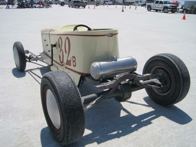

  27. I have been following your build and I am loving what you have done. I know you are going the sprint car route but as a possible alternative have you thought about a Modified? They were running them in the period that you're building too. There is period shots of midgets and big cars <.
    Stogy, bct, volvobrynk and 1 other person like this.

  29. Thanks! Yes, I'm hoping to do exactly that for floorboards and to tie the frame rails together a bit. This old T frame is spindly!
    I don't think the menu came through but tanks for that bit of history! Very cool!
    You know when I first dreamt up the project it was a three-springer. I have a Chevy cowl I had planned on narrowing and I even bought a Whippet grille and radiator. I love the early modifieds and the ones you posted are great! It is still on my mind and I'll probably keep those parts on the off chance I come up with an early parallel leaf frame. Thanks for checking in!
