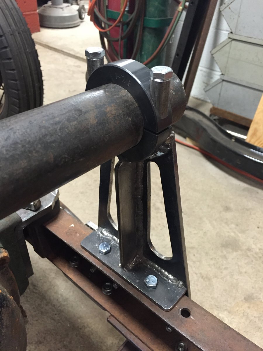

  3. Thanks man! I was really just trying to take a little visual weight out of the bracket. I hope it's not too fancy for the car??
    I hope I can find some more square headed bolts that are graded a little higher? I really like the look!
    Thank you!

    Here's the collar with the back-dated bolts. They could stand to be a little shorter. I hope to find a bunch of old hardware to replace all the new stuff for the car's first incarnation (before final paint later down the line.)

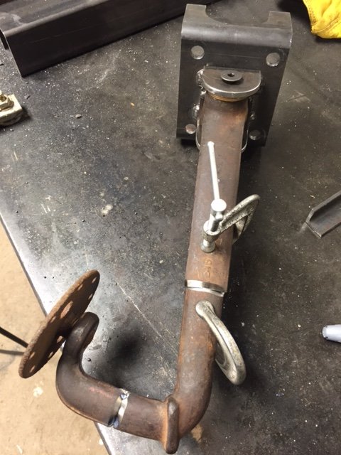

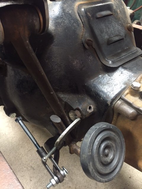

    So I spent a little time deliberating what to do with my clutch pedal. It's been a hang up for a few months now. I finally made a decision on it and started cutting and pasting. Preliminary results seem ok so I will press on!
    Pat, Stogy, flatout51 and 3 others like this.

    I stole this from instagram. Seems pretty simple enough.

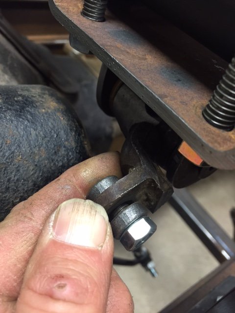

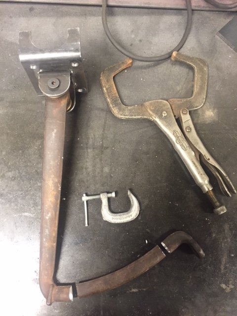

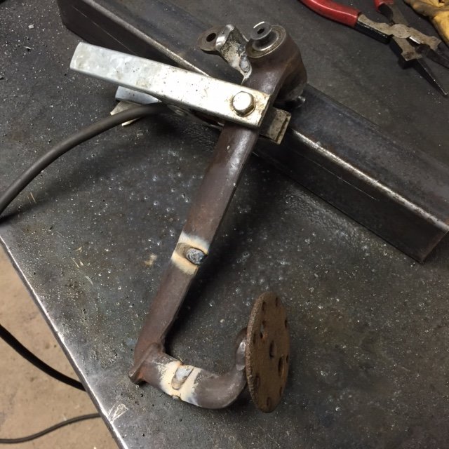

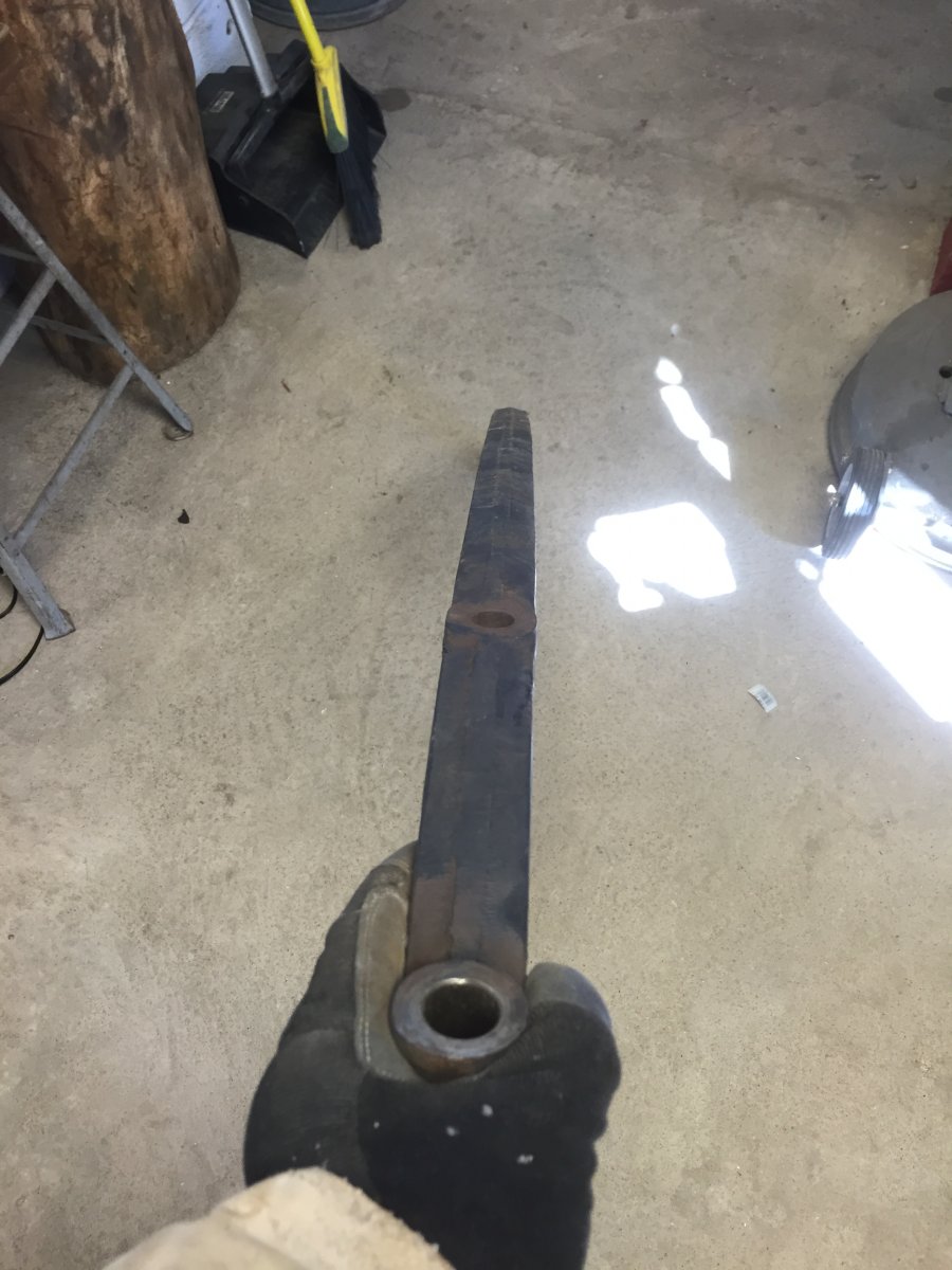

    With spring upon us I've been pretty busy around the farmette mowing, gardening, etc. but I've managed to sneak in a couple hours here and there to work on the clutch pedal/linkage.
    I sectioned this pedal arm, flipped the pedal pad mount around and stuck the tab in a different spot. I also had to plug the old zerk hole and relocate it to the front of the arm.
    I welded a couple of 5/16-24 bolts together to use with the yolks. Here are the pics...

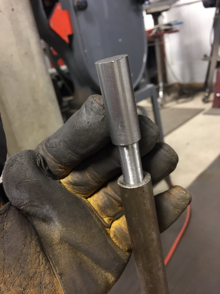

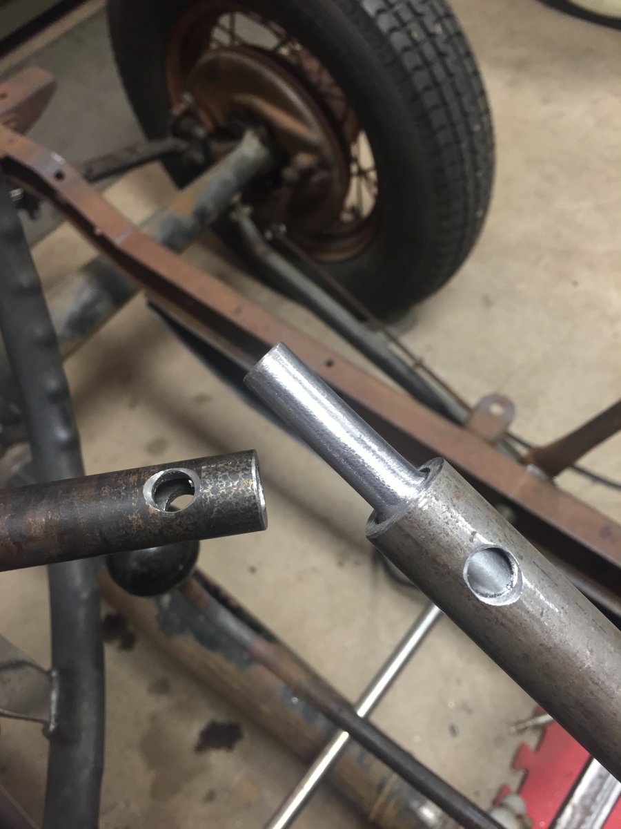

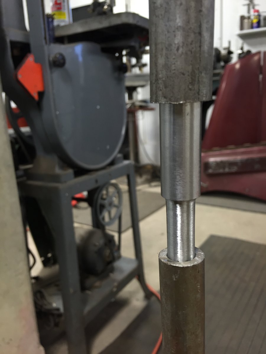

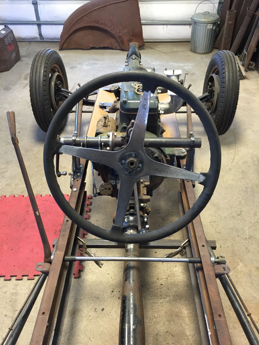

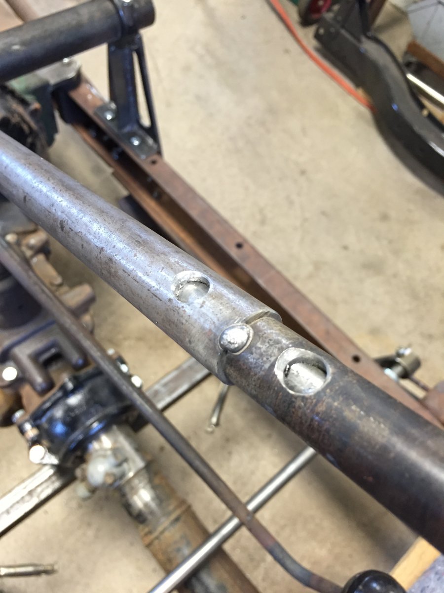

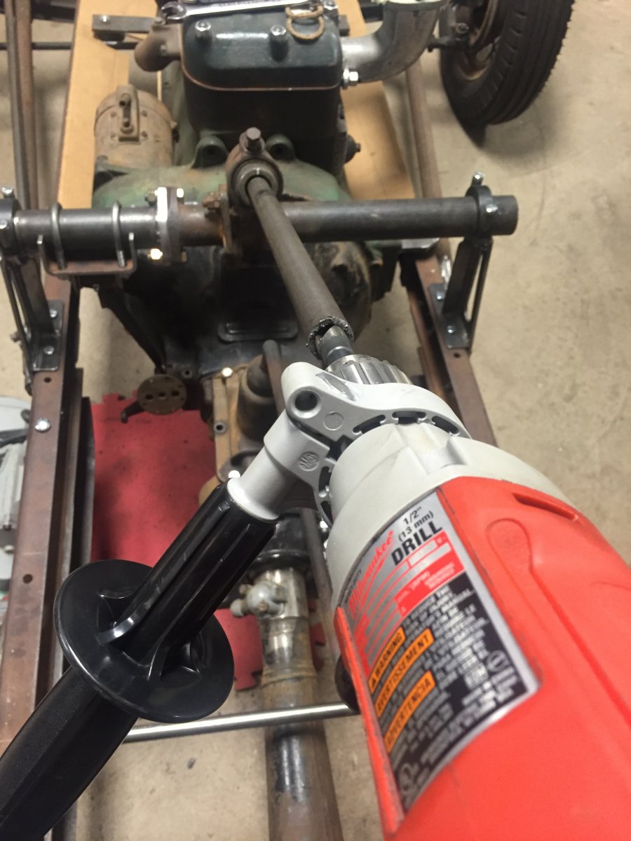

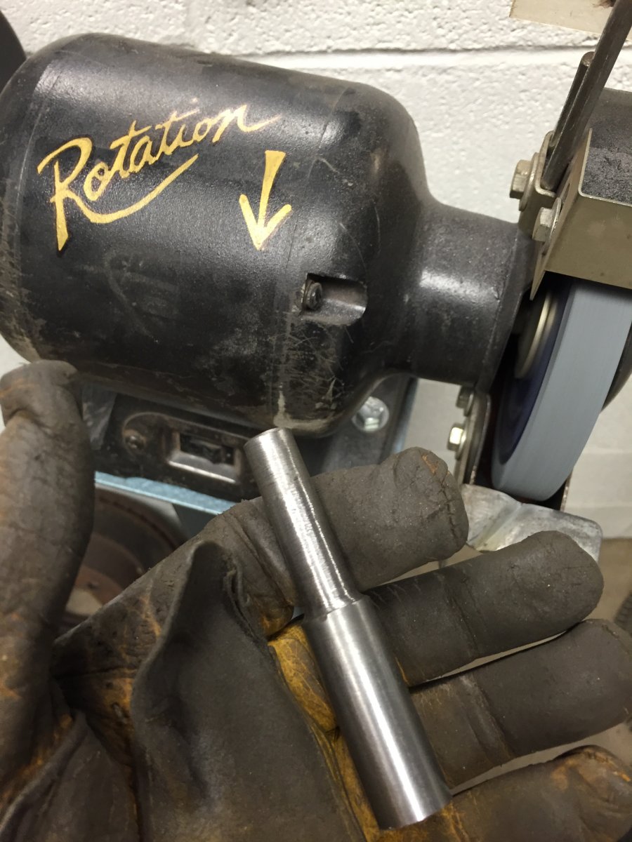

  29. I had a little time on Sunday to work on the steering. I took everything apart to change out the steering shaft for one that wasn't bent and then proceeded to shorten it and adapt it to the V8 shaft I had to utilize the adapter for the "bell" wheel.
    Back to the "abrasive lathe" to turn an adapter.
    I had to open up the shaft as it was a little smaller than 5/8" ID.
    Just tacked for now in case something needs to change. Not much of an update but it sure took me a long time to do, ha!

    My wrist HURTS looking at that drill in that shaft.... haha! Looking good my friend!
