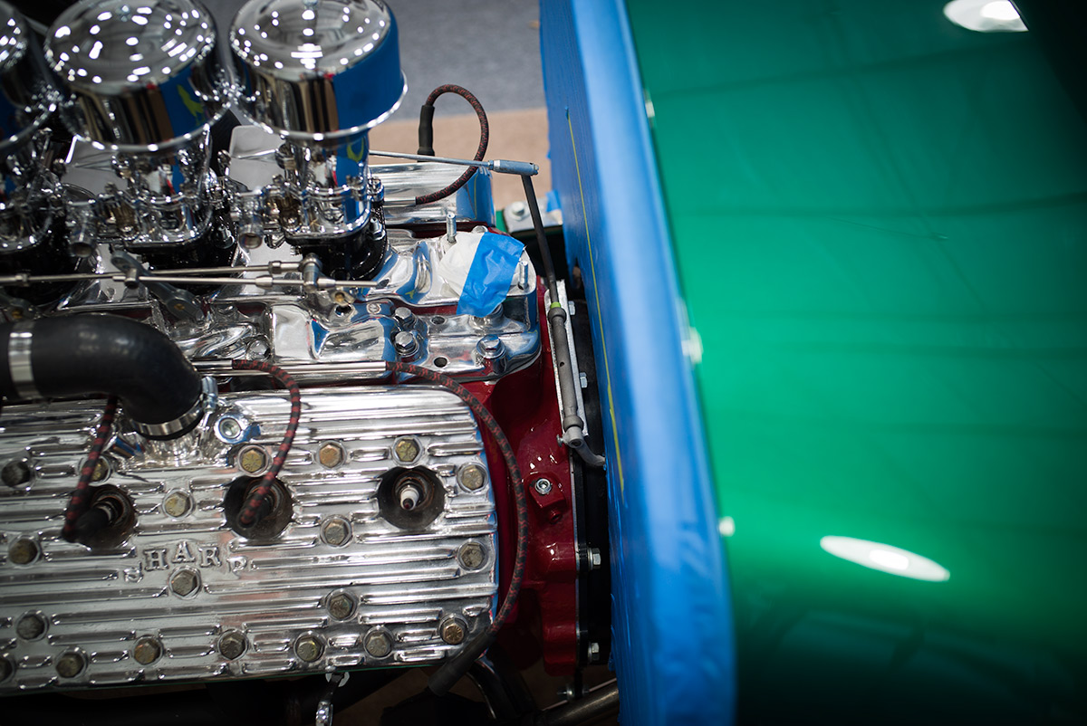

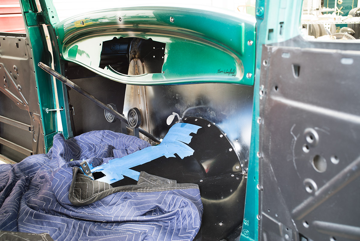

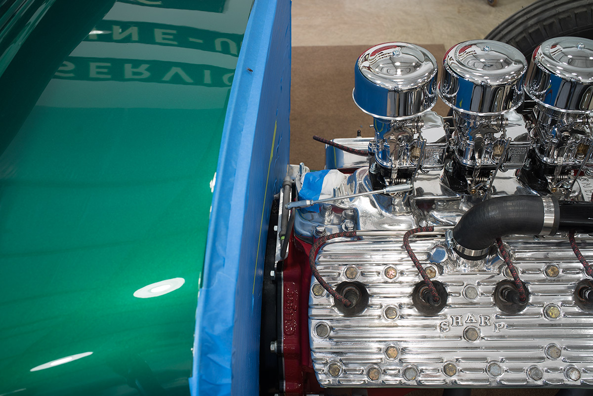

    So, I mentioned some challenges in final ***embly...
    The car had never really been in final mock up before it was torn apart for paint and chrome. So, as you might imagine, that big ole chrome firewall has been pretty intimidating. There are no provision for a throttle linkage, a fuel block, or anything else that needs to be mounted.
    The throttle linkage seemed to be the scariest project, so Keith attacked that first. The owner mentioned that he might want to someday run a Scott blower on the car too... so just a hole in the firewall wasn't going to work... It would need a "slot" of sorts and cutting into the chrome firewall would be a real risk. It could chip. It could blue. It could all go to ****.
    So, instead Keith decided to run the linkage off the bell housing - avoiding the process of cutting into the chrome all together.
    This placed the throttle pedal in a pretty comfortable position... But there are other concerns to worry about as well. For instance, the tremec ****** places the shifter pretty far reward which interferes with the big Mercury steering wheel that you will see later. And, of course, this car has a seat out of a P47 aircraft that places the driver's legs fairly high in the ****pit making ingress and regress a challenge.
    This is all going to be a very intricate dance of location.
