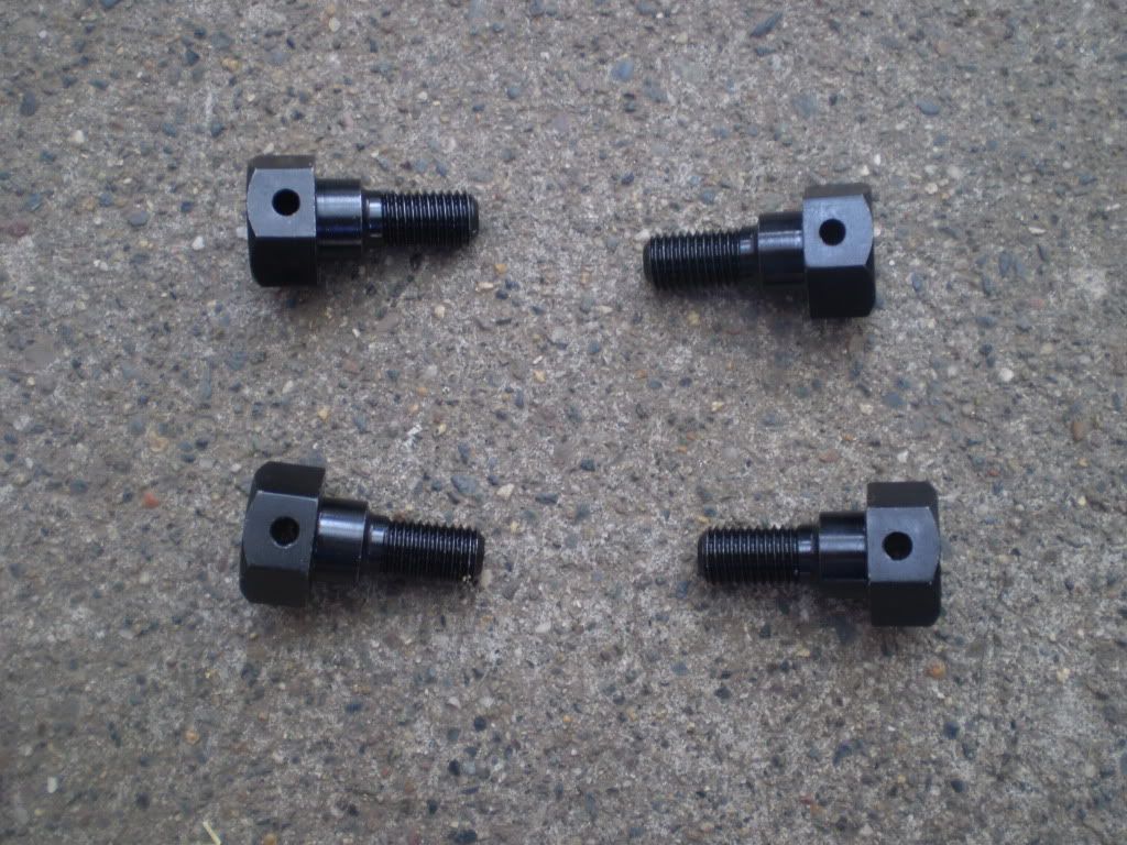

    Today I got a package from "obsolete parts" and it contained the special shouldered hood bolts for these early fords:
    Long time ago doing the body swap I had missed placed the bolts for the hood and like a dumb-*** I installed some regular old bolts in the hood instead of ordering the $12 54 ford hood bolts, which is a big NO NO and a great way to tweak a good set of hood hinges(54 ford hinges are pricey)...mine used to close perfect, but now the drivers side hinge is tweaked a little and no matter how much I adjust it cant get it to close all the way, the p***enger side still closes great, nice and flush.....Guess I learned my lesson, Oh well! I'll keep messing with it and see if I can get it to sit a little better:

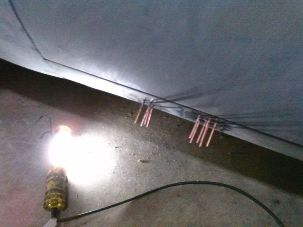

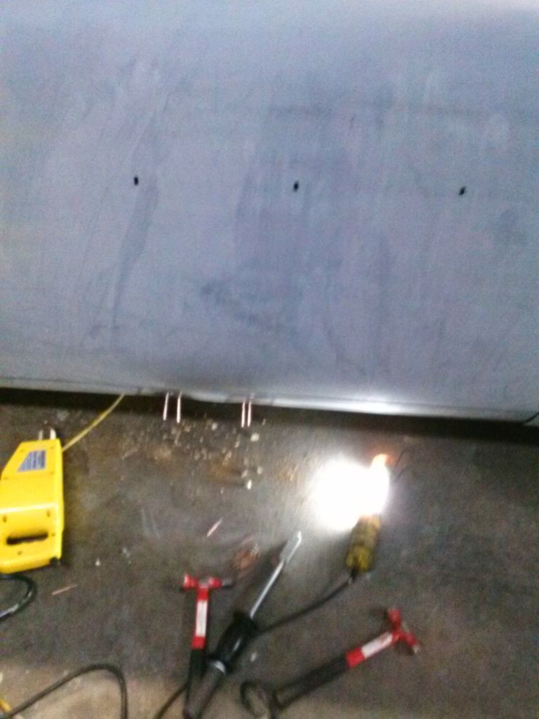

    while i used the stud gun and pulled out some dents on both the driver and p***. side rockers:

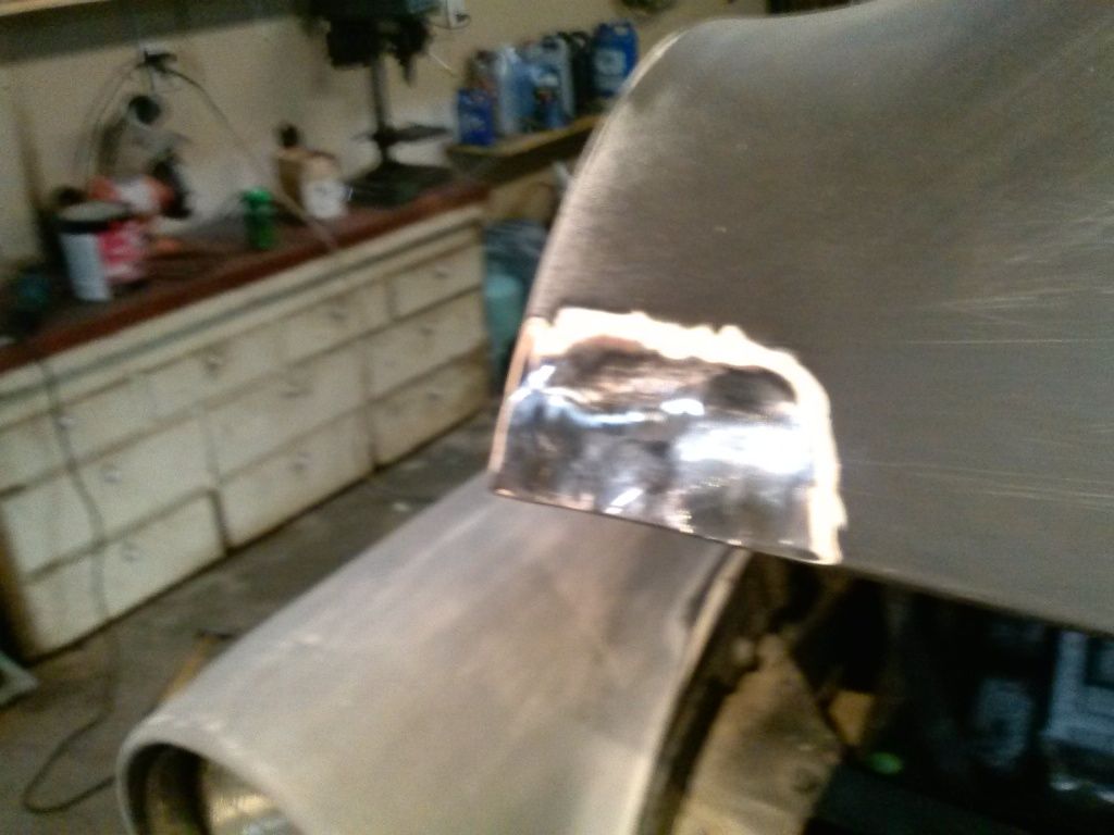

    Then i started to tackle the rust spots on the hood corners:
    cut out the bad spots and started making some patch panels:
    getting them fit:
    tacking them in, dont worry i did put on a helmet after i got them tacked:
    results! the fender patch will have to have 3/8 bondo smeared back on it to match rest of the fender but at least now it doesnt have a rusting hole:
    dont think it turned out to bad for a couple of patch panel rookies!

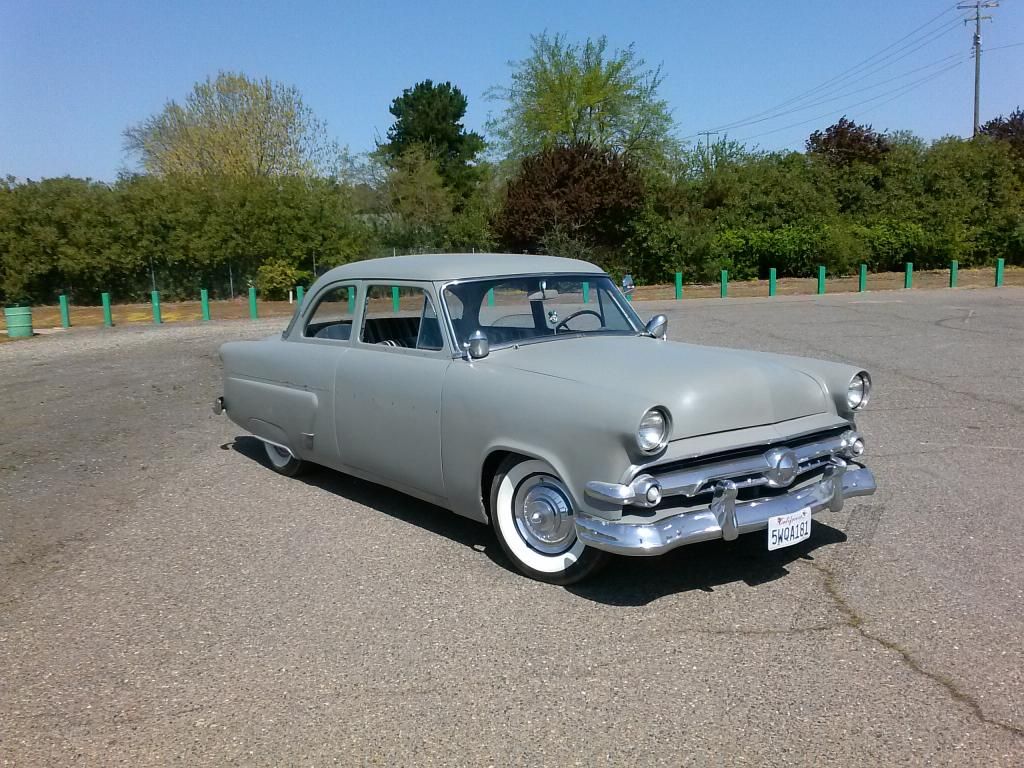

    Been doing some body work here and there still have more to do but was tired of the way the car looked and kinda embarr***ed to driving it around the way it was so I got the body looking pretty good and decided to rattle can epoxy primer it one color, Ill still touch a few things up here and there and then shoot another real coat of primer out of a gun when the time comes and then plan on paint...this is how me and my friend Richie got today...tomorrow ill finish pulling the rest of the tape and the grill and bumpers will go back on for awhile while i drive it...
