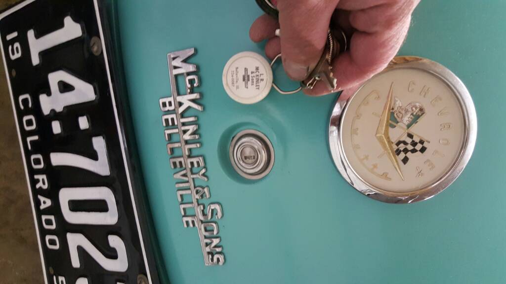

    Welcome to the HAMB
    My dad was from Belleville, I have his Corvette that was purchased at McKinley & Sons. 1459992063693.jpg

    Sadly he has p***ed, would have been 100 in 2015, but he is riding shotgun every time I drive it.[emoji41]

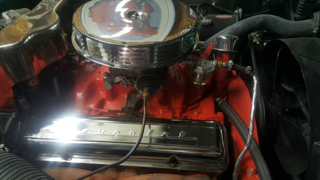

    I recently dealt with this problem. I used the non staggered script valve covers on my 305. I used an intake with the oil filler neck. I also had to have my engine builder buddy drill and tap a hole through the top of the intake for the pcv valve to vent to. He also fabricated a baffle for the underside. It's kind of a pain in the ***... So yeh.
