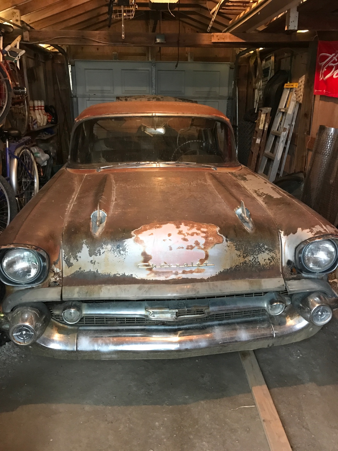

    Well, got her in my garage, if you can even call it that. Had a heluva time getting it off the trailer because the front tire was shredded. The l6 is full of oil so im going to go get a battery and see if it will turn over. Water pump is pretty rusty though so i dont have high hopes. I took a few pics of it once it was in the garage, me and 3 other guys had a hard time getting it in like i said, so once we made progress there was no time for pics. [​IMG][​IMG][​IMG][​IMG][​IMG][​IMG][​IMG][​IMG]

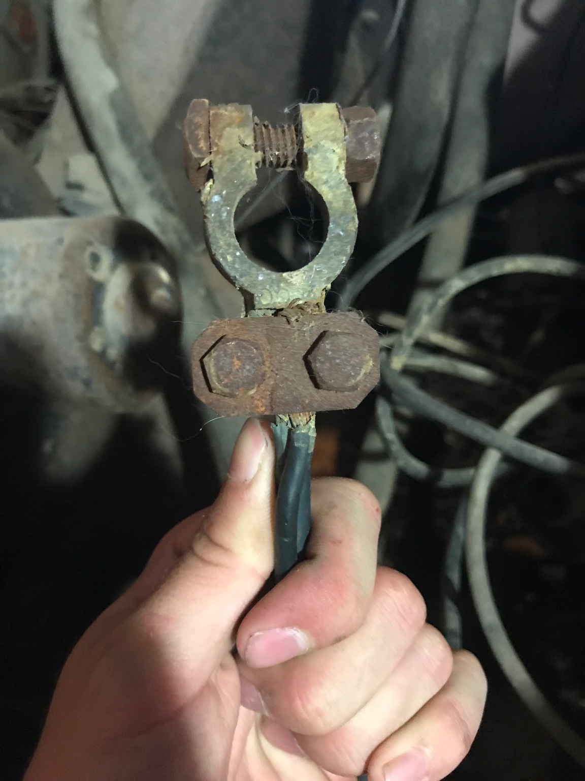

    So, i've run into my first problem. It's my understanding that tri fives are negative ground, which means the single battery cable goes on the positive, the cable running to the starter and to the core support goes to the negative? I'll attatch some pics of what i'm seeing. Thanks[​IMG][​IMG]

    Hot dog! You finally did it! Starter cable to +pos , ground cable to neg - like normal.

    Those cables are ****. Ground the battery to the block, and frame. There's other body grounds, but those are the big ones.

    first pic is ground- The second with 2 wires is pos+ notice the positive is for the bigger positive battery post/terminal

    Not sure what your question is. The cable from the starter goes positive. The cable from ground goes negative. You are going to want to replace those cables eventually but they should turn over the engine. You may have to play with them a little to get a good contact. What are you doing for fuel delivery???

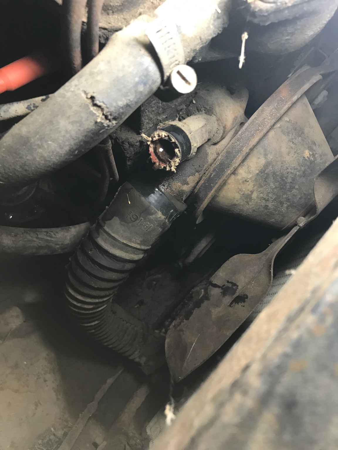

    Another question. Where does this run to? Should i run a hose to a certain place? Besides that i'm getting a spark but the carb leaks gas everywhere[​IMG]

    That looks like a heater hose port. You are going to want to remove it and plug it or you are going to have coolant everywhere.

    I looked closely at the heater and i dont think its anything heater related. There are no dangling hoses anywhere either. I wont be able to work on it for about a week anyway, so i have time for you guys to enlighten me

    Congrats on your purchase. Yes, that is a heater hose connection.
