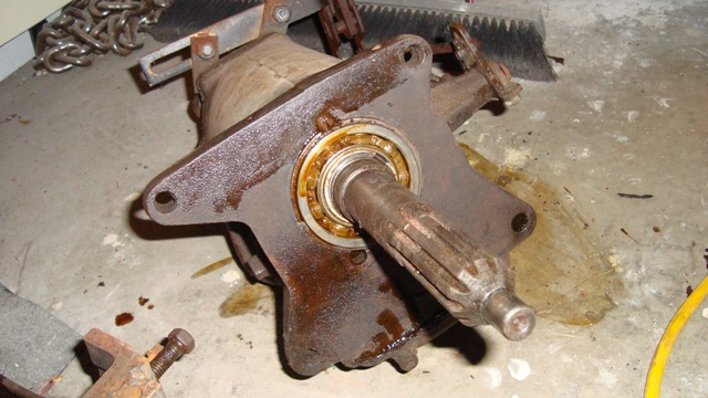

    I thought they were all gone.

    uhhhh what is it?

    Naw, ya just gotta look under a 50 Olds. Or behind a Caddy or Olds in a hot rod.

    Cadillac Lasalle.

    Very close.
    1950 Oldsmobile. Basically a Lasalle, but check out how short the tailshaft is. I've never seen a complete one for sale.

    one year trans..50 Olds. Some internals are not interchangable with the Cad LaS
    Did you get the front bearing snout?...and the "50 Olds only" rear yoke?:eek: I have yet to find a different yoke that can be used...

    Is the front bearing snout the same as the lasalles? No, I don't have the rear yoke. I guess the look is not over [​IMG]

    Same snout. The 51-up Olds Selector trans snout looks right but won't work. The 51-up Olds yoke is close...but won't work either. They had the same spline count, but the diameter is just a bit off.

    Well, I had a 37 LaS top shift trans here. I did use the 50 Olds short tail setup on it just like Paul did.
    I noticed the 2/3 synco's were different diameters Olds versus 37 LaS. So, I started test fitting to see what else. The syncro from the Olds would not fit to the front input shaft (3rd gear), and it would not fit to the 2nd gear on the top shaft, BUT, if you used all 3 of those pieces together, then the "set" would fit. You just can't use one piece.
    the clusters were the same.
    Now if you read up on hamb, the Cad used the LaS style trans to 53 or 55 about. I am thinking some of these later cad transmissions carried the same front gears, syncos as the 50 Olds. I can't say for sure because I do not have an Olds OR Cad parts book.
    One more thing. The front snout: there is no gasket between the snout and the trans face like you would have on a bolt-on snout (ford or Chev etc) Instead, there is a full face gasket on the trans-to-bell face. It needs to be thick, because the the way the snout fits into the 50 Olds bell or Cad bell. If the gasket is too thin, the trans ears will snap or bend.

    Thanks again for the info. I did not know about the gasket. Does the gasket just fit around the trans. front bearing allowing the snout to stay up in the bell? Like a large sheet with a hole just the size of the bearing

    Yes, the gasket is cut out to the OD of the snout.
    Just lay the bell down on blocks, then stand the trans into the bell, You will see a gap between the trans face and bell. The bell is bored for the snout to fit into. If the gasket is too thick, then the snout won't be pressed tight to the front of the trans.
    I am almost sure there is a gasket set repro'd...maybe read Paul's tech on the short shft conversion??? in the tech area. I know I read it somewhere on hamb.
    ...or do some measuring..to tell what gasket thickness.
