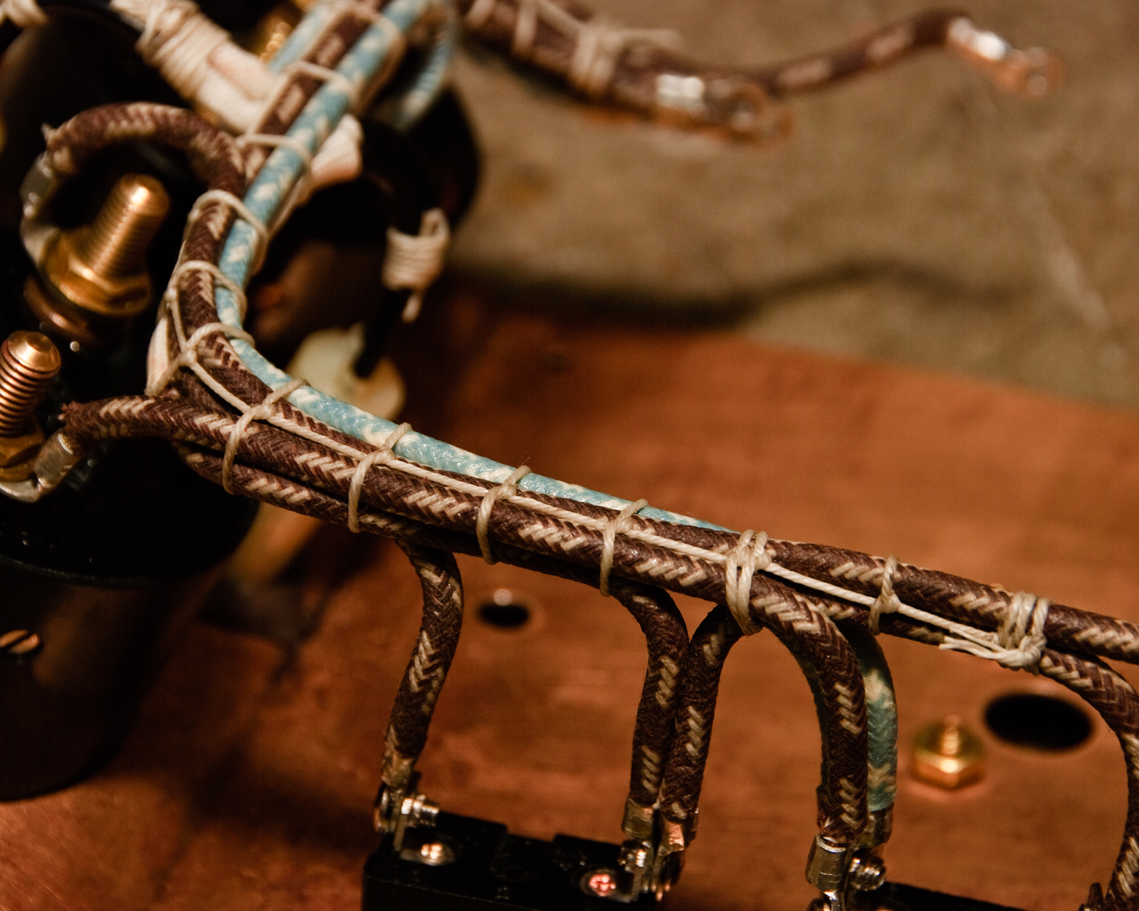

  4. So other then this looking like art .
    and with cloth wrapped wiring I could take a wiring harness done like this ito bed and have it be the little s**** .
    what are the advantages over split loom
    , correctly cut zip ties etc .?
    Why is it still used in certain applications ? A9B96A04-C762-4896-B8A9-18D972A94F8C.jpeg B6C4A7AA-6B51-4433-8DA7-864397A1B669.jpeg
    Trust me I’m not criticizing, I think this is art in a utilitarian form , it’s beautiful. But why is it still relevant as most folks ‘ain’t “ touched like us” and see beauty in this kinda stuff .

  9. This was originally used as a kind of strain relief. Race cars, boats, planes, industrial equipment, any place vibration could be present. By tying the wires together, the increased m*** of the combined wires reduced its susceptibility to certain vibration frequencies, plus where there's multiple terminals, the stress is spread out between them.
