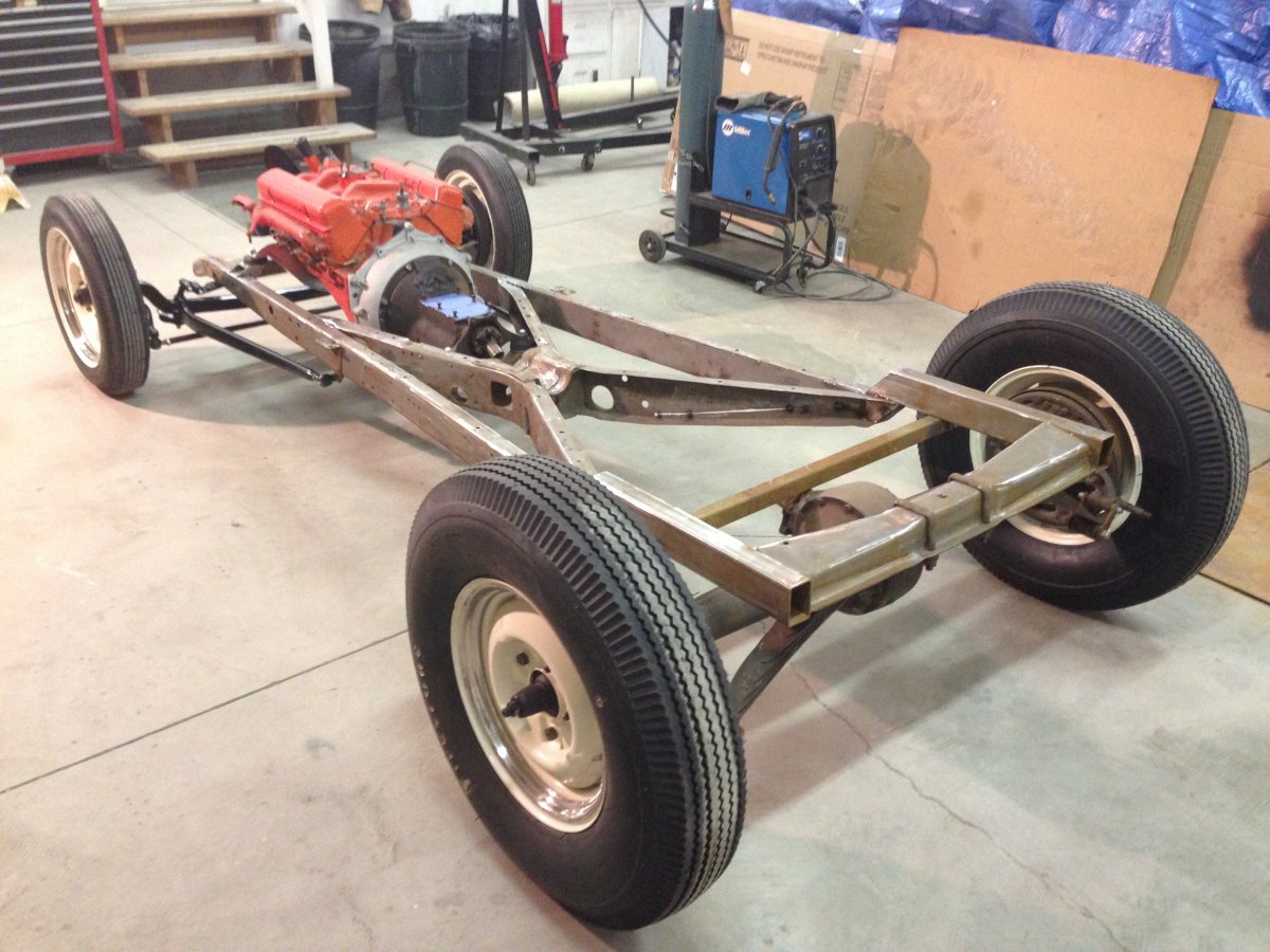

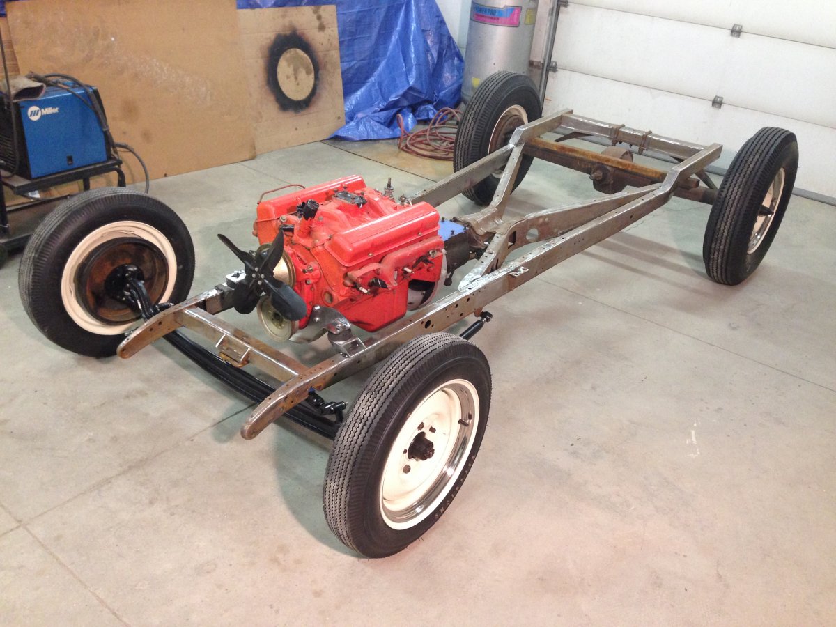

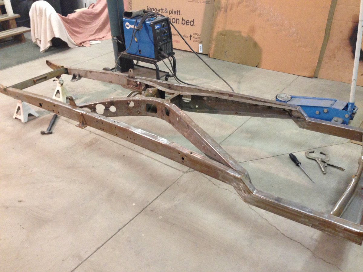

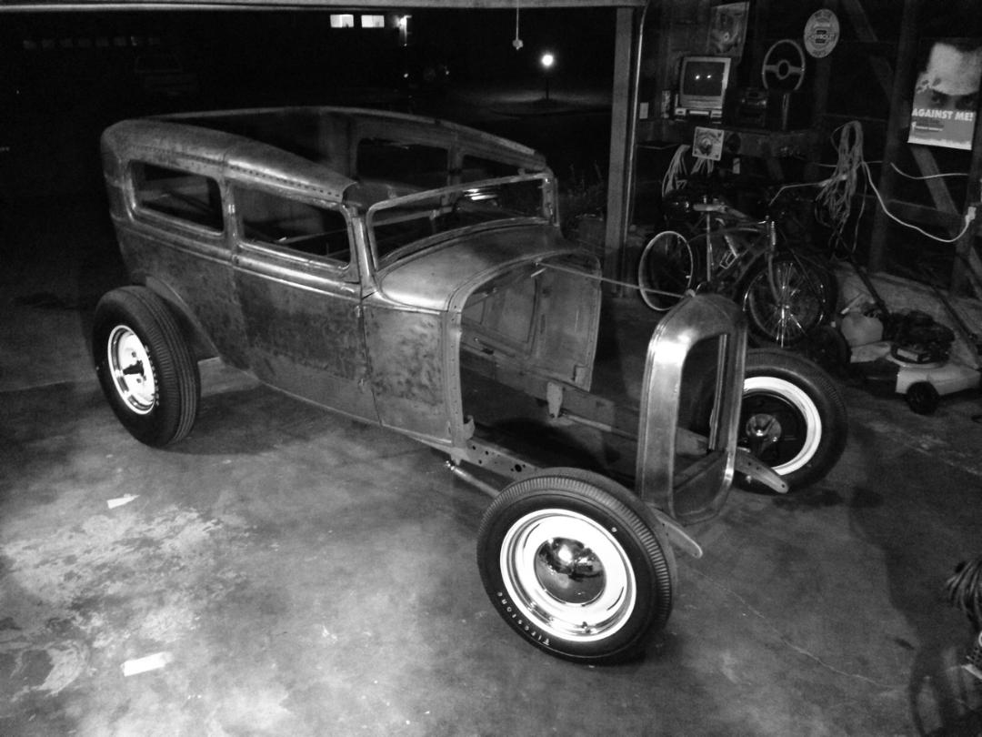

    Okay, where were we? Things have been crazy at work and I haven't had much time to work on the car, but there are a few updates. A few weeks ago my folks were kind enough to bring the chassis along with them to Omaha when they came to visit. While we were unloading, my pal Ryan stopped by with his just completed T-sedan.
    Kind of a big moment for everyone. He and I started our projects at about the same time and have been figuring out how to build hot rods together ever since. Our cars had even been resting together in the same junkyard for years. Now that it's finished it's without a doubt the baddest T-sedan on the planet. In case you missed it, here's his build thread...
    http://www.jalopyjournal.com/forum/threads/oldsboy-_t-sedan-build.549465/#post-6086581
    I got the chassis stuffed into my two car garage with two other cars already in it. Pretty tight, but at least it's here.

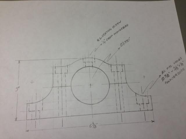

    I've been thinking more and more about a clamp to hold the F1 steering box in place above the framerail (thanks @cactus1 and @Tuck for the idea). Here's a doodle of the clamp/pillow block arrangement that will bolt to sleeved holes through the frame.
    I'm going to make it out of 1" 6061 aluminum. There will be additional bracing to the box/column to keep it from moving.

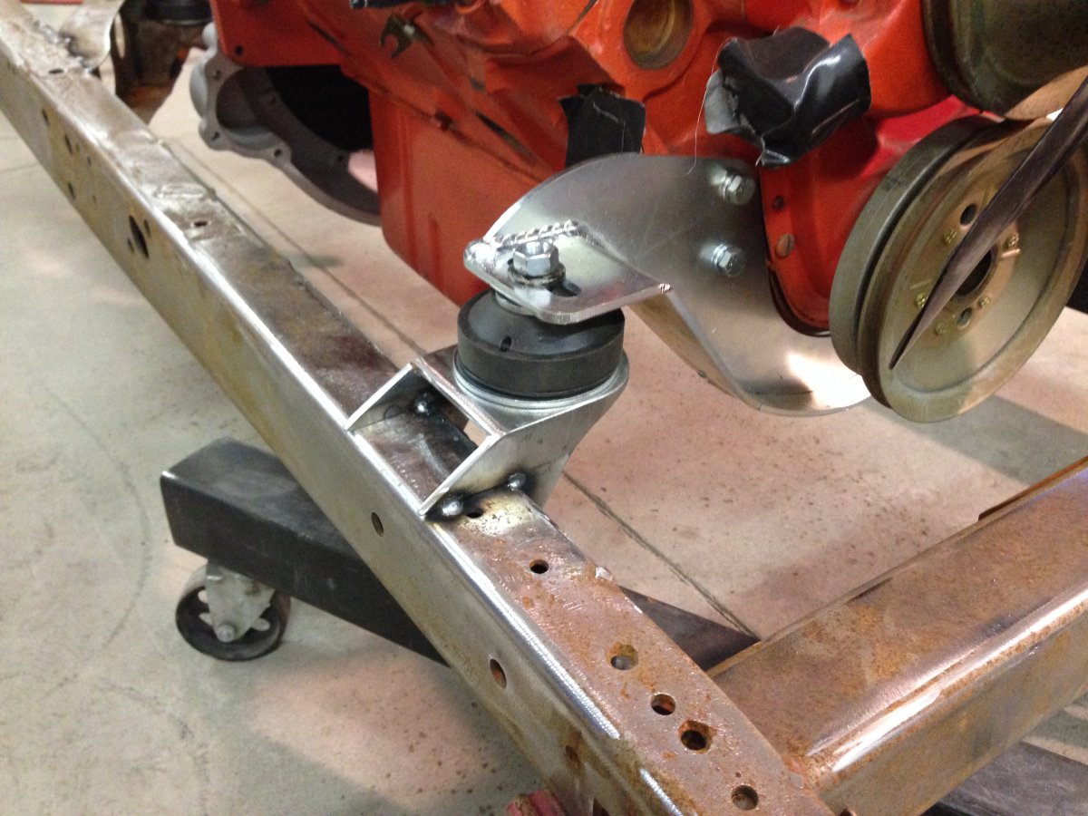

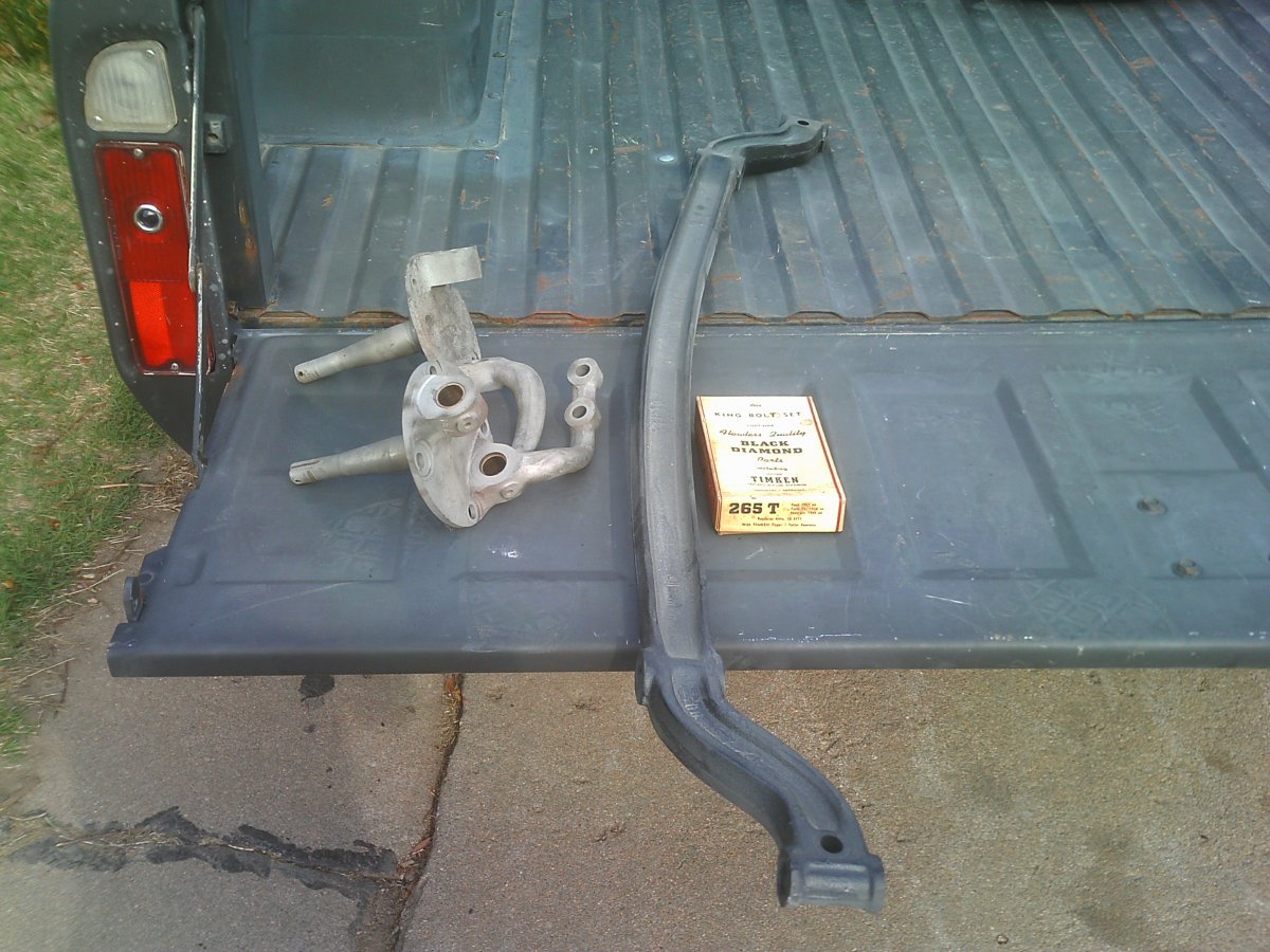

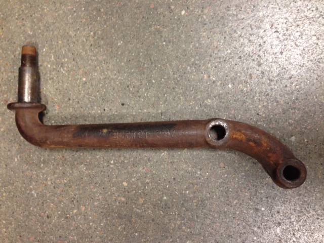

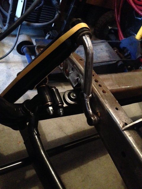

    With all the baby commotion, progress has been slow, but I have chipped away a little here and there. I picked up some So-Cal shocks and modified some F1 mounts for the front.
    Sorry for the crappy iphone shot.

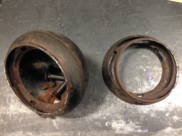

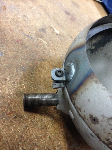

    I also got my headlights ready for paint. They're 38-ish Ford truck lights that I got for way cheap and they came with an ancient "Arrow" sealed beam conversion. The
    spring clamp/release thinger was rusty junk, so I welded tabs and a nut to the case. Now a 10-32 screw holds the ring to the housing.
    This all seems like piddly little stuff, but I can usually only work on it in 30 minute bursts, so any progress is better than no progress I guess.

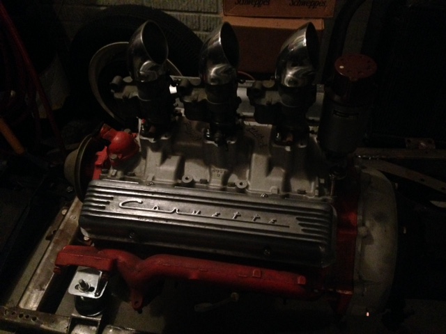

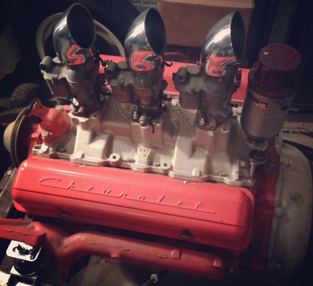

    I also finally settled on an intake. Call me un-original, but after poring over late-50's/early 60's Hot Rod mags I found that damn near everyone was running 3x2 intakes on these early Chevys. I got a good deal on an intake that has some personal history for me, so I couldn't resist.
    And my pal Ryan scored some staggered-hole 7 fin Corvette valve covers for me. I've always loved these.
    That last pic was taken way early this morning and I didn't have time to fumble around for lights. You get the idea.
    We're once again up to speed. I'll try not to stay away for so long this time as the work grinds on between bottles and diaper changes.
