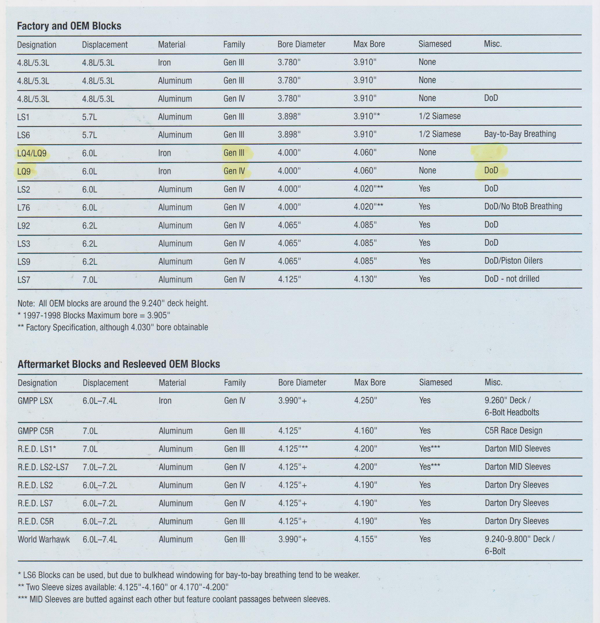

    as an image file, and cropping off the direct injection engines from the bottom...

    I am leaning towards the 6.0 truck block. The LQ4 seems to fit the bill.

    Will chime in, with the cathedral port heads (LS1, LS6, LS2, early truck) the best flowing units were the 243/799 heads. Same casting just the guts were the main difference. 243 are LS6 Z06 heads with sodium filled valves where the 799s came on 5.3 and 4.8 motors. The heads on the 6.0 motors are almost the same, the combustion chamber is a little different. Since your motor came out of a 99 Camaro, it would have the 241 heads. I guess the rough old small block comparison would be like a set of power pak heads to camel humps. Might be closer to a 1.94 vs 2.02 debate, but its been a while since I really delved into factory LS heads.
    The later LS3, LS7, and later truck blocks had rectangle port heads, I think the change kind of goes in line with the reluctor wheel or is close to the change.
    If your not worried about looks and have the hood clearance, then I would look for a truck intake manifold, they are usually dirt cheap and actually a much better flowing manifold than the stock 99 Camaro unit, they are just ugly though.
    If your looking at 6.0's then its not much of a worry, but with the 4.8 and 5.3, they use the same block and if the short block is all together the top of the piston is really the only quick visual way of telling them apart. 4.8 had flat tops and 5.3s had a dish piston.
    The only part that will kind of become dependent on the car you plan on dropping it into is the water pump. GM seems to like to have lots of options on those on where outlets are located for the car they were going into.
