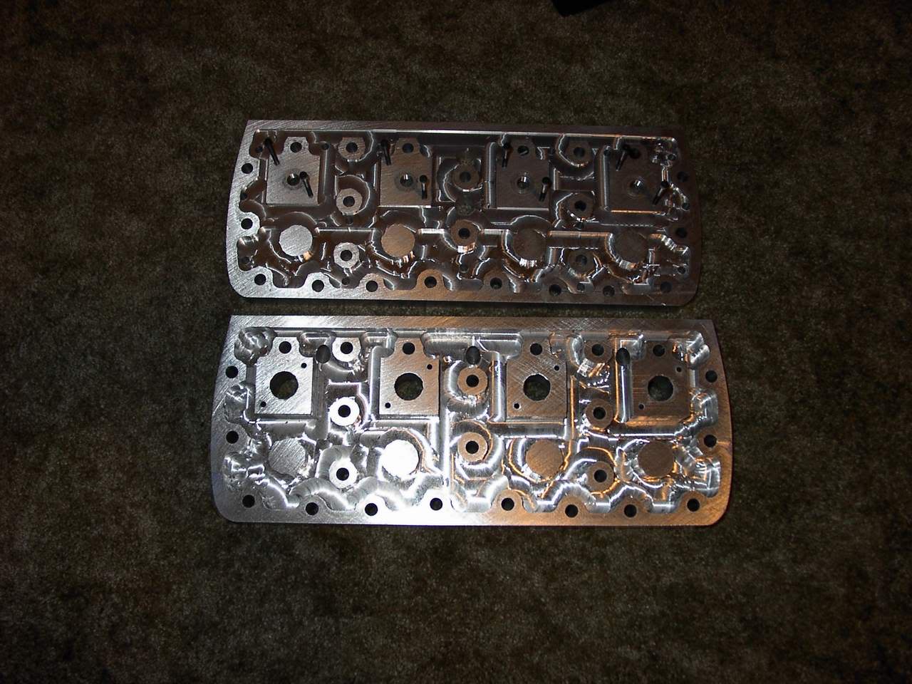

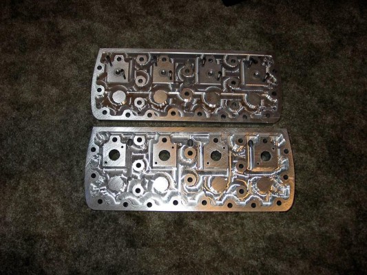

    Inside Norman Frick head. Another i stole off another Hamber which he took off the web.

    That head looks like it was machined free hand the old way, like the way I'm going to do it. It looks to be a flat head.

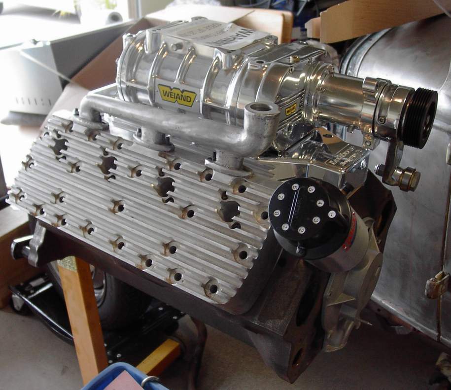

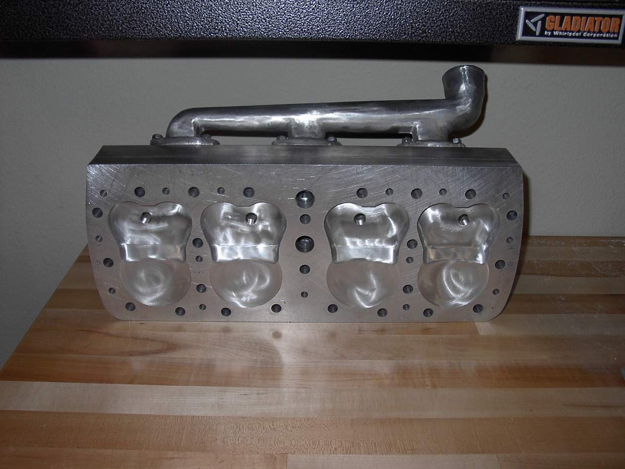

    jpm49c,
    Those Norm Frick heads and pictures are mine.
    The material is 6061 billet, and can be welded together chemically with Goodson FW-88 Fluid weld...............an 8.8 oz. bottle is about $85.00, but you can use the smaller one for half the price. It works great and is what Norm uses on all of his two piece heads.
    Here are some closeup pictures of the chambers and undercut valve reliefs in the top of the chamber.................and the motor mocked up.
    I certainly admire anyone who sets out to make his own head from scratch.
    There was guy on the old Ford Barn site that modified a Chevy V8 head to go on the B motor, the same guy I bought my cowl patch panels from.
    Good luck with the heads and keep the pictures coming................IMHO

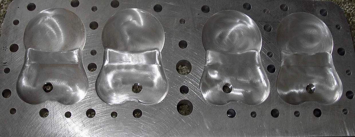

    George,
    The Norm Frick head is kind of done by hand on a old CNC....................but it gets the job done. Here is a little closer picture of my Norm Frick head.
    Can't wait to see the finished product!
