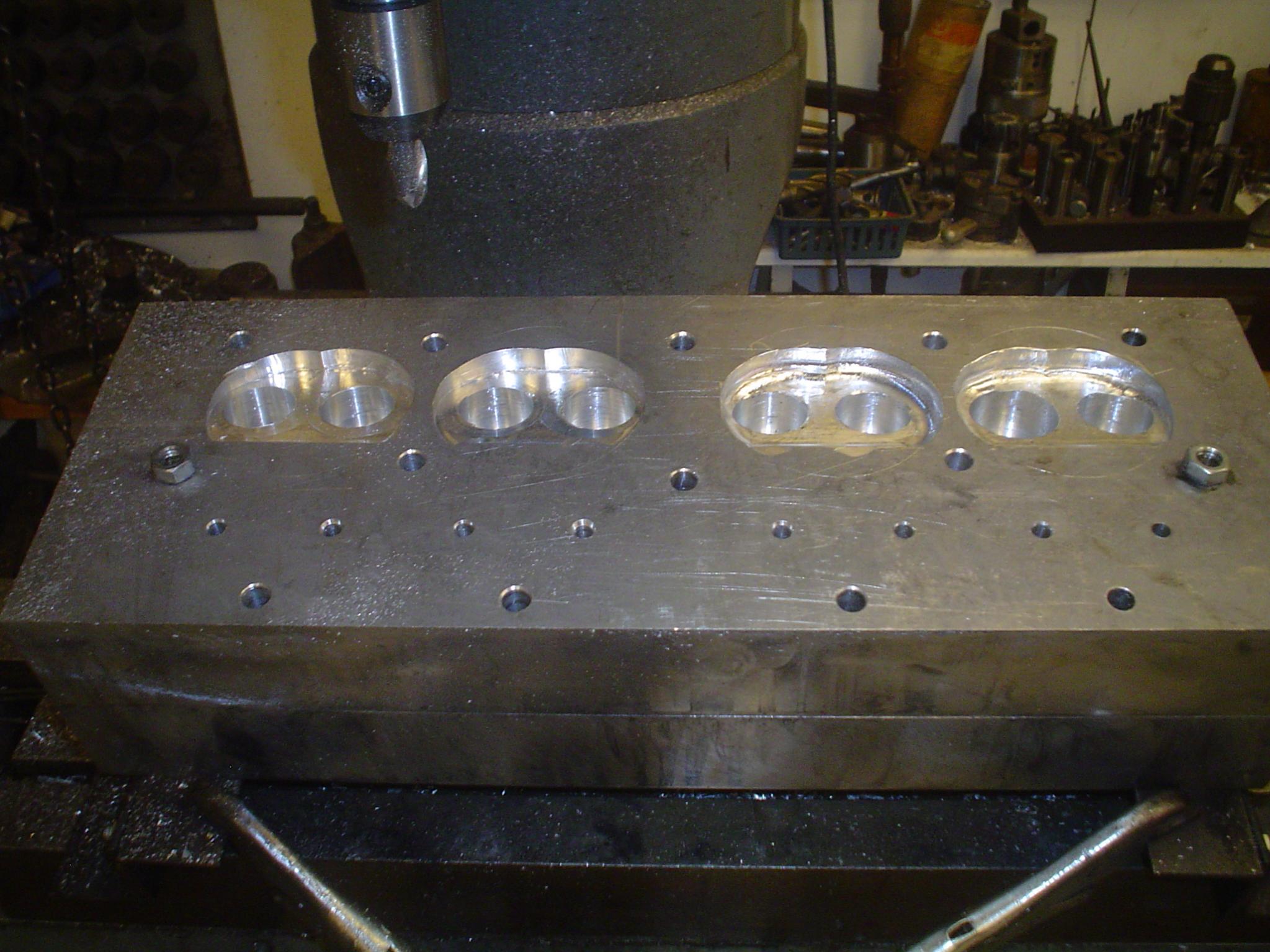

    Combustion chamber of the Frick "Ardun" banger head.
    _______________________________________________
    I guess I have been living in the dark. I never realized so many guys were making there own heads. Hang on at 73 I don't work 12 hours a day any longer.
    I should have another picture later to day.

  19. George Miller
    Joined: Dec 26, 2008
    Posts: 413
    George Miller
    from NC usa
    Drilled 150" of metal, started on combustion chambers. Next will have to cc them and see how much more I need to take out. cylinder head 001.jpg
