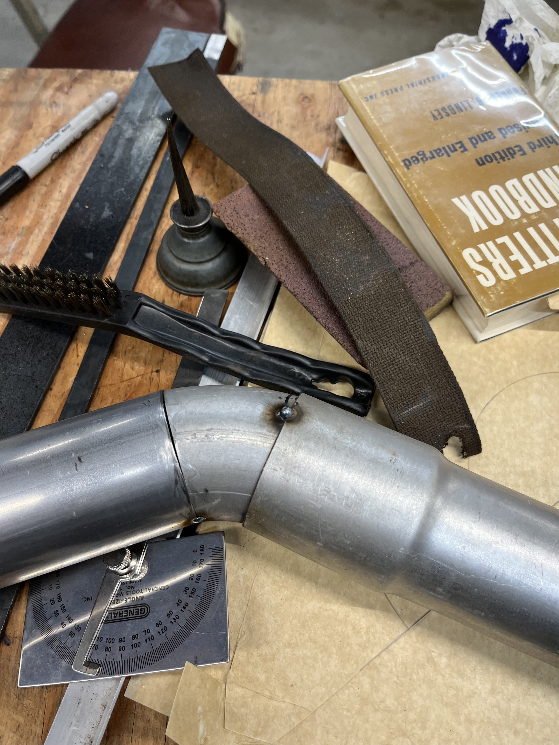

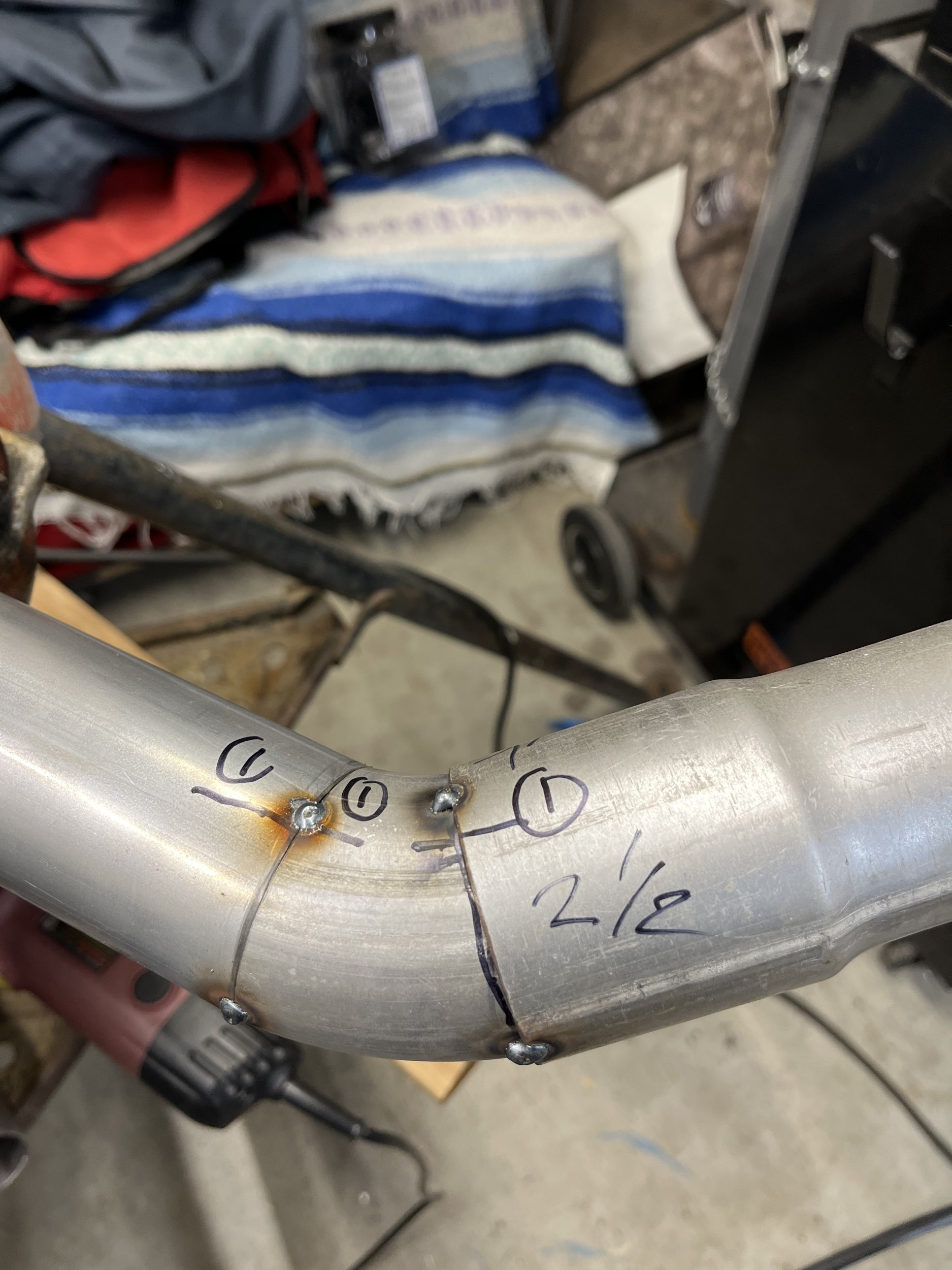

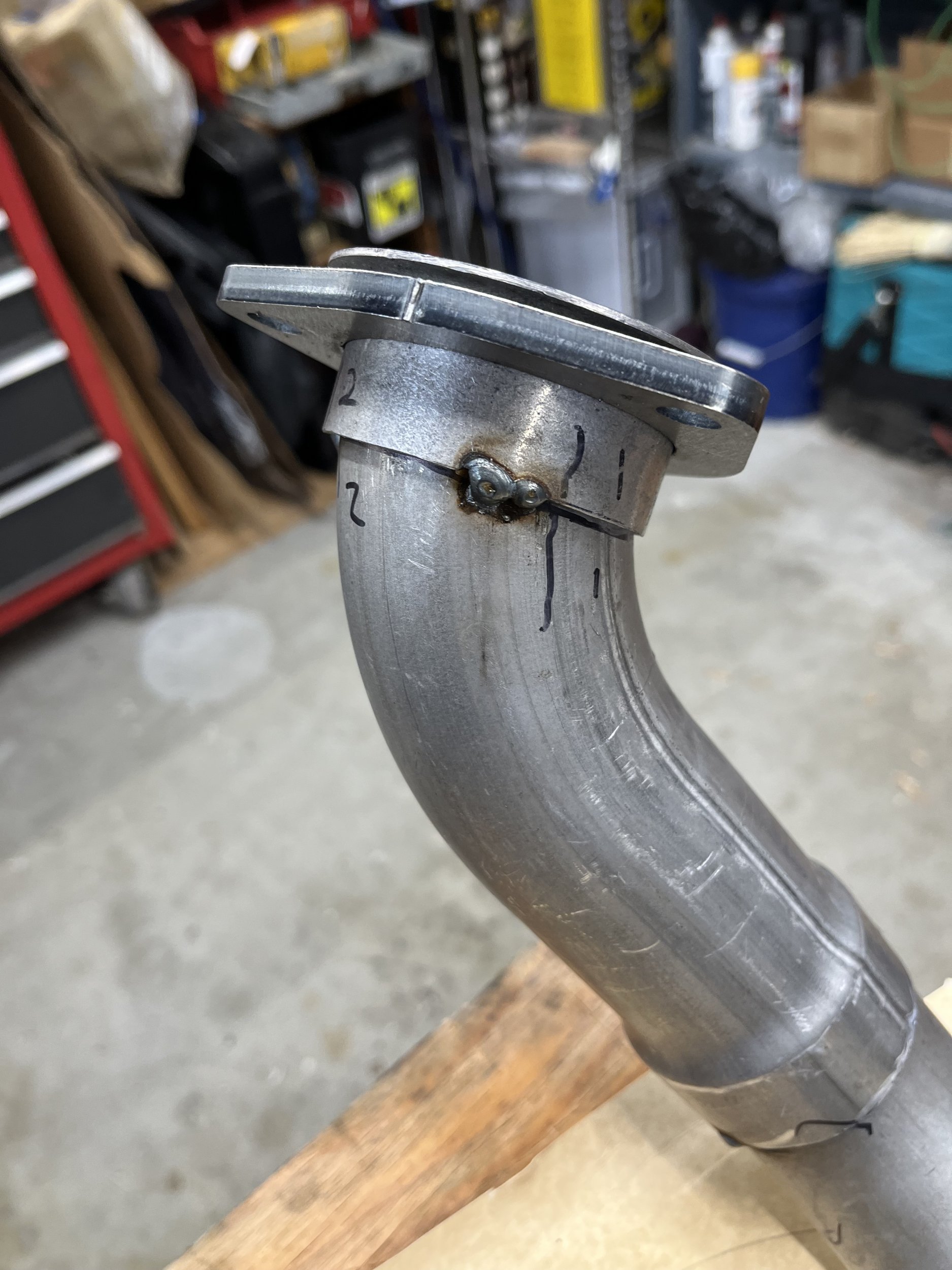

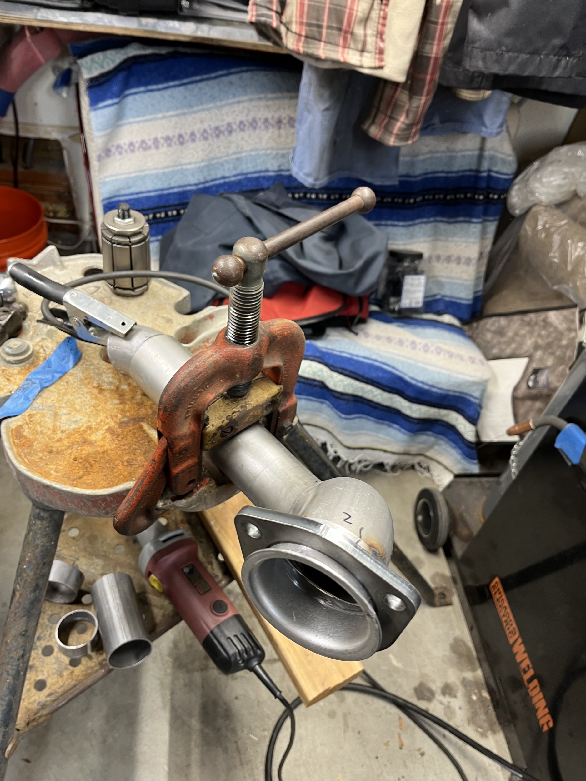

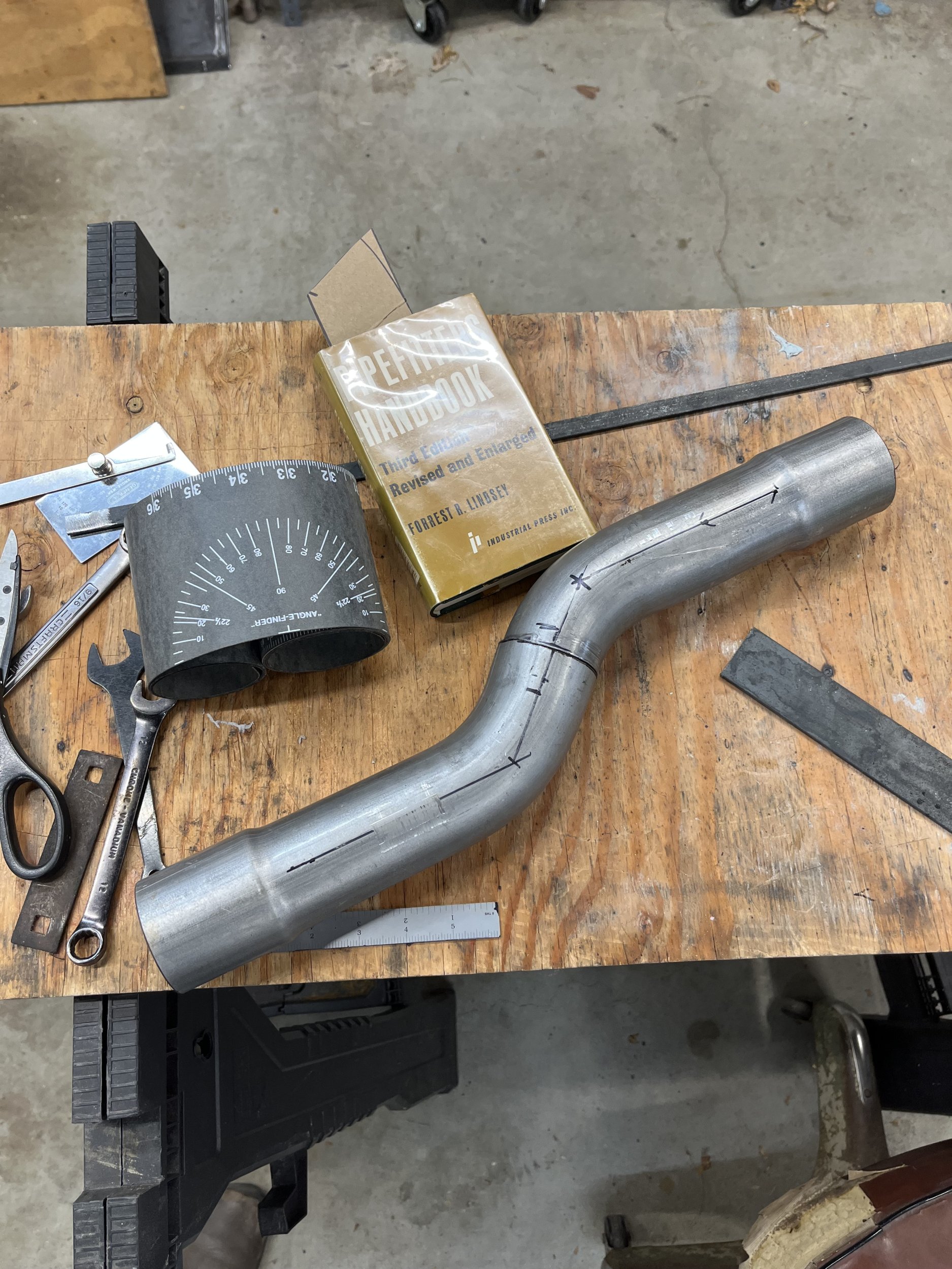

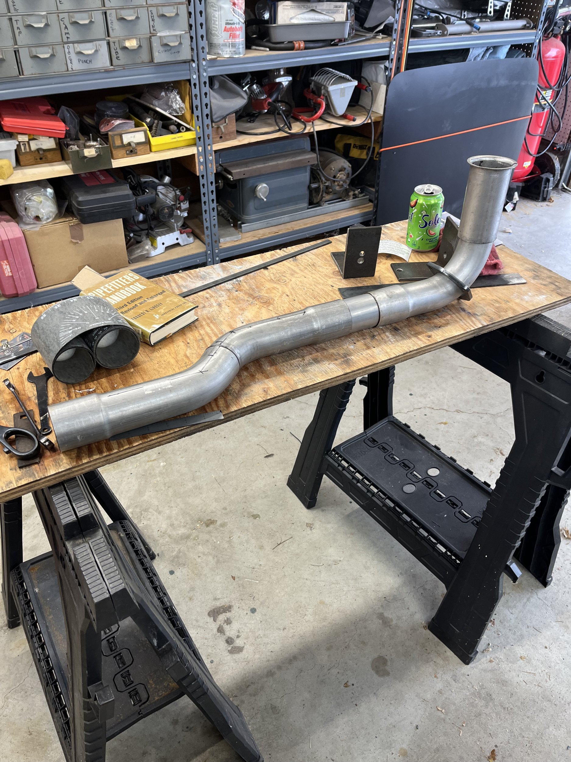

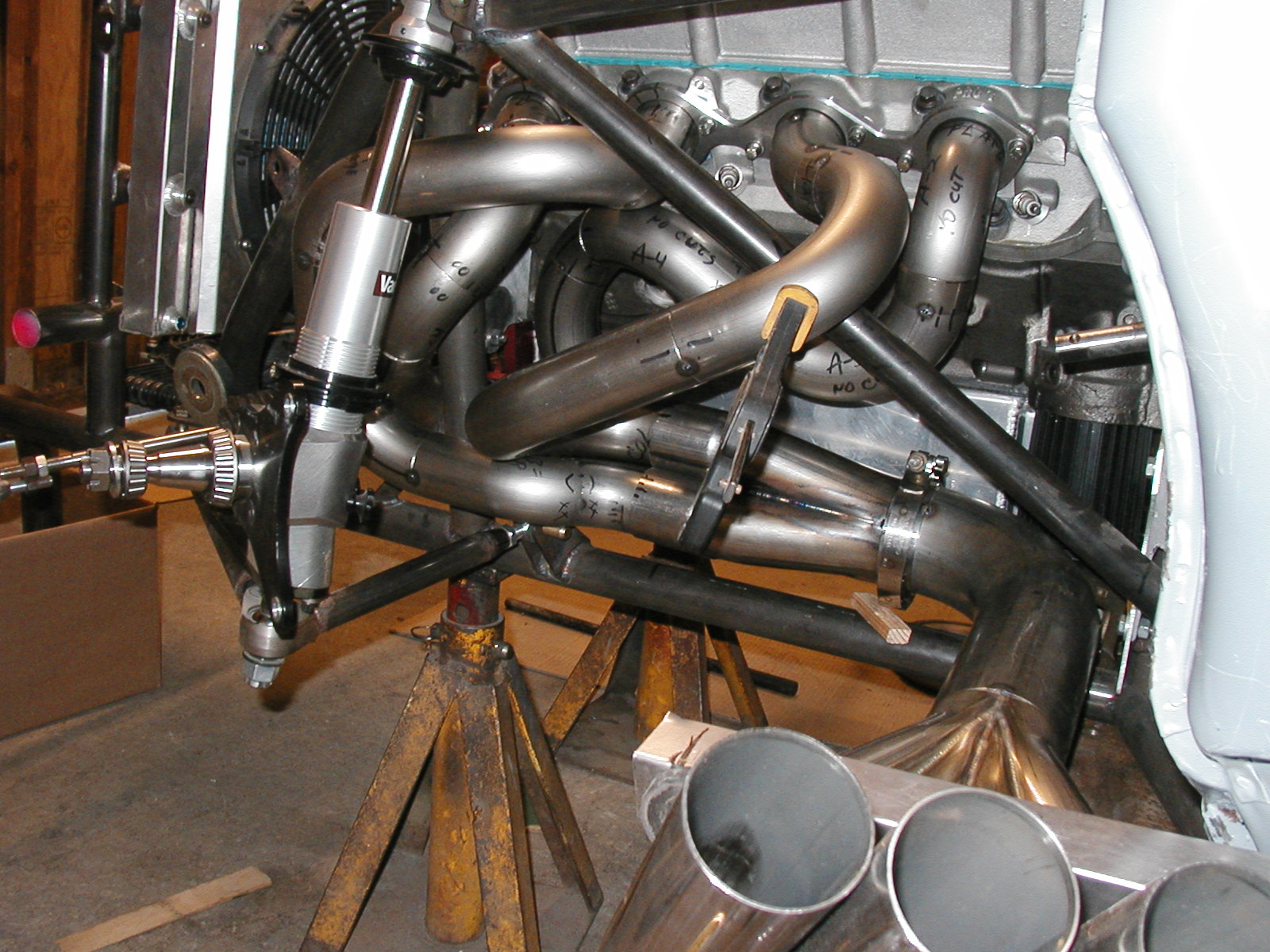

  17. Okay guys, I'm going to share something with you here I've never done before. I believe every craftsman has his tricks and things that helps him do his thing. Quality work requires quality equipment and the knowledge to use it right. Then there's the adjustments needed to make them actually do the job you want them to do. We that have done it know you must have a perfect cut for a perfect fit. There's some talk above about what different ones of us use and after, some sanding, grinding or fitting to get things round enough to **** together and be able to weld said joint. I don't ever have to do that step. I get perfect cuts every time, No B,S! It's me saw of choice. It's a Wellsaw bandsaw model 1000. I've had it 45 years and it still makes $$$$ for me and gives me the cuts I need for headers. Look how tight and square these joints are. Every one of them are strait off the saw. Perfect fits.
    To do that required some machine work on the Table of the saw. This is a drop arm saw so the blade drops through the table as the cut ends at table surface. There was a relief in the table when I bought it for that. The issue was it was wide and not equal on each side of the blade. The blade I went to is a very tooth extra fine and is 1 full inch tall plus the teeth and .030 thick. I also never use a wavy tooth blade, they will give you headaches. I removed my table from the bottom deck and proceeded to fix the relief in the opening. I made an insert and fully closed the gap. Then found dead center of the saw blade and milled a 5/8" relief in it for the blade to drop through replacing the inch and a quarter one that was off center and not square to the blade. Now I can set the u-bend in the saw vice and rock it a tick until it makes contact on both edges and clamp it in the vice and just cut it and done, move on. Can't get any easier and reliable than that. Look at the ends of those 2 tubes. Never touched them out of the saw. Perfect fits.
    You probably noticed the hose clamps. That's all I use to hold all the joints together until it's time to tack. The clamps have a short section of teeth removed so I can tack through the clamp to the pipe. Noting ever moves.
    Below are all 8 primary tubes for this set of headers. Flawless seams and pressure tested. as I recall even my welds were all leakproof. That comes from perfect cuts and fits. No gaps to fill.
    I will also say a lot of Luck plays into this and they are Not my first set. You too can do this with a little practice and some luck.

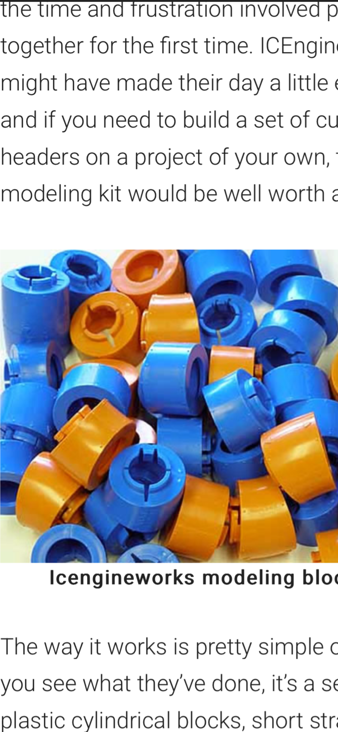

  19. 19Eddy30
    Joined: Mar 27, 2011
    Posts: 5,149
    19Eddy30
    from VA

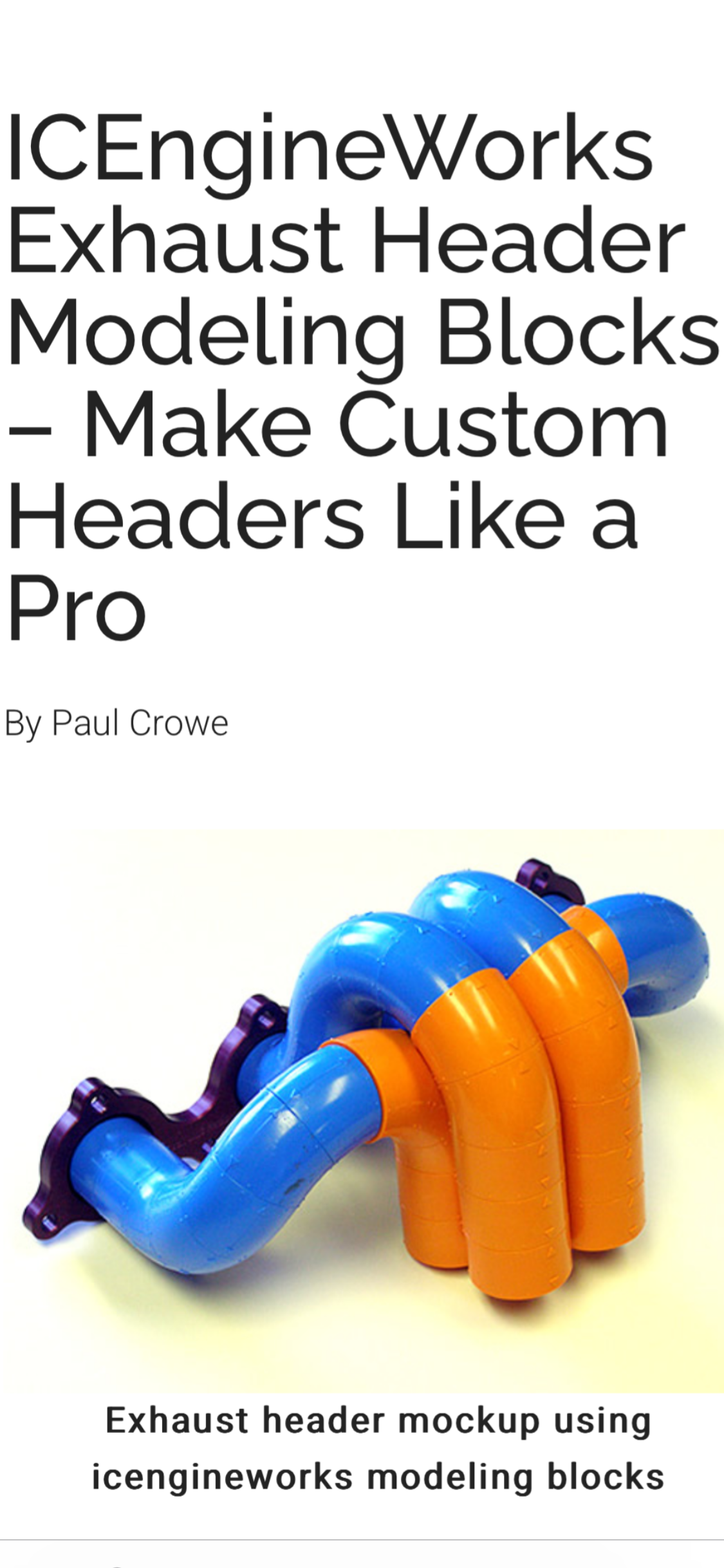

    The trick that @Pist-n-Broke mention about the hose clamp with the
    Oping /notch /slit helps a lot, You can buy or make yourself,
    I have used these , for Tight octopus shaped building ,
    Snap together , & 360deg rotation ,
    Many OD sizes .. multiple degree pie cuts also available.
    ""Down fall""
    Size specific & are / can be
    expensive 2-3 hundred $,,,
    What also nice it your unable to weld ,
    You can take to a fabricator and have them duplicate your Lego headers.

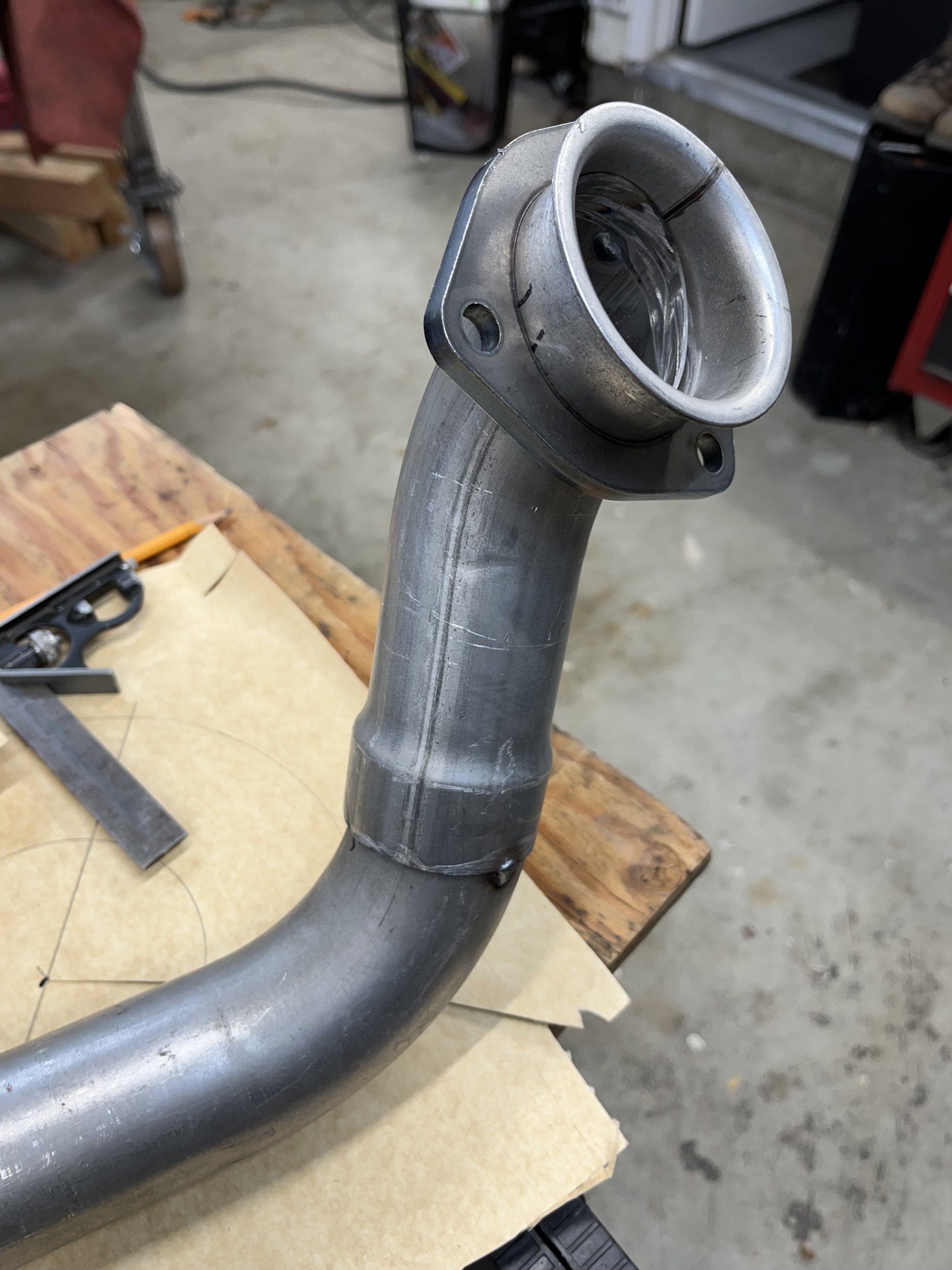

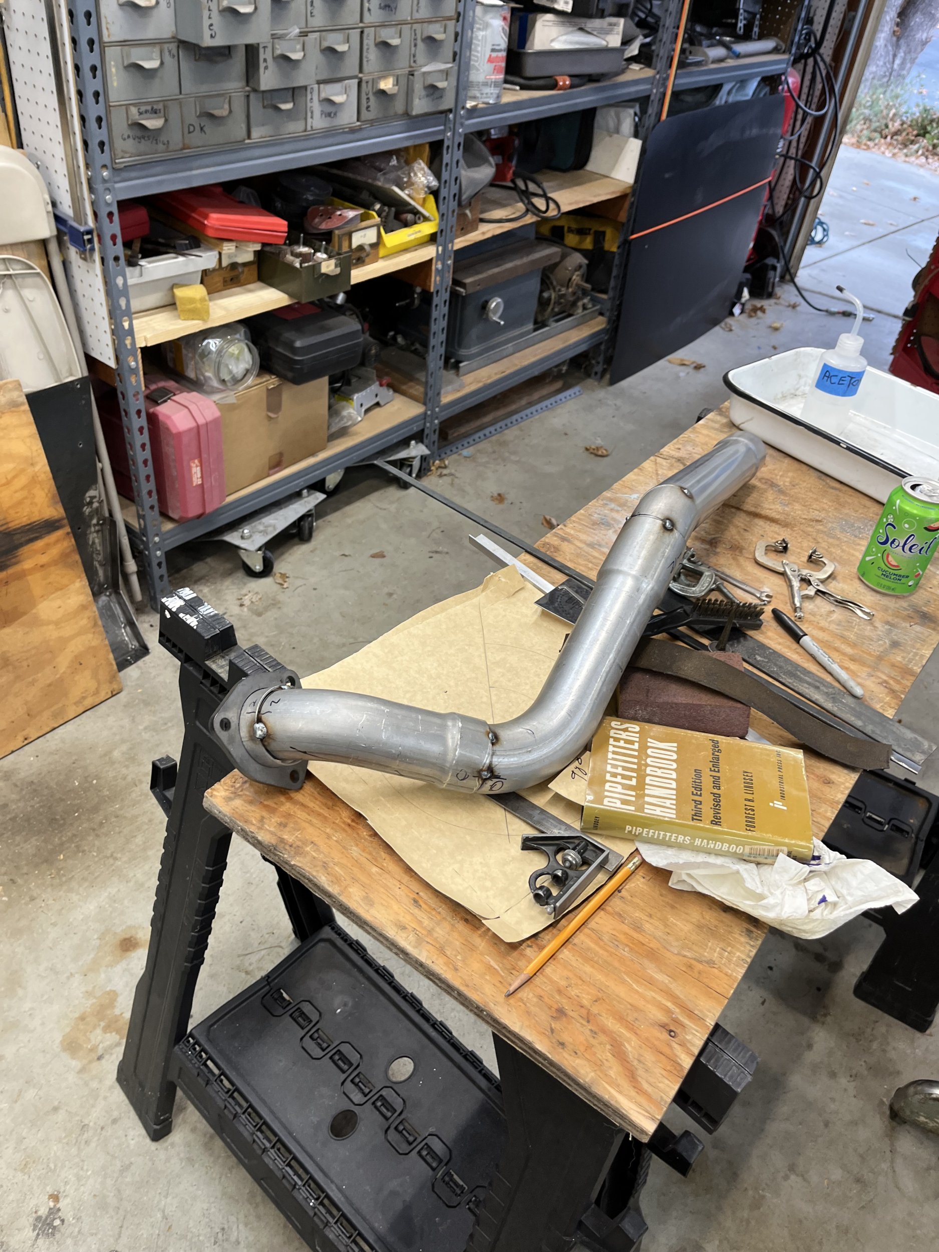

  25. And this is why the above post is the first one I've done on here or anywhere online. The way I do things isn't the best way or the only way. I kinda feel this is a Hands-On bunch of at home builders that want to DO instead of Pay or Spend. I know the Hose Clamps seem kinda Mickey Mouse, but I've learned most of us have a bucket, box or coffee can full of take offs. They are cheap at least, often times free and most of all Universal to size. I truly don't understand the whole Lego snap together thing, sounds like a lot of $$$$ out the window. Plus, you have to store them somewhere and how many more times will you use them. For most of us this Car thing is a learn as you go, there's always a little bit of cast off and second time around. If you're going to build, Build! Don't spend, spend, spend, then Pay someone else to finish. Building Cars is a continuing Education course that is full hands on, so do hands on. It's like anything you do with your hands, once you get the hang of it no big deal, unless you make it one.

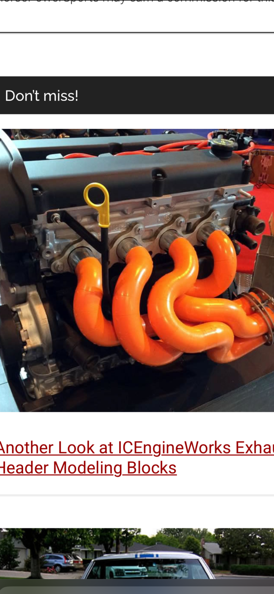

  26. 19Eddy30
    Posts: 5,149
    19Eddy30
    from VA
    @Pist-n-Broke ,Nice job of the pic of header you posted , You do not think time could have been saved / Faster to lay out with header modeling?
    Maybe this is what you do every day is build headers ,So you have a eye whats needed.
    I am not that young now , I just want to get things finished ,
    Header Modeling Not for every one
    When most here are just doing a car or two with same O engine combo's thats been done many times over & over with same parts , There is modern simple Technology that can cut time in 1/2 , & save on material taking the guess out of Knowing whats needed ..
    Just a few examples for mild complex headers, My Legos / header modeling
    Are left on shelf until I am doing / need a radical header or set, H-R , full tube Ch***is or relative waiting to stuffing a
    427 side oiler down into Ot micro car .
    There is a build thread on here ,
    Where the owner / builder has used a Cad / 3D
    To build a basic roadster with Sbc thats been done Thousands of times since 1965-to present , Builder could of saved time & $ just using Quality parts
    Like Pete/Jakes & other ,
    Its a Nice built roadster ,
    Not trick or exotic parts .

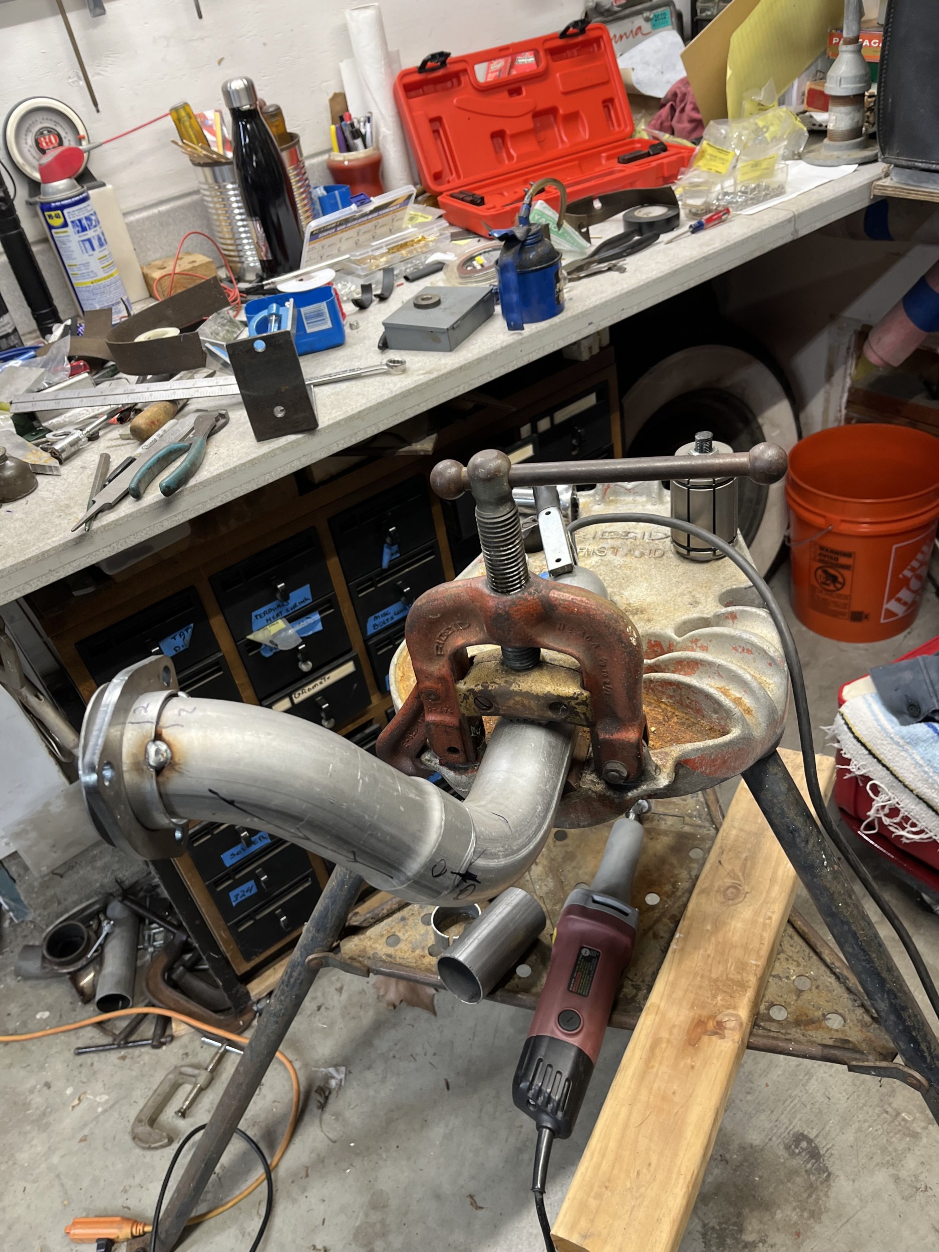

  27. Might just be the Generation Gap and how you learn to do what you do and how well it works for ya. When I started Cad programs didn't exist, and Lego's hadn't been invented yet. I feel if you're a true Craftsman and know what you're doing the more complex the job just means spending a little more time determining how to execute it. Next is deciding if you're up to the job at hand. There's a Start point and a finished point. What's in-between is just the job. I'm really glad I'm retired now. I don't work anymore; I just spend the day doing what I choose to enjoy doing. I have 2 more sets of Headers to build. One for this.
    And one for this. Noting real exotic or difficult.
