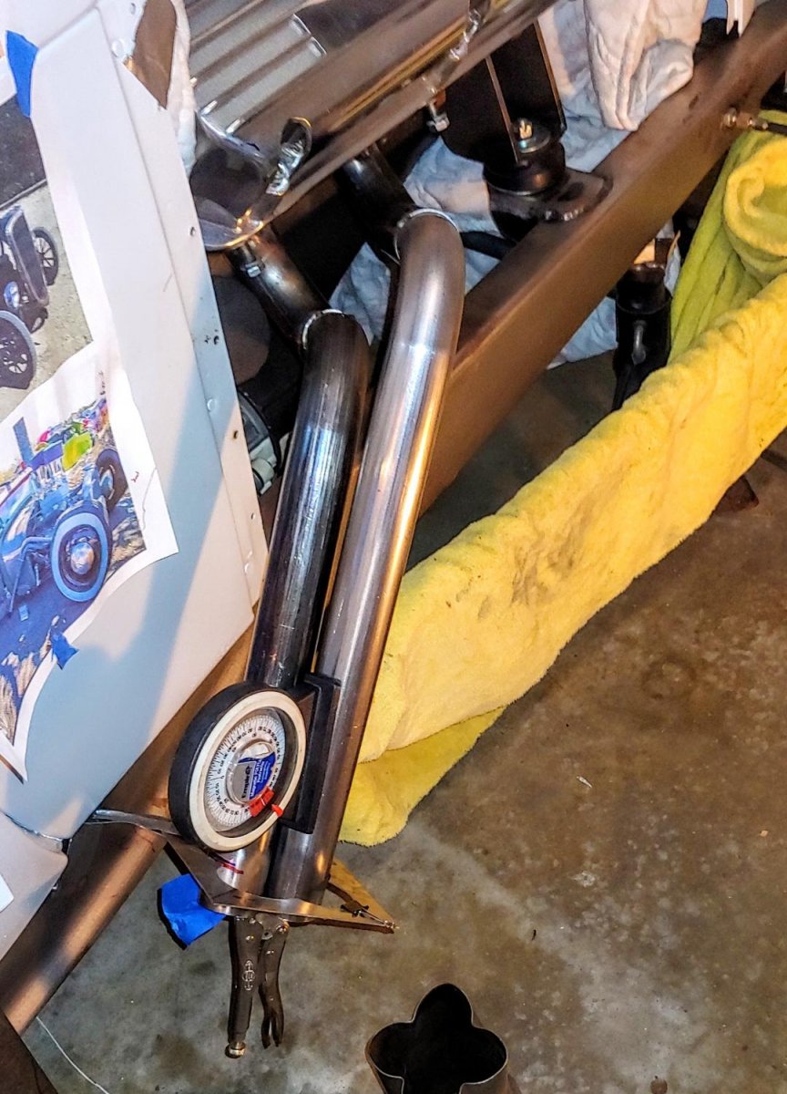

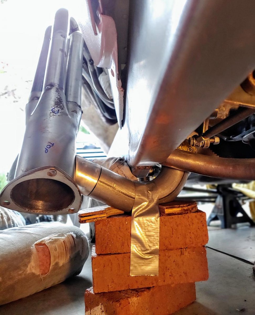

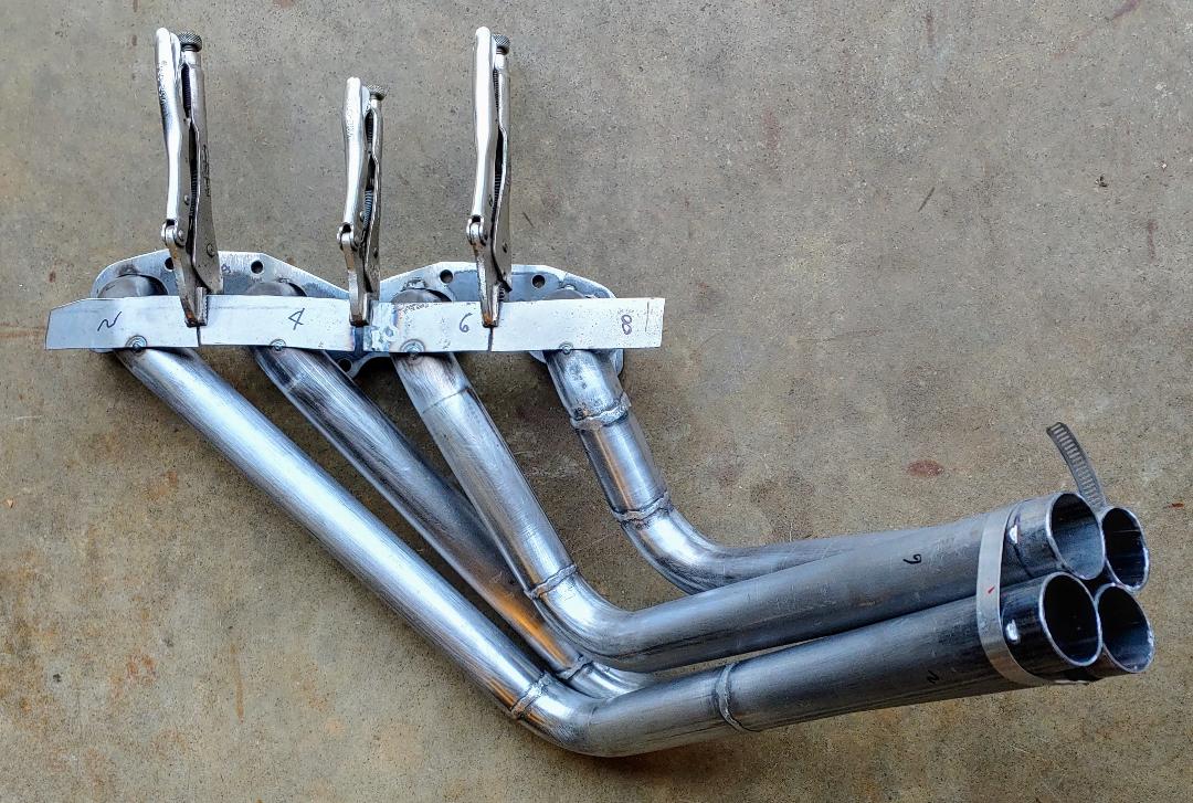

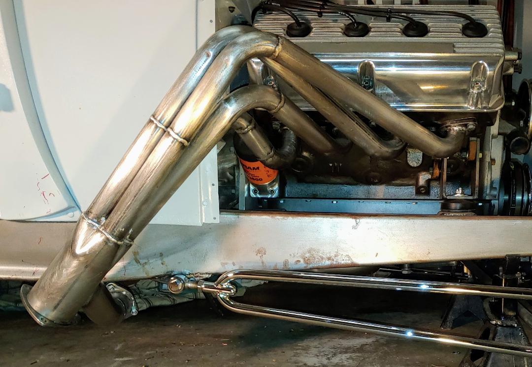

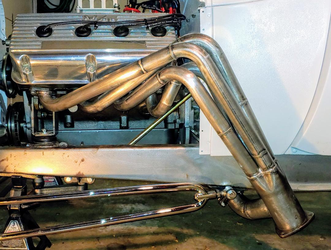

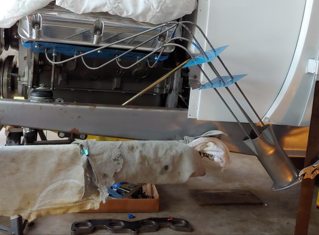

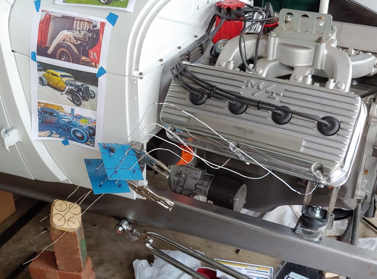

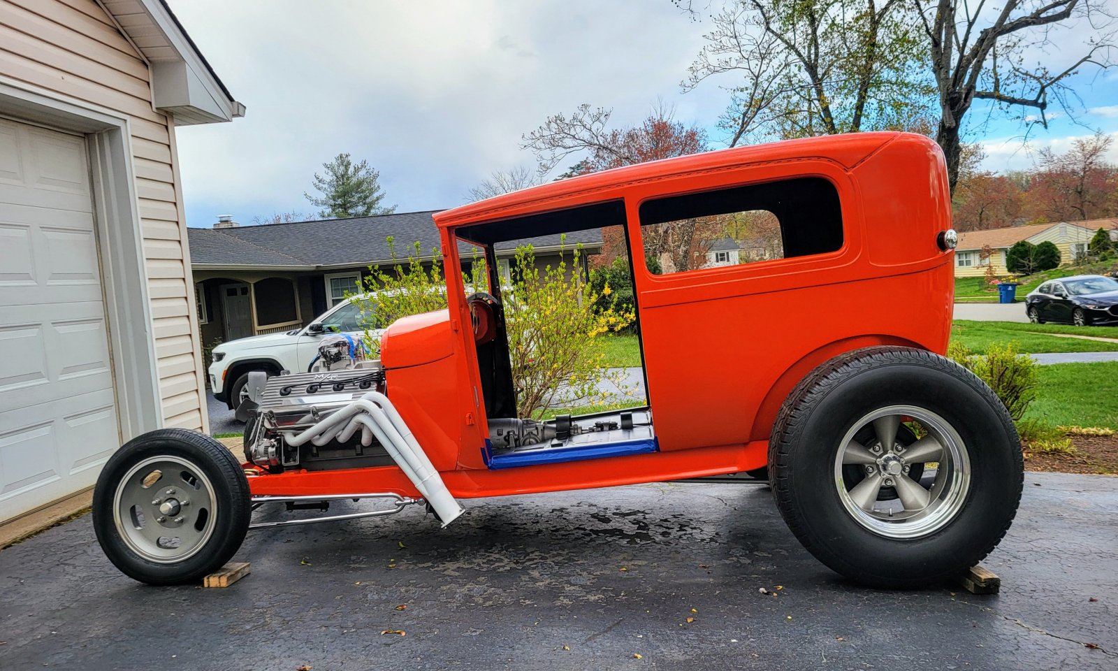

    Here's how I made the fender-exit headers for my A. I'm an amateur hack with a MIG welder and mild steel tubing..
    Prototype #1 was ultra-traditional coat hangers & bricks: ;)
    Prototype #2 was 1/4" steel rods with 2.5" radius.
    Headers themselves consisted of 5/16" thick flanges from "Headers by Ed", 3.5"x10" collectors, and 16 gauge, 1 5/8" primary tubes with 2.5" radius mandrel bends, from Summit.
    More pics here:
    https://www.jalopyjournal.com/forum/threads/introducing-my-fuel-coupe-styled-tudor.132127/page-7
    headers 01.jpg headers 02.jpg headers 03.jpg headers 04.jpg headers 05.jpg headers 06.jpg headers 07.jpg headers 08.jpg headers 09.jpg headers 10.jpg headers 11.jpg headers 12.jpg headers 13.jpg headers 14.jpg headers 15.jpg
    bchctybob, BradinNC, warbird1 and 9 others like this.

    I really like the hose clamp idea. Is there a matching hole 180 degrees apart?
    Chavezk21 likes this.

    GREAT tip on the nerfs!

  11. Marty Strode
    Joined: Apr 28, 2011
    Posts: 9,852
    Marty Strode
    3 holes normally! The safest way I have found to drill the holes is to put the clamp on some s**** tube and use a step drill.

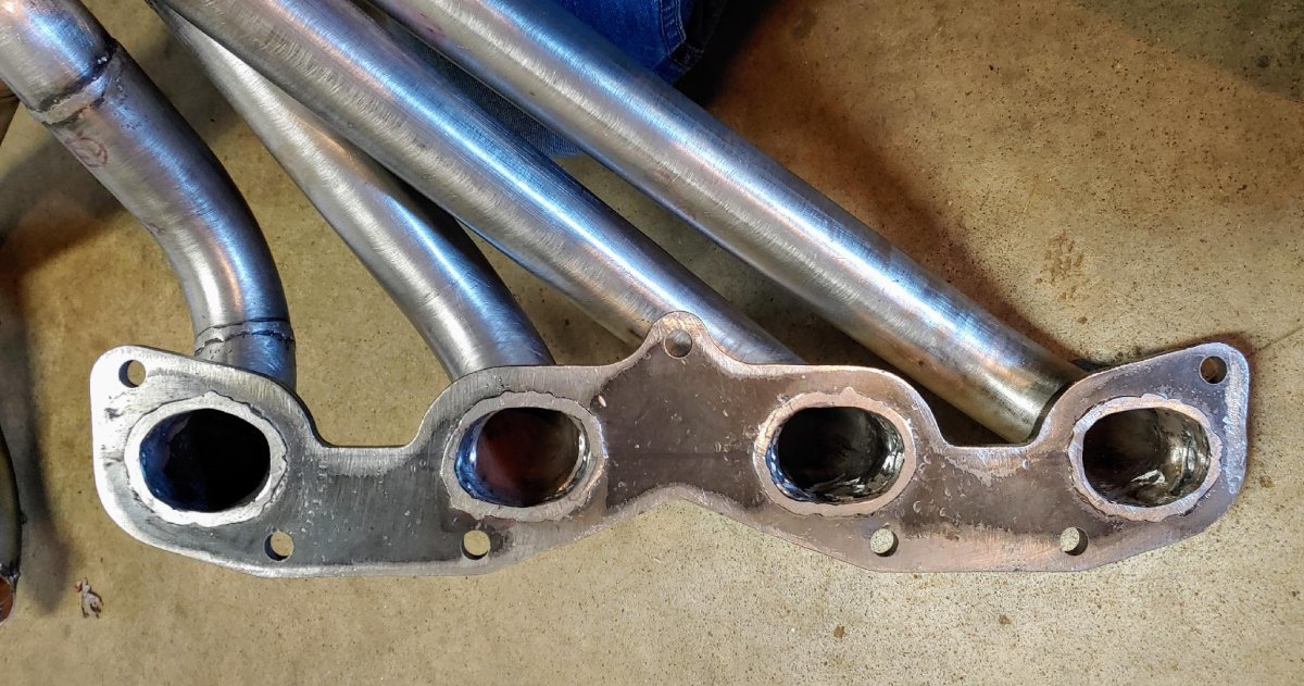

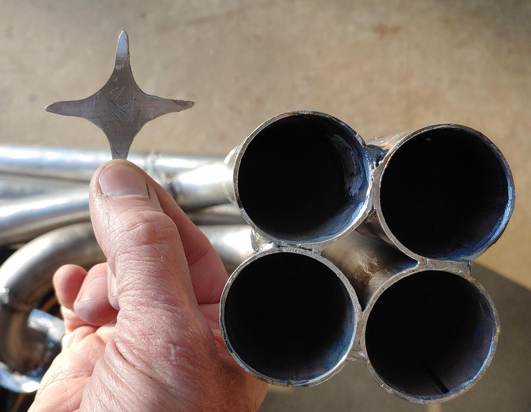

  21. e015475
    Joined: Jul 25, 2013
    Posts: 122
    e015475
    from Phoenix

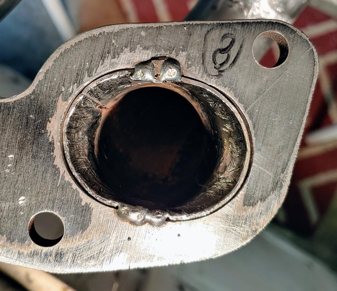

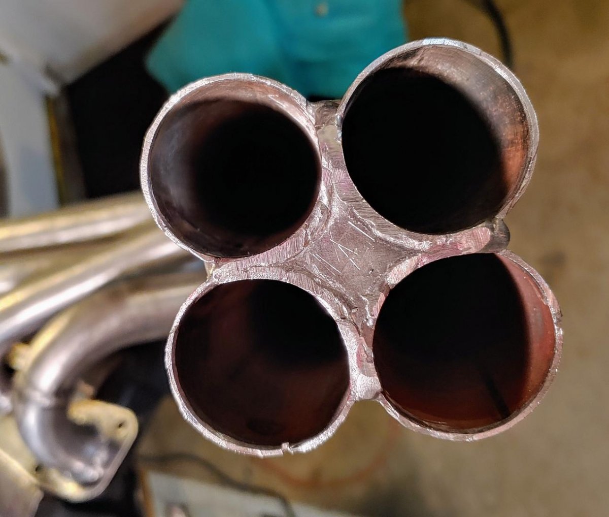

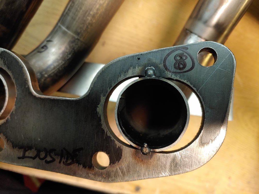

    Confuser? You're making this too complicated. Unless you are going to do several sets of headers a tool is unnecessary IMO
    Squeeze the primary tube in a vice so it will fit in the oval port. Put a couple of sturdy tacks on the primary to the flange. Use the ball end of the largest ballpeen hammer you have to work the primary tube into the oval flange. (I usually use the big hammer ball as a tool and hit it with another hammer) If you are using stainless tube, it will want to spring back and you may have to use some heat to get a good joint. Once you've got it fitting nicely, grind the tube flush to the flange and do a 'peanut' (autogenous) TIG weld at the joint. Braze the outside where the primary meets the flange and put in a nice fillet. Do this with the flange bolted to a s**** piece of steel (like a 6" piece of steel channel) and you'll have a pretty good chance of keeping it flat enough to seal.
    You can MIG weld the primary on the engine side of the flange like "Just Gary" did in a previous post, but you'll need to 'blanchard grind' the surface to have any hope of sealing the flange to the engine. (I've had reasonable luck using a belt sander with a sanding surface about the length of the flange) I think this is how most of the m***-production headers are made.
    ekimneirbo and patsurf like this.

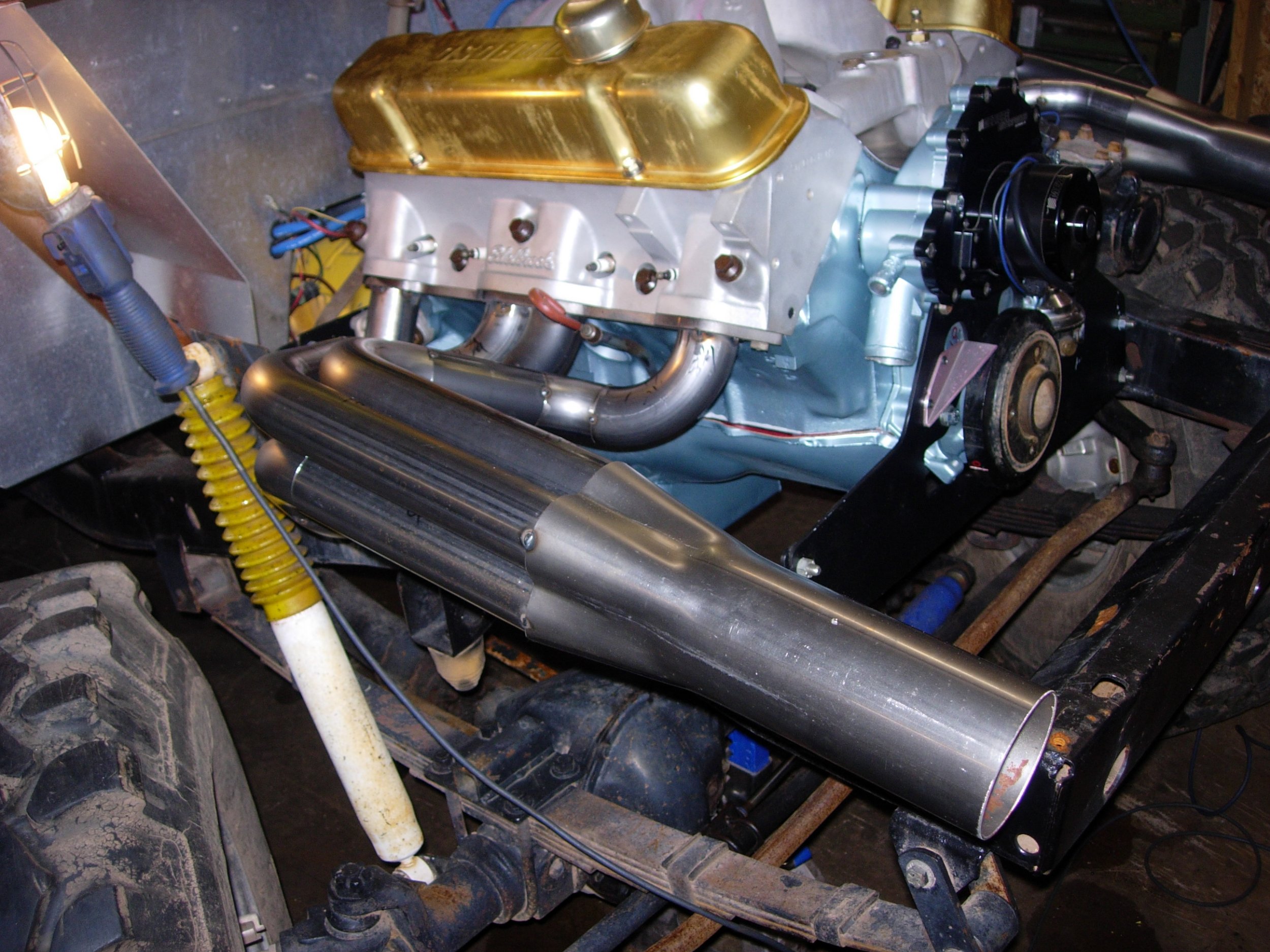

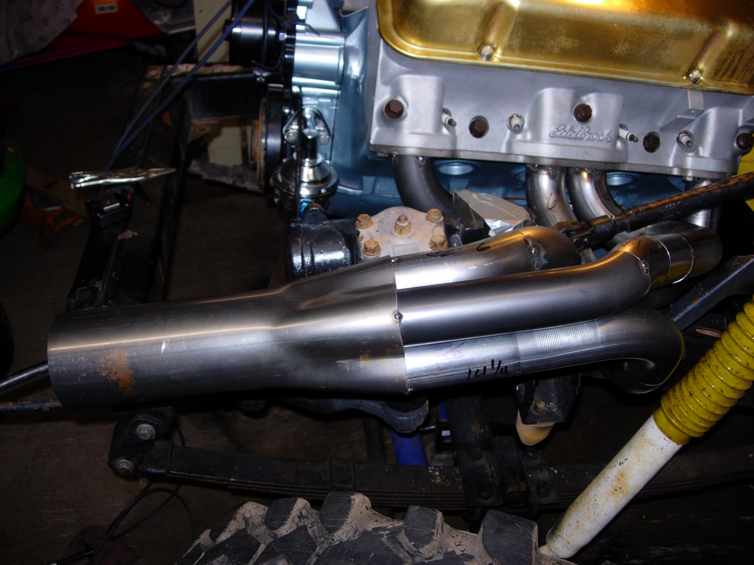

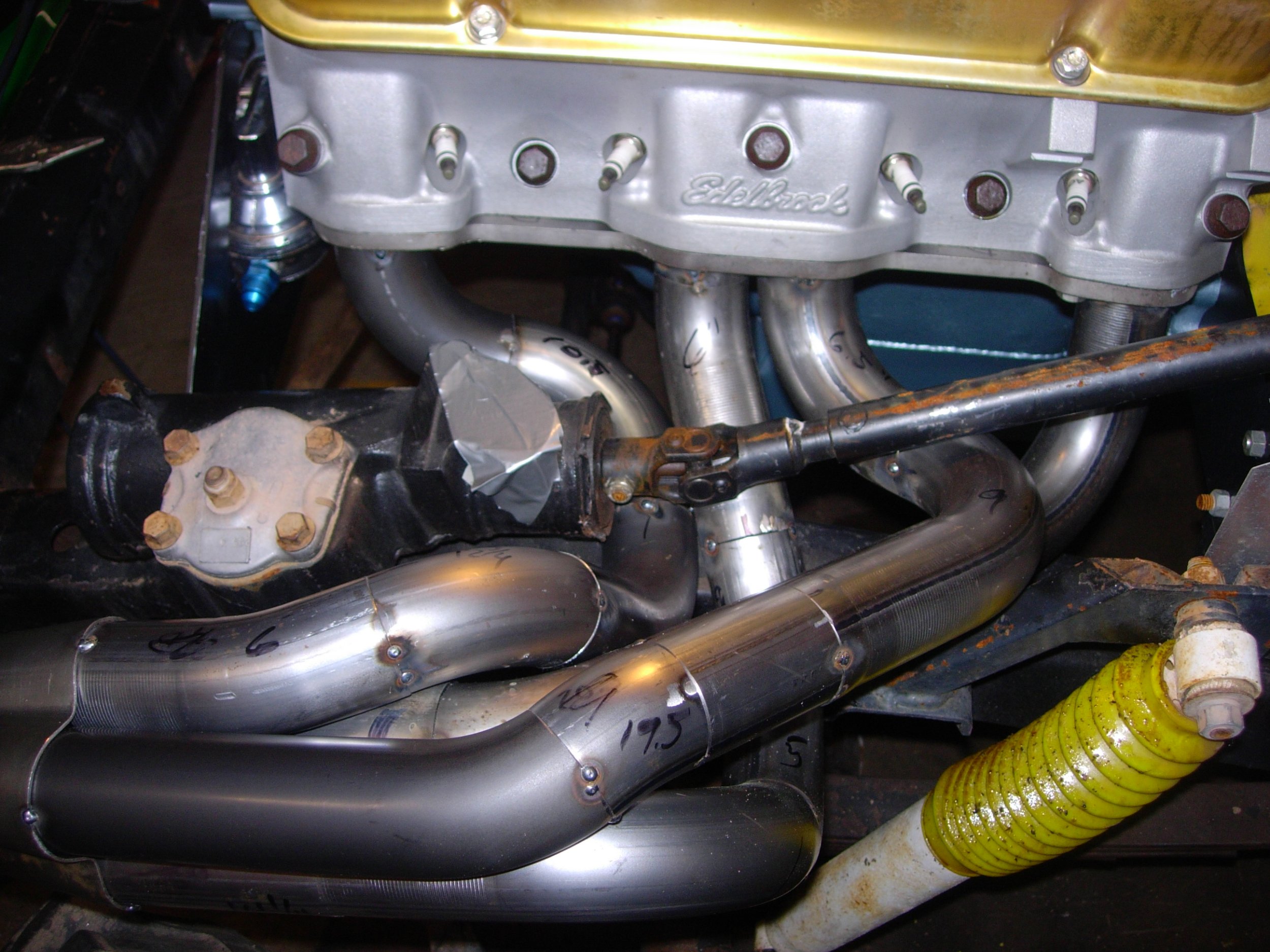

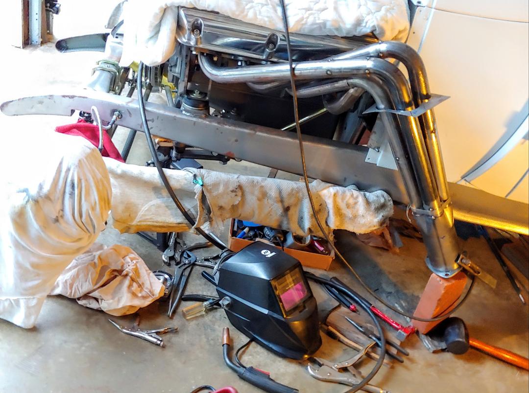

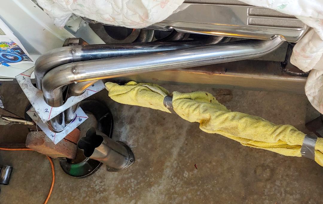

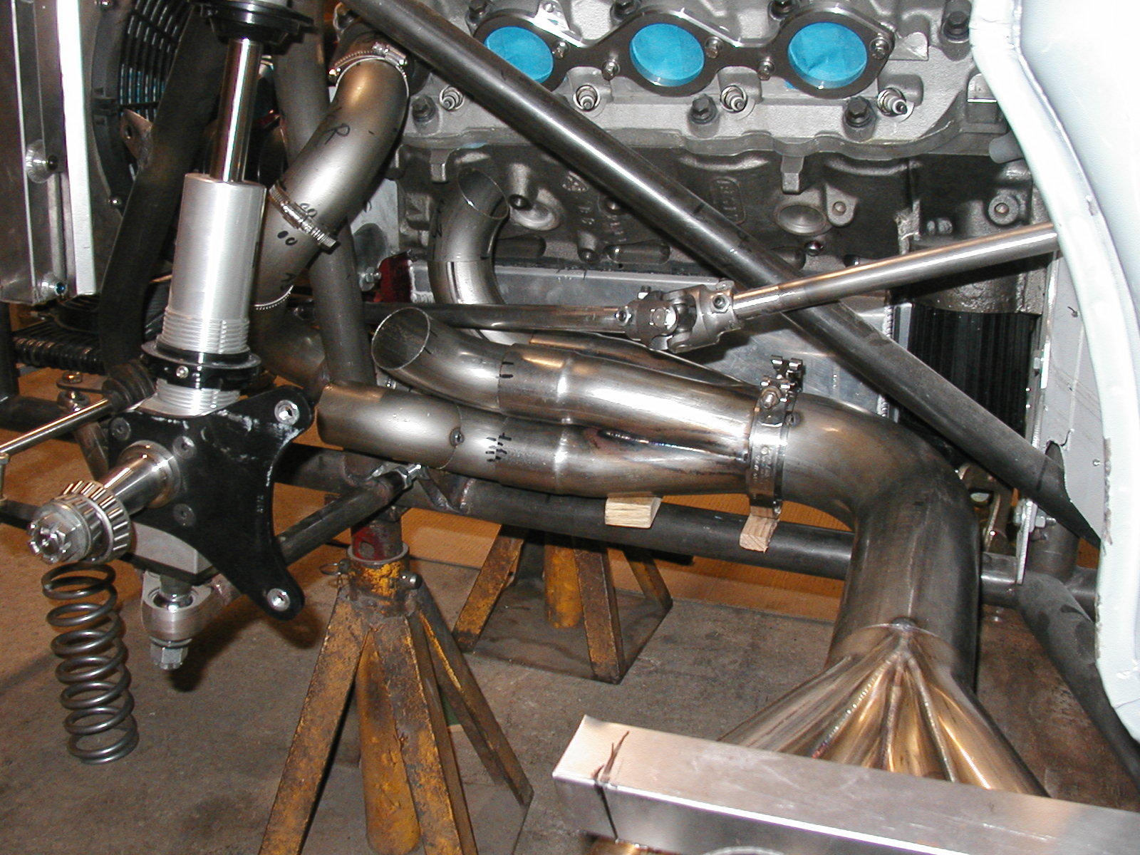

    A set of long-tube headers for an OT engine. Used lumber to get the correct orientation of the flange to the collector and started cutting tubes to connect them
    Focus on fit-up - no lippage allowed! The steering shaft goes through the headers.
    An ICE header lego kit was useful and can be resold after you're done with it for nearly what you pay.
    ekimneirbo and Just Gary like this.
