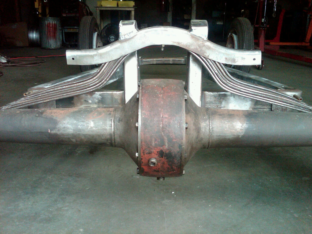

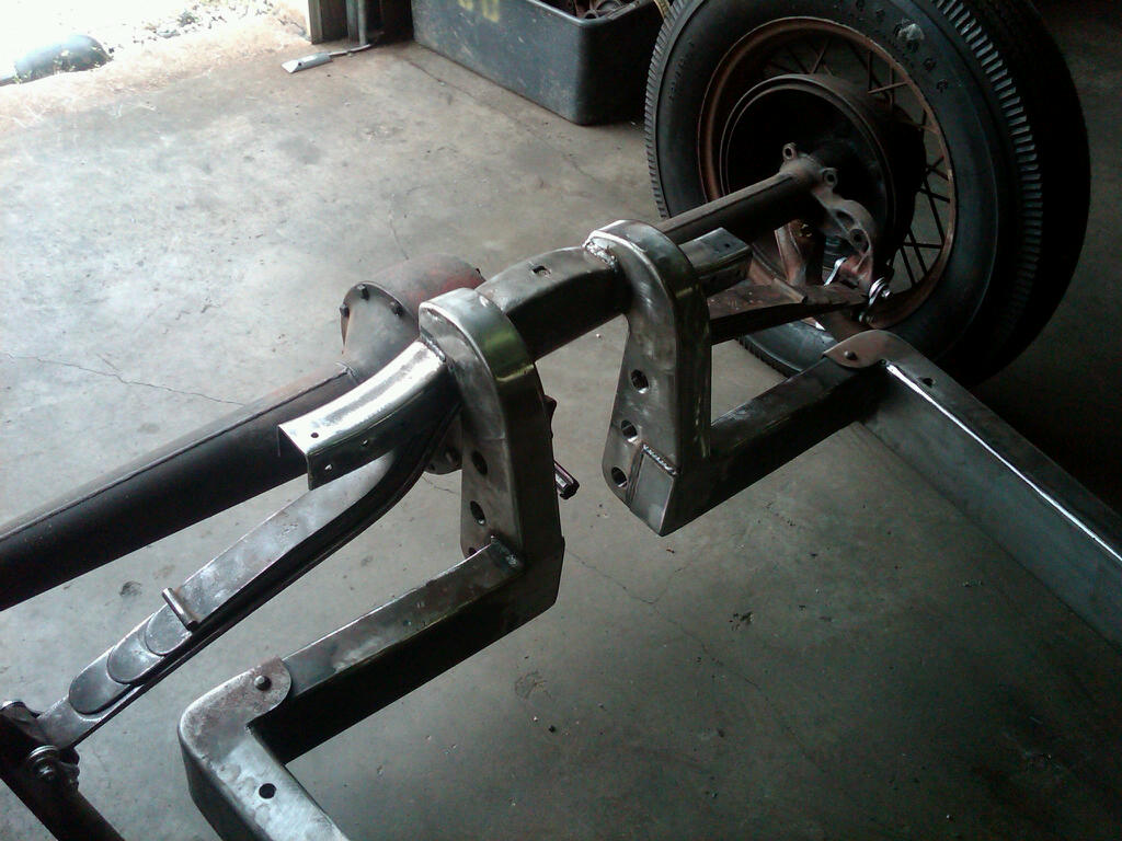

    Thought I'd share what I'd been working on. Trying to keep it as 40's style as possible using and reusing as many original parts as possible. I started by pulling some measurements of the body and length of the motor. The body is a 26-27 T Roadster minus trunk. The motor is a 21 stud v8 flatty out of a 37. I knew I wanted to run the rear spring in front of the rear end with a floating T gas tank.
    My buddy bent up some frame rails from my measurements and it all went from there. I also drew up the rear kick ups in solidworks and he lasered them for me. Thanks Dave.

    More pix. We went crazy mocking stuff up and staring at it.

    Love the stance, and I REALLY like that detail in the back of the frame, where it wraps around and has a "top plate" with a big round-head rivet-looking fastener on it. That's a kick-ass detail.
    The wheel base is spot-on, too.
    The one thing I wouldn't consider safe is mounting the leaf spring perch thru the split bones.
    Look at the metal thickness of the cross members where the springs mount... they're thick like that for a reason: they're holding up the entire weight of the car.
    What's the wall thickness of those bones? Then you gotta factor in the leverage applied with the front axle/wheels out ahead of it supporting the weight, and the flatty behind it.
    -Brad

    Thought I'd share some information on how I got my measurements and how I thought it out.
    I started with wanting the very front of the frame to be 20" so it would tuck behind a 32 grill shell. Then I took a measurement of my flatty with the fan on and the length of the body figuring the bellhousing would be right at the firewall to keep the shifter at the right spot inside the cab. (I don't remember my measurements for this but it gave me a starting length.)
    The length of the frame rail is app. 83" and the firewall sits 34" back from the front of the frame. I then measured the width of the 2 rear body mount holes that would be under the seat (35 1/2"). I wanted those holes to be in the center of the frame rail.
    Just so happens since I started with a 20" wide front cross member and run the frame rails back to 35 1/2" in the center and with body sitting where I wanted the frame rails enter the body perfectly at the firewall.
