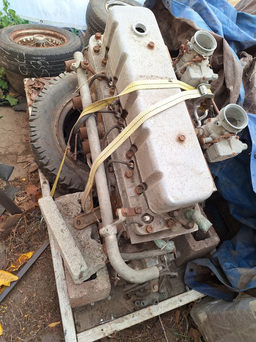

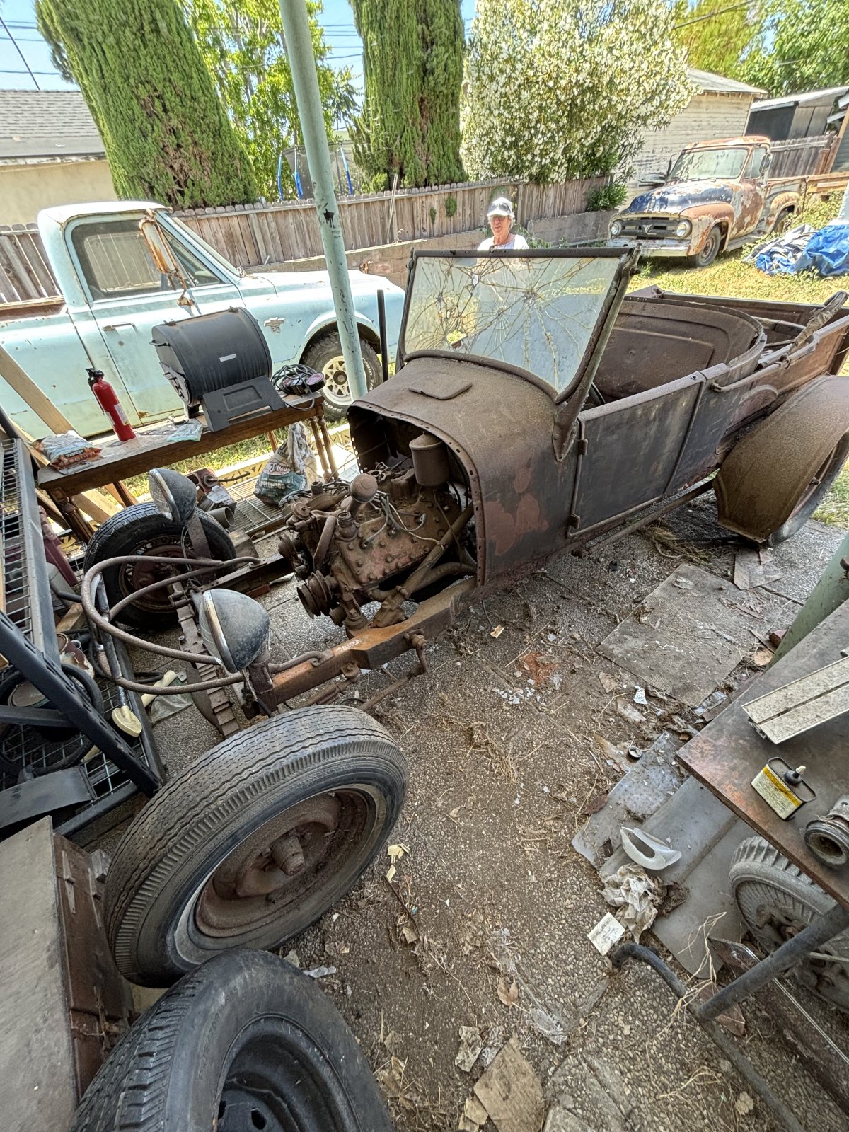

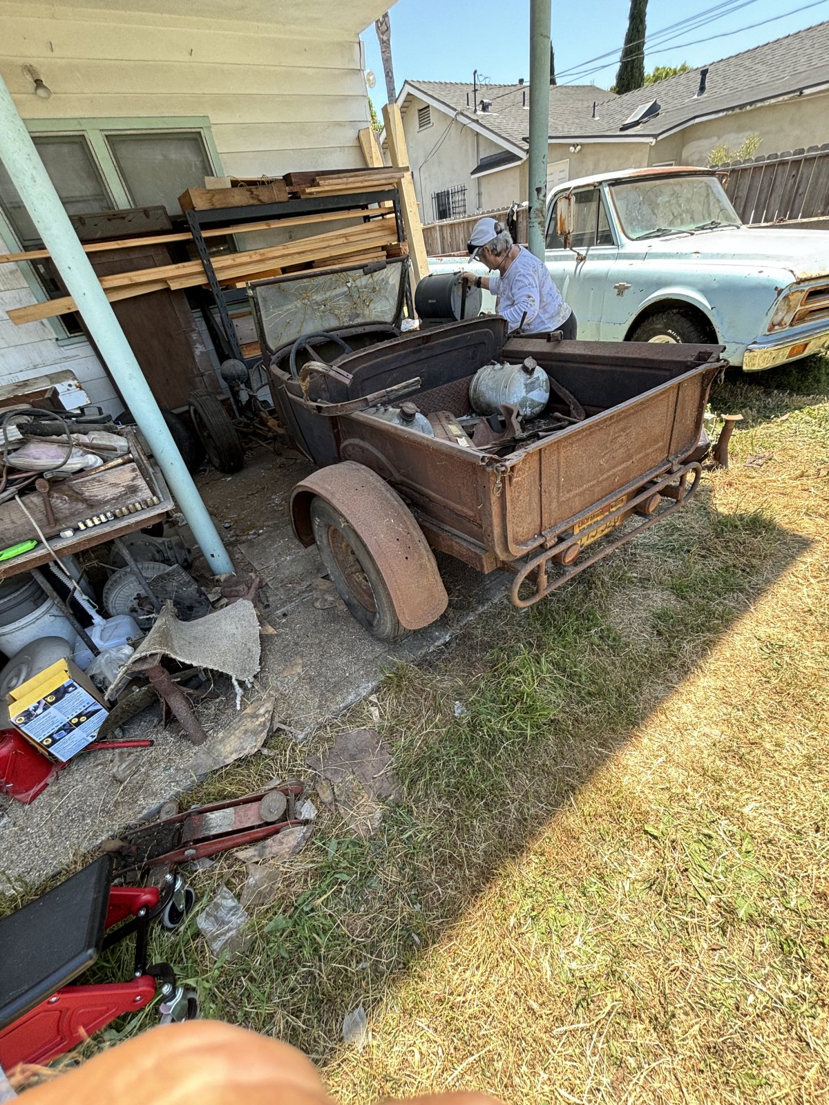

    David McKindley owned this car from 1951 until he p***ed away earlier this year. His family always referred to the car as the “hot rod”, and an extra engine as the “race car engine”. The car is a 1927 roadster pickup body on later frame rails registered as a 1934. The race engine is a Ford G series 6 with a Madis aluminum F head. How I came to have the opportunity to own and restore them is a story in its self.
    The car is powered by an 8BA that appears to be stock. It’s backed by a Lincoln Zephyr trans and a banjo diff. It also has a Dodge front axle and Dodge front and Ford rear juice brakes.
    Along with the car and the Madis engine I got an Edelbrock dual carb intake, a few 97 and 48 carbs, and a complete Cyclone rear end with Buick drums. Oh, and a copy of the 1951 pink in Mr McKindkey’s name.
    My plan is to restore the car mechanically with the 8BA and current trans and diff, but eventually install the OHV Madis 6 and the Cyclone quick change.
    At this point I’m still ***essing what I have. As the project progresses I’ll post updates, but here are a few pictures of what I’m starting with.

    Tell us more about the Madis Ford 6cyl.

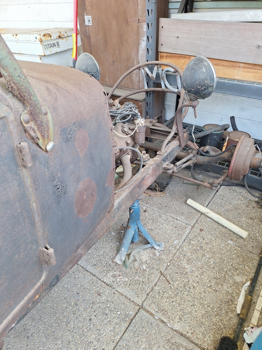

    As I ***ess the car I'm currently concerned about a couple of things:
    The front suspension has really short radius rods. From the rear pivot point to the center line of the axle is only about 15". This was done, I think, because of the kickout on the left frame rail to accommodate moving the steering box out to clear the 8BA. It would seem that as the suspension compresses the caster would increase a lot more than longer radius rods. But I don't know that this matters.
    The rear suspension is also a concern. It has split wishbones, but still has the torque tube drive line. I suppose that if the radius of the wishbone front pivot point to the rear axle centerline is exactly the same as the distance from the centerline of the universal joint to the centerline of the rear axle it should work, but I've not seen this done before. The rear suspension moves freely, so it doesn't seem to be binding up.
    The car was driven about 15 years in this configuration, so it must work to some degree. perhaps my concern is unfounded, but these configurations are unconventional.
    Any thoughts?

    I think the original torque tube rear suspension has perfect geometry. Splitting the wishbones back there ruins that. Can they be brought back in? Hopefully they didn’t do it because frame rails were in the way.

    I'd be concerned about the geometry in that front end and the side/twisting loads being put into that shackle mount as the axle travels through caster change.
    But as you said, it was driven for an extended period with that so can't be too bad.
    I'm conscious of the flaming going on in that other thread though and just because something was built a long time ago, doesn't make it right or safe.:rolleyes:

    Yeah, I couldn’t leave that front hairpin alone. Needs to be at least a foot longer, maybe two. Especially with a tube axle. Old and not broken doesn’t guarantee good, just means it’s been lucky so far.

    I’d change it also. Many of these cars don’t have much suspension travel or just see primarily paved roads so they “work”, but if you run it thru full travel which could be just the case of hitting a pothole. That’s when the failure (hopefully nobody gets injured) will show up.

    @Clydesdale Good point about the amount of twist on the spring perch. It’s not practical to lengthen the radius rods due to the frame kickout that the steering box fits into.
    However, the caster change could be eliminated with a four bar setup.
