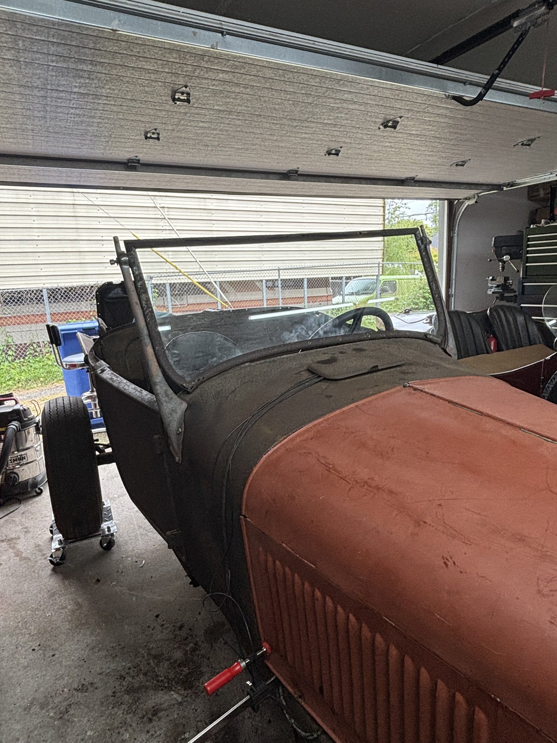

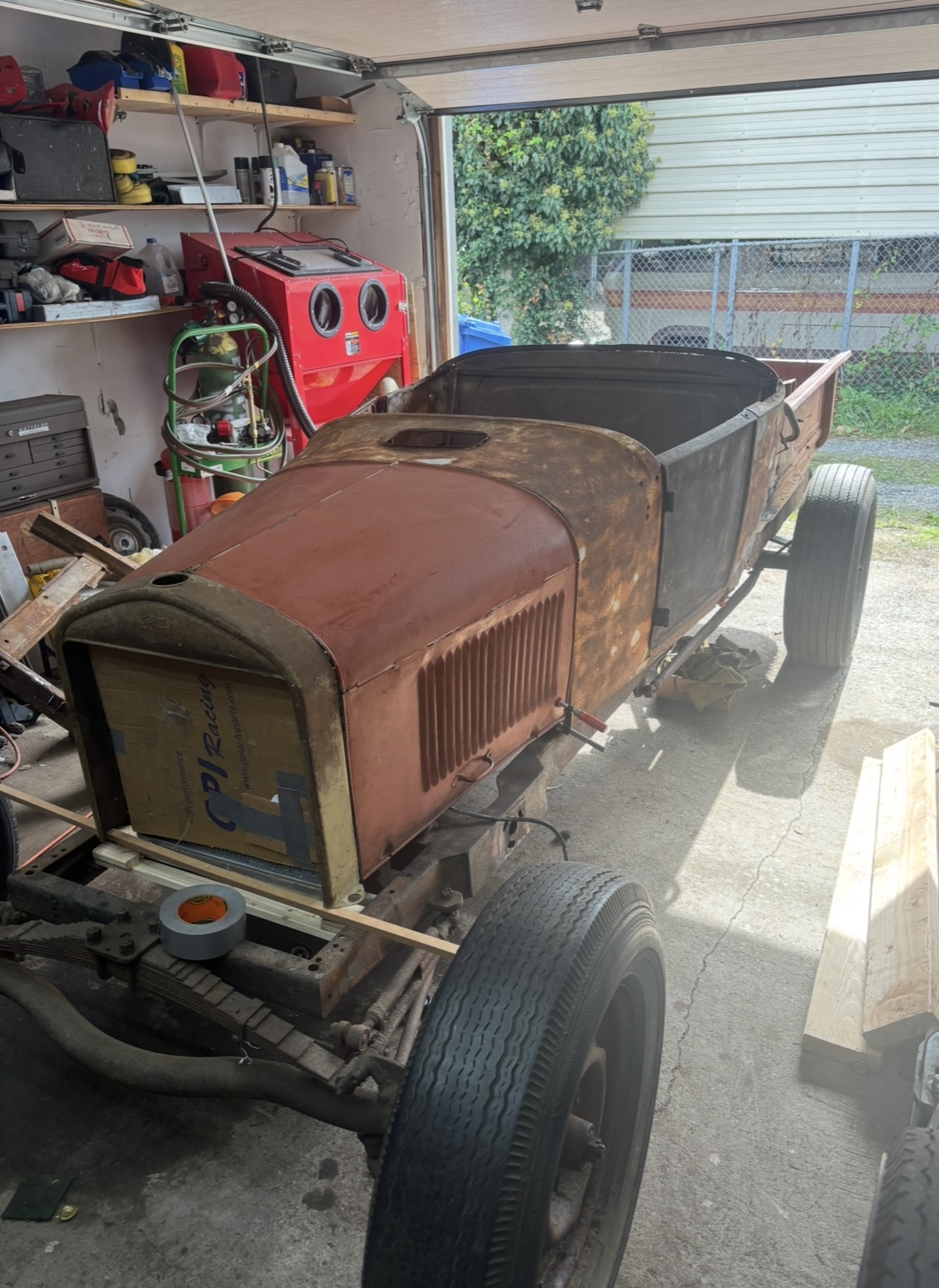

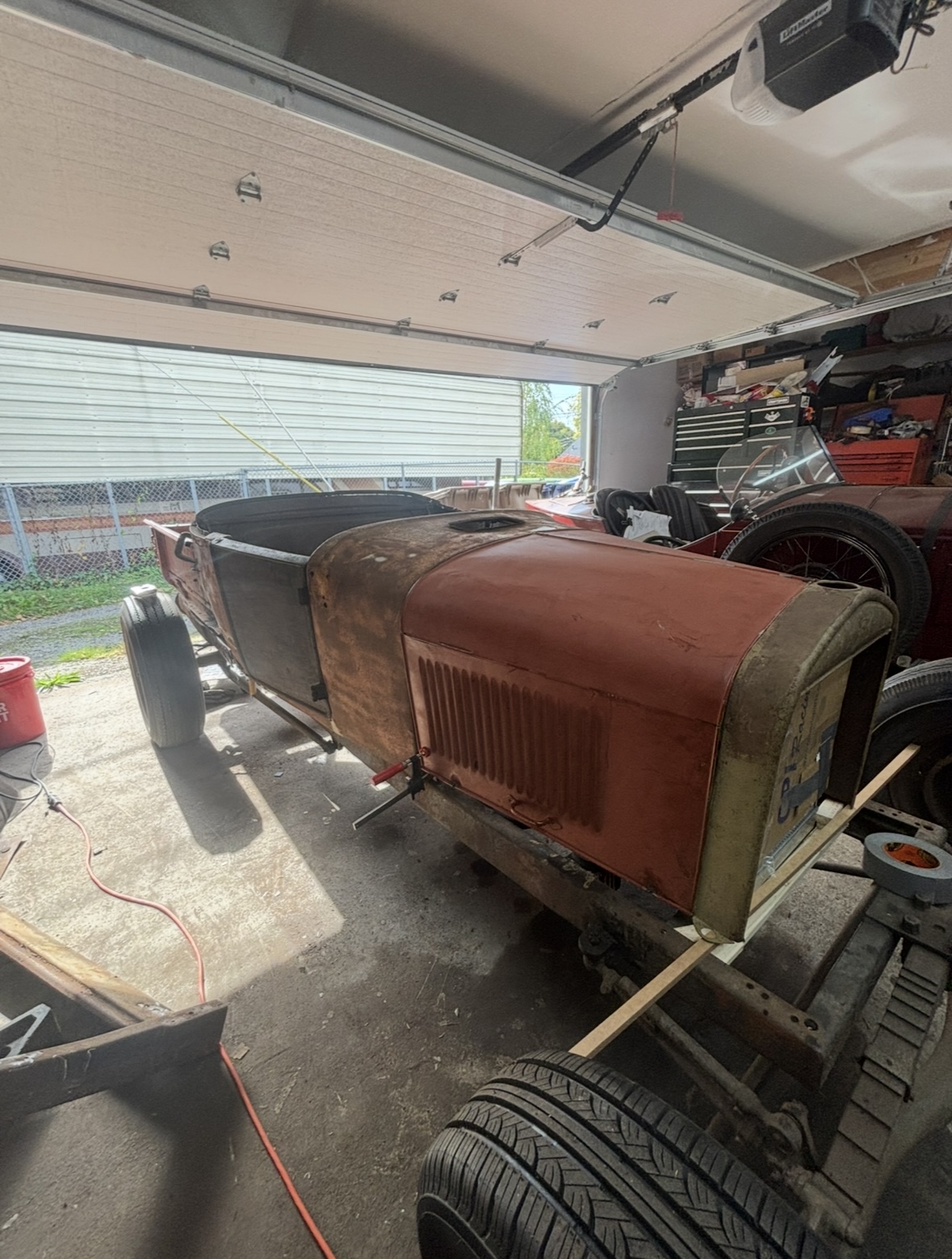

    IMG_1394.jpeg IMG_1393.jpeg I shipped out my ‘41 Ford coupe to SoCal last week and now have enough shop space to get going on the roadster pickup again. Early in the week I found an original ‘27 hood and the matching grill shell. The car was originally built in 1950 with these parts. I’d been debating on changing the look with a ‘32 grill shell, just because I like it, but have decided that preserving this car and bringing it back to its original state is very important. Especially now that I have the original parts.
    Also, a few weeks ago I snapped up another ‘27 roadster body in much better shape than what’s on the car. Particularly the cowl. The new body has the seat base in it, so that’ll save additional fabrication time. I did a quick mock up and pictures are attached.

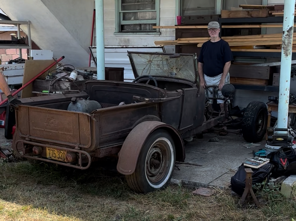

    Here’s a picture of the car as found. Quite similar. .

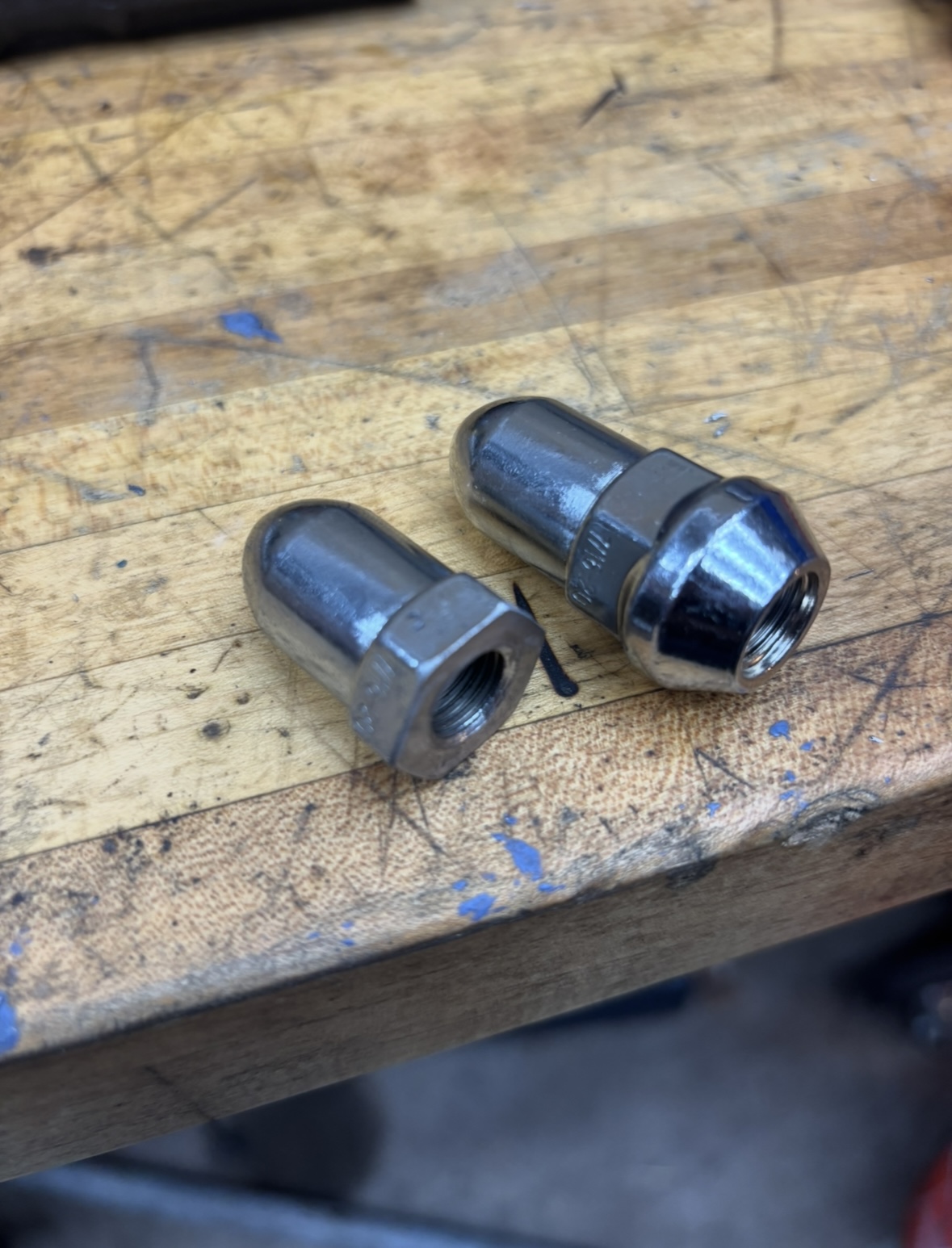

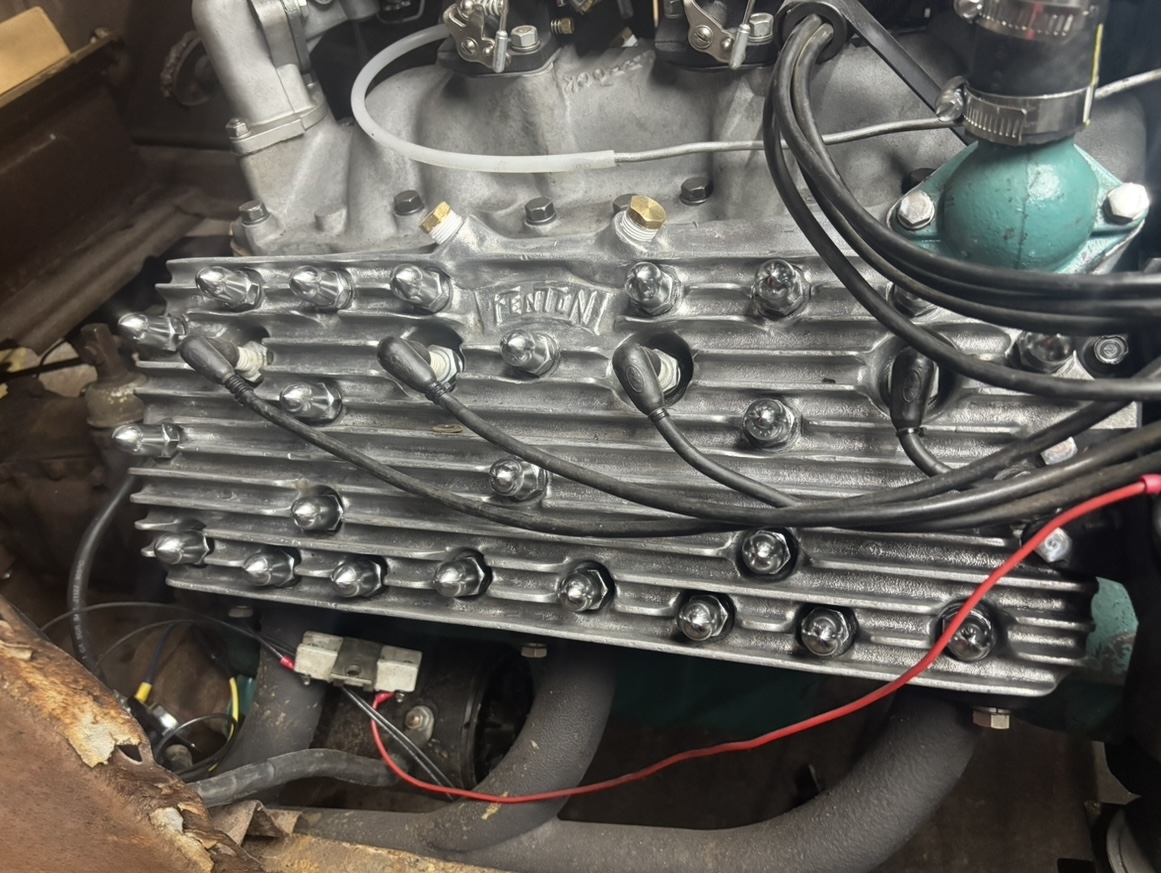

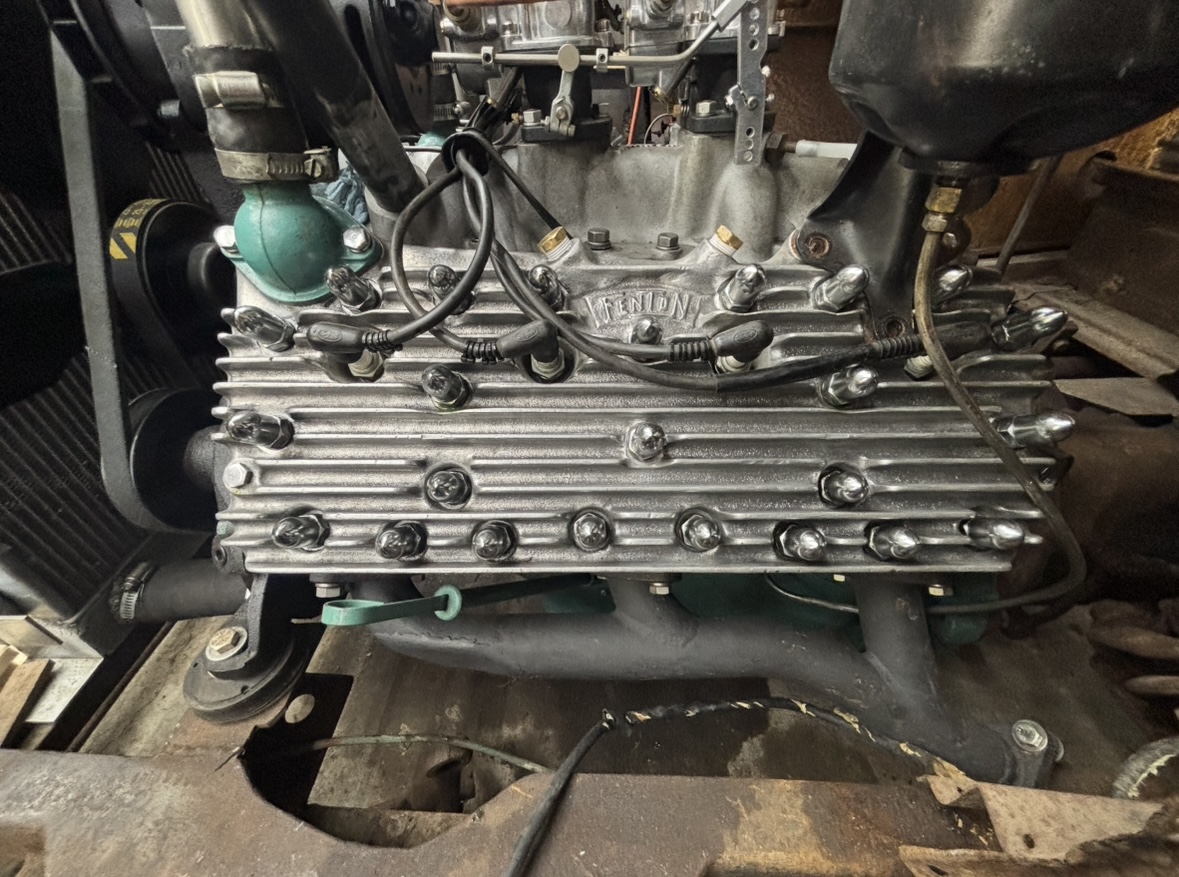

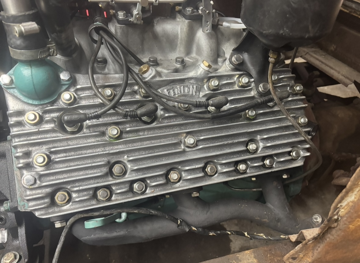

    IMG_3061.jpeg IMG_3062.jpeg IMG_3063.jpeg IMG_3064.jpeg A little EAB dress up for the McKindley hot rod project. I recently purchased a set of chrome snap on head bolt/nut covers, but didn’t like the idea of fake caps on the engine. So, after some research and a fair amount of lathe time, I came up with a solution. 7/16-20 chrome bullet lug nuts modified as shown. The real problem is that they have a 3/4” hex and I had to machine a thin wall socket to fit the nut and still have clearance between the fins of my Fenton heads. A standard 12 point socket split, so I machined another from a 6 point impact socket and it worked fine. The look isn’t exactly what I wanted, but feel it’s better than having the snap on covers.
    BigRRR and Tim like this.

    now i'm curious how they'd look cut off just to the 'flat ' above the taper--would leave a 'washer-face' nut...
