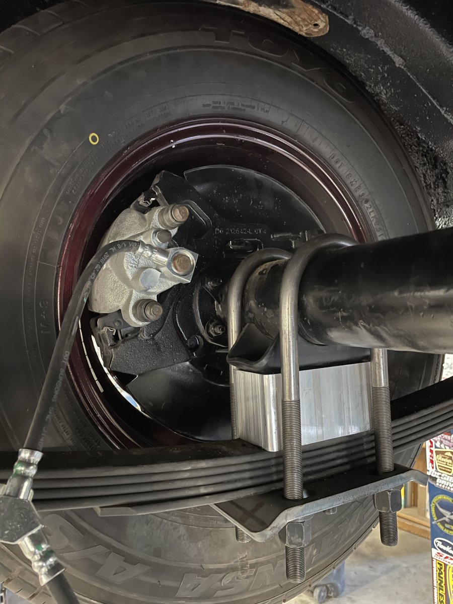

    118E502E-DBC0-4E11-B5C1-DBFFC12EB89A.jpeg F27CF37F-23F8-4D95-9A66-808431614F62.jpeg 725610FC-7A9B-4DD5-B7B0-132688ADE339.jpeg You guys were absolutely correct. I flipped them and it is ridiculously low now. She loves it, but it is sitting on the bump stops on the axle. I removed them to see if it was at the bottom of the stroke. It basically is but there is only 3” of travel between the axle and the frame. I doubt very seriously if a tire would come out of there if needed.
    I would either have to c-notch the frame or remove the blocks and go back to the 2.5” blocks, which seems to be the lesser of two evils. Good thing is, we have gotten good at it.

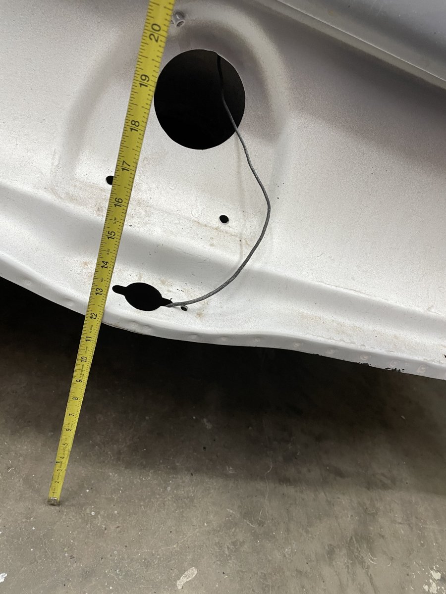

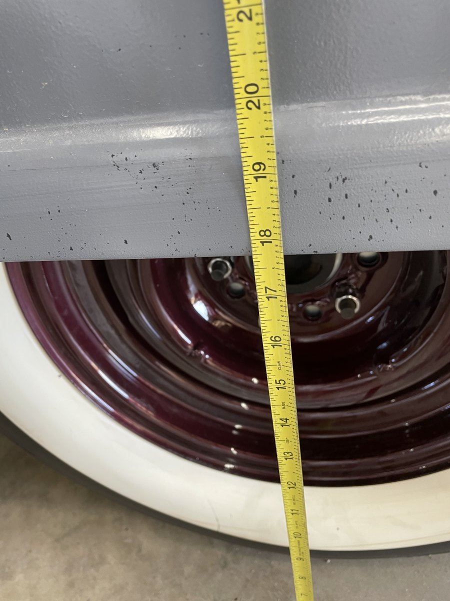

  12. Dos Cincos
    Joined: May 13, 2011
    Posts: 935
    Dos Cincos
    How does it sit now that the shackles are flipped with no blocks? Mine is sitting at 17.5" to the center of the wheel opening with worn out stock springs and 3" blocks. Just curious in case I ever have to replace my rear springs.
    loudbang and guthriesmith like this.
  13. Moriarity
    Joined: Apr 11, 2001
    Posts: 37,714
    Moriarity
    SUPER MODERATOR
    he has 4 inch blocks, simply add 4 inches to the measurement, so without blocks it would sit at 20"
  14. Dos Cincos
    Posts: 935
    Dos Cincos
    Thanks. That is where he was with the new springs, shackles flipped incorrectly, and 2.5" blocks. Should be sitting nicely with the 2.5" blocks and the shackles flipped to the correct position.

    Right now, the opening is at 16”, which looks awesome, but would ride like hammered ****. I’ll have the 2.5” blocks back in it tonight. I didn’t think it would take this long honestly.

    AA969430-29B7-42D6-ABB1-17EB6436FB84.jpeg 306864C0-F64B-405B-890C-59AF5ED55C17.jpeg D63316F3-A5F5-4CB9-BFA9-099A085CCCDC.jpeg 3CCDDD62-894B-4D33-972B-DA4EB18078DA.jpeg

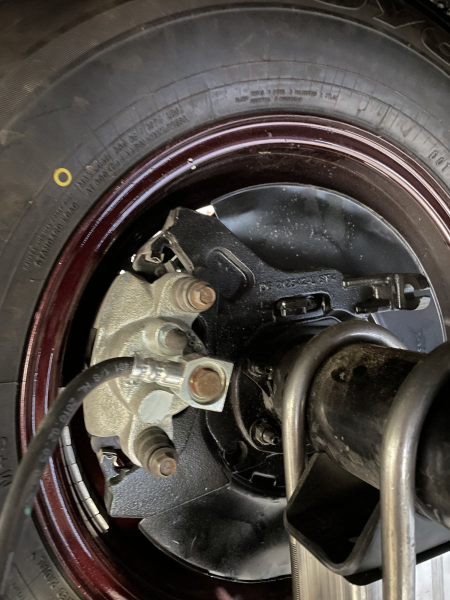

    So, here is the final ride height. She says it’s not an option to go any higher, so do whatever To make it work. Something is hitting on the down stroke, I think the bolts in the calipers are just grazing the frame on both sides. I may have to make some relief cuts for clearance. I have about 3.250” of clearance above the axle, so a C notch may have to happen. That’s with no bump stops at all installed.

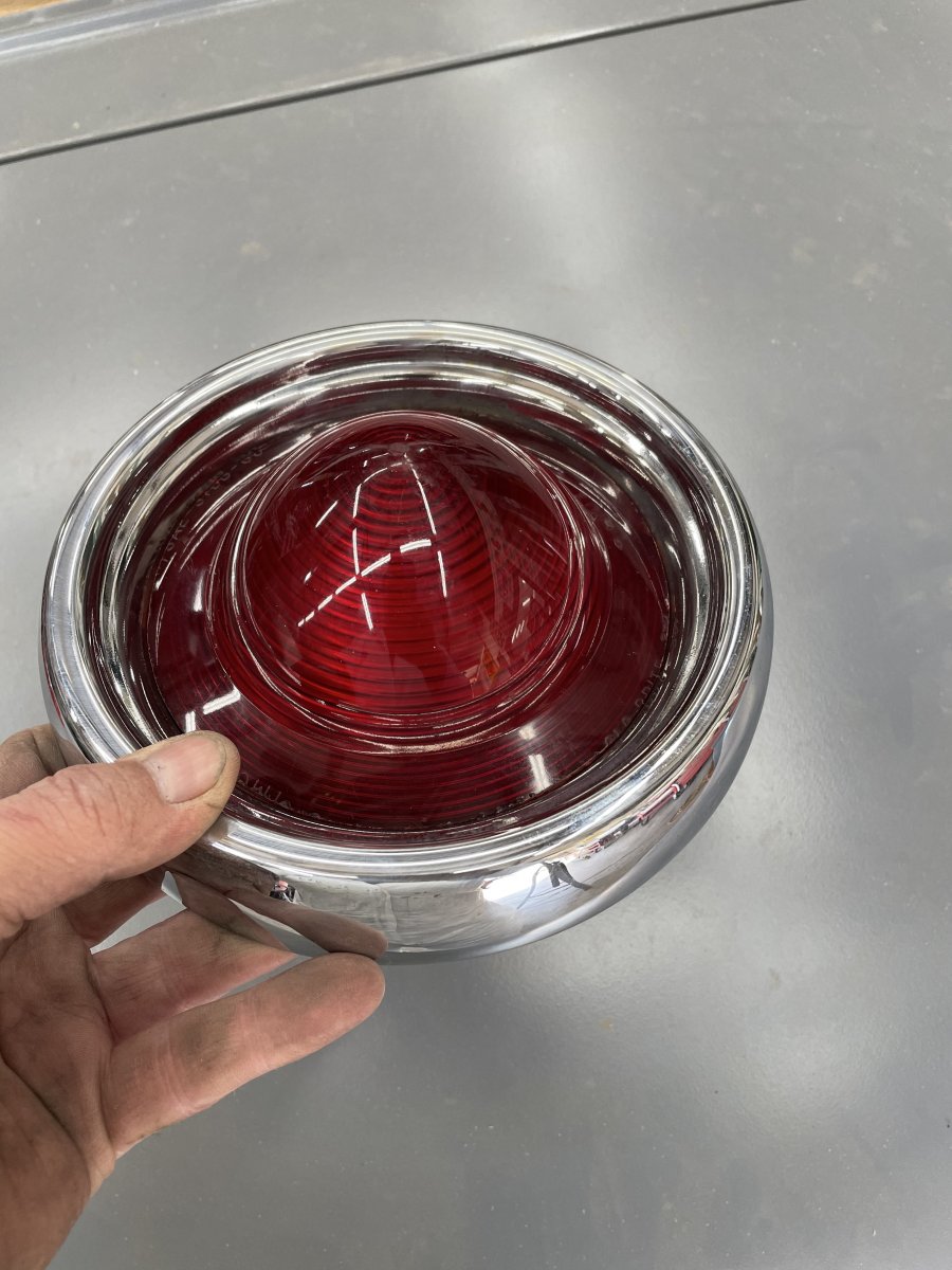

    So, we have been struggling with what tail lights to install. We have gone from Packard to Mercury Wagon, just about everything under the sun. We wanted something that looks like it is supposed to be there, but different from stock. Make people scratch their head wondering what happened.
    The Packard lights are great, but probably beyond my skill level.
    The Mercury Wagon tail lights are pretty dang slick, but they cost as much as a 4 post lift and would rather have one of those.
    Mama and I started perusing the little books looking for old articles about tail light swaps and we found one that was printed in 1957ish when the 57 Fords were brand new. A guy had taken a 57 lens and cut it down to fit a stock 55 ring. That was our answer, so we started digging through my old parts and found a bunch of NOS tail light lenses I had bought from a hamber 10 years ago when I had a 57 wagon.
    The trick was going to be how to cut them down without cracking them. So we decided to use an electric rope cutter. It’s basically a soldering iron with a blade. 313BFBFB-37A6-42D4-A015-1D178959D9E9.jpeg
    74D08F52-B4F9-47D6-8441-EAA425B3AC59.jpeg 062E47B6-5FCA-41AE-B34F-C3BA41294820.jpeg 96B9DE15-8DE2-4B02-9D10-CEB79A9ABF49.jpeg A65B6DC3-0249-4375-B8FF-BE71943FBCE5.jpeg

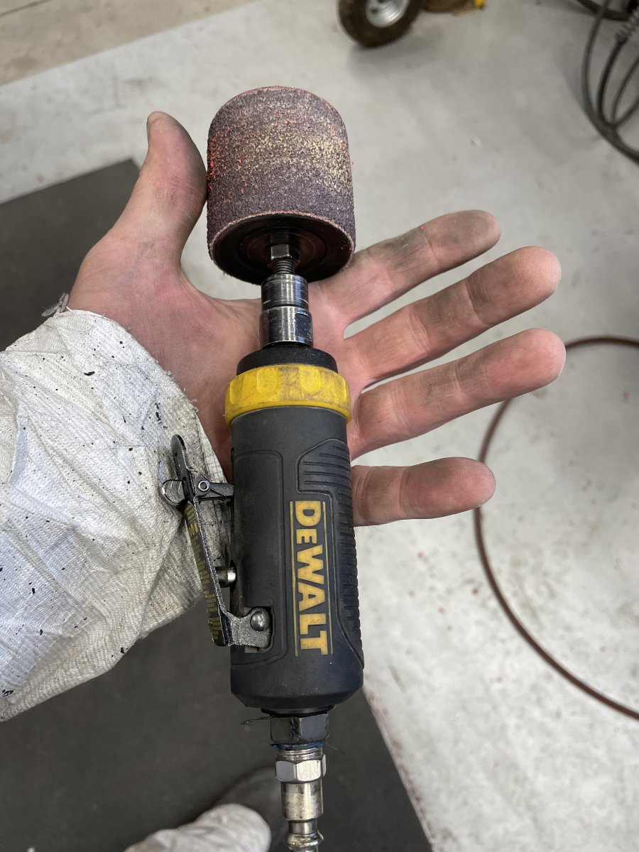

    Then she took a barrel sander on a die grinder to smooth off the melted plastic and finish up the final fit.
    Here are few pics for comparison of the original and the 57 lens before she started whittling it down. 8948ACF3-4135-4420-AC42-08E3E8047B94.jpeg
    This is it after she took a hand file to it and smoothed it all up. We just need to use a soldering iron to make the mount holes and then I will final ream it to size with a dull drill bit. I have about 412 of those.
    EF92A818-9E98-47C0-9CAA-1C923F04A778.jpeg 455A7836-48B2-4A50-9CF4-77BE8AA71110.jpeg
    Not bad and I have about $20 in these total. Changed the look of the tail light but doesn’t look hokey. The best part was Mama did it while I changed the lowering blocks for the 4th time.

  21. I did a quick Google search and see that there is a couple different locations for the Calipers on these. Do the caliper brackets bolt on to keep the wheel bearings/axles in the housing? If so can you just change the location by rotating the bracket to a different location? I've never had my hands on any 8.8 so have no first hand info on that.
  22. Roothawg
    Joined: Mar 14, 2001
    Posts: 26,033
    Roothawg
    It’s a 2000 Ford Explorer. As far as I know, this is basically it for mounting. They do not keep the axles in. They are like a GM 10 bolt.
  23. So the caliper brackets are welded to the housing?
  24. Roothawg
    Posts: 26,033
    Roothawg
    No Sir. They bolt on to a bracket. I can take some pics tomorrow.
  25. Maybe just a little rotation of the way it's mounted will be the cure?

    Here you go. It just grazes the side of the frame. It has taken off the paint, but not a lot of damage.
    D9C4E845-9598-43F2-AB05-DE69937AE1D4.jpeg E96CD817-16E4-43EB-B13B-62AE65D4D5DD.jpeg 7F06F97E-8C1E-4610-B040-61909C1A82AB.jpeg

    Brake lights look good! And, the ride height will be fine once it settles some. :D You wouldn’t want it any higher.
    And, what are those funny looking drums in the rear? Mine has no issue with stuff like that crashing... :rolleyes:
  30. Roothawg
    Posts: 26,033
    Roothawg
    Yeah, but mine will keep me from crashing.;)
    I still have to trim the U-bolts and paint everything. Just making sure everything clears.
