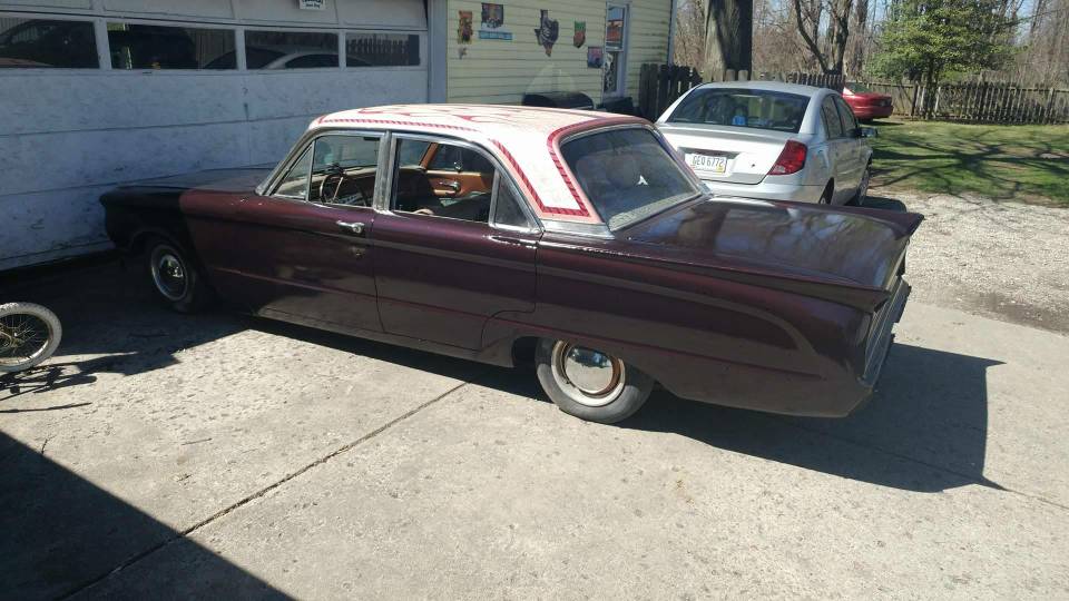

    Still have it. We painted it Black Cherry which was the original color. But did not take it down past the color that was on it. Tjat bit us in the ass. So tje grandson is doing the work to repaint. received_10209162027073227.jpeg Screenshot_2017-02-19-18-31-03.jpeg

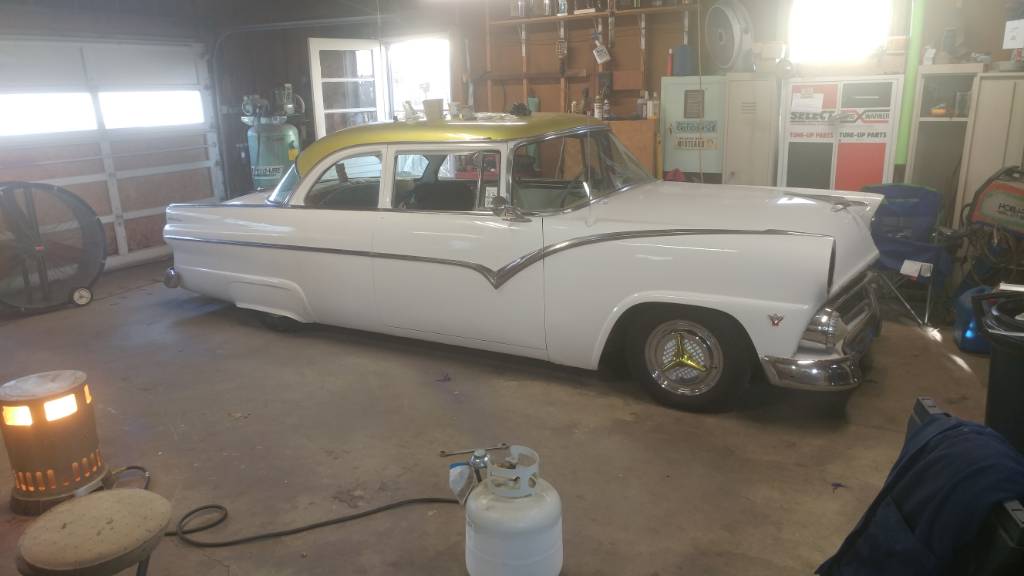

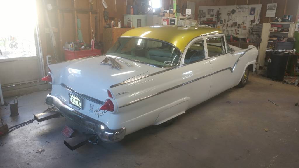

    I ordered rear springs yesterday. St Louis Spring is making a set of 4" drop for me. This weekend I am going to do some misc stuff. I dropped off the motor at the machine shop today. Should be back in a weeks. I need to make new patterns for the door panels and the package tray. Trying to multitask to keep everything moving forward.
    A couple of pics showing the contrast with the before and after. The exhaust shows how much the Connie kit was sticking out.

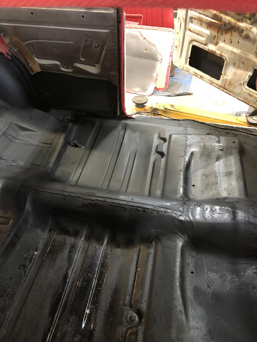

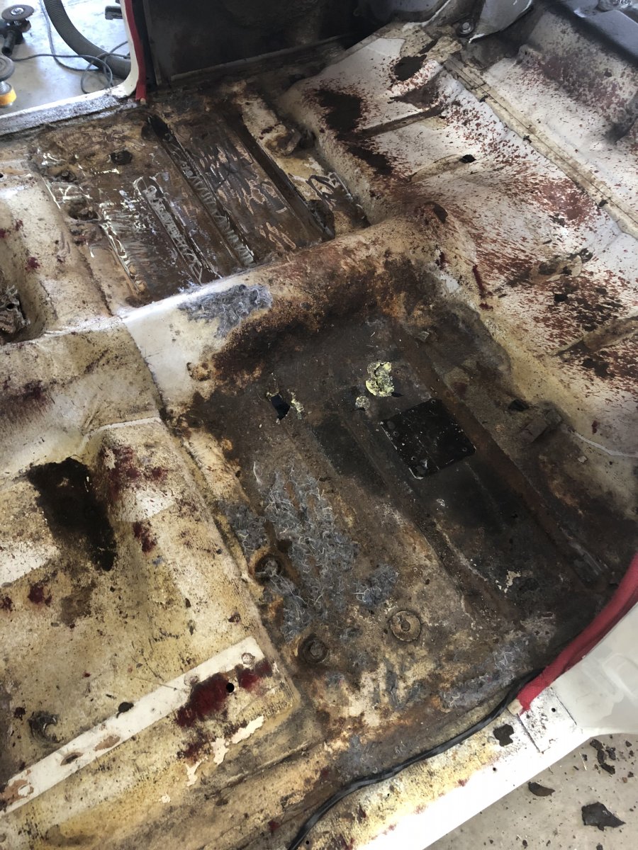

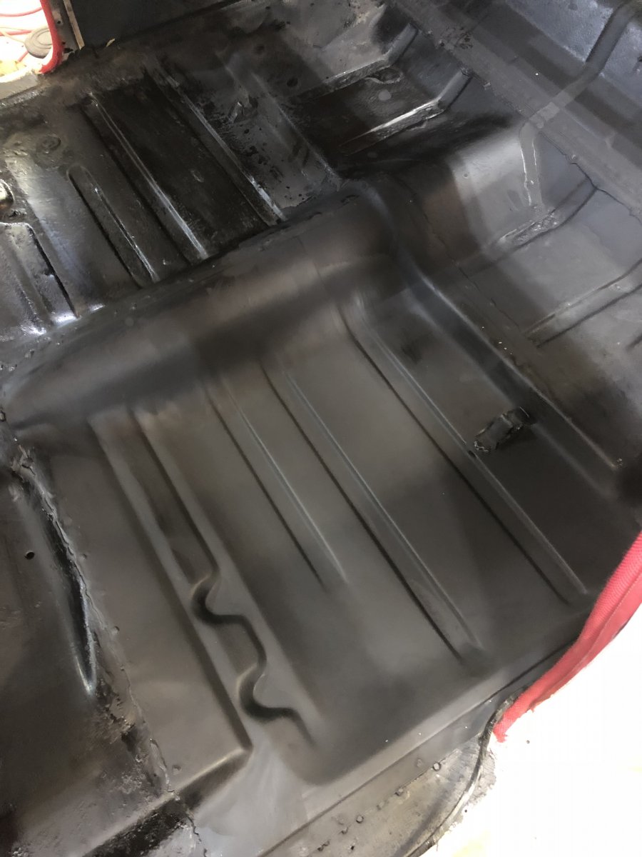

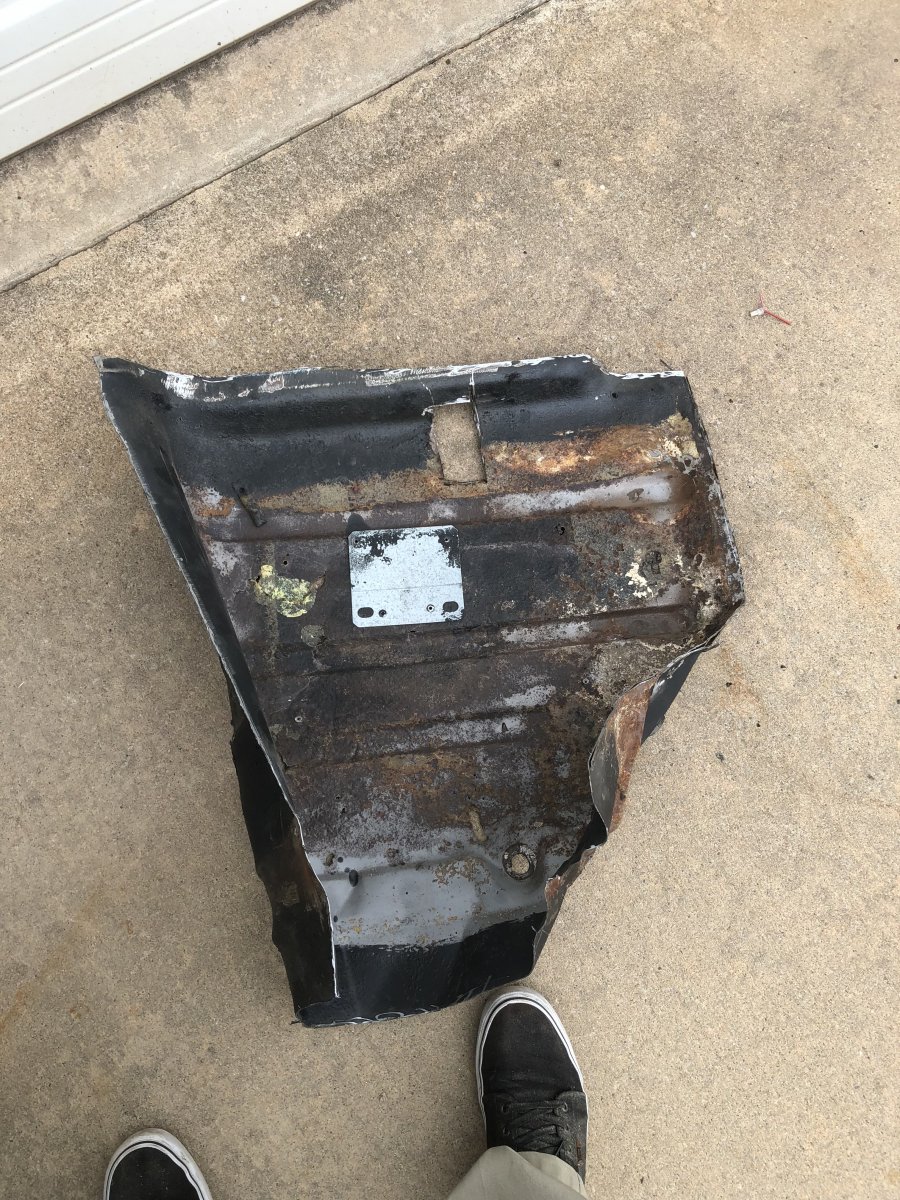

    So, I have been taking care of a few things. I pulled the interior and when I got the carpet out, the floors needed some attention. I ordered the drivers side rear floor pan from EMS. Good quality and fit. A little more money, but it sped up the install. I opted to blast the floor and change the pan. Then I used POR-15 and painted everything, including the trunk.
    73DDED79-638E-4F6C-8812-69C1E788408D.jpeg 96E58F6D-F1BD-48B1-9A26-8BC90BD52628.jpeg 0A290625-A56E-4E85-B065-CB70346BAB32.jpeg CDF193C1-6D02-42AA-BEA4-1995F6EAFB29.jpeg B6BE895F-9267-46C8-85E9-47733CC07F93.jpeg 7B88DEFB-76A5-4C45-A07C-1BEEE07E5AD3.jpeg

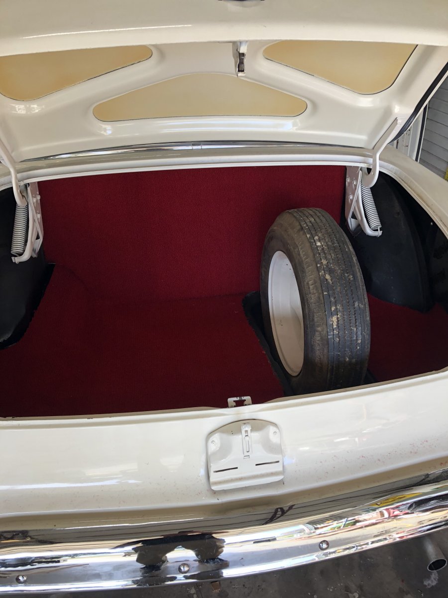

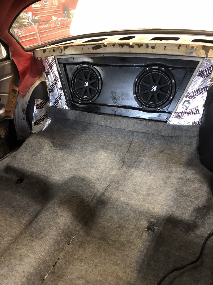

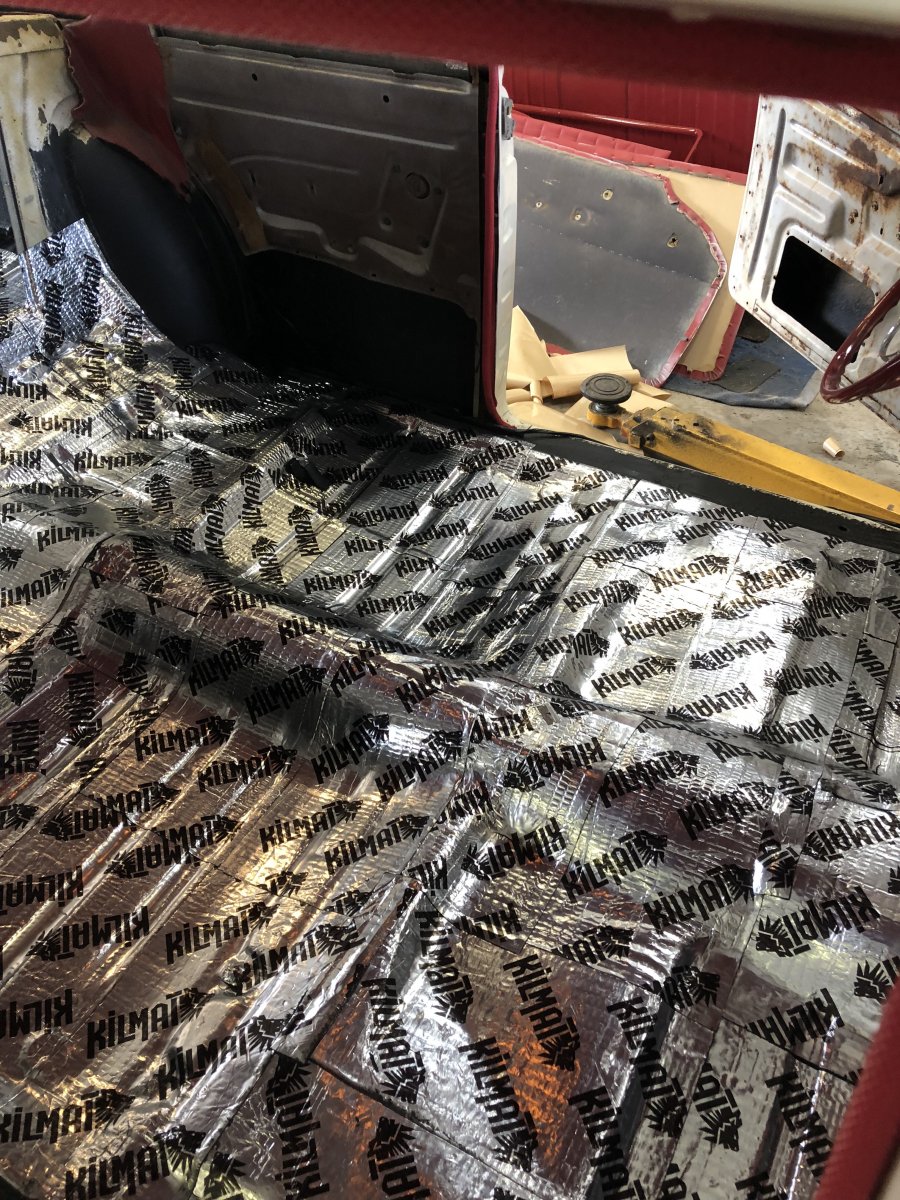

    I tried my hand at building a sound system. I am driving my audio buddies crazy. I’m no carpenter so, no jokes about my box. I built one to replace the cardboard divider between the rear seat and the trunk. I am not an audio guy, I just wanted a little bass, so I added 2, 10” subs behind the seat. I have 4, 6.5” Rockford Fosgate 3 ways for the rear package tray and kick panels. I am adding a Memphis amp, which I am still saving my pennies for.
    When I get it all done, it will be basically invisible. I am building a close out panel to hide the box in the trunk. The idea is to get it upholstered to match the interior.

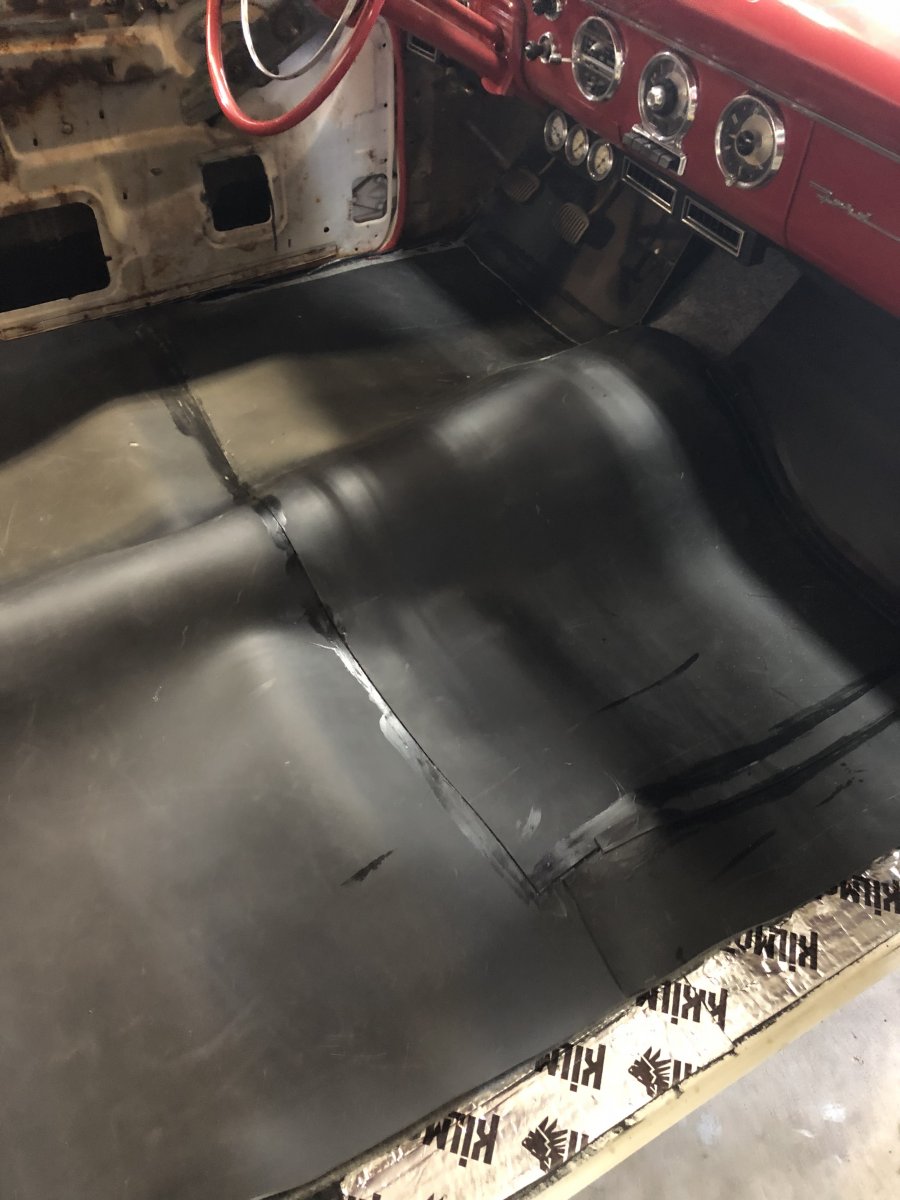

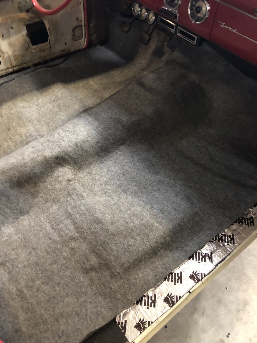

    88F36E50-C8B9-4157-AF97-E07D44ECF1F4.jpeg Been knocking around in the shop for the last few weeks. I added a layer of synthetic jute backing. Next is the layer of mass loaded vinyl. I picked it up on Amazon for about $120. It looks to be about .250” thick or so. The difference this will make will be susbstantial. The car had nothing but rust and carpet in it before. Anything I do will make it better.

    Been piddling in my spare time. Not a ton of progress, but I am juggling multiple projects at one time.
    I am not an upholstery guy by any stretch of the imagination, but I made a close out panel to hide the sub box in the trunk. Some day, I will get real upholstery. It’s better than the plaid plastic mat that came in it. I do have respect for upholstery guys. This is not as easy as it looks.
    I cut the mass loaded vinyl and glued it back together, sort of like a sewn carpet kit.
    It will make a substantial difference in the road noise, especially since the old carpet was glued directly to the floor with no insulation.

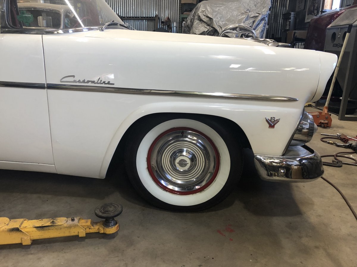

    D0541E35-539D-4059-8D58-4CB3FF8AE511.jpeg Before
    After
    I got a couple weeks off so I figured I would start trying to knock off some things in my. “To do “ list.
    I partook in the forbidden fruit, of which I can not talk about. Just know that while partaking in this forbidden fruit, I also installed the Aerostar springs. And threw the Olds caps on to see if I liked em. I think they are an improvement.
    I changed the shocks while I was at it. I have to finish replumbing the brake lines and a few other odds and ends. The stock rear end is shot and marks it territory, so a rear end swap is in the works for next week. I have a new set of 4” lower rear leafs to install at that time.
    It’s hard to see the difference in the shop, but it is an improvement. I'll roll it out after the rear end swap and try and get a similar pic, so you can see the actual difference.

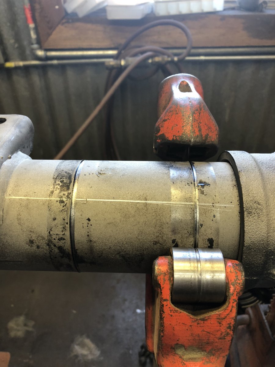

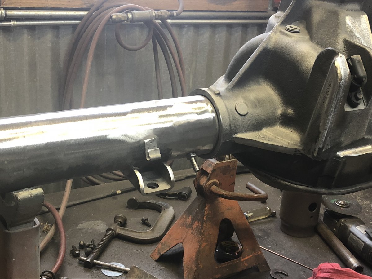

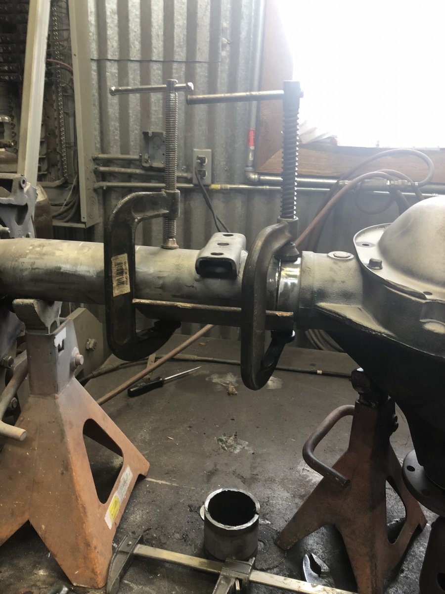

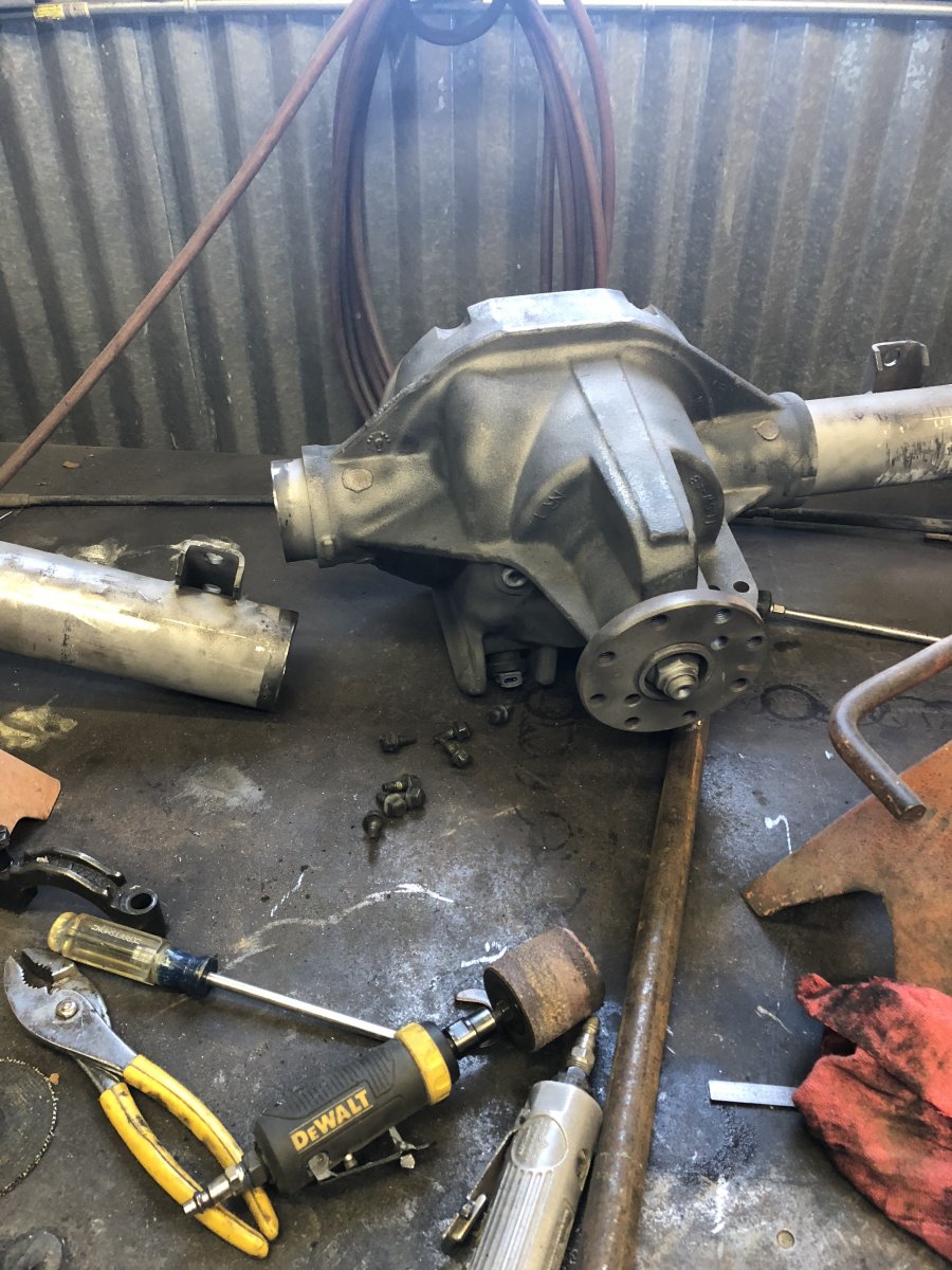

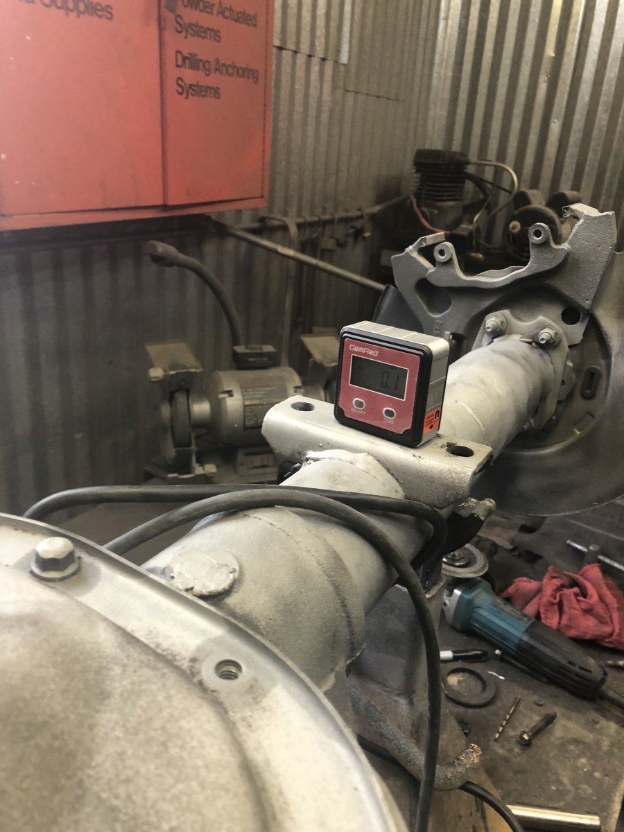

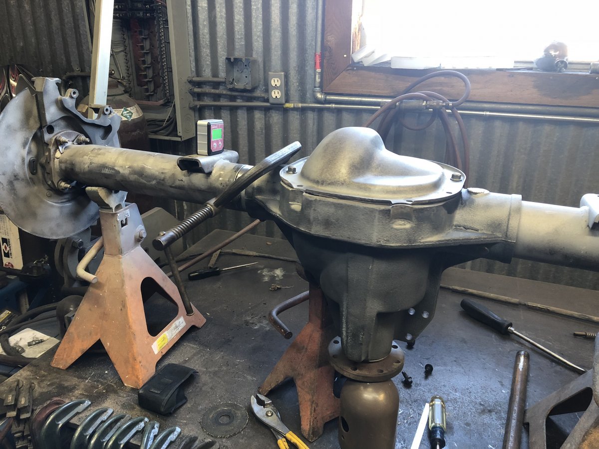

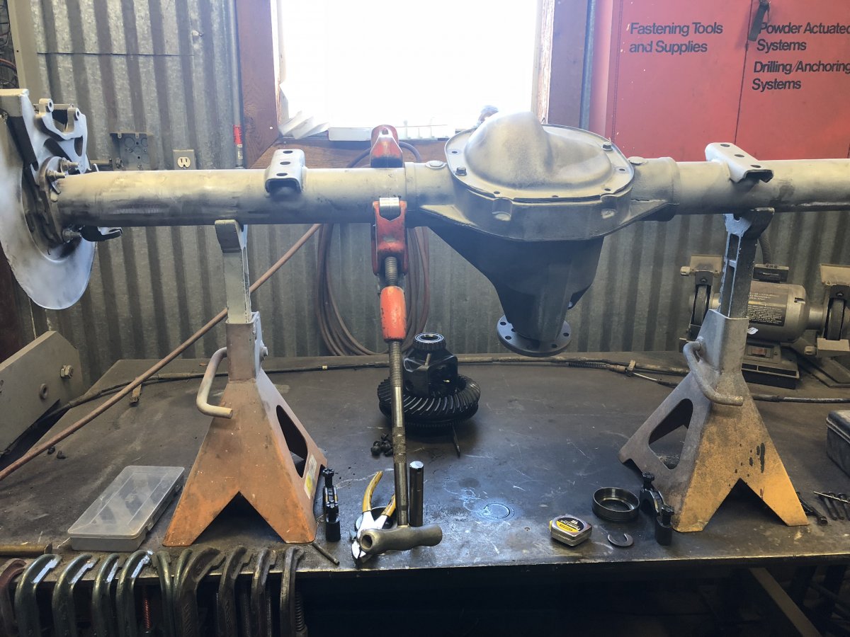

    34DCFB5D-C8A0-4E68-A5AE-CBEA6CAD6289.jpeg 4104AF38-DA56-45A9-83B6-C956230A644D.jpeg 55D34BFB-685C-4948-8424-2D6491784859.jpeg 52964F09-BF57-4669-AA5F-B5F277545BC6.jpeg 284F6A18-8E10-4F66-A427-03F9EF52A0A2.jpeg D36D5455-24D5-49ED-89F4-5D6E4D7C7730.jpeg 73D739B9-6B8D-491D-99FD-E399B9700818.jpeg So, haven’t had a lot of free time lately, but I did narrow the 8.8 Explorer for the 55. I bought a spare short axle. It’s about 3 inches shorter.
    I rented a pipe cutter to cut the housing. It makes it perfectly round with no distortion. It’s not a speedy process. I cut it up close to the center carrier to reduce warpage.
    I left the sway bar mounts for future possibilities.
