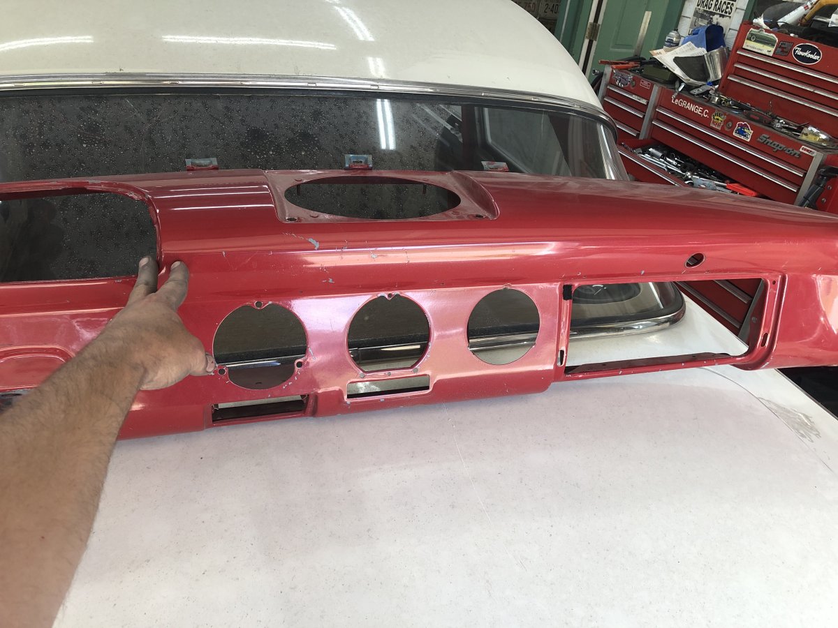

    Nothing major to report. I pulled the dash apart and blasted everything. Going to weld up a few holes and then I’ll put everything in epoxy primer and then paint. It will probably live in the spare bedroom on mama’s antique bed. Don’t tell her....

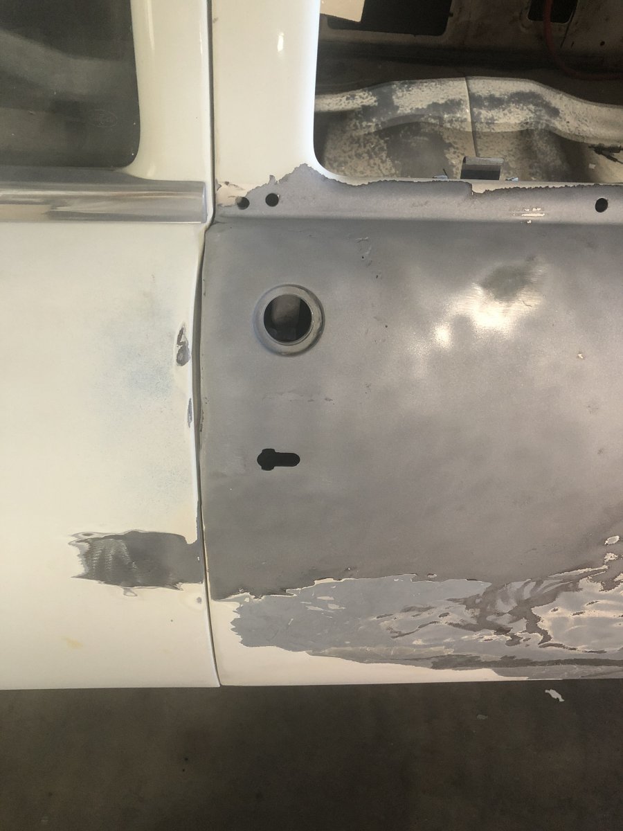

    551921B5-8A13-4542-BD1C-0BDF2F3A11A3.jpeg 19FD4E9C-486C-49A6-B9C2-066FEA796DF9.jpeg Not a ton of progress, but since the Okie Apache is gone, it frees up my evenings and weekends.
    I started frenching in a set of 1941 Lincoln door buttons rather than shaving the handles.

    Did you by the Lincoln door button french kit or make one yourself?
  7. Roothawg
    Joined: Mar 14, 2001
    Posts: 25,921
    Roothawg
    I bought it from the same guy that builds the buttons. Logictech. He's a hamber BTW. The only problem is the space inside the door. I ended up welding the nut to the frenching panel. I will have to screw the button into the door. Not a big deal when everything is new, but if I ever have to remove it, it may be an issue if any corrosion ever sets up. I'll use anti-seize when I assemble. I modified the stock latch, but I may buy new ones and modify them to increase their expected life.

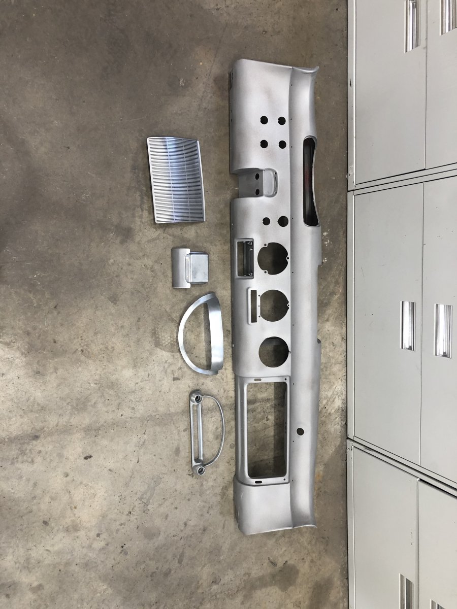

    Not much progress to note. Been filling holes in the driver side now.. Mama has been Captain of the blast cabinet for the garnish moldings. White metal is good.

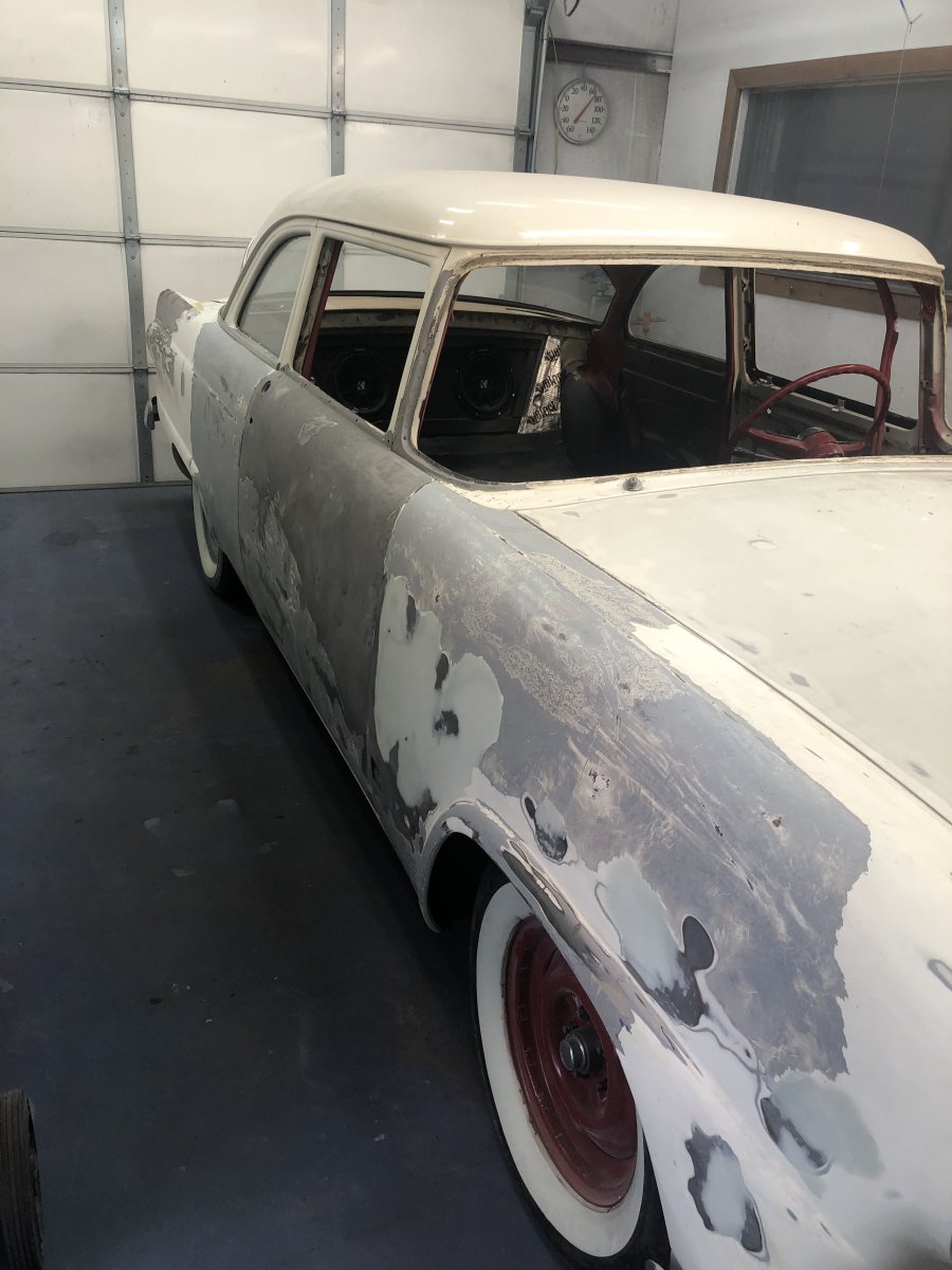

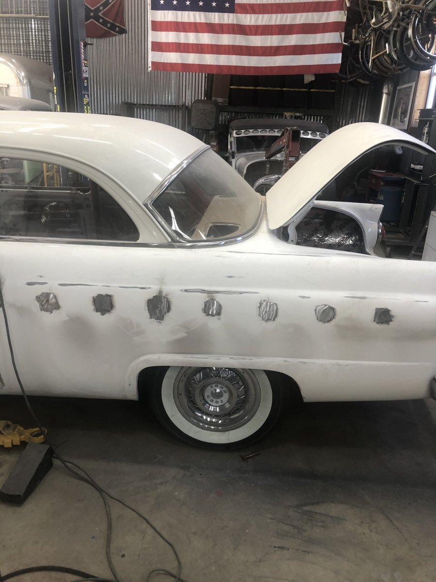

    E2BC1BC5-A92A-48A4-B1CB-EF8CAC111A96.jpeg 68E00C58-6BEC-45D0-B725-8DABDCD7340D.jpeg 60E02981-4029-491E-95D9-A886429F1A18.jpeg Not a ton to report. We filled the rest of the trim holes on the driver side.

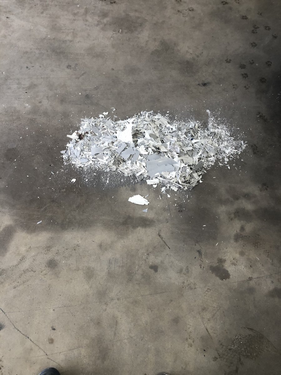

    Then we started playing around with scrapers. I was gonna just DA the whole car, but the paint that is on it, is probably 20-25 years old. That means it’s brittle. I would hate to spend all of this time and effort on bodywork, to have it let go at the car wash.
    This is about 4 hours work with the wife on one side and me in the other with putty scrapers. Saves on sandpaper, anyway.
    All of the previous owners bodywork on display. Nothing terrible to speak of.
    we may take off a couple weeks and thrash on it around Memorial Day, since the COVID 19 crap screwed up my vacation plans.
    This was a running, driving car. I'm an idiot.
