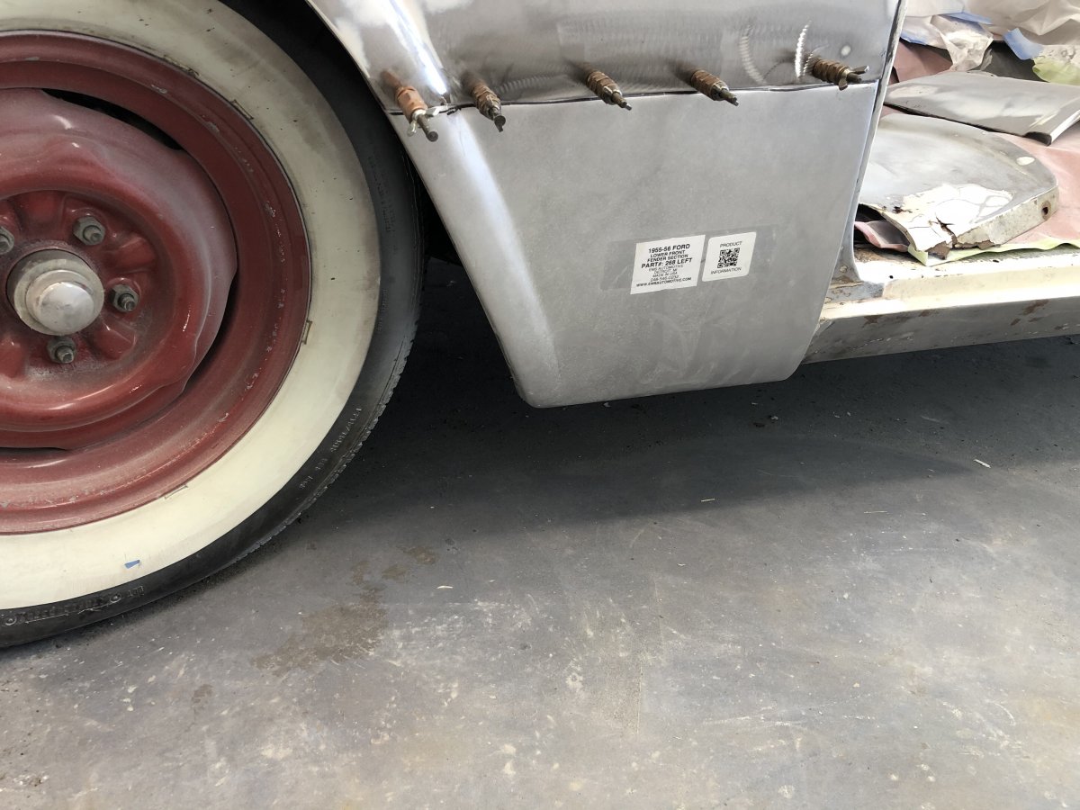

    Ohhhh, I dunno. They look right, but the trim is in an odd place. Is that at ***us place?
    loudbang, Sancho and chryslerfan55 like this.
  2. Moriarity
    Joined: Apr 11, 2001
    Posts: 37,714
    Moriarity
    SUPER MODERATOR
    yup, send him a pm and get him to measure em for ya,

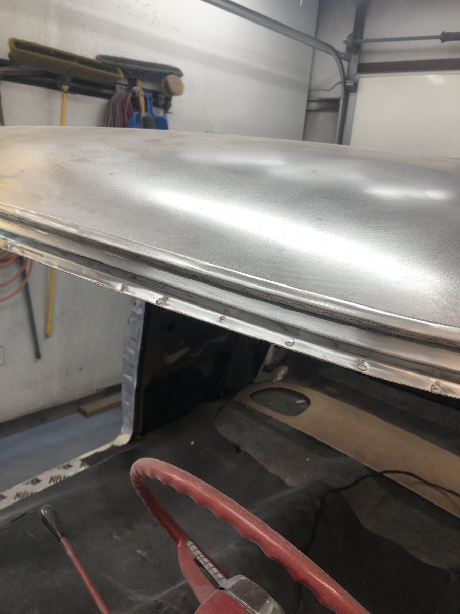

    Day 5 on the Memorial Day thrash:
    Very little visual progress.
    Most of the day was spent trying to strip paint around the window frames etc. a lot of the hard to sand areas. This takes an enormous amount of time. It will pay dividends later. It just gets discouraging. The goal is to get the whole car sanded tomorrow and then lay some primer down.
    D904283B-543D-45F2-9DA5-F73DDEF2CAF0.jpeg 2D232487-7057-4F11-A2CD-CC1197C4D588.jpeg 6AEEFBCE-5CB8-43F3-BFD5-B35C4C35FDBF.jpeg
    It takes a while to cover this much ground with a 2” Roloc disc.
    I knew if she had enough time she would eventually want to pull the rear windows. I was right. Today she was looking at the slight delamination around the edges....”We should change these, since the rest of the car is going to be nice”. Out they came. What a mess. The rear quarter windows don’t have much room in the quarter panels for maneuvering. We will grease up the regulators and get it ready to install.

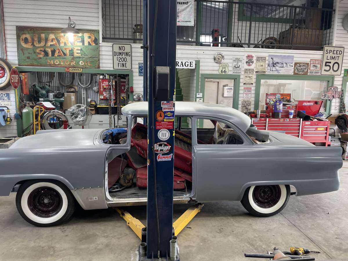

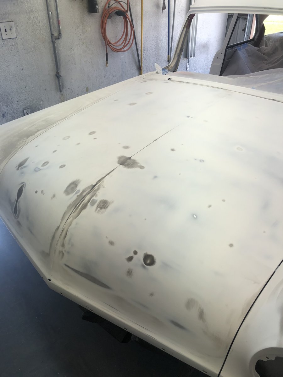

    Day 6 of the Memorial Day Thrash.
    We have visual progress, but man do the Imperfections stick out. Starting to build back the other way now. 3 qts of sprayable material.
    There is a ton of surface area and my gun started acting wonky. 20+years of flawless service from my old Sata 2000. I may have to have some sort of memorial service for it.
    Now the guide coat and block sanding party begins!

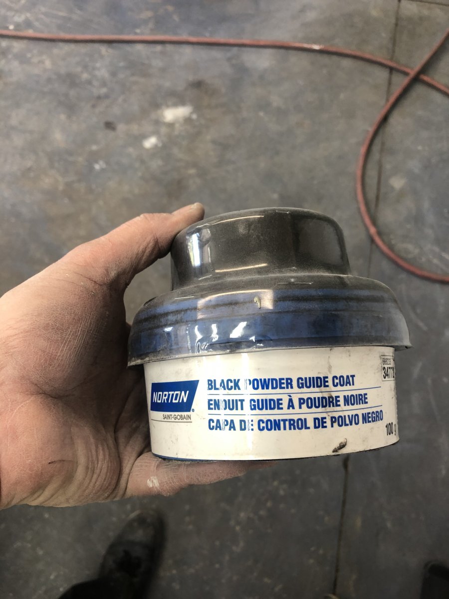

  5. loudbang
    Posts: 40,347
    It's been awhile so bear with me, is light color primer now "the thing"? Back in the day we used the darker primer on bare metal which in my opinion you could see, after sanding, any high spots easier because the shiny metal spots stood out from the darker primer.

  6. Roothawg
    Joined: Mar 14, 2001
    Posts: 26,033
    Roothawg
    I try to use a similar color primer for the end paint. It covers easier. I'll guide coat this and then the darks will be left in the lows.

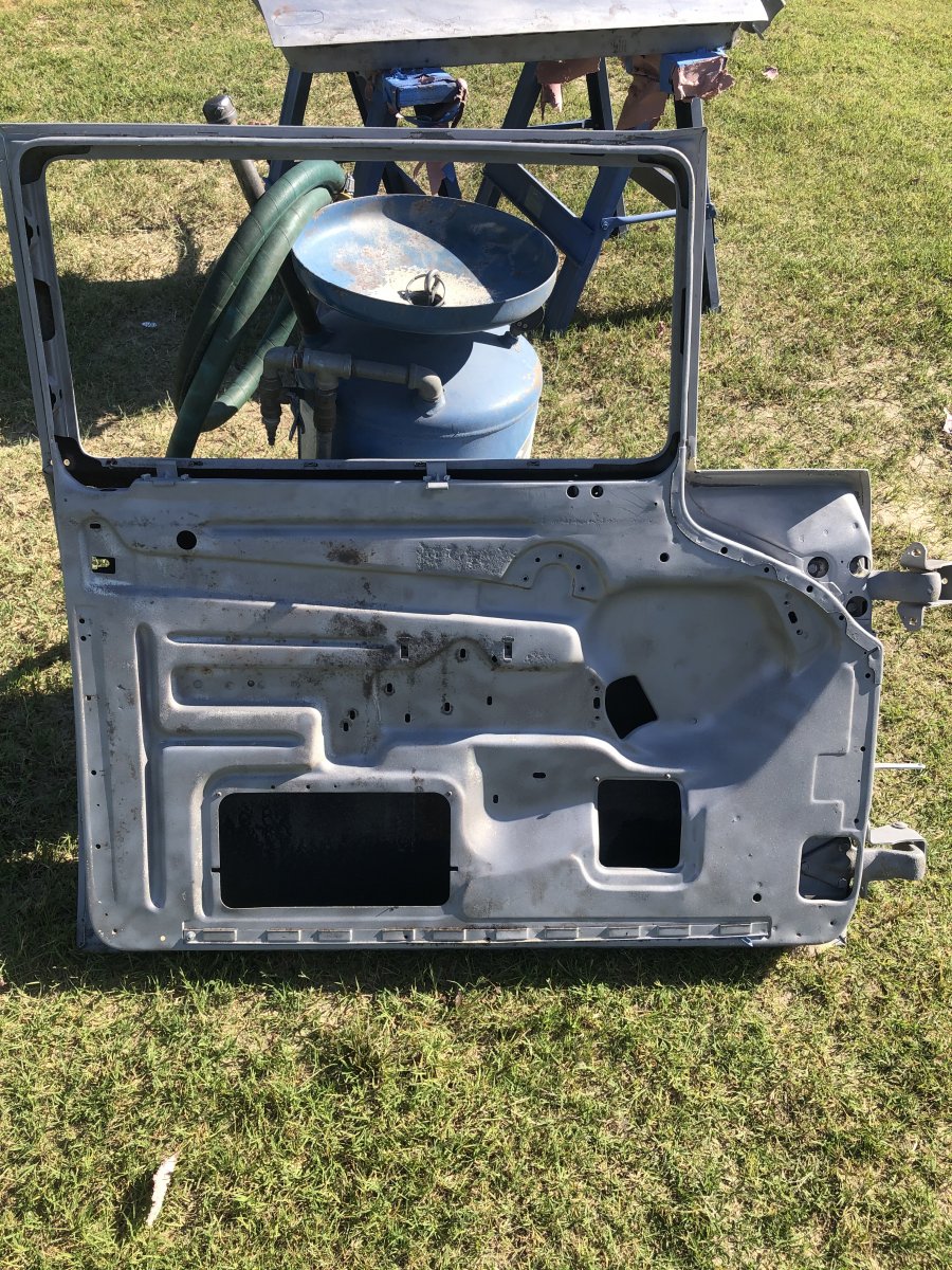

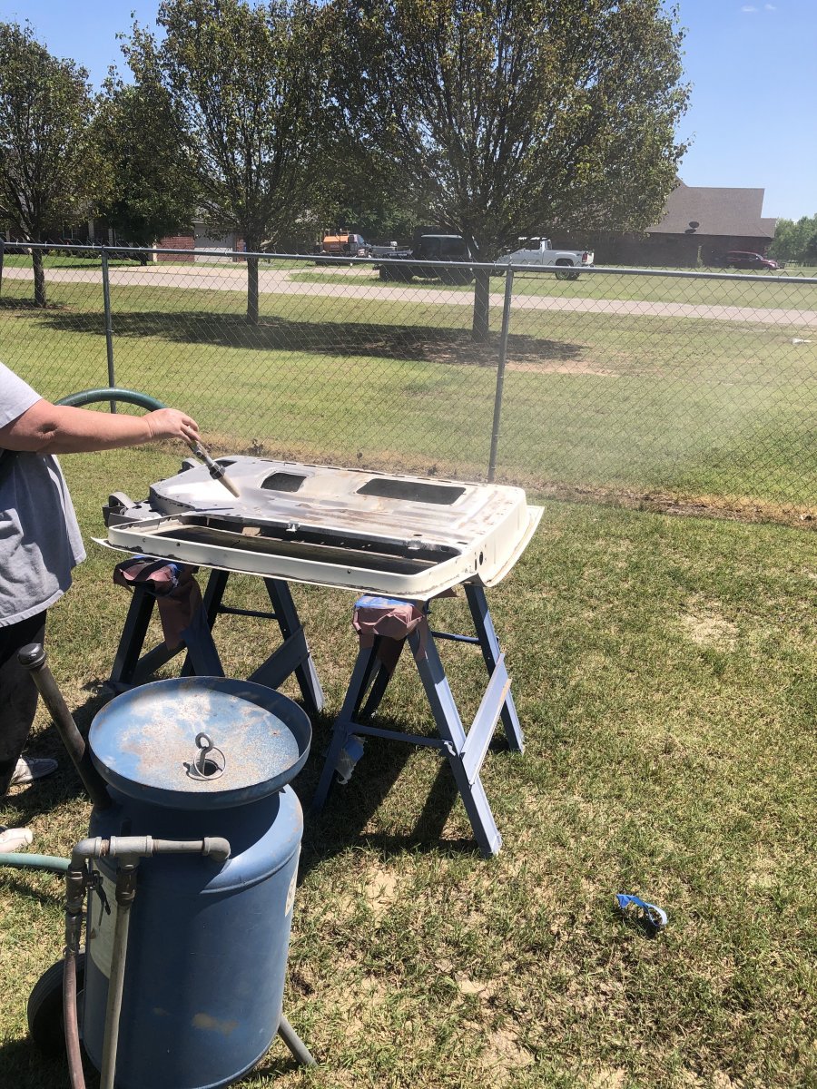

    Day 7 of the thrash: Started blocking today And the wife wanted to sandblast the insides of the doors, so who am I to argue?
    I posted some pics for my buddy @loudbang. This stuff is what I use to show the lows etc. it’s made in South Africa. I think it is just coal dust, but I can’t prove it. 77671894-9FDD-4232-B593-6223B352D2A0.jpeg 5E566649-C92F-46F3-B559-137E28EB57E2.jpeg 189B8B5D-261B-4FEA-8771-6BA5B0A72385.jpeg B8CCD2A0-1585-420F-90FF-B149A88184C2.jpeg CBABC40B-7205-4392-A108-C2792C675CCC.jpeg

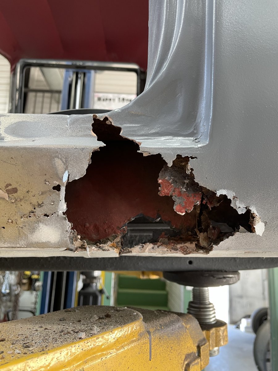

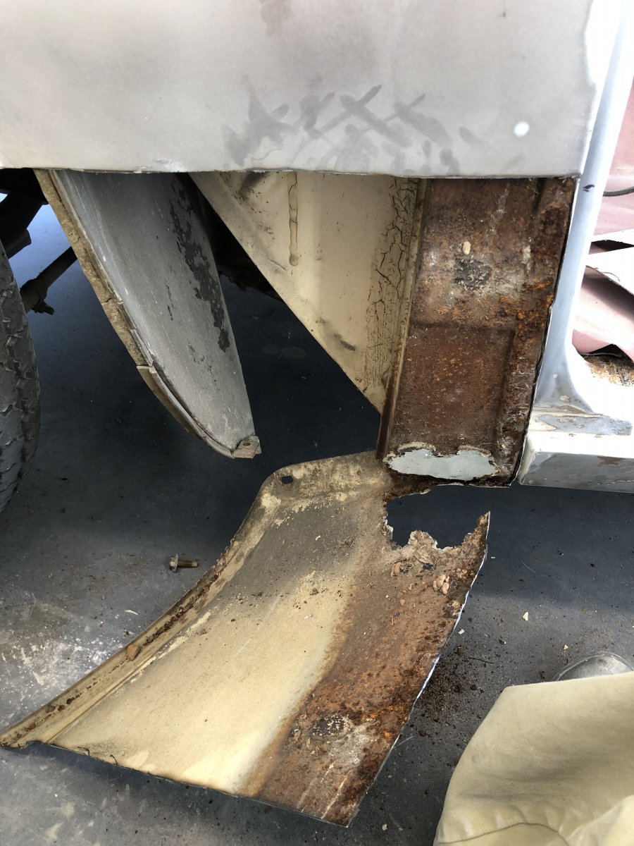

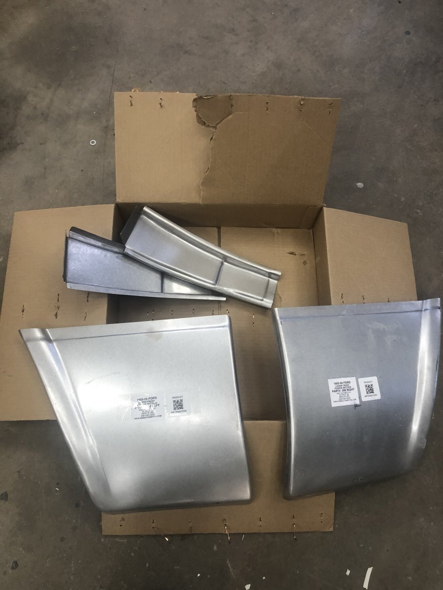

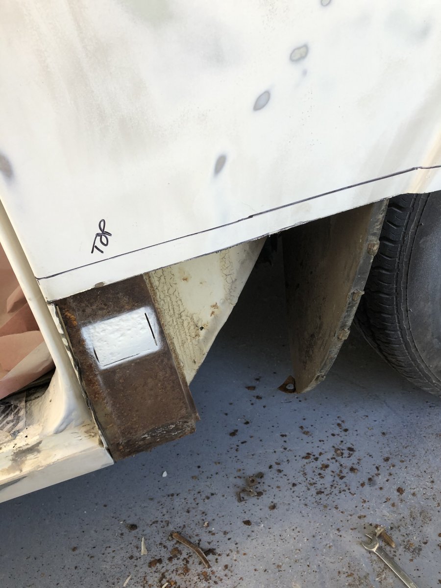

    Today was day 8 of the thrash. We affectionately call it **** day.
    Lots of blocking and I started cutting the lower fender out for the replacement panels from @ems customer service. They fit so much better than the China Charlie ****. Thanks for putting out a good product.
    The previous owner obviously thought that filler fixed rust....
    I’m scared to dig into the rockers.
    We have been looking sort of homeless lately, doing all the blocking, so we figured we might give panhandling a shot.

  9. ems customer service
    Joined: Nov 15, 2006
    Posts: 2,654
    thanks for buying from EMS. we are going to add your photos to tech section of the ems auto web site

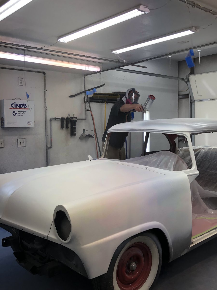

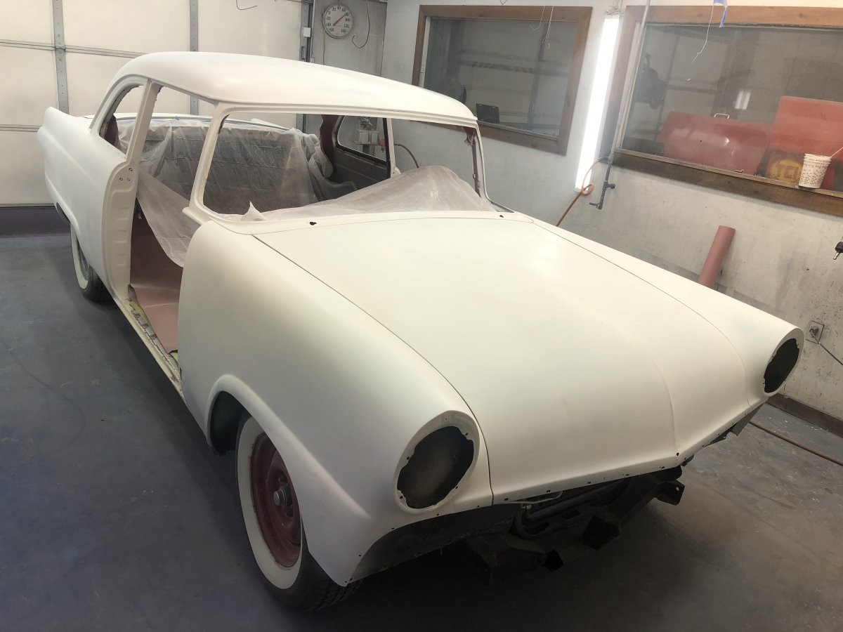

    So, we have been going out after work and blocking the car this week. The 9 day thrash kinda ****ed the life out of us for a bit.
    We had a little primer left over, so we decided to go ahead and spray a coat, so we can add more guide coat and continue blocking.
    It gets sort of overwhelming trying to figure out where you are at times. Not much to see.
    We found some more hidden treasures from the previous owner/sculptor. I ordered rockers yesterday. I’ll post pics when we decide to tackle that nightmare.
    Primer is kinda thin.
    Poor people have poor ways....

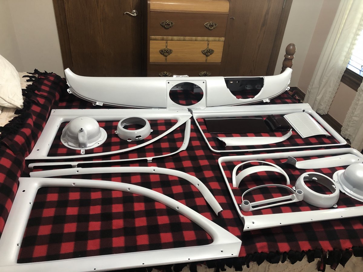

    I did paint a few pieces after mama ran them through the blast cabinet. Makes me feel like we still moving forward. At least that’s what I tell myself.
    196C7800-2F5D-48E7-8290-9DCED12C19E0.jpeg 84B2B2CE-BDDC-4EA0-9985-0E9DC781127F.jpeg
    She made me put a blanket down on top of a bedspread....for safety, you know. Running out of room quickly on the antique bed.

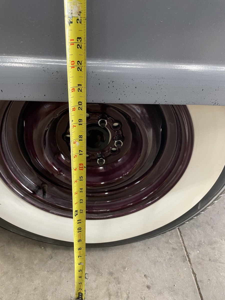

    B199F323-7197-436A-A115-C56132DB4FD3.jpeg Been on a sabbatical lately. Decided to do something today, even if it is wrong.
    So I decided to start the rear end swap.
    Figured I would take a few measurements for reference.
    0535517B-0BBC-4D23-8191-146A37B7066B.jpeg 348C3E5B-5EF8-401C-BE07-2AD790684F48.jpeg
    Dropped the rear end out, had to order the bushings for the new springs, so I am on hold for a day or two. I need to power wash the bottom side while everything is out of the way.

    So, my nephew came over today and I showed him why Bondo is not a solution for rust.
    This was the old fill it with caulking first to give the filler something to back it up. The guy actually spent the time to paint the inside of the rockers, like he was doing a real repair.

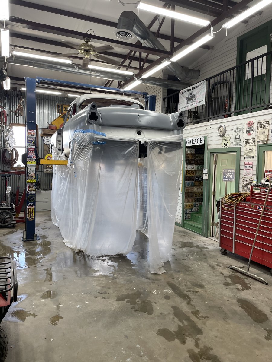

    So, I built a tent and donned a Tyvek tuxedo. Decided to power wash the bottom side of the car. I figured that since the rear end, fuel tank etc were out of the way, It would be a good time to clean it up and put my signature move on it. Raptor bed liner. I should own stock in this stuff. It makes a huge difference when you have to crawl under it and you don’t have dirt and crusties falling in your eyes. It’s hard to see a lot of difference in the pics, but it is a lot cleaner. C05FFB6A-5448-4C44-A6CA-4D5845208F83.jpeg EEC2438C-77F9-4C07-AA9E-5C98DCFCCBD3.jpeg
    I hit it with a weed blower to help speed up the drying process. I’ll probably wait and spray it tomorrow, make sure it’s dry.
  28. Roothawg
    Posts: 26,033
    Roothawg
    This will probably just look like more of the same. Hard to see under here. Pics after Raptor was sprayed.

    Well, today was semi productive. We put the rear end in and mocked everything up. We installed the supposed 4” dropped springs from St. Louis spring company. (I think the company has changed hands, because I called to ask a question about the springs I bought and the guy was a super *****) The car actually went up an inch.
    Now in their defense, the old springs were shot, and we are running a 205/70-15 tire, so that played a part. I had a set of 2.5” blocks laying around, so we tried them. Better, but that just made the car level.
    The springs feel pretty good. The ride will be much improved. I may look at a taller block, mama wants a tail dragger.
    518DC412-93AC-45C5-B6EF-EB23A50F2DFC.jpeg A293CE0A-15A1-49B5-A983-171A81238A65.jpeg
    If you remember, I swapped over the front springs with the Aerostar springs. I am sure the springs will settle a bit, but not enough to keep mama happy. Happy wife, happy life.
    Also, for the guys wondering about the Explorer rear end swap, it was perfect. I shortened the one axle, that you can see previously on this thread.
