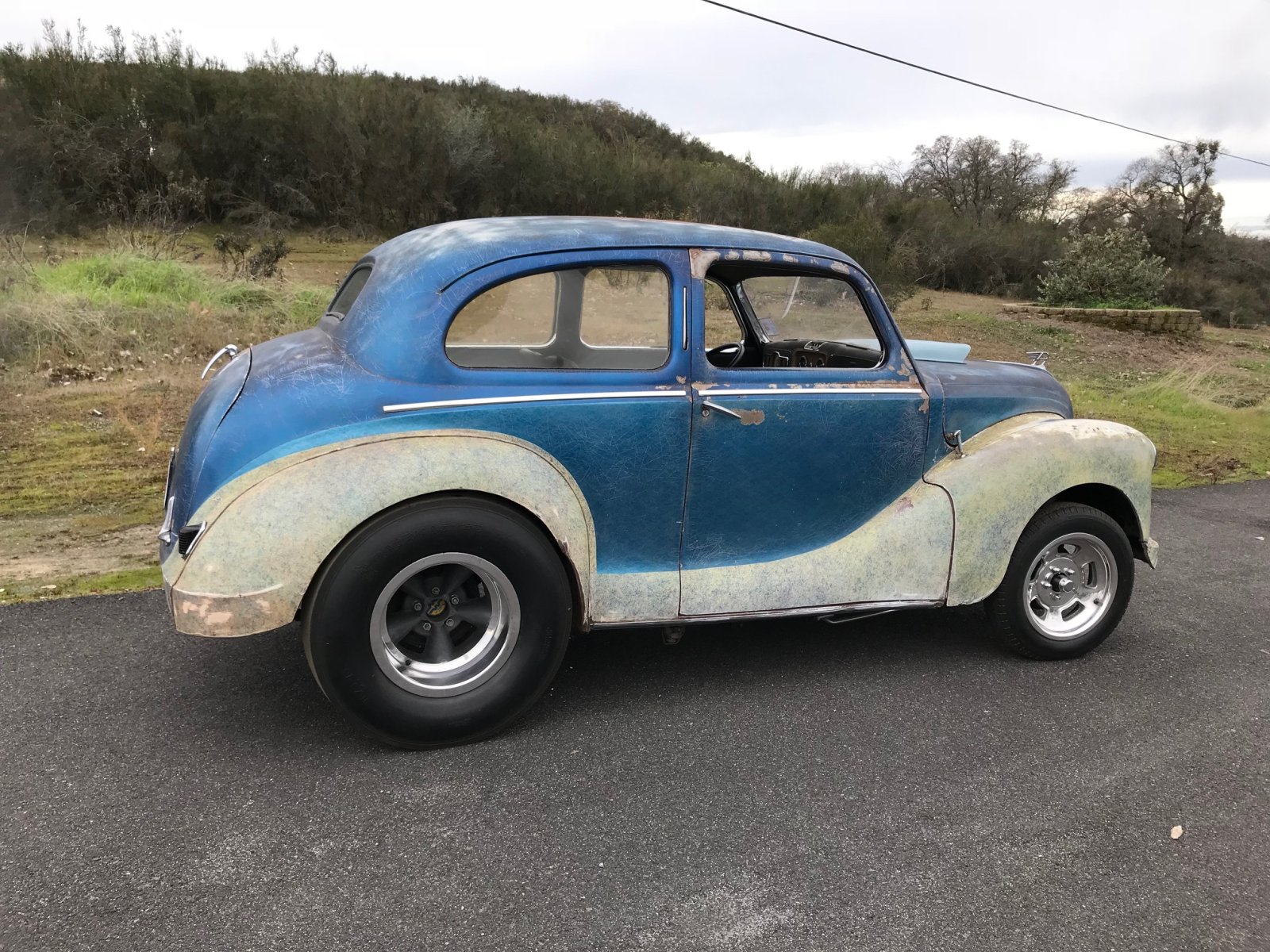

    There’s the Austin g***er that I took in trade when I sold my ‘31 Tudor. It replaced the Willys pickup that I built and intended to finish in retirement. I always liked Austin g***ers and I fit better in it. I replaced the mild SBC with a blown 355 and fixed some very shaky previous modifications. It’s licensed and insured and has gone to our local cruises as well as Bakersfield and Eagle field. Joey U found it interesting enough to put in Rodders Journal. Built around 1964, no history has been found.

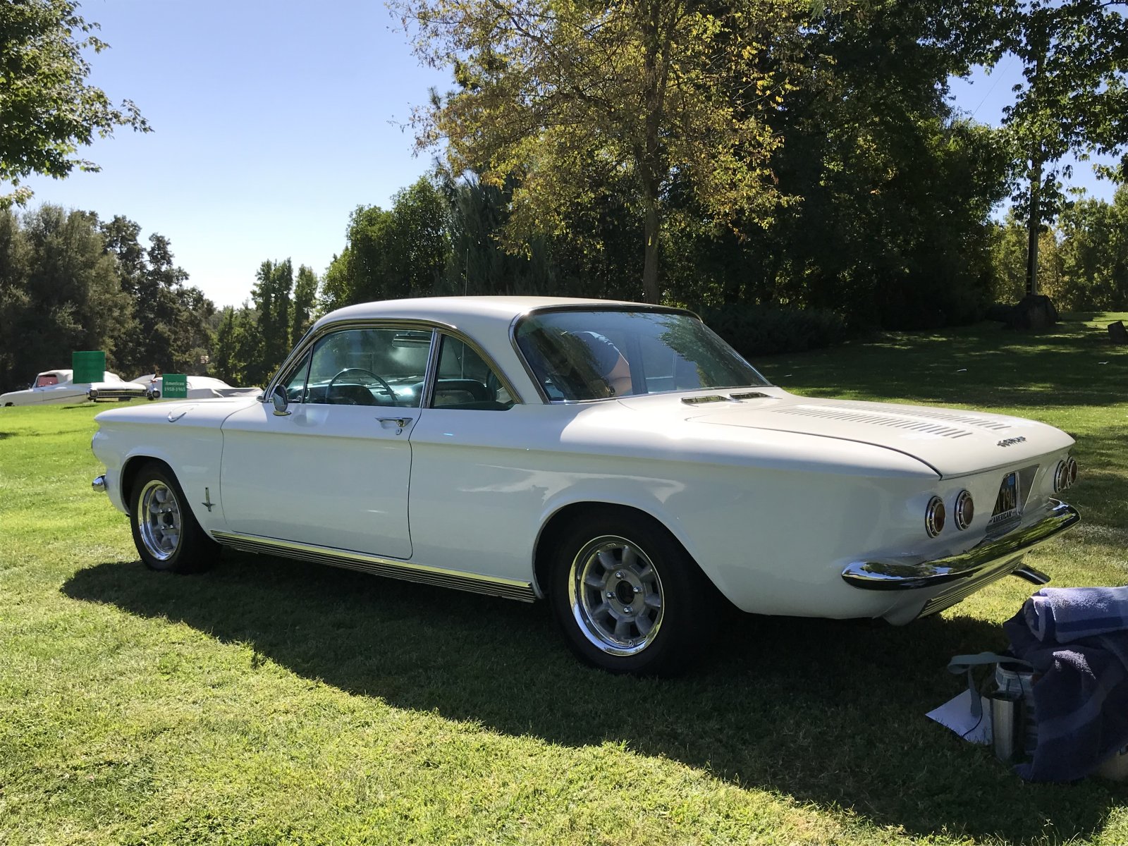

    Walking through the Turlock Swap Meet with my wife we spotted a clean ‘62 Corvair for sale. I’ve always liked Corvairs so we stopped and checked it out. She fell in love. For the rest of the day she talked about it, so we went back and made a deal for her first hot rod. My other projects waited while I went through it and made it safe and reliable for her. We splurged on some real English Minilites and the appropriate tires. Later I installed a fresh ‘65 110 hp engine that a friend donated. It’s a blast and it’s always ready to cruise whenever my junk is down.

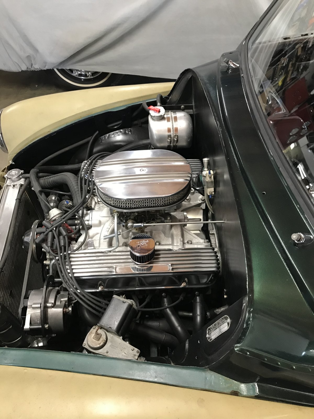

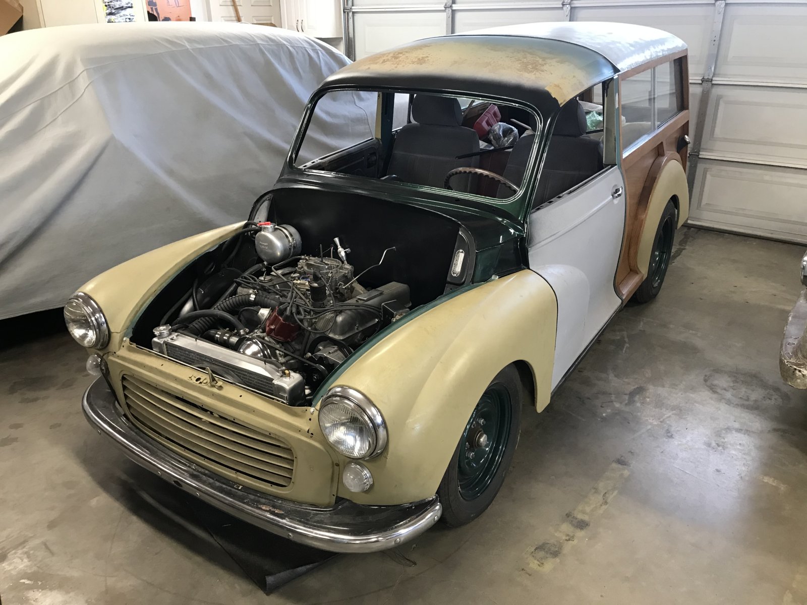

    Finally the oddball in the herd. The wife and I saw a really *****in Morris Minor woody while on our honeymoon in Ventura. Knowing that they aren’t very usable in California traffic with the stock engine and brakes, I never really thought about buying one. But this one appeared in the HAMB cl***ifieds as an unfinished project. With new wood, a new frame with Art Morrison suspension and a cool little 215 Buick for power, it was perfect. The wife said hell yes and I pulled the trigger on it. I again went through everything, wired it, and got it running and driving. It’s way cool! We took it to a couple cruise nights in bare metal after I stripped the paint off. I started painting it a dark metallic green as a tribute to its British roots but my wife didn’t like the color. We just couldn’t seem to agree so once again it got mothballed while I went back to work on the other cars. (it doesn’t take much to put me off body work and paint!)
    We finally have a color, and it’s all apart for paint. I pulled the windshield and stripped the green off but the wet weather set in. So hopefully, when the weather cooperates, I’ll finally get to paint it and get it on the road. I can’t wait to have it done and ready to go again.

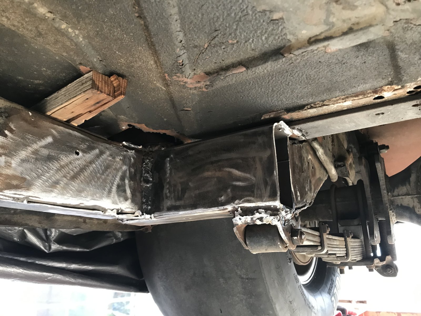

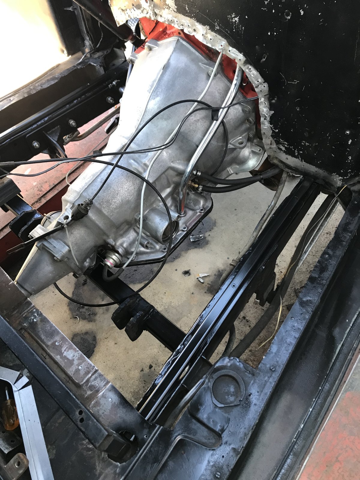

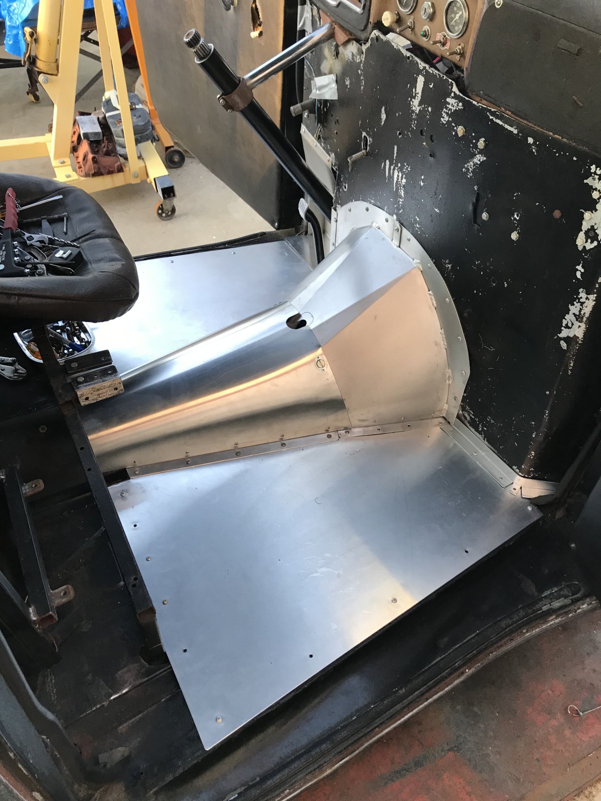

    Lately I have been doing some upgrades on the Austin with the idea of selling it this year. I rewelded and added some additional support to the rear clip, making it safe and strong.
    The master cylinder failed so I had to either replace it or upgrade to a new dual system. I never liked the pedal position or the single M/C so I bit the bullet and built a new pedal ***embly with a Mustang master cylinder. Of course this left a huge hole in the floor and required a new hole for M/C access. Hmm.

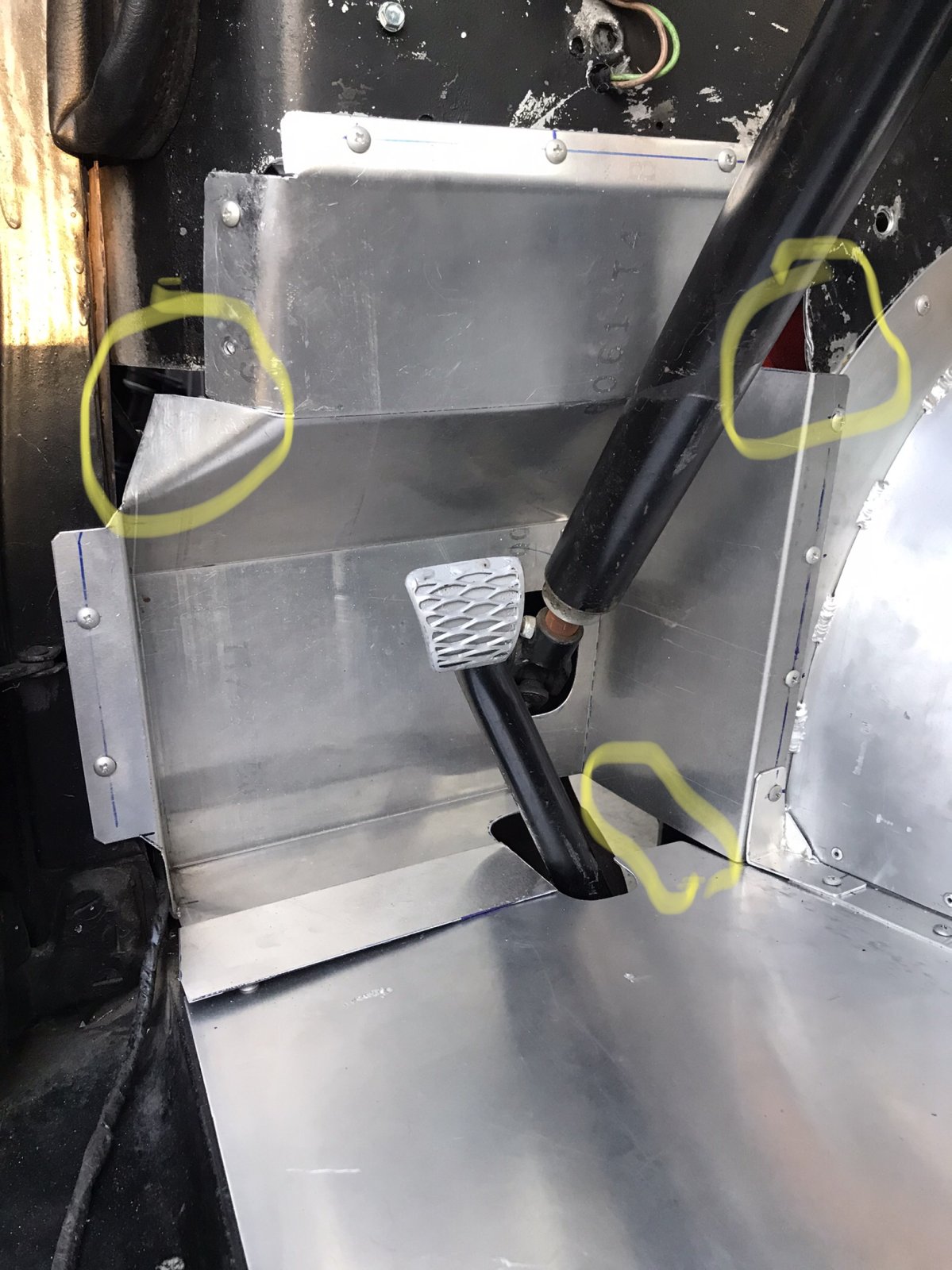

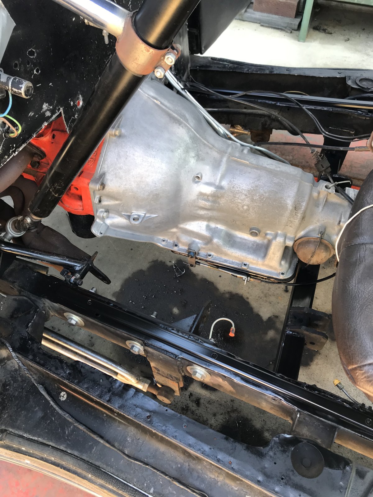

    The old trans tunnel was made from O-toothin aluminum and had scars from a previous transmission explosion. It was also way bigger than it needed to be leaving little foot room. so I built a new floor and tunnel. I also incorporated a footwell to allow me to move the pedal to a more natural position.
    As with everything on this car, I had to pay attention to the details and not make the new floor look too “out of era” with the rest of the car. So no fancy bead rolling or step rolling. Just the basics. Easy, since I have virtually no sheet metal equipment.
    The frame before….
    The frame now…. With gussets and end cap/fish plates.
    The floor now…. (I’ll have to find the pix of the old floor)
    It’s not finished, I have a few more pieces to weld in and a piece to close out around the brake pedal to make. I’m working outside on my hoist and it’s been raining on and off, slowing the progress.
    I’m still trying to decide what to do about the firewall. Ugh.

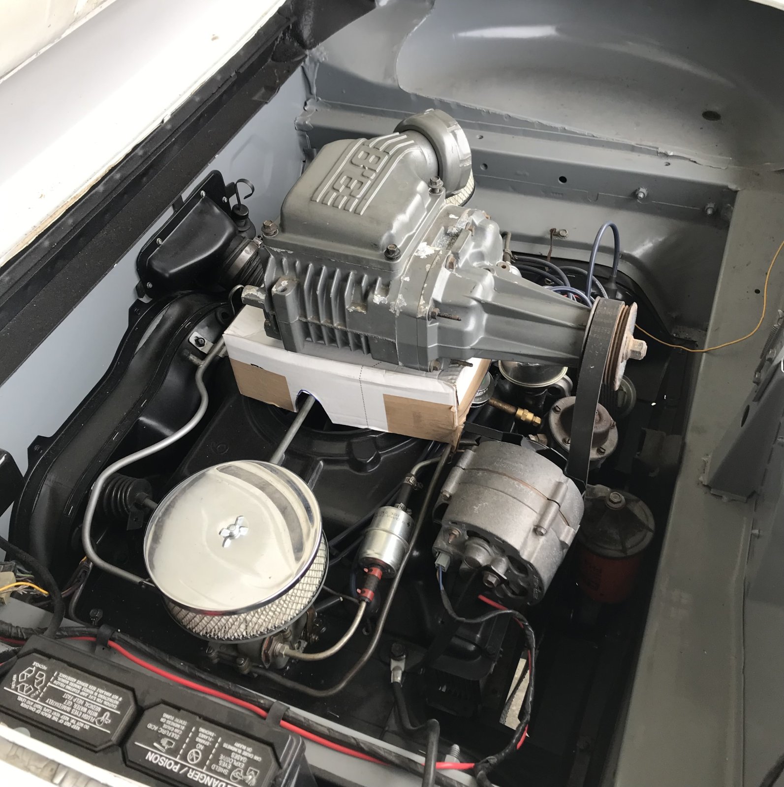

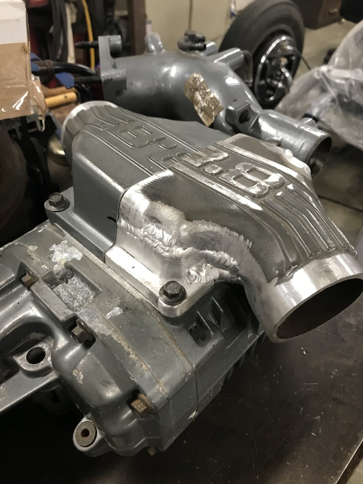

    It was raining all day today so I turned to my latest brain fart, an M90 Eaton blower for the Corvair.
    My buddy asked me to come along to the Turlock Swap and share his space. The guy next to us had this little blower sitting there calling to me. At the end of the day, the price dropped significantly, $60.
    It seems to be in perfect shape.
    Of course I had to mock it up as soon as I got home….. It looks like it’ll work. It even spins the right way.
    I bought two outlet castings off of eBay and did a Siamese twin job on them. Rainy day progress.
    I guess I shouldn’t have sold my mill, I’m going to have to grind the fins off since they don’t match.
    I have another Corvair engine that I will put on a stand and do the buildup on. The fuel pump and oil filter will have to be relocated.
    The question burning in my head at the moment: Is there a problem with running California ****ty gas through a blower that was meant to pump only air??

    Bob, I believe I have read that the Eaton blowers have some sort of coating on the rotors that the gas will peel off, I’m not 100% but I have looked at using one of the bigger ones on something.

    I went to the link Walt provided (thanks Walt) and did a little more research on the blower application. I’ll take a look at mine and see if it has a coating on the rotors. If not, then I will proceed with finding a suitable carburetor and build an intake adapter. It’s just a stock 110 hp engine, I’ll probably add some headers and a better exhaust system to it along with the blower. The car just needs a little more oomph on the low end being a Powerglide. The highway cruise rpm is pretty good so I don’t want to change rear end gears.
