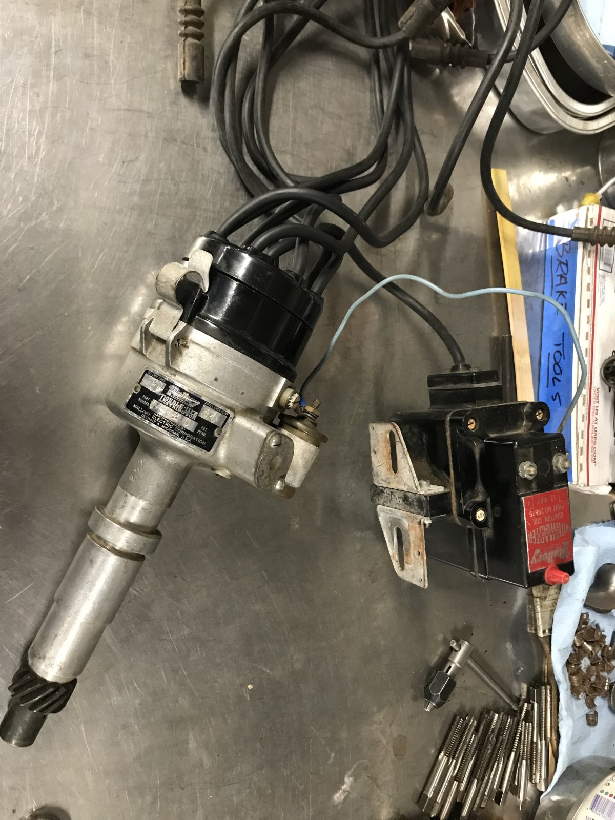

    I found a Mallory DoubleLife distributor for a Buick on Craigslist the other day and immediately sent a message to him. I didn’t hear back. This morning I checked, no response. So I sent another message but this time I cut and pasted the web address instead of trusting the link. I didn’t get an immediate response so I headed out to the shop. Just as I was starting to get dirty, he called. He was about an hour away but he was available so I dropped everything and hopped in the family truckster for a little road trip. The wife was in the middle baking some sour dough bread and she didn’t have a window to come along so I set out solo.
    He was a real nice guy whose hot rod dream was curtailed by his Mom getting serious cancer and he being her caregiver. We talked about family responsibilities. He’s doing it right.

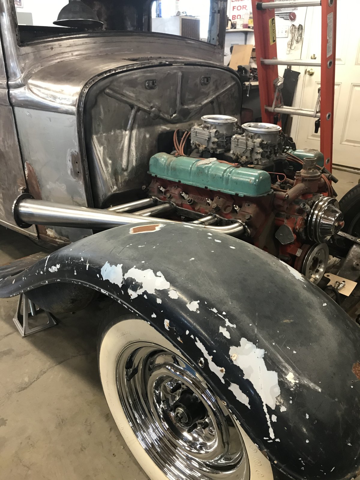

    The plan is to use it in the 425 Buick in my ‘33 pickup. As it is, with the stock distributor, I really should make a recess so I have full timing adjustment, it’s pretty close. The Mallory is much smaller (and cooler).
    The ‘33s have the bulging firewall like the ‘34s do, I removed the firewall, trimmed it and reinstalled it farther back. Instead of sticking out 2+ inches, it’s now almost flush but still looks stock. When I mounted the Buick, I installed the radiator with a mechanical fan and positioned the engine accordingly. I wish that I had just tacked the firewall in so I could have moved it back another 1/2 inch for better distributor clearance. Oh well. There may be enough wiggle room in everything to get more clearance without m***aging the firewall. If not, no big deal, I have hammers.
    Pardon the green valve covers. I have the factory aluminum ones all polished up and safely put away.
    The black line under the windshield opening is a cut line. I’m going to drop the windshield down close to the cowl. I never liked that flat area under the windshield on these trucks. I’m gonna fix that.

    Bob, once again you spring something on us that’s out of the norm. I would never have considered dropping the windshield like that, will you be doing a mild chop to keep the w/s stock height or doing a full on chop?

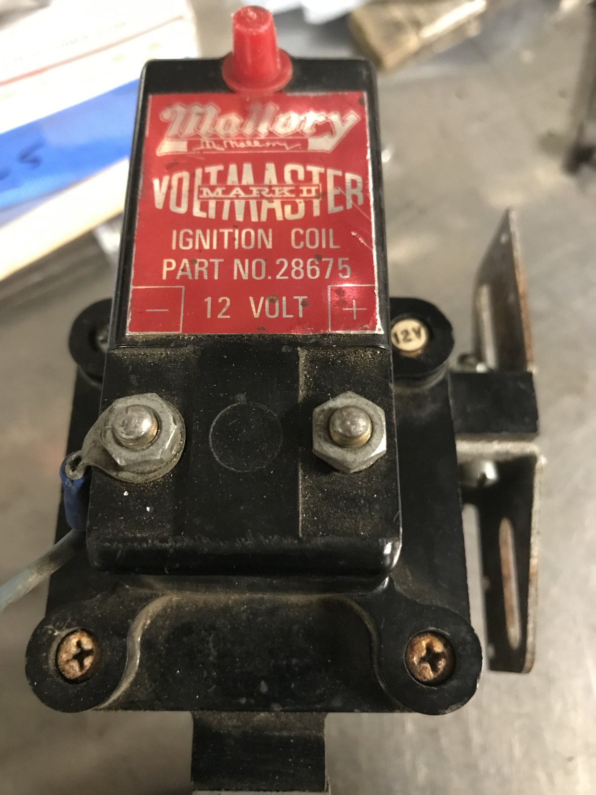

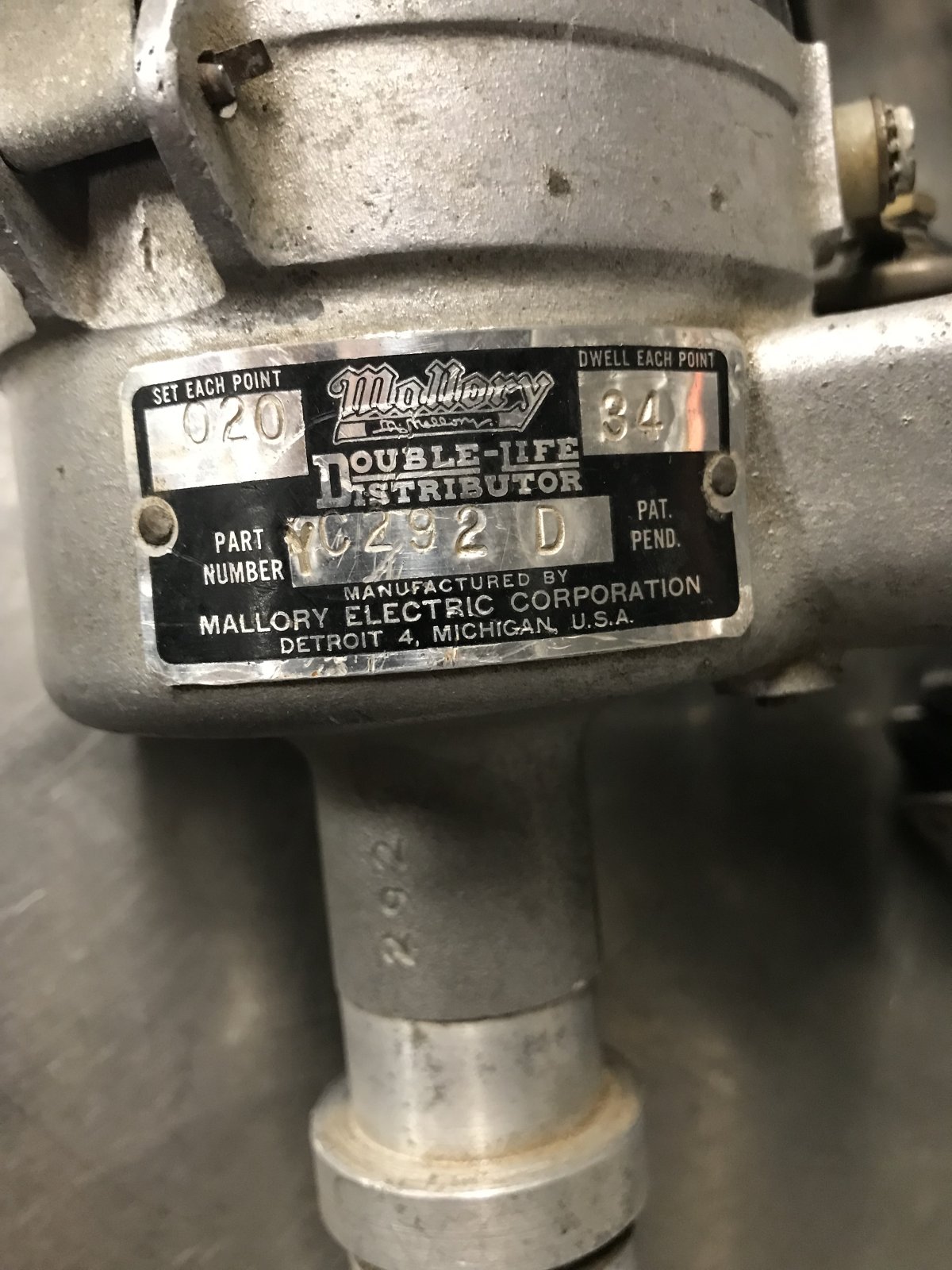

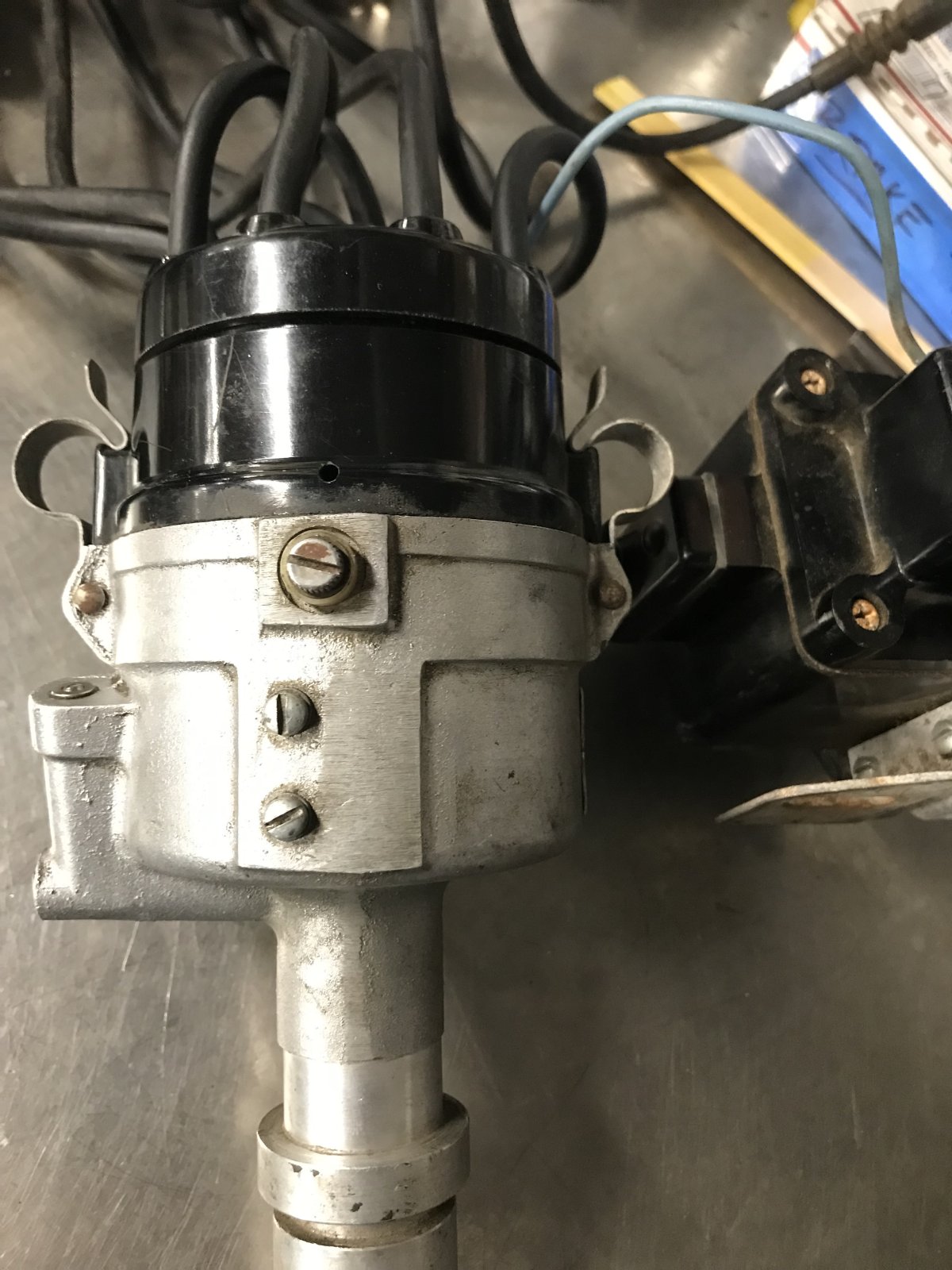

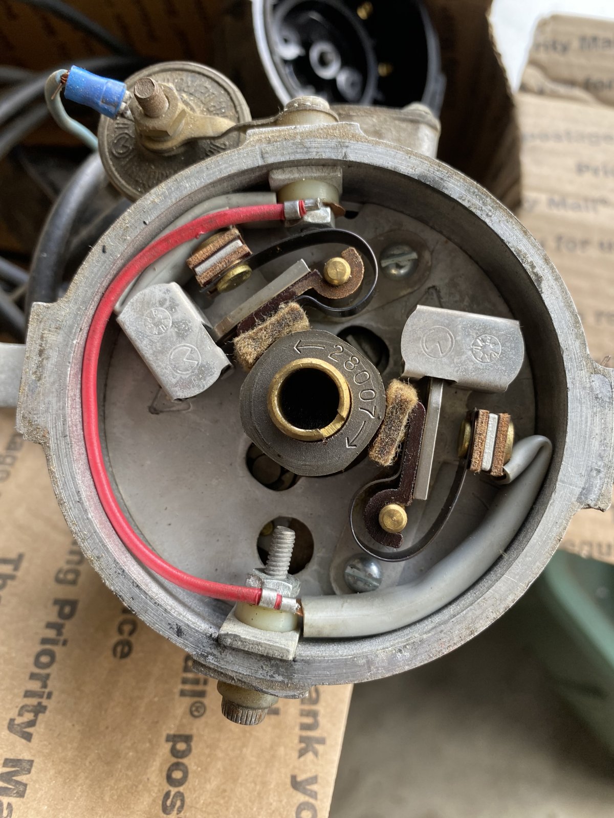

    I’m not experienced with the DoubleLife Mallory distributors, is it supposed to have two external condensers? I see two screws and a p*** through on one side with no condenser. Is there a thread on how to wire these things?

    The Double-Life uses a single condenser and that Voltmaster coil that you have. The Rev-Pol models, which used the same distributor housing, had two condensers and required a Rev-Pol coil which had two primary windings with separate terminals for each set of points. Yours hooks up as you would expect; neg side of coil to the distributor, both sets of points and the condenser connected together.

    Thanks! I noticed right away that it has a four lobe cam. That made me wonder. It’s really nice inside. The story is it was used for a very short time in a boat engine, was replaced with a magneto and sat in a cabinet since 1968. It came with the 401 boat engine that the guy bought for his hot rod project.

    Nice, that thing is untouched inside. I ran one in a SBC for many street miles in the 70's, I recall that new points closed up a bit as the rubbing blocks wore into the cam and after that the dwell stayed stable for a very long time. Access to a distributor machine makes exact set up so much easier: you set the dwell on one set of points and then adjust the second set to fire exactly 45 distributor degrees after the first set. (just slip some clean folded paper into one set while you adjust the other).

    I figured that there would at least be some salvageable parts in it. Imagine my surprise when I opened it and it looked like new. I’m going to have to ask around to see if anyone nearby has a distributor machine. I always wanted to buy one but I never found one available when I had the money.

    It’s funny how some little things just bug me. That windshield/cowl placement and the pudgy grille shell always put me off of these trucks. But when I saw Kieth Weesner’s artwork with a low tangerine colored pickup with a motorcycle in the bed I just had to have one. A friend gave me a really rusty cab that he harvested some patch panels from so I could plan without cutting my truck.
    You can see the difference in these two shots. Basically the same windshield frame but it just flows across the cowl and into the door window better on the Model A coupe. I want my truck to look like that. Just my opinion.
    I’ll try the ‘32 p***enger car grille on mine but the factory grille shell has grown on me some.

    Will you have knee room in the truck after dropping the dash a corresponding amount? Chop, channel, and dash/windshield drop will make for a cozy cab.

    The dash won’t drop more than 3/4” depending on which method I choose. If I section the top of the dash it won’t affect the leg room at all. And yeah, it gets pretty tight in there, the thickness of the seat back is critical to me fitting in there. I’m about 5’10-11”so it’ll be close. I had a chopped ‘29 closed cab as a daily driver for years so I’m used to small spaces but I am older and less flexible now, lol.

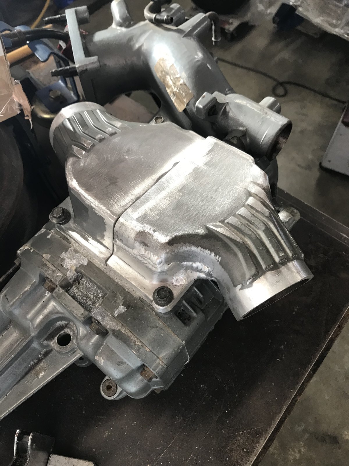

    I was distracted by a number of things today so I didn’t get as much done as I had hoped. Mowing and weed spraying a**** them.
    I made patterns for the little patches that I need to close out the Austin floor. I made the pattern and the panel to close out around the brake pedal.
    I ground off the powder coat and most of the fins on both halves of the blower outlet but I didn’t weld them together. I still need to dress the inside of each half while I have better access.

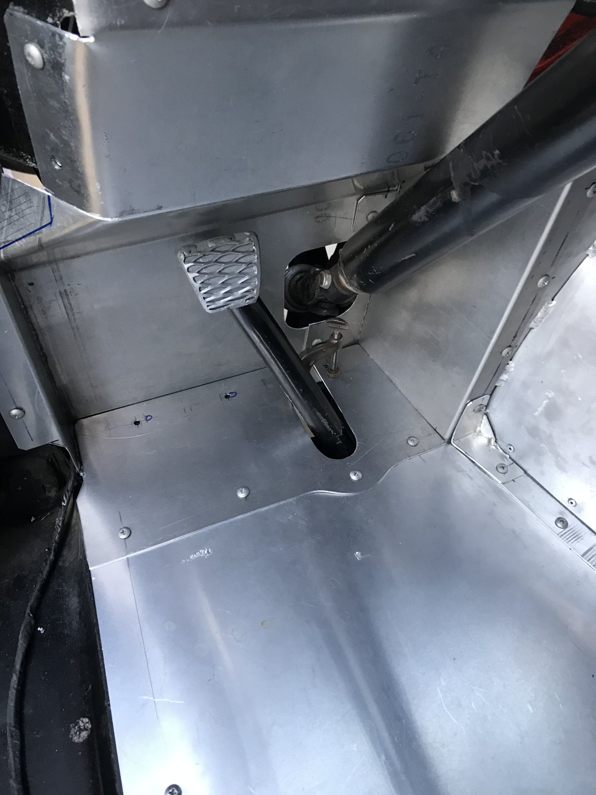

    Enjoy u bouncing around projects. Do have a question: where is the gas pedal going in the Austin? Picture of patches on floor show no room between steering column & ****** tunnel.
