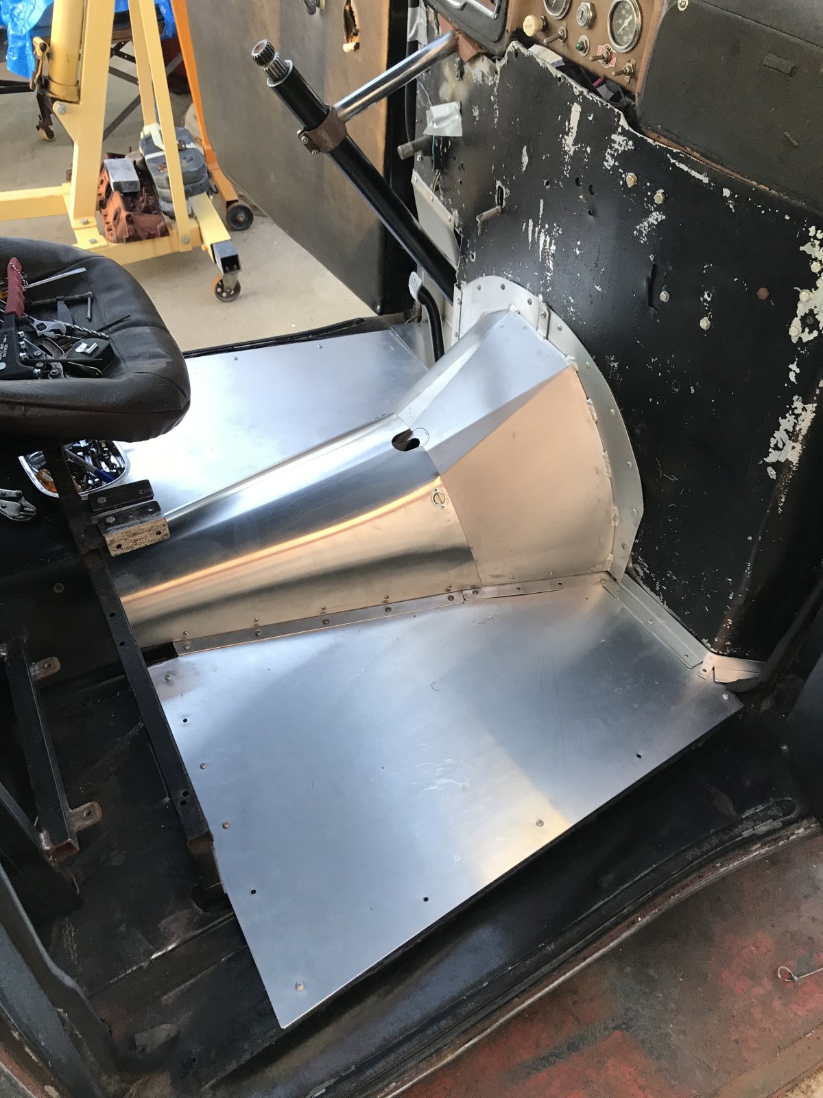

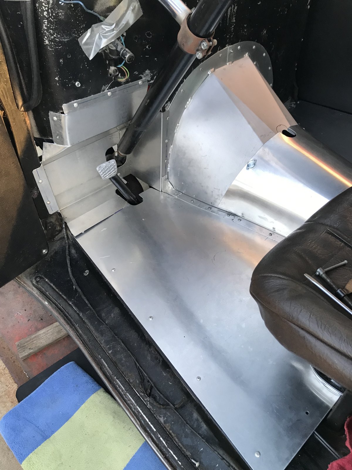

    I’m not 100% sure yet. Let’s just say that I gained about 2” in that area by shrinking the bellhousing area so you can imagine how cramped and awkward it was before. I might add another U-joint to the column and radically change the angle of the steering column if I can’t get the gas pedal in a reasonable place.

    Bob, I was looking at the picture of your brake pedal and steering column . It looks like you need to raise the steering to make room for the gas pedal. Do you have some other idea in mind that I'm missing?:)

    You may be right. The gas pedal was in a mighty strange place before as is common in old g***ers, but there should be a little more room now. I’ll soon find out.

    Here's what it looked like before....
    When driving, I had my left foot on the M/C and the arm of the brake pedal. The gas pedal will move to the right about 1.5" but it will still have a little angle. I might narrow the gas pedal and ditch the big base or make something different but still period appropriate. No big Moon pedal in here!

    Flat firewall looks ideal for Hurst Pedals set up...
    I got one with Chevy master for clutch and brakes.

    The current firewall is too thin. I considered removing the firewall, building a firewall hoop and hang pedals from it but I am really trying to restrain myself. I know me. Next the engine comes out ‘cause I would really like to remount it about 2-3” forward, Then the new firewall and pedals. Then new headers and exhaust. Then a cage…..

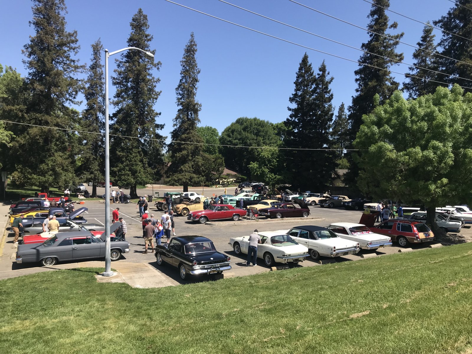

    A friend turned me on to the Studebaker show in Stockton today so I gave the old Stude a bath and went for a little drive. It’s about 75 miles ‘round trip, a little farther than I’ve taken the old truck so far.
    It was a beautiful day and it performed like a champ.
    It’s a small show at a nice park. Nash and Rambler owners were invited to. They actually outnumbered the Studebakers.
    Here’s a few pictures….

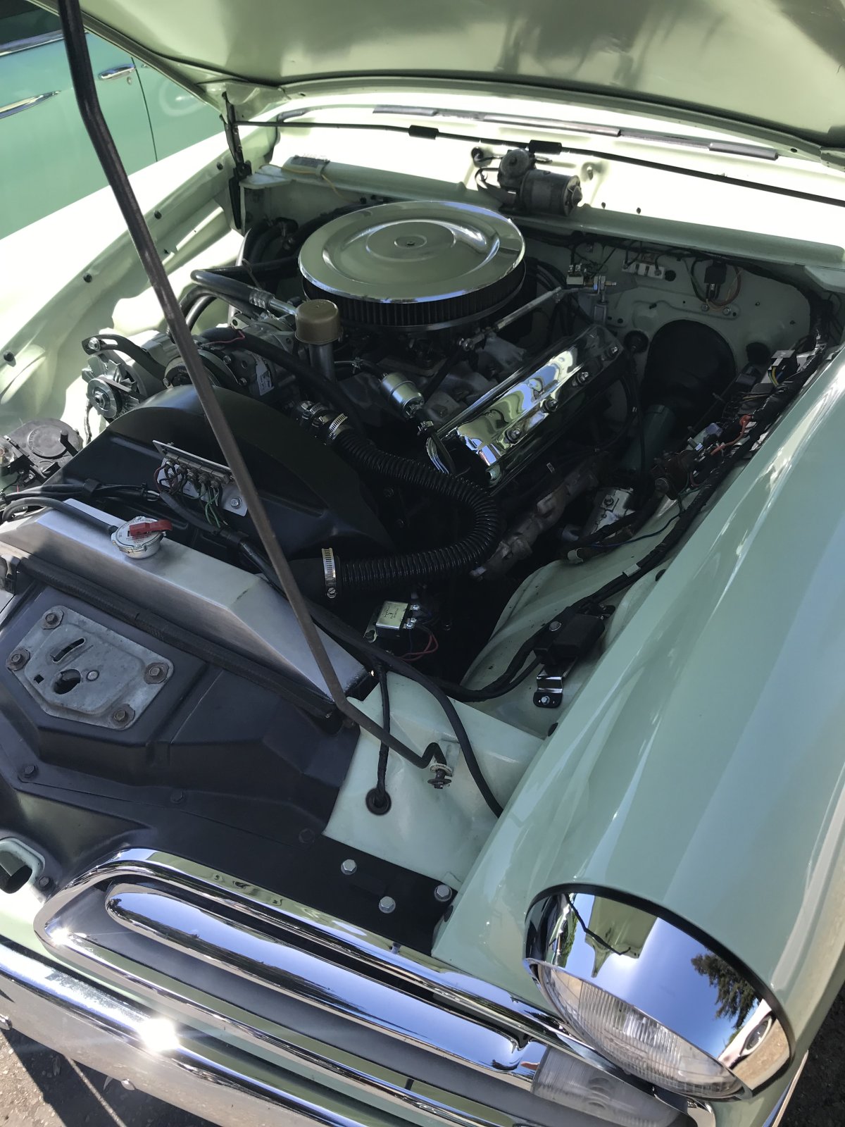

    What’s wrong with this picture?
    Thor1, catdad49, Paul B and 10 others like this.
  12. Nice Stude covers on a SBC.

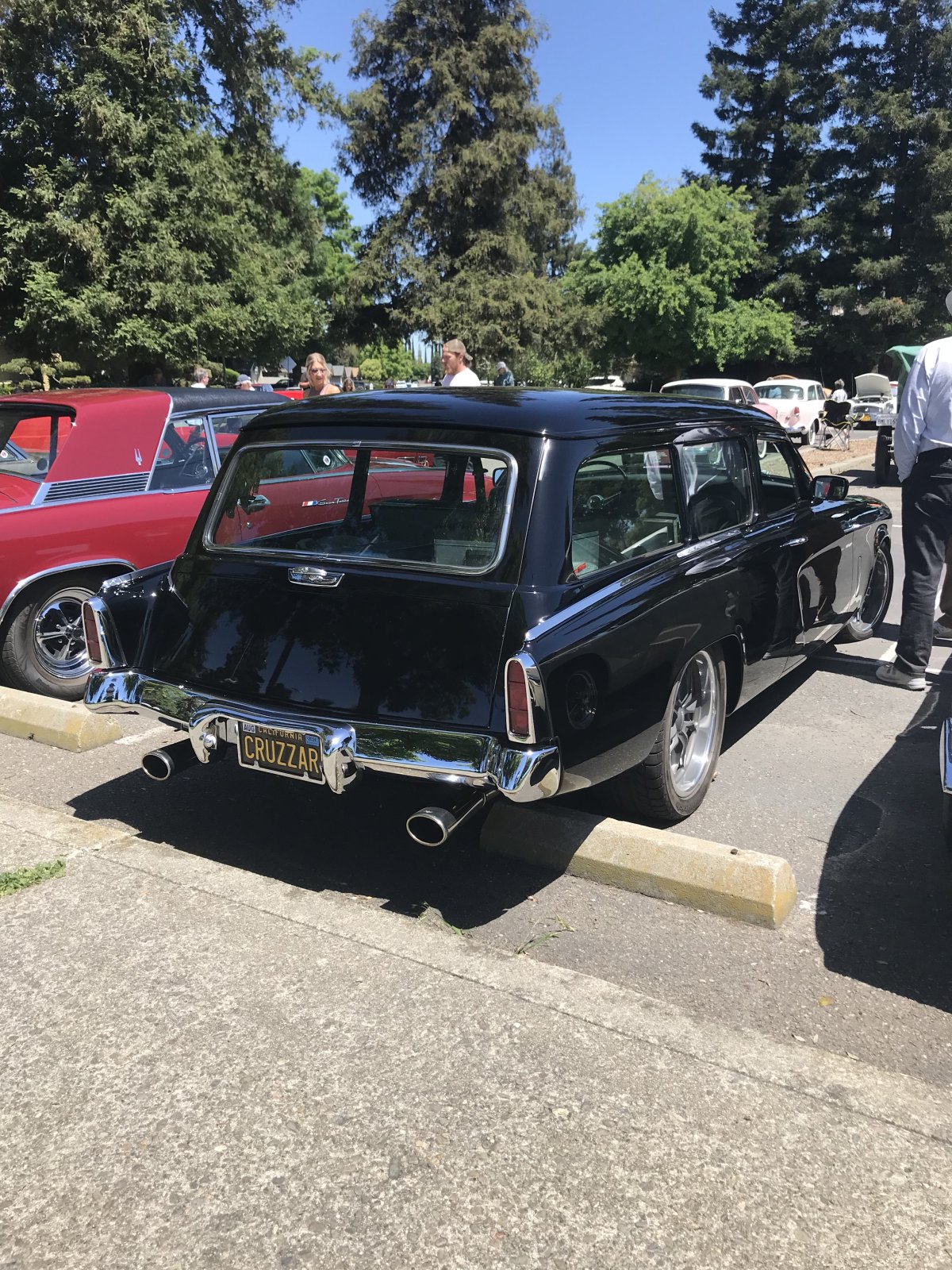

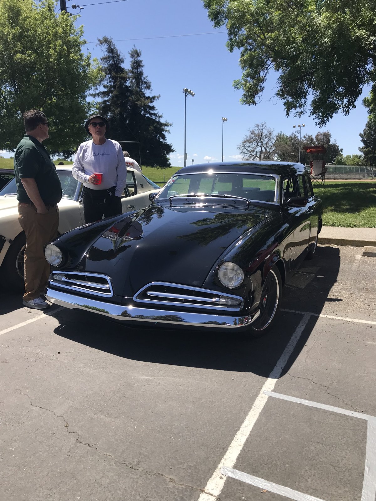

    By far the star of the show was a ‘53 Conestoga, with a light top chop, some other subtle improvements like aligning the bottoms of the side windows and door windows, and a mile deep black paint job. Unfortunately, it had a late model Mustang Cobra drivetrain and non-HAMB wheels. I did my best to get acceptable pictures of it without breaking our rules.

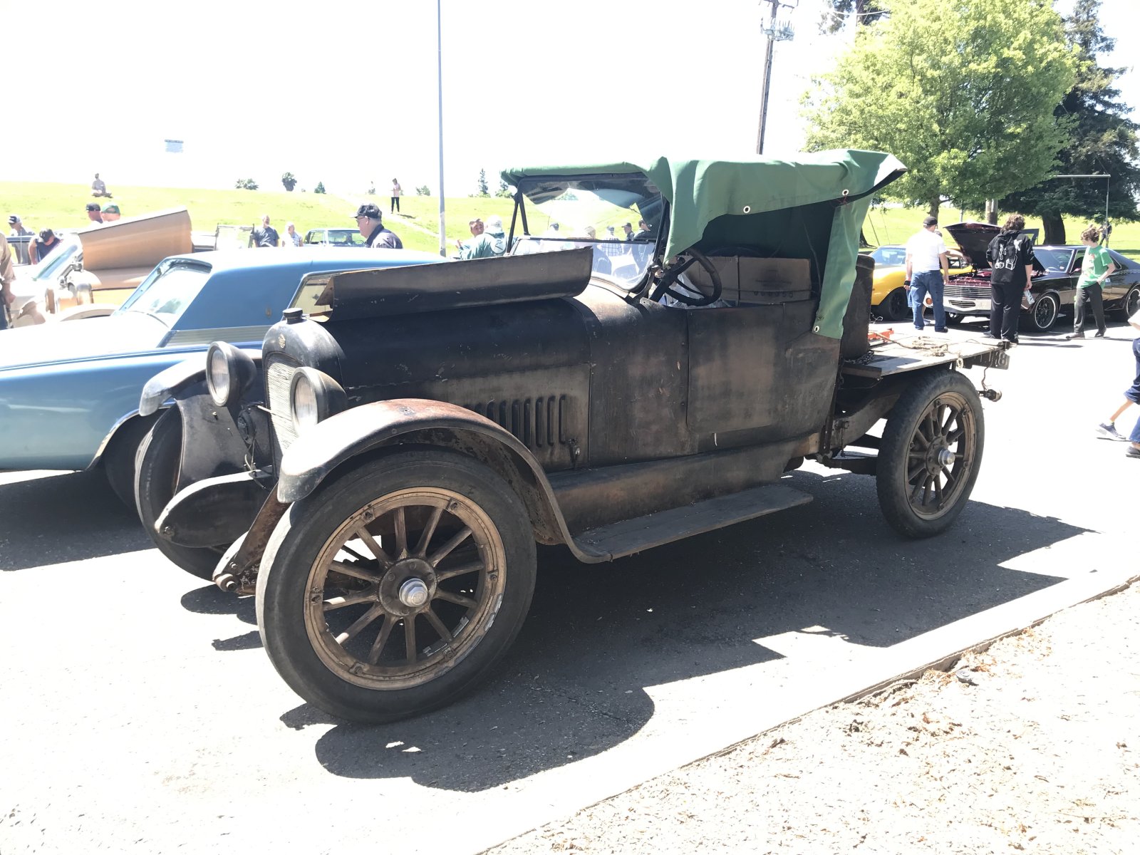

    The old and leaky crowd was represented by a couple of unrestored Nashes.
    I particularly liked the muffler patch featuring vintage baling wire….

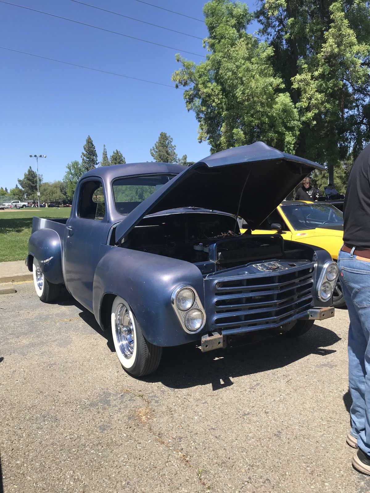

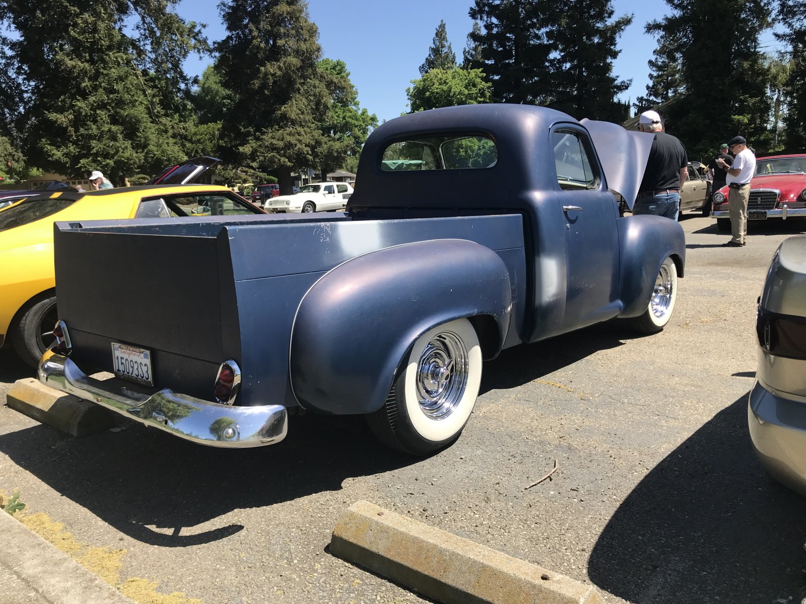

    Last but not least, my heap representing the mild custom pickup genre. (Note the new primer spots)
    There were more picture worthy cars but my phone was dying so I just caught the highlights. It was nice to put some miles on the truck and gain some more confidence in it.

    Yeah. I’m not a fan of valve cover swapping but he did a pretty good job. I think the air cleaner, battery, full uncut shroud and overflow tank help sell it.
    There was some exceptional work on display, that green wagon had a SBC and was all Corvette underneath. With the hood closed, you’d never know. It looked like a high dollar restoration.

    That truck of yours is sweet. It must have been a rewarding day to take it for a trouble free drive.

    Just one little quip: There's more to that black wagon than meets the eye. There were no Conestoga wagons in '53, and looking at the pics, I'm guessing its a C/K coupe with wagon roof grafted on. Looks too low to be a '54-up wagon body originally.

    It's more likely a coupe nose grafted onto a wagon body.
    While not a bolt on, it's MUCH easier than adding a wagon top and floor to a coupe !

    Oh yeah. I didn’t get a chance to talk to him but he was telling folks about all of the changes that were done to it and one was the front sheet metal swap. Lots of work in that car.

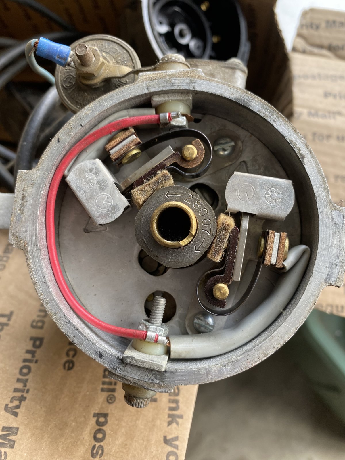

    I used a Mallory "Double Life" distributor in my race car many years ago ..... it's important to check the separate points phasing by comparing the ignition timing on both #1 and #4 cylinders. Adjust the individual points to balance the timing. That Mallory coil should also have a ballast resister included in the run circuit.

    Beats me. Nicely detailed though, huh. He even found a molded upper radiator hose that looks right.

    Thanks for the info. Mallory had quite a few variations when it came to performance ignitions, it’s good to hear that some folks take the time to figure them out and run them these days.
