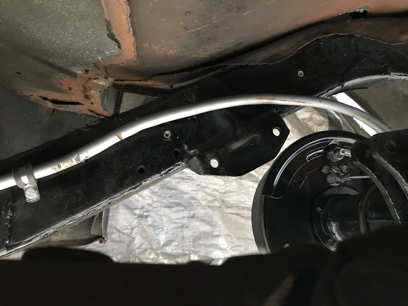

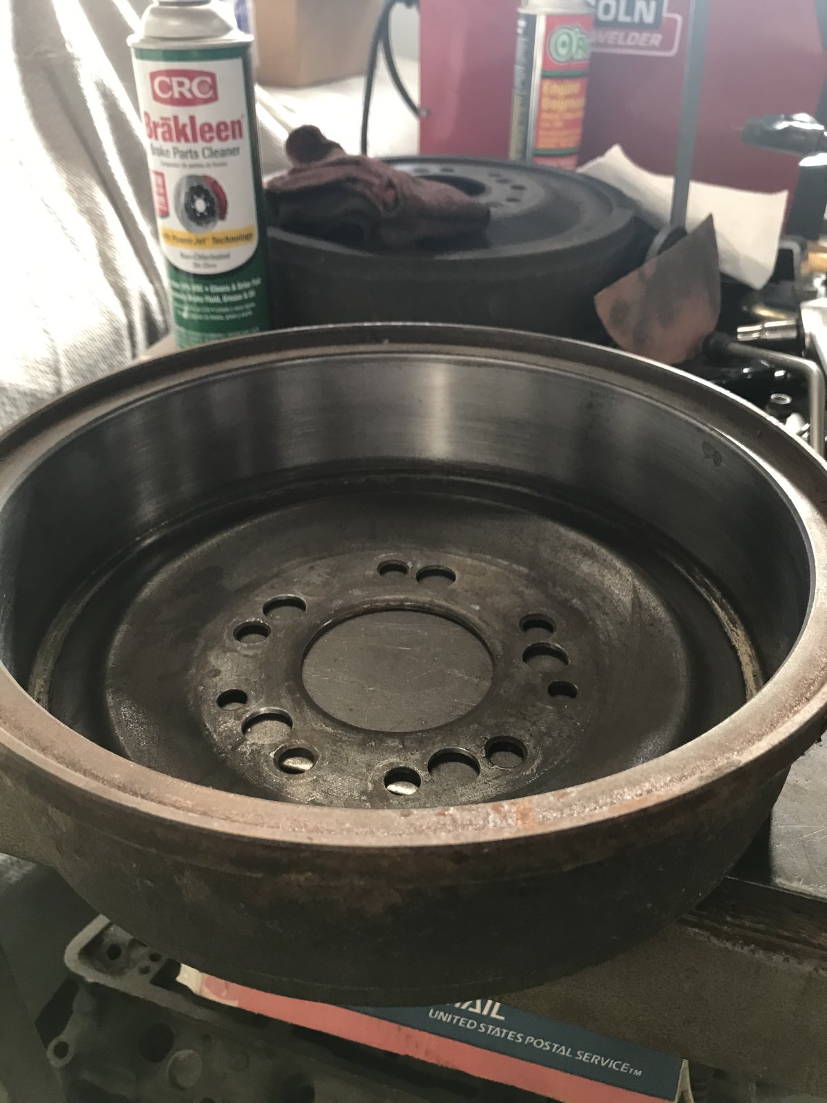

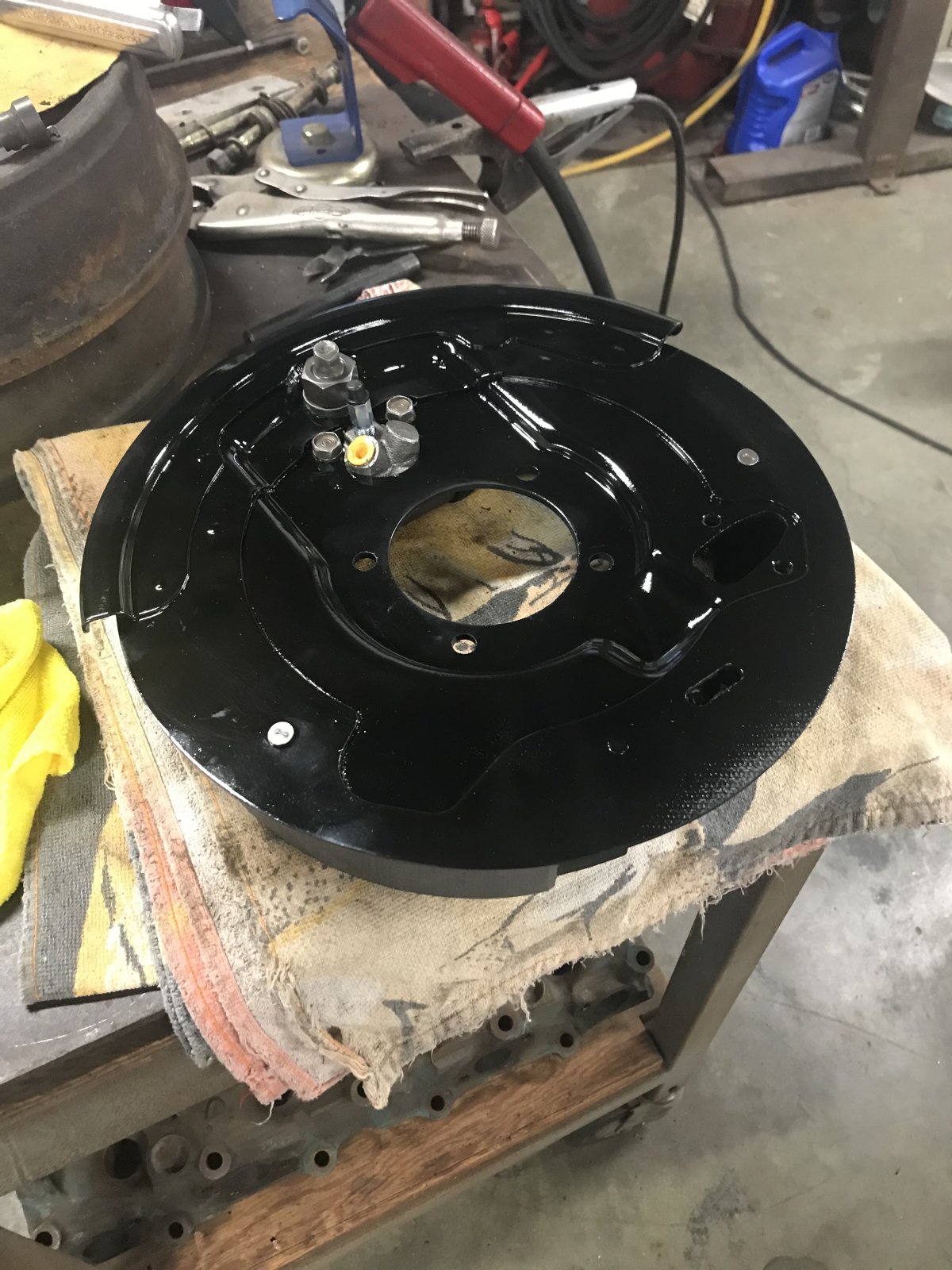

    I did a little dirty work on the Austin. The rear wheel wells were pretty nasty with torched edges and random sheet metal sticking out towards the tires. Everything was either rusted bare metal or ancient undercoating so I s****ed and trimmed and ground and sanded to make it nicer. I hit the springs and rear end with ch***is black since I was already covered in sanding dust and overspray….
    The brake drums look great so I’ll just prep them and give them some high heat paint and they’ll be reinstalled over the new brakes and refurbished backing plates.

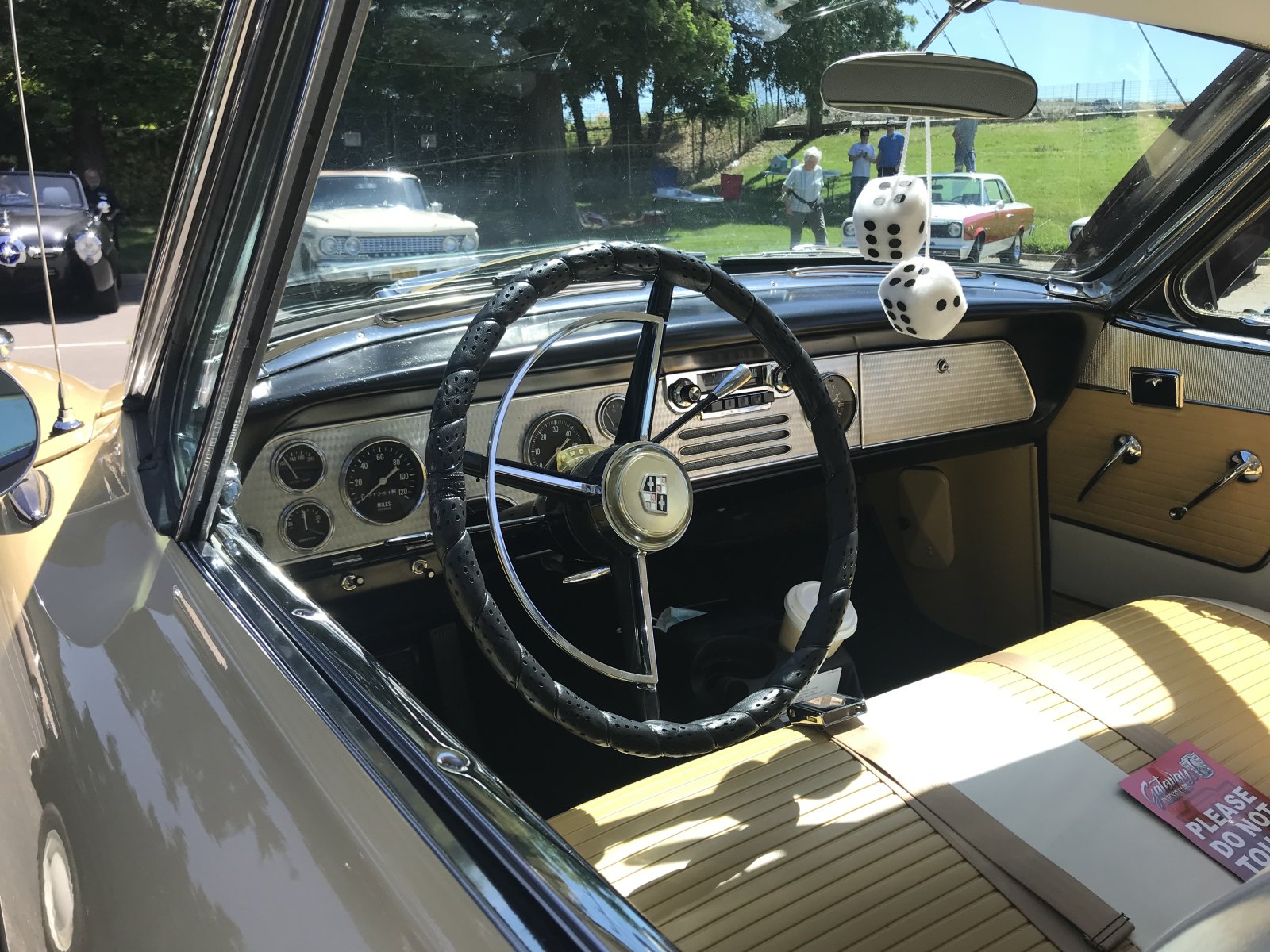

    Factory machine turned dash plate w/ S-W gauges... nice!

    Posts: 6,011
    bchctybob

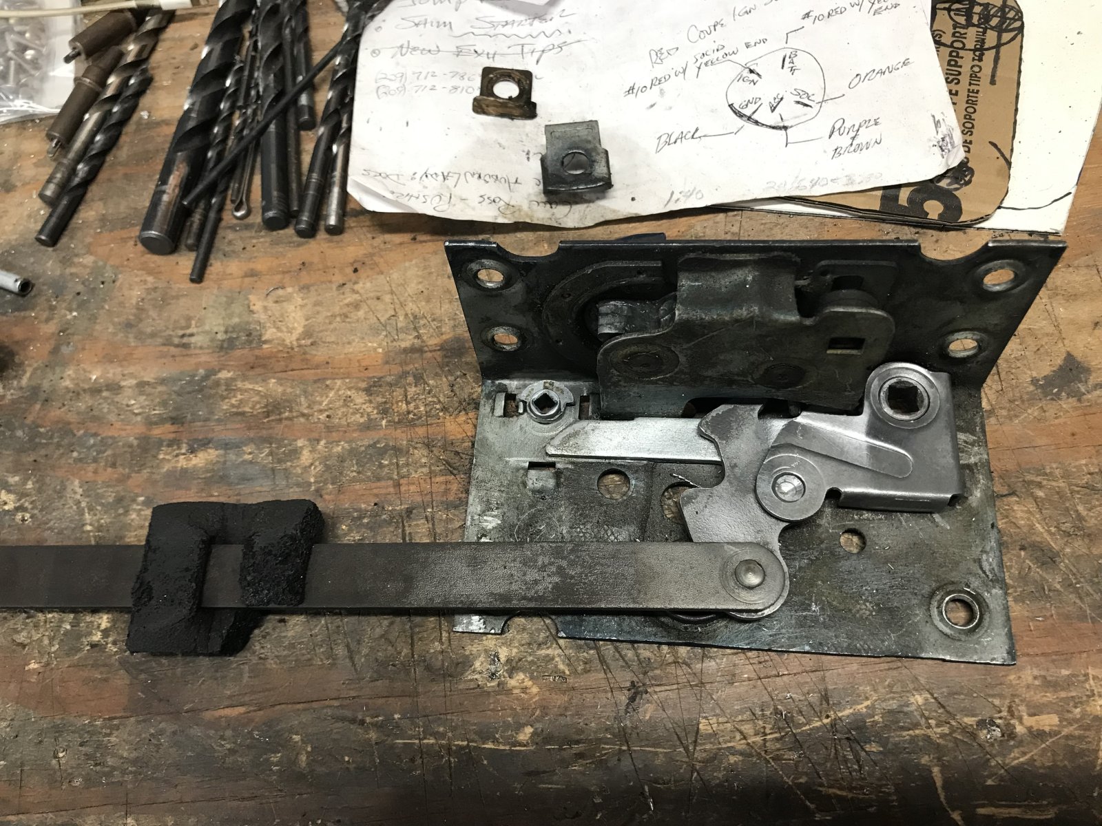

    Our little trip to the Studebaker show revealed a couple irritating things that need my immediate attention if I’m going to be driving it a lot this season. The p***engers outside door handle doesn’t work worth a damn. You pull it down and it doesn’t unlatch, so you pull and pull down and finally it opens. After watching my poor wife struggle with it, I moved it up to top priority.
    I had to go to the hardware store and go do some maintenance at my Mom’s house this morning but when I got home I pulled the p***enger’s door apart.
    I took out the latch and found the problem. Just wear on two interacting parts. A little weld and grind should have them back in working order quickly.
    Item two will take a little more work. The brake pedal effort is too much for my aging legs. I used the pedal that came in the truck to keep it looking like it did with the old TreadleVac brake ***embly. The ratio was borderline but I gave it a shot. I’m going to have to make a pedal with the proper ratio. That’s ok, it won’t change much in the cab. I’m also considering finding a front disc brake conversion to replace the ‘58 Plymouth drum brakes. Anyone have any recommendations?

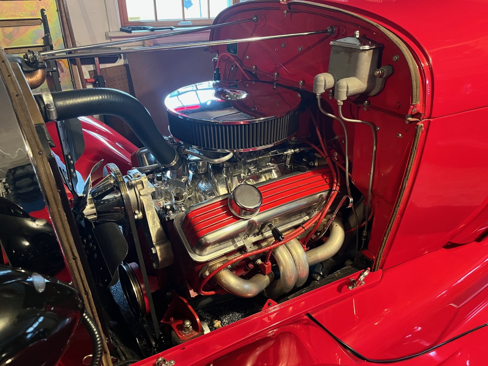

    I don't have the horsepower that you have, but this is what works on mine. IMG_4208.jpg

    My buddy (rip) had two Studes. One a late 50’s, small convertible car, the other a 60’s, a bit larger car.
    Reason I brought that up, one of the dashes looked similar to your pic. Also, seemed Stude used SW gauges w/o the logo on them.
    FWIW the ‘50’s one had a flat 6, the 60’s was a 239 or 289?, can’t recall.

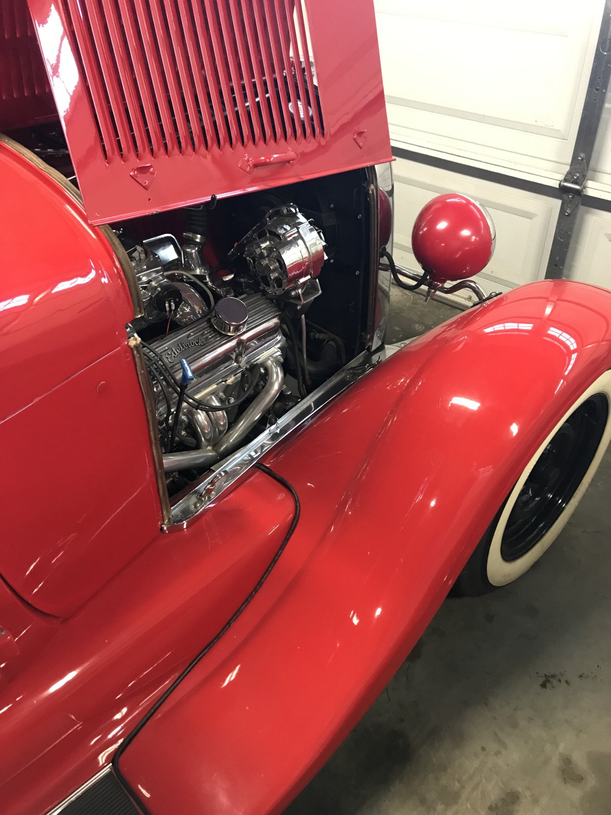

    Mine has a Blueprint Engines 430 hp 383. The dyno sheet that came with it said 458 hp but I doubt it has that in its present state of tune. I didn’t post a full photo because it has a Demon carb on a late model endurashine intake.
    I like your water pump and mechanical fan. I bought one to use on the 283 that I was planning to install this spring. I’m going to have to find another use for my 283.

    That same filter ***embly worked fine on my big, stock...259 Stude engine.
    I'd think that, yeah, It definitely would be too small for a good running 383.
    But, I wouldn't think that it would affect the "idle" rpm air flow.

    I found the same restriction problem on the center air filter on my Pontiac 3x2. I ordered a different element (Wix) and the idle speed remained the same with or without the air cleaner. I guess the cheap filter elements that come with these fancy aftermarket ani cleaners are just that, cheap filter elements.

    I haven’t posted much but I have been getting some stuff done. I rebuilt the Stude door latch and it’s working fine now. I forgot to take pictures but my wife will vouch for me.
    I got the rear brake drums on the Austin cleaned and painted and installed but I think there might be a little problem. I need to go back and look but I think the adjusters are backed off all the way but the drums are snug on the shoes. I read on some thread that they make replacement shoes a little bigger to compensate for turned drums? I need to delve into it some more.
    I wire brushed, sanded and cleaned the rear springs, rear end housing and frame rails in the Austin. I got a couple coats of ch***is black on all of it and I cleaned and painted the Gabriel adjustable rear shocks. Again, no pictures. I’ll post some later, when it’s back together.

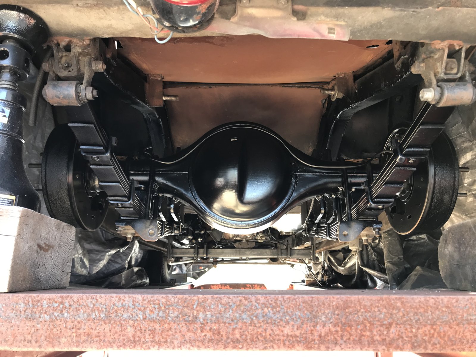

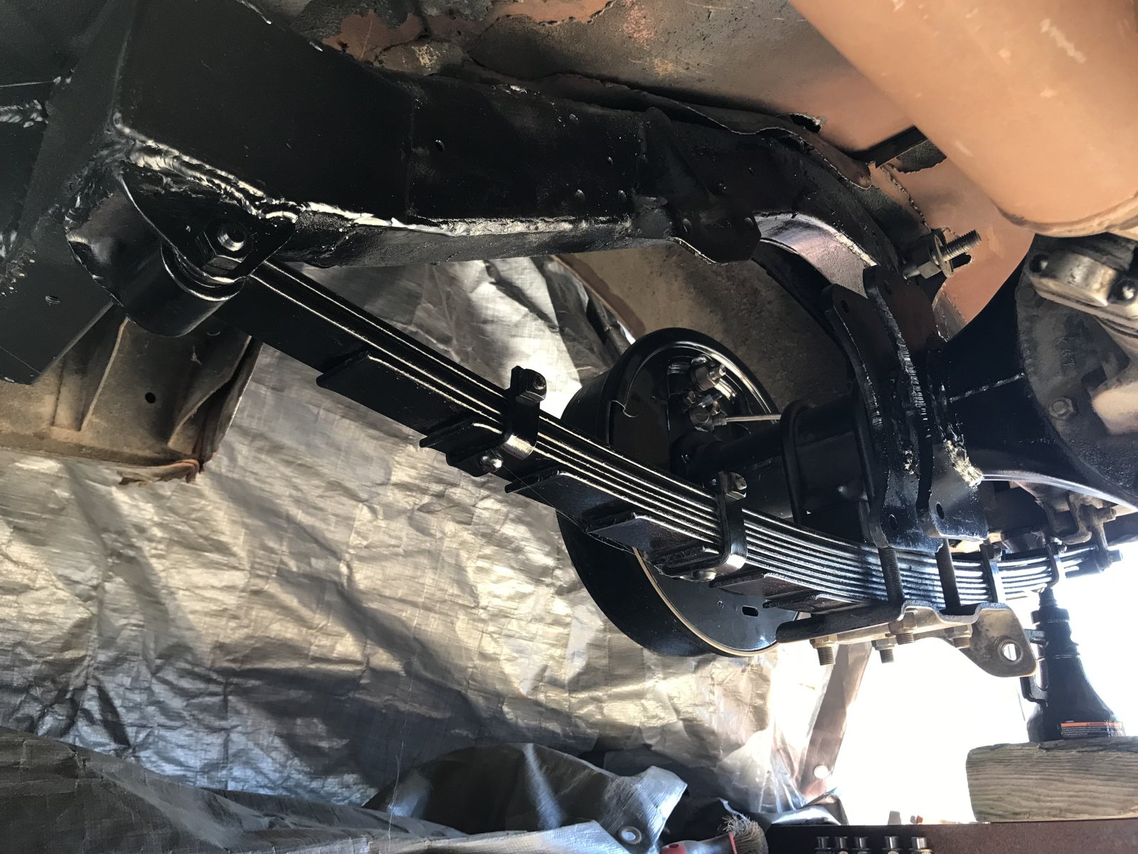

    I was gone for a week or so and took myself a reset day, just unloading the van, putting travel stuff away and figuring a plan for the shop utilizing the newfound space. I was hoping to move my ancient lathe down the wall closer to the phase converter and get it wired up again. I’m going to need it for the Corvair blower project but it would impede access to the breaker panel. Don’t want that.
    Here’s the pictures of the rear suspension cleaned up with fresh paint. I still have a little more to do but some areas will be coming apart and will get painted then. I’ll be pulling off the spring plates to weld on some traction bar tabs.

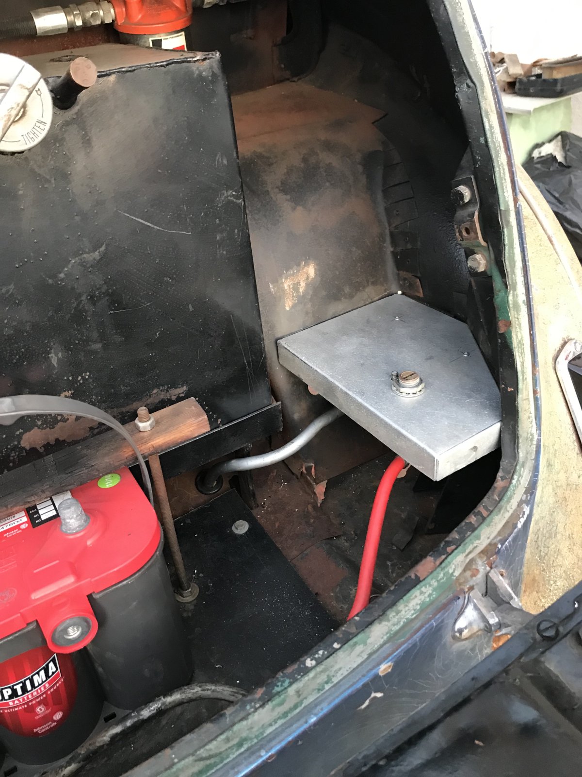

    I made a cardboard pattern and made a small shelf, for lack of a better term. It hides the ugly and moves the switch to a more accessible location.
    Here’s what’s left of the old trunk floor support where the cutoff switch used to reside. The positive cable p***ed through the hole on the left, over the sharp edge and into the tire area. With a nice sharp bend to avoid the tire. Swell.
    Here’s the new shelf. It looks old because I made it from the custom hood side panel from my roadster. I’m no sheet metal guy but I got it right on the first try! The front edge is folded down and pop riveted to the wheel house. Note the trick, non-conductive battery hold down. That’s the kind of work I’ve been correcting since I got this car. All the while trying not to modernize it.
    Oh yeah, that’s the gas cap and one of four vents in the homemade gas tank in the upper left.

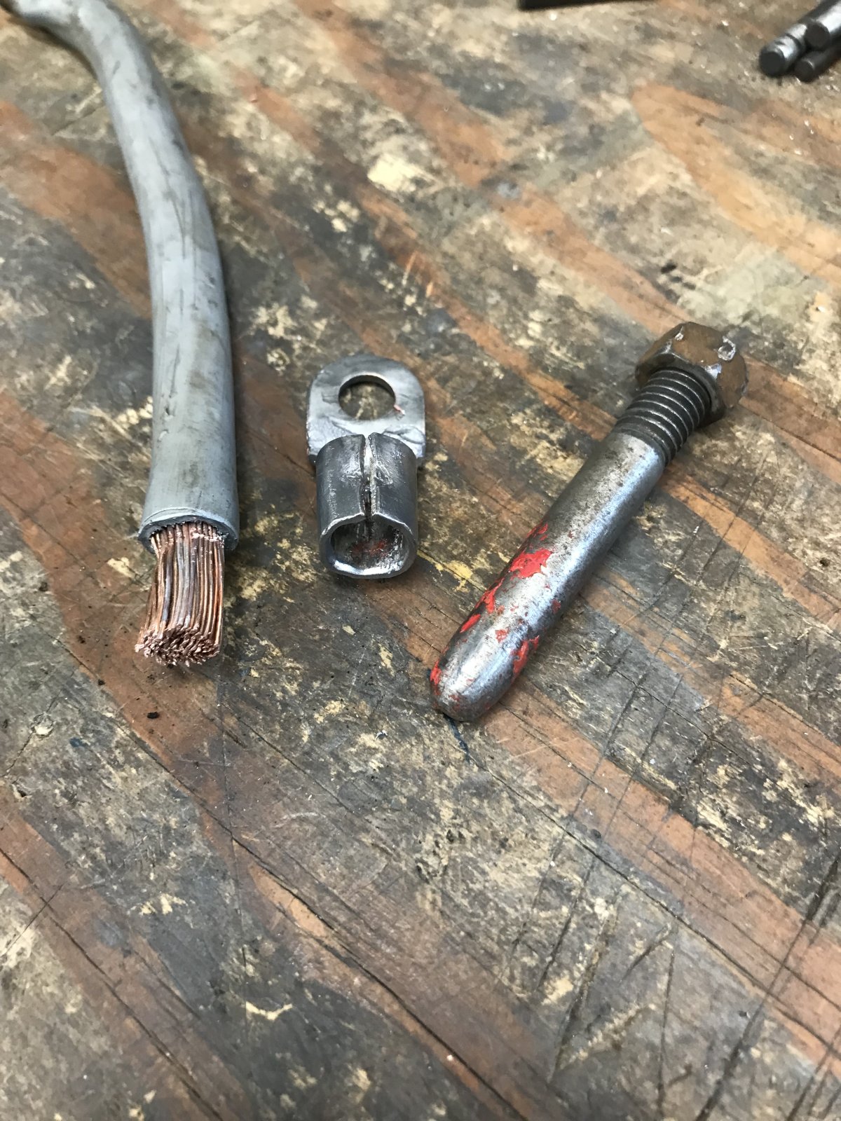

    The rerouted battery cable proved to be way too long so I shortened it. Of course I didn’t have the correct size cable end so I had to reuse the existing one. I learned a while back that you can get wires out of a crimped terminal by cutting it off with about 1” of wire sticking out. Then, by pulling the individual wires out, usually starting with the center ones, eventually they get loose and the terminal is empty. Then you just reshape the crimped part.
    They had tried to solder it but only a few wires were slightly stuck. I found something to drive into the crimped part to open it and act as a mandrel to reshape it. What I found was the start of a homemade hood pin that I made when I was just out of high school - 1969-70! The other one had a washer welded to it.
    The end result is acceptable. The cable is now safe and secure and not rubbing on sharp sheet metal (note the grommet) The switch is a good Hella part with a removable key. I might replace it with an NHRA acceptable switch with an external handle but it’ll be ok for now. There are so many cheap imitations, I’m not sure where to get a good quality one.
