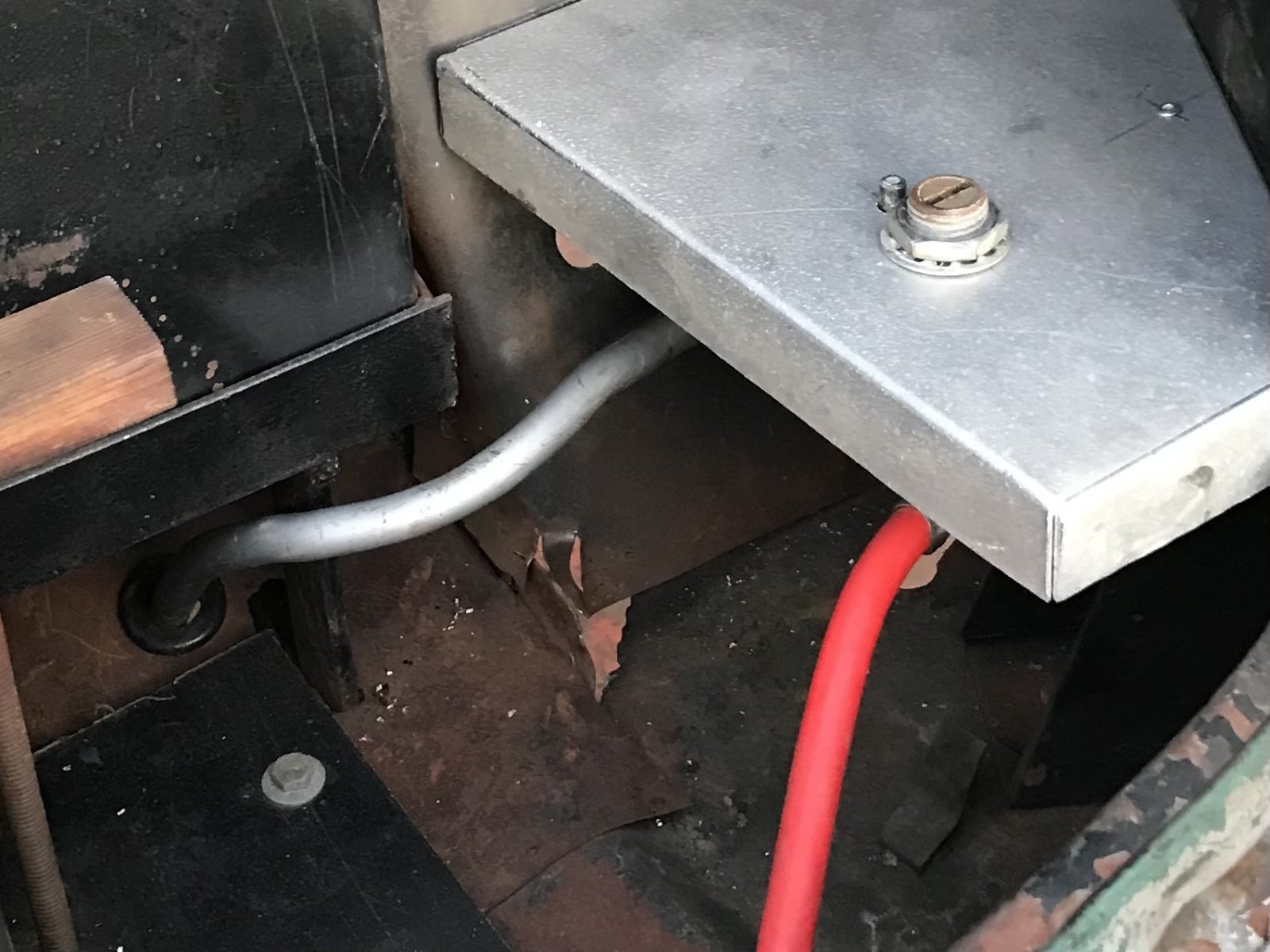

    I don't remember ever seeing a silver battery cable before............:D Enjoying your thread, it's almost like being in my shop.......but without the sweat.:)

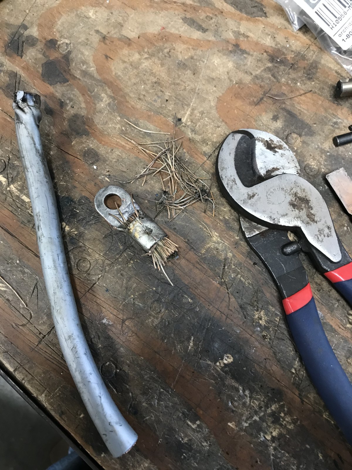

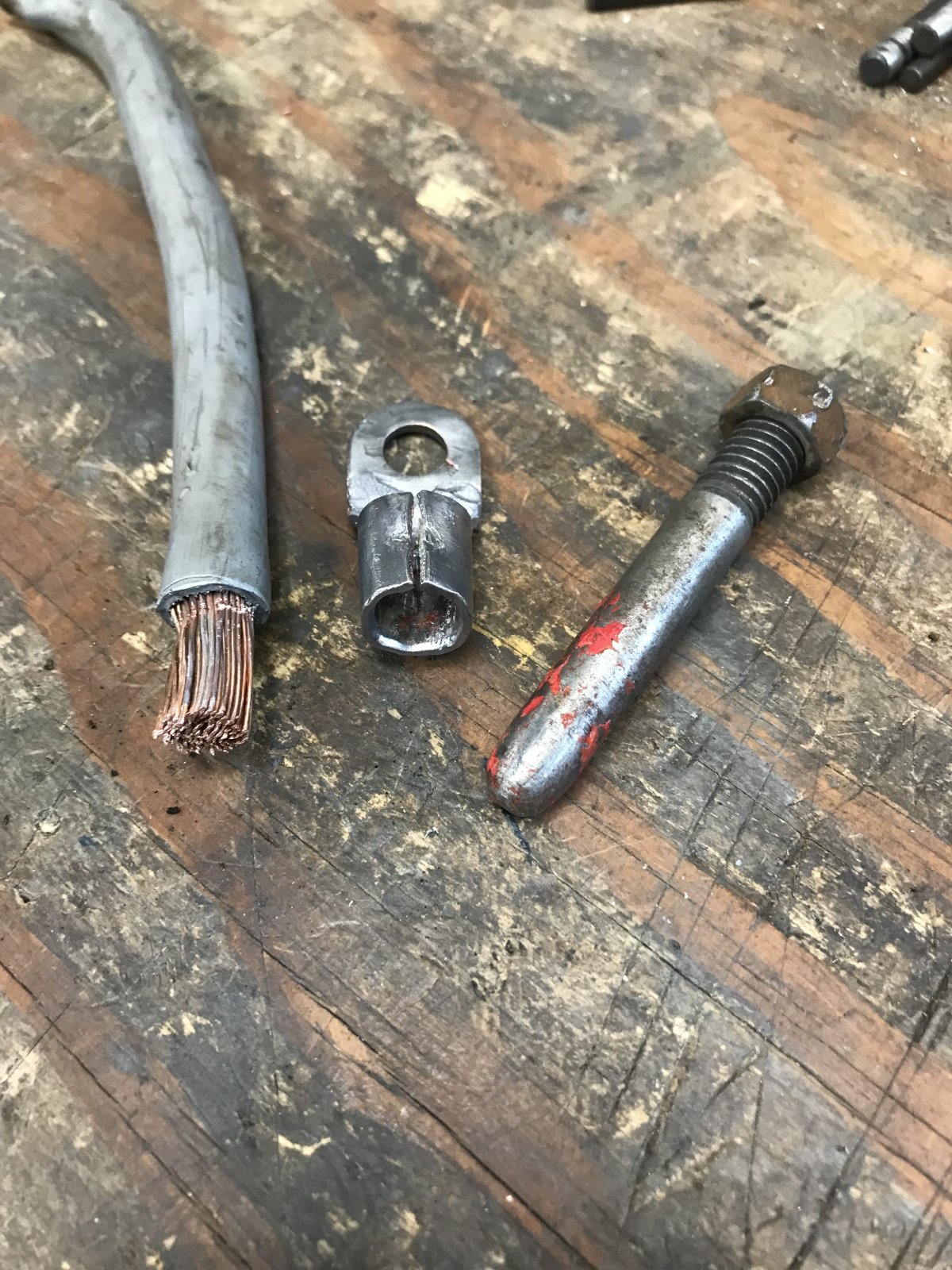

    The battery cable is from Belden. I’ve never seen silver insulation before either. The insulation is thick and durable. It has some indentations in it but no cuts, abrasions or internal corrosion so I reused it with new ends.

    That may be marine battery cable. If it is tinned copper that is an indication it was made for marine use. Damp environments cause a lot of corrosion on plain copper. Marine cable also has thicker insulation. Used to work on boats and saw a lot of silver cable there. Seems like I only saw it on OE applications, don't recall ever using it for replacement. We used red or black tinned cable, which lessens the chance of accidental reverse polarity.

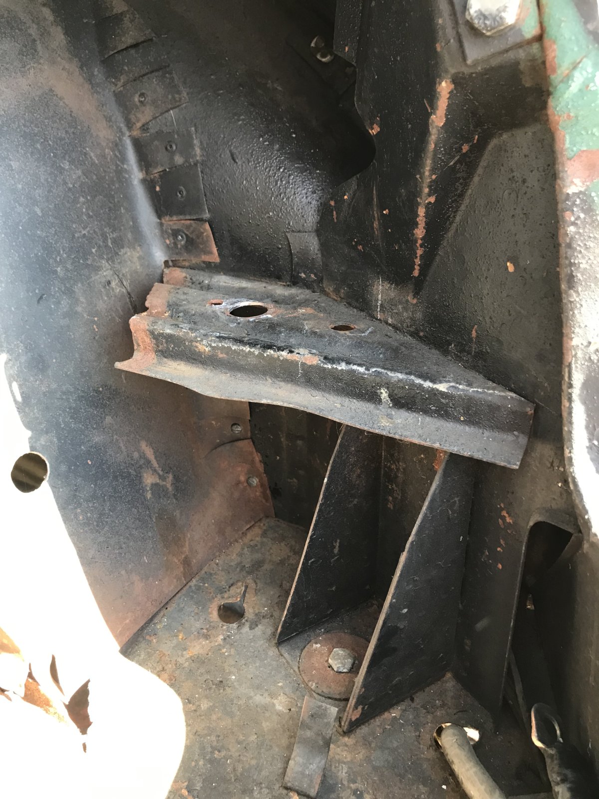

    I dug out the tank that I bought a long time ago and it was pretty obvious why I didn’t install it, it’s way too big. I don’t know what I was thinking but with that tank in place there isn’t room for the battery. I dragged out a tank that I built for my Dad’s old Flatbottom, it’s just 9 gallons but it would work. It’s not a good fit though. So I ended up ordering a 12 gallon aluminum tank that should be perfect.

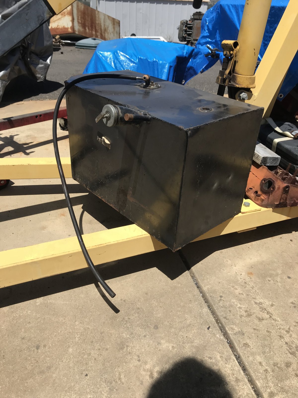

    Here’s the old one. I did think about sectioning the current tank but I’m not thrilled about cleaning and welding on used gas tanks these days.

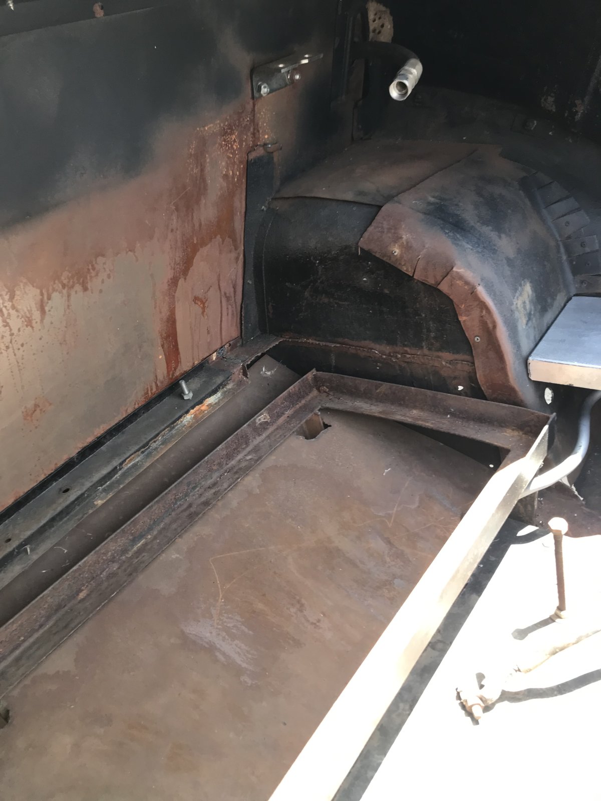

    Here’s the space available. The tank I ordered will fit into the existing bracket. I’ll try to do a little cleanup in there.

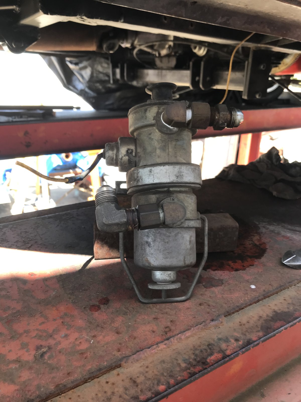

    Here’s the good old Stewart-Warner fuel pump. It will make its way into my roadster.

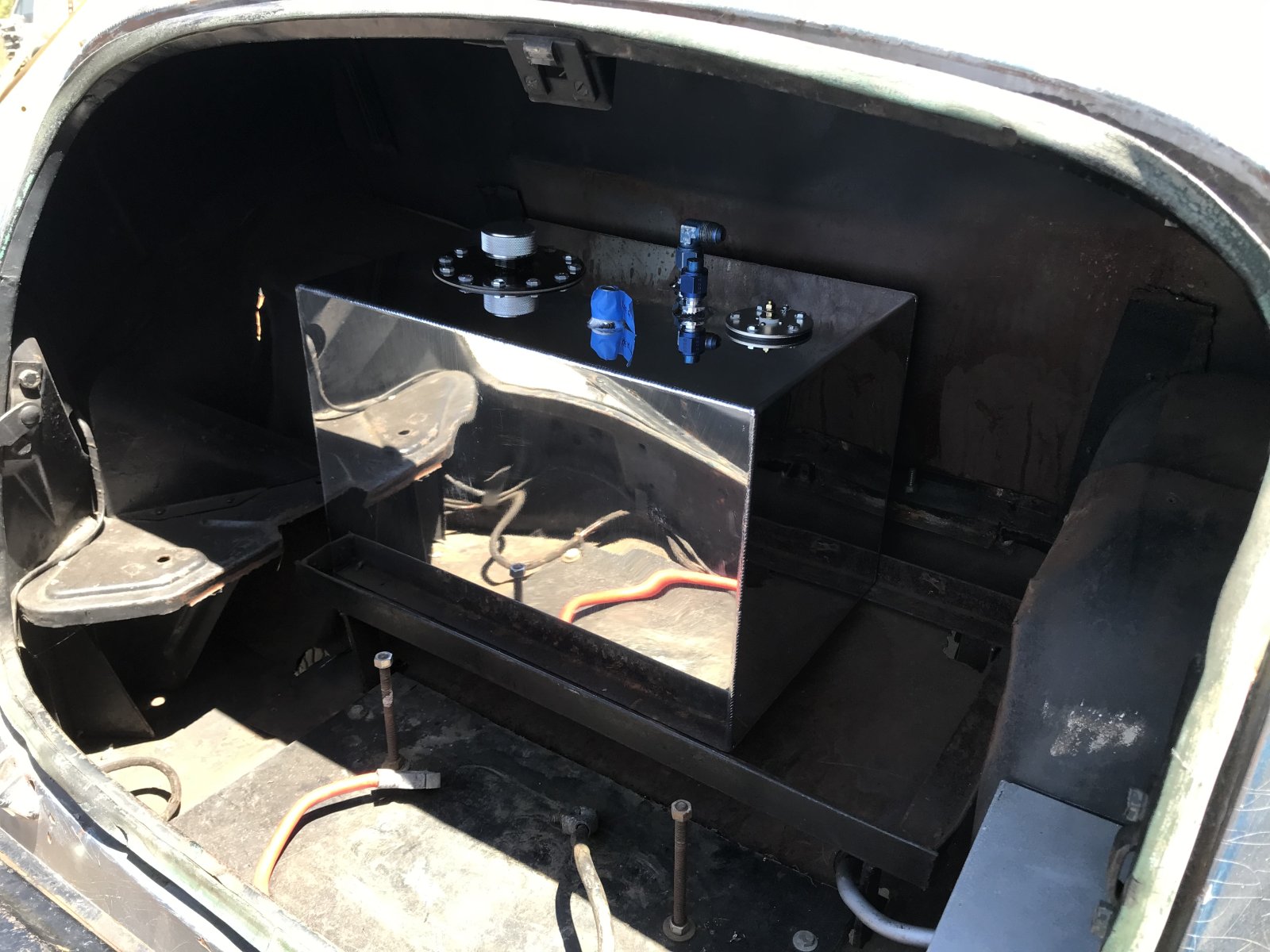

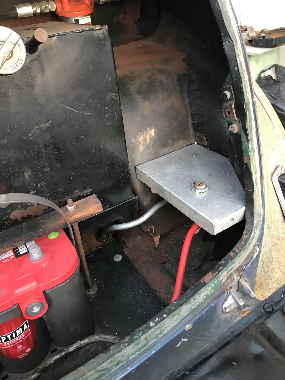

    I set my new fuel tank in to see how it fits. It fits great but it poses the same problem that it had before, it’s a ***** to fuel it up. My red coupe was the same. The filler is up inside the truck. I see two solutions, turn the tank 90 degrees and make a new mount, or put the filler in the body and run a hose up to it. Either way is ok with me. I guess I’ll flip a coin.
    I’ll scuff it up with Scotchbright no matter how I mount it.

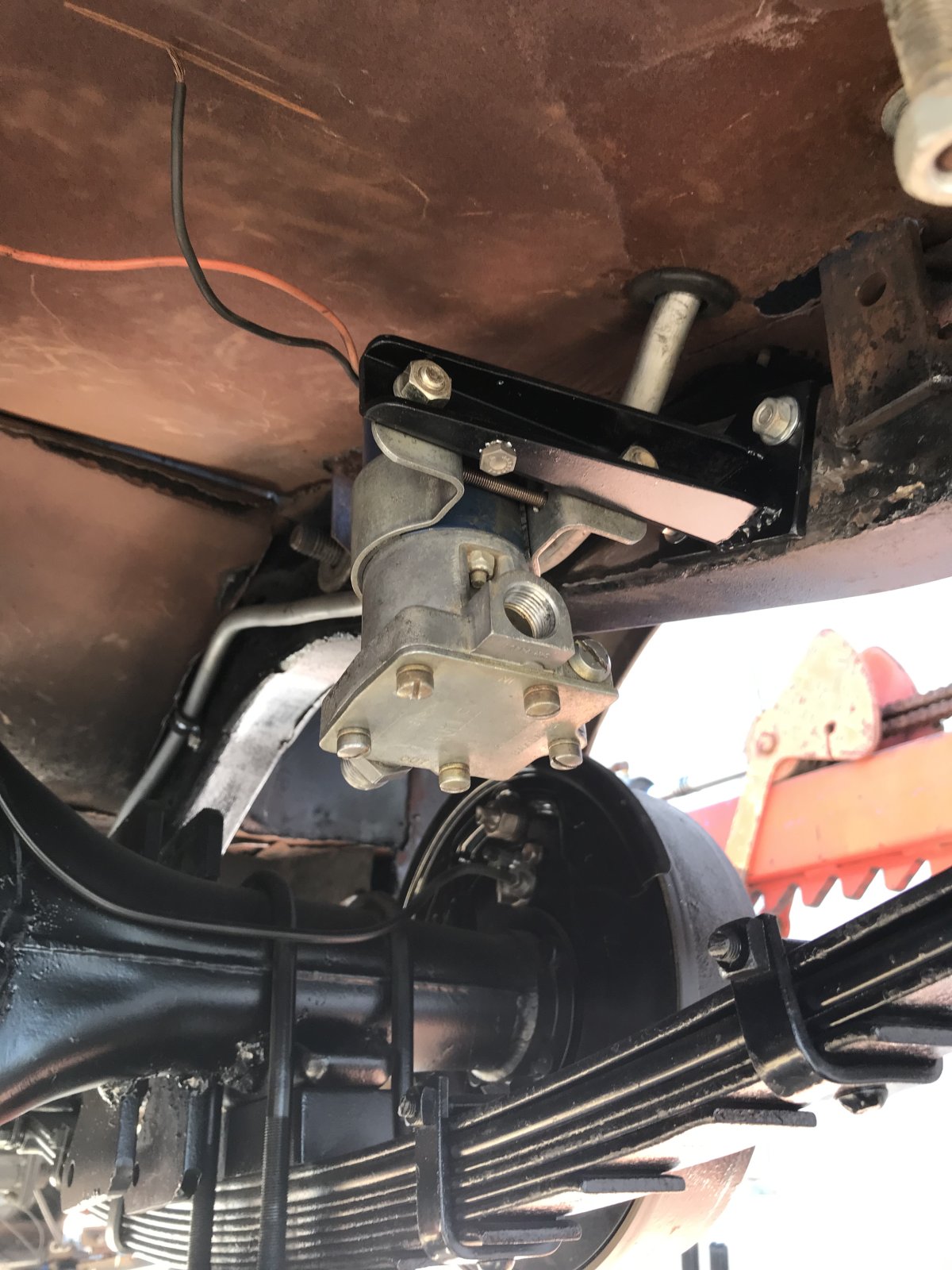

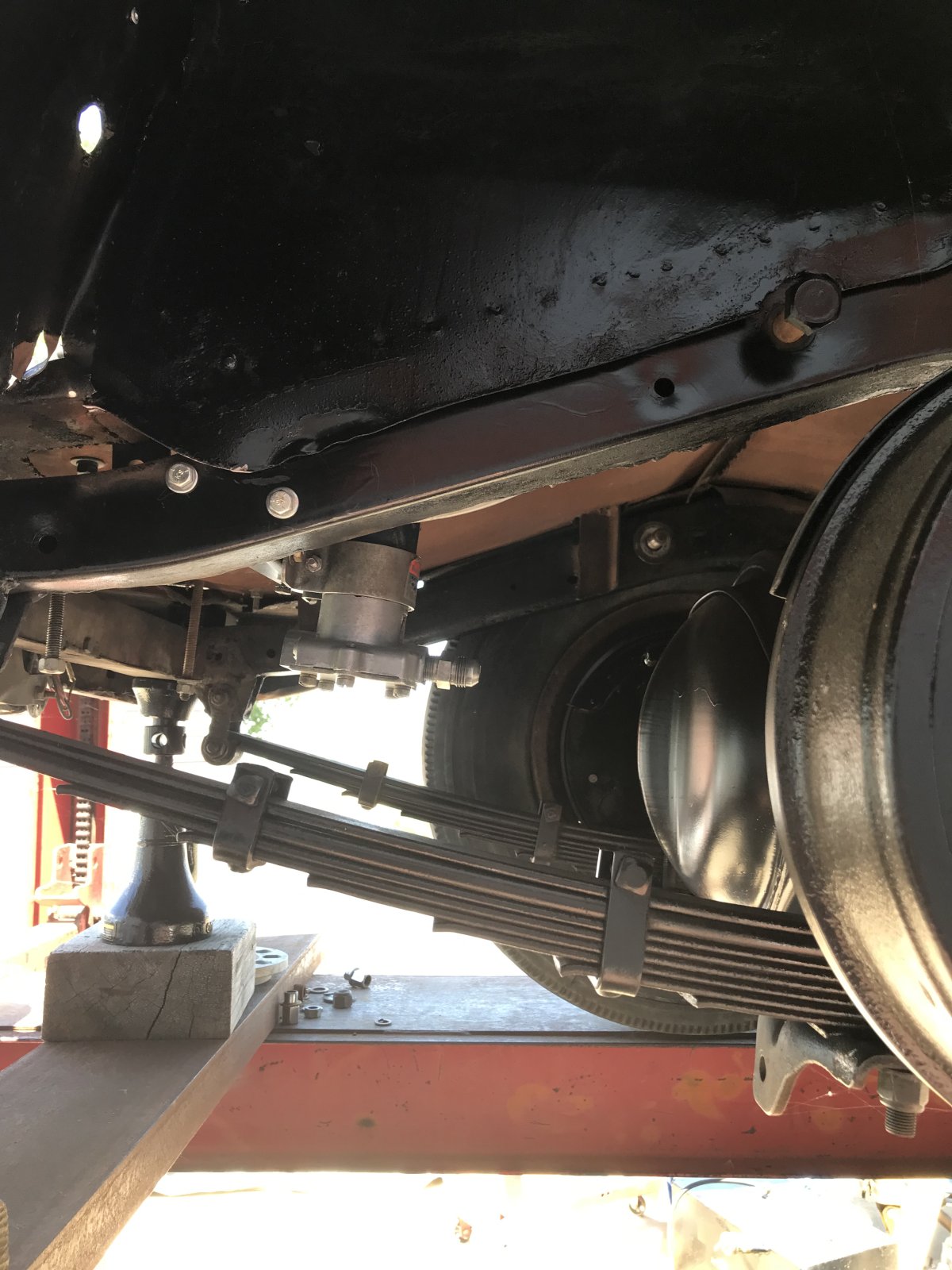

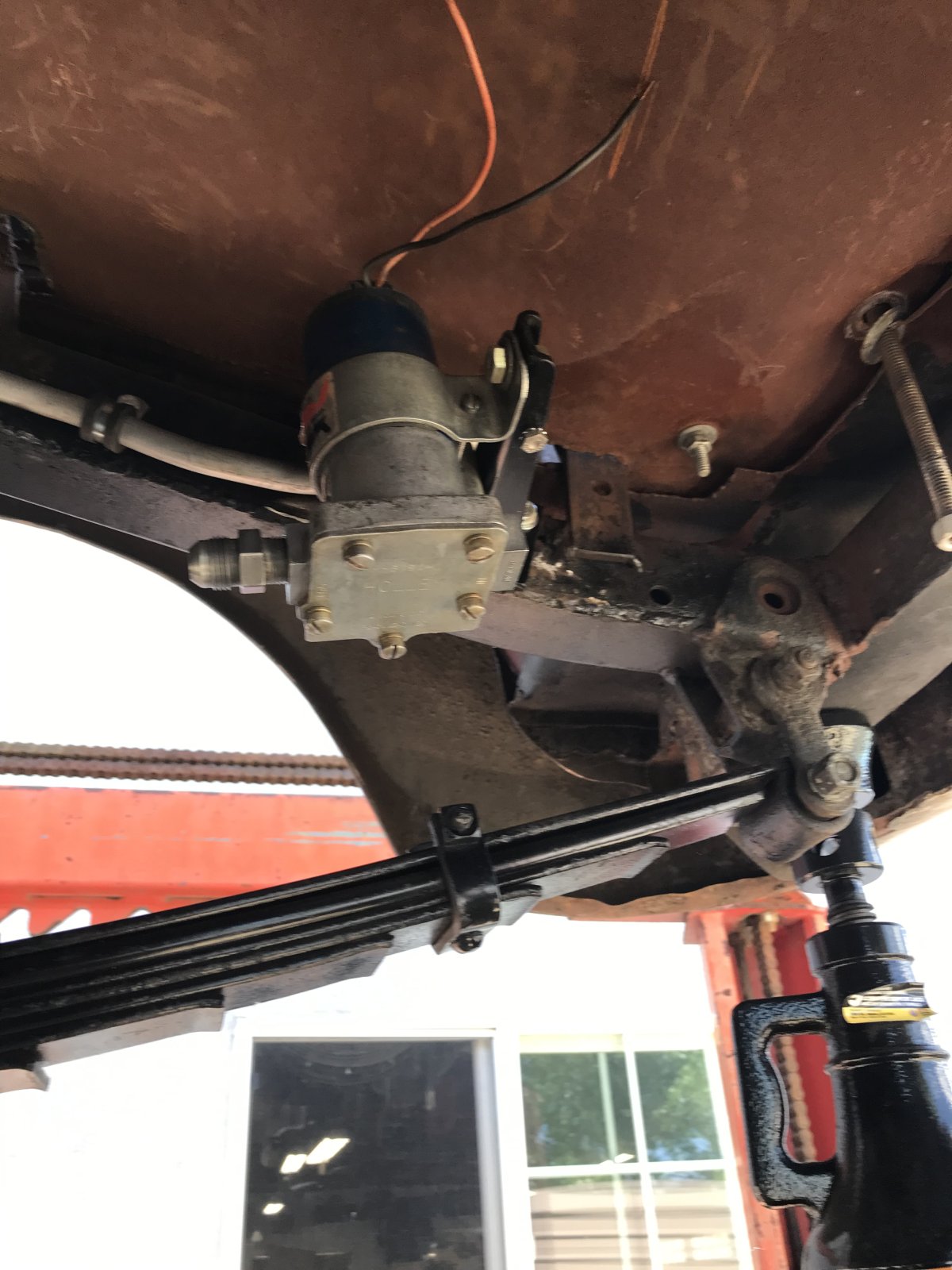

    I also made a fuel pump mount for the Holley blue pump I’ll be using and got the pump mounted to the frame rail. It looks tilted but the car is off the ground in the back so it’ll be level and out of sight when it’s back on the ground.
