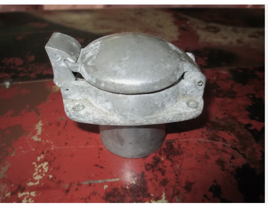

    I went out to the shop with the little bubble envelope from Speedway that came while I was gone and added some AN fittings to my selection.
    I took my smallest tape measure out and opened the trunk of the Austin to figure out how and in what orientation to mount the new fuel tank. I’m going to rotate it 180 and put a flip-up filler cap in the body panel above the tank.
    That puts the pickup in the back and the filler in the middle. I think I have a cap from a sixties Triumph around here somewhere but just in case, I bought a used cap off eBay cheap. Either one should look like something that the original builder might have used in the ‘64-66 timeframe. And it will be waaay easier to fill than it was. Here’s the eBay cap….
    Same as on my 1964 flatbottom.
    Progress, and I hardly lifted a finger. There is stuff you can do safely even if you’re benched.

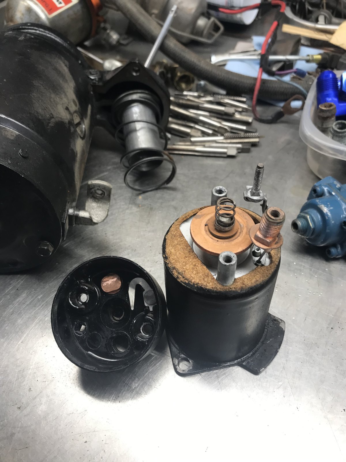

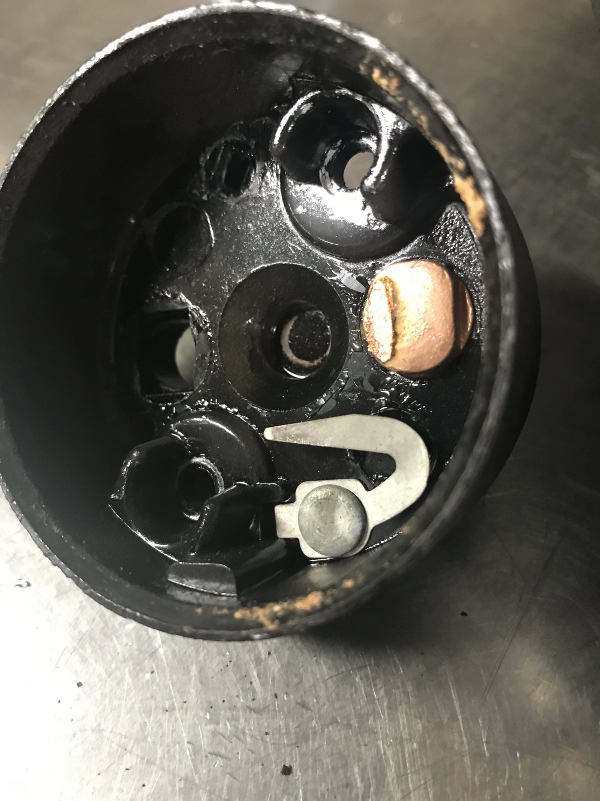

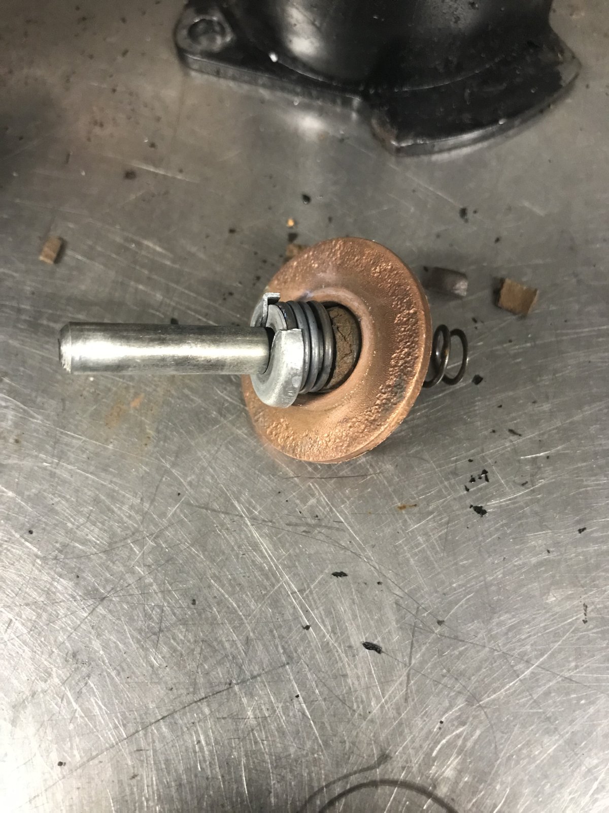

    A little update. With much of my family in town, I tried to fire up the Stude and drive it to my sisters for dinner. They haven’t seen it yet. I’m Weird Uncle Bob, long hair, rode Harleys, played in bands, never had kids of my own, always drives strange cars. My family never knows what kind of contraption I’ll drive up in. I give them all rides in my hot rods but none have caught the bug so far.
    No go. Turn the key and it just clicked. It acted like the battery was dead, so I put the charger on it. Later I tried again but still it just clicked. Dang.
    After testing the ignition switch, the neutral safety switch and the connections I figured it had to be the solenoid. I’m under “Doctors Orders” for another week but I just don’t like being without my parts chaser so I figured out the best way to jack it up without straining myself and carefully crawled under it on several layers of moving pads. I put spade connectors on the small wires so I don’t have to struggle with the S and R wires, just unplug ‘em. Two bolts and the starter was sitting on the torsion bar. I put a big pile of towels under it and let it drop. I pulled off the solenoid and found that the insulating spacers/washers on the big copper washer had broken up allowing the big copper washer fall out of place and not complete the contact between the battery cable and the starter terminal. Excellent. I have plenty of GM starter parts, I’m sure I have what I need to fix it.
    Note there’s nothing left to hold the big washer perpendicular to the rod. That’s debris from inside the solenoid on the workbench above….
    The contact will need reversing or dressing….
    There’s a candidate, lying on the floor with the other parts I salvaged from the lovely chrome starter that came on my red coupe and dis***embled itself as soon as I pulled into my driveway. I have other, original GM bits stashed in this place somewhere.
    Enough borderline violations of Doctor’s Orders for today. I need to think of a way to get the starter back up in place without actually lifting it. I’m pretty sure the good doctor would consider lifting a 15 lb starter from an awkward position under a truck, straining. I’m hoping my little floor jack will do it.

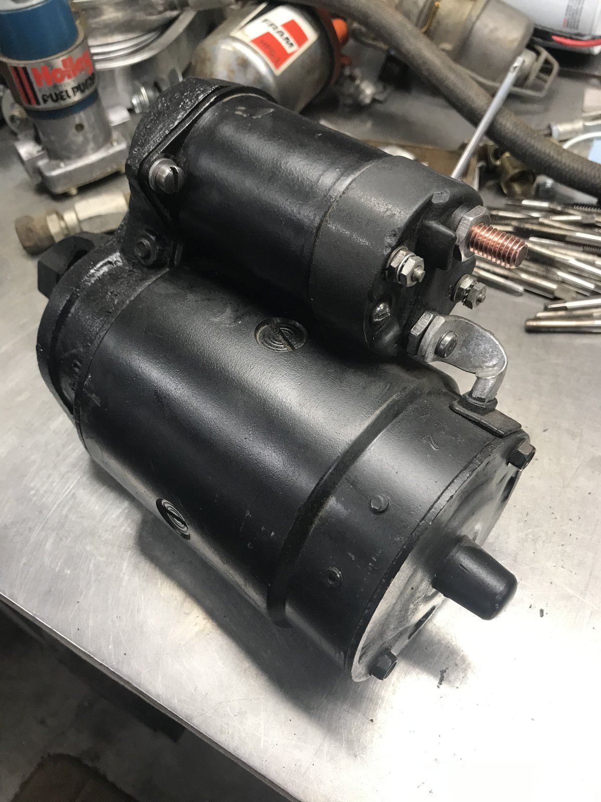

  30. bchctybob
    Joined: Sep 18, 2011
    Posts: 6,007
    bchctybob
    The starter, back together and ready for installation.
    74FF6B68-4F6A-4699-B39F-796BABA40D91.jpeg CC2A1DE5-6DAE-4F29-897D-AC3298268846.jpeg
    As long as it was up in the air, I took the opportunity to clean the front wheels and apply a good coat of wax.
    I smile every time I look at the chrome wheels with the Cal Custom Knock-offs. Thanks Black Panther….
