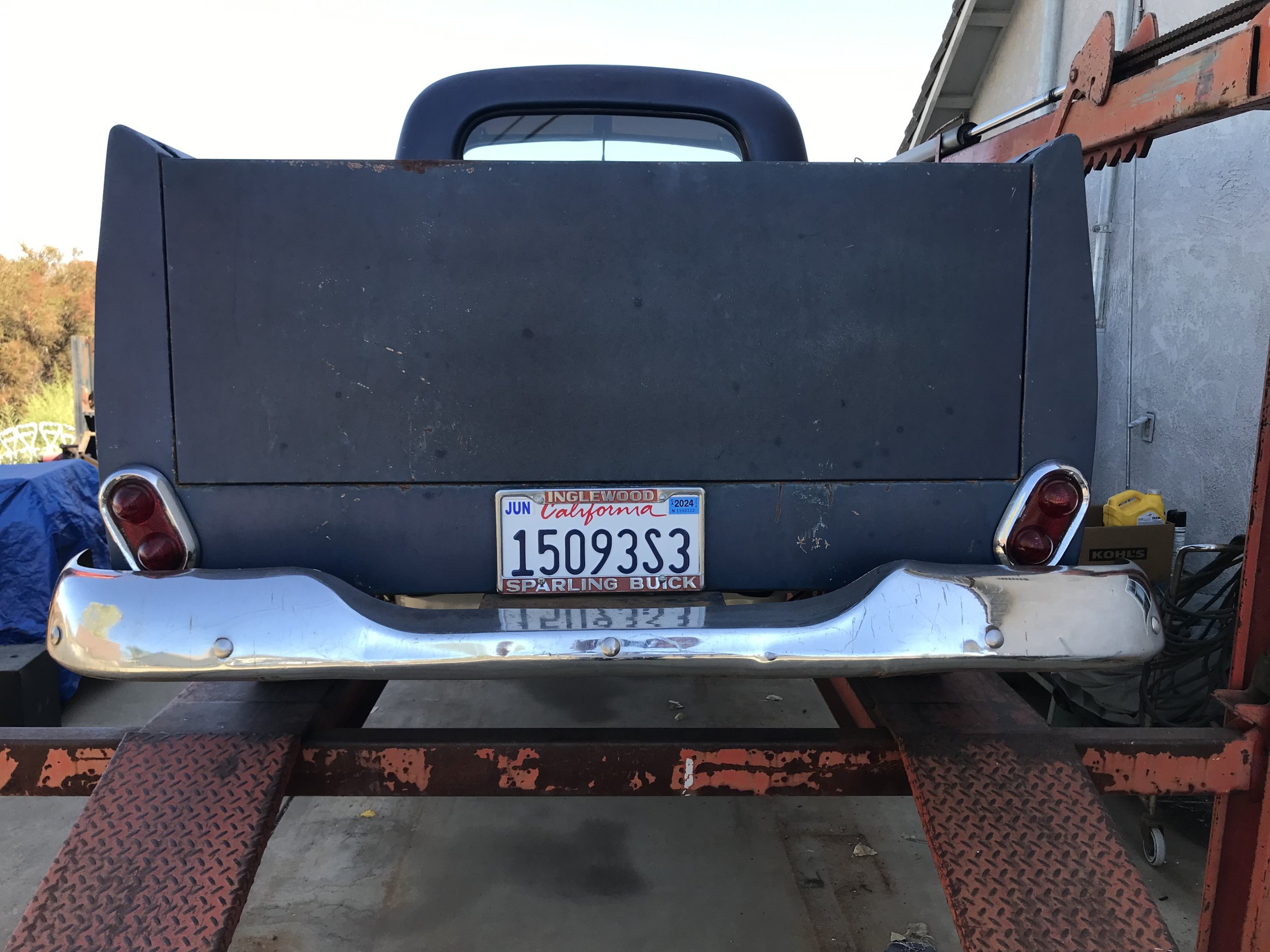

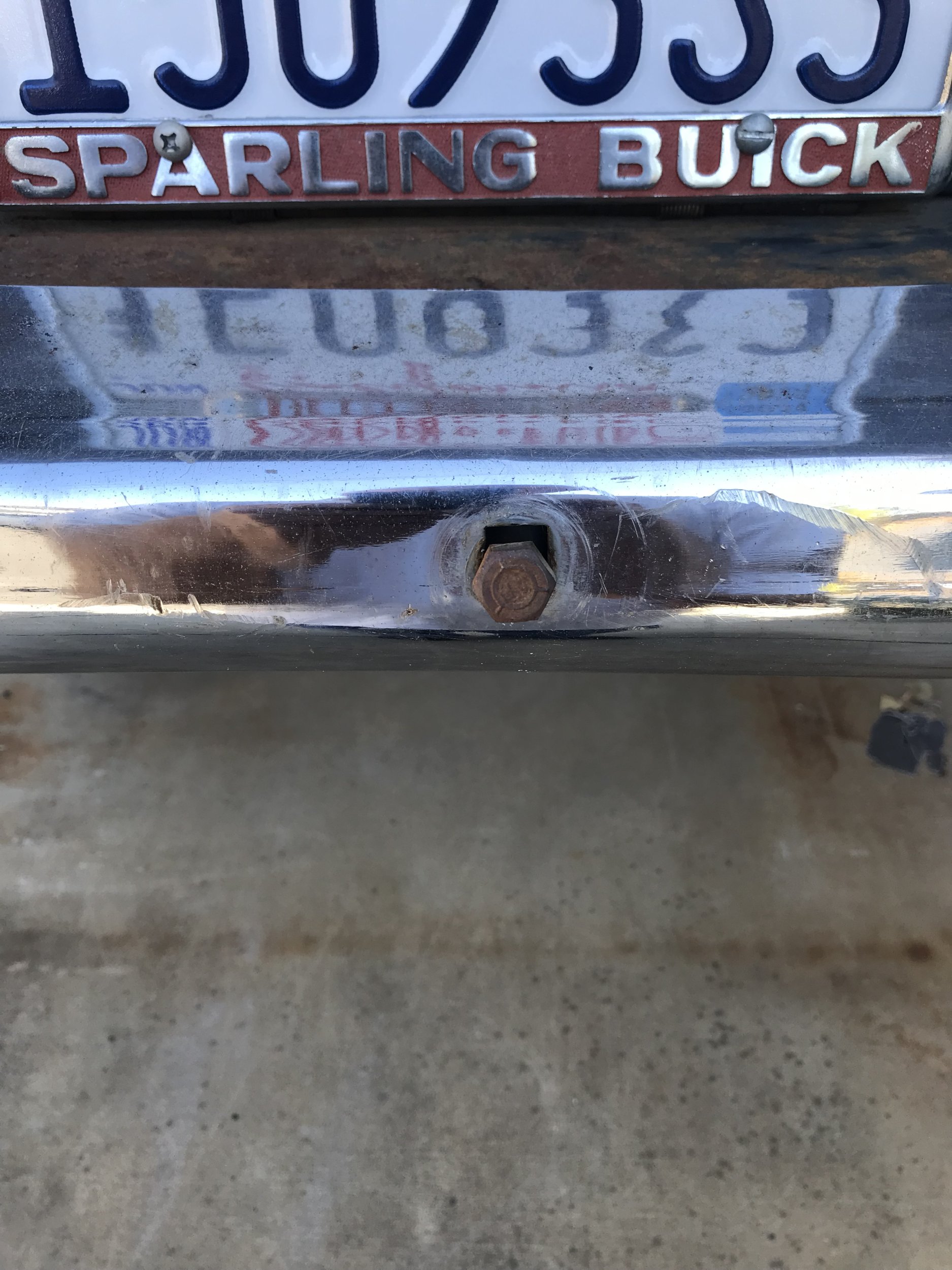

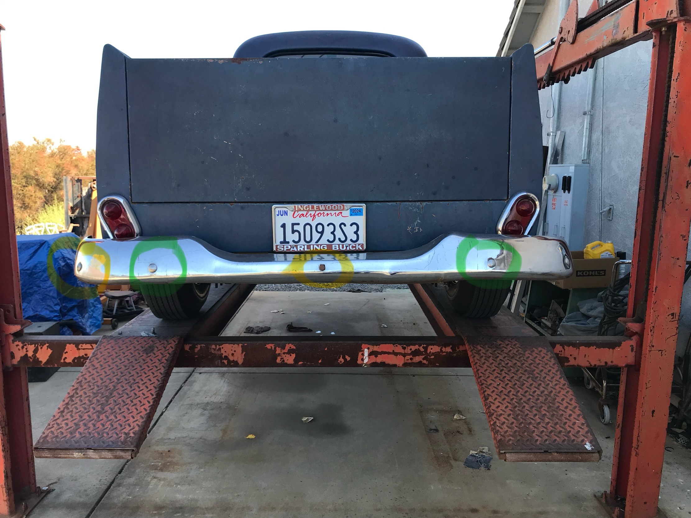

    Some things just bug me. The rear bumper on the Stude. It’s a little too high to my eye, it’s wrinkled in a few places and it’s held on with hex bolts instead of real bumper bolts (remember those?).
    Looking for instant gratification, I wasn’t going to remount it or try to straighten it, but I could at least deal with the missing and wrong bolts. The ones circled in green were missing and the ones in yellow were rusty old hex bolts.
    I dug into my stash of old bumper bolts and made it look a little better.

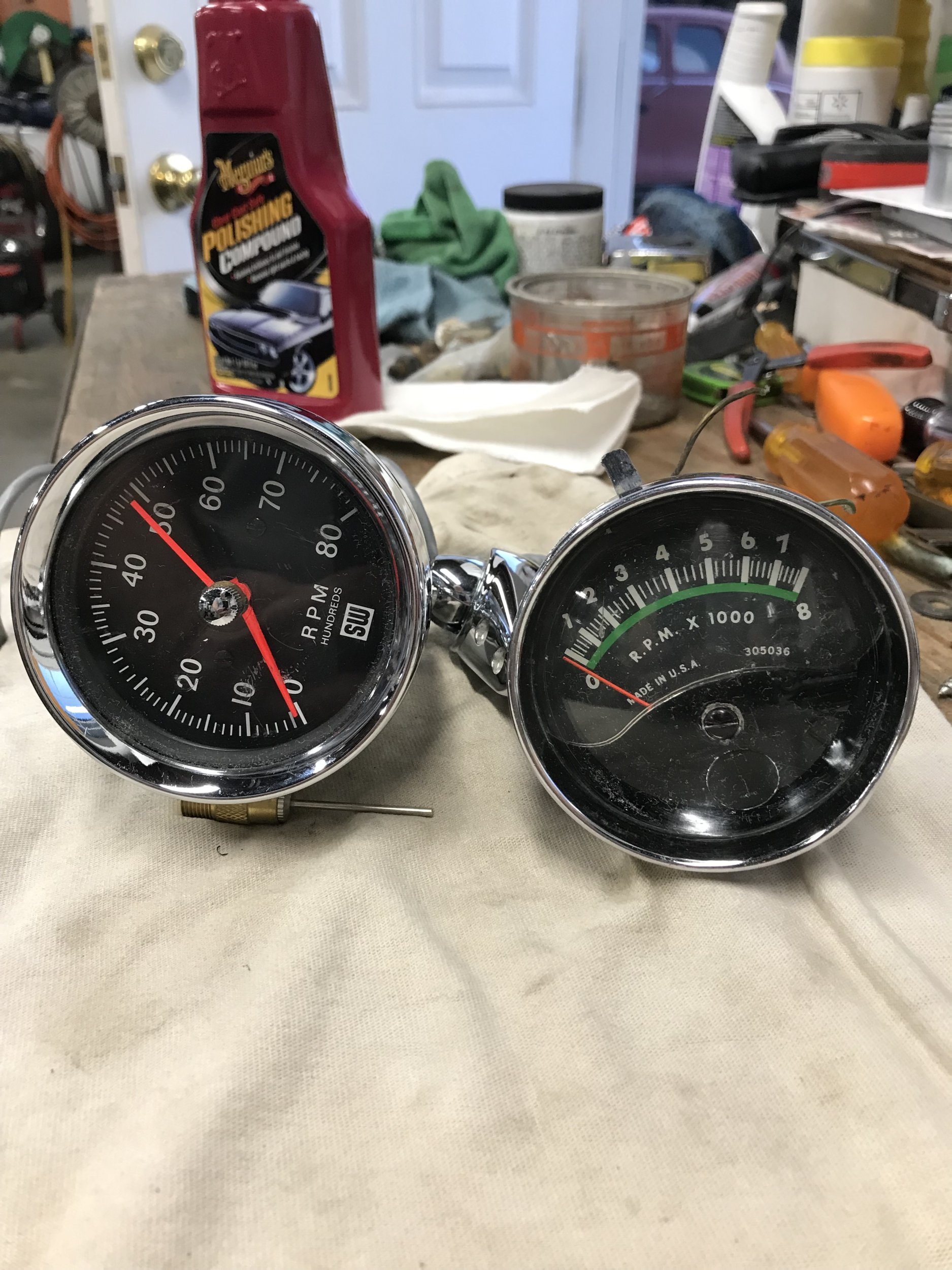

    I went to Bakersfield last weekend for the California Hot Rod Reunion. I decided to hit the swap meet right off the bat. I was looking around my shop for a steering wheel for the Austin and noticed that my steering wheel inventory was getting low so the first item on the swap meet list was cheap useable steering wheels. I stopped at the Mooneyes booth for comparison and a simple black steering wheel is $130 or $150 now. I found these three for $15 each…… one is foam, I’ve never used a foam one, we’ll see
    I was also looking for a suitable tach for my Stude pickup and found these. One for $60, one for $20. I’ll test them on the Stude tomorrow. Either one would be just fine.

    Well, I’m glad I didn’t pay too much for the tachs. (or did I?) I looked up the wiring for the nice Stewart Warner one but when I hooked it up to the old Stude it did absolutely nothing, it didn’t flinch. I tried several different grounding points, nada. Who repairs S-W tachs?
    I had to repair/replace a couple wires on the other one and it works, kinda. It shows 2000 rpm at idle (actual = 650) and it does climb with increased rpm.
    I just took an educated guess at the wiring of the little one based on the remnants of wire left behind. Two were obvious: the red wire led to the light, and a black wire led to case ground at the light base. The green wire disappeared into the mechanism, so I ***umed that it was “coil - “. There was a contact that had a brown wire jumpered over to the black wire at the light ground. And there was another separate contact next to the brown wire with a stub of copper wire sticking out of it - I ***umed that this should go to the ignition switch.
    With that last wire connected to the ign post at the switch, the tach reads full scale, with it disconnected, it acts normally but seems to read high at idle. Any thoughts?

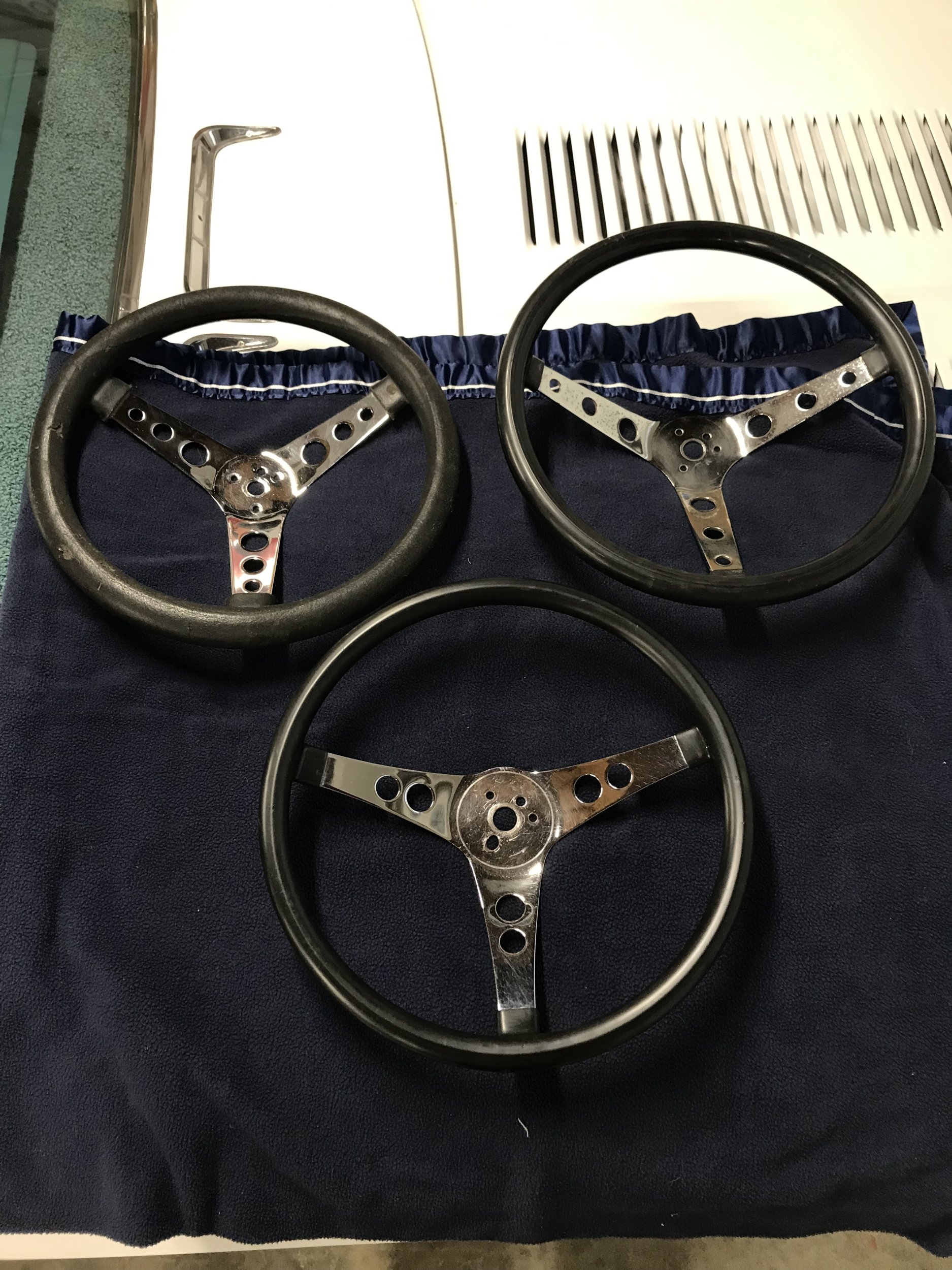

    Oh well, at least the steering wheels work like they’re supposed to….

    Every tach I've installed has had 4 wires:
    Red, Ignition hot
    Black, Ground
    Green, Coil Negative
    White, Light.
    Devin
    bchctybob and porkshop like this.

    Yeah, me too. And the S-W tach was true to form, but the little cheapie tach had a factory red wire going straight to the center contact of the night light. Pretty obvious. There are two small round contacts protruding from the insulated back plate. One had a brown wire which jumped over to the outer shell of the light socket along with a black wire that exits the case. Again, pretty obviously a ground. The other contact had a wire broken off right at the contact with no insulation left for identification. I ***umed that it would be “power in, from the ignition switch”. The green wire disappears into the body and I can’t tell where it goes. All of the wires were cut very short, just barely sticking out of the back.
    I’ll probably just have the Stewart Warner tach fixed if I can find someone to do it.

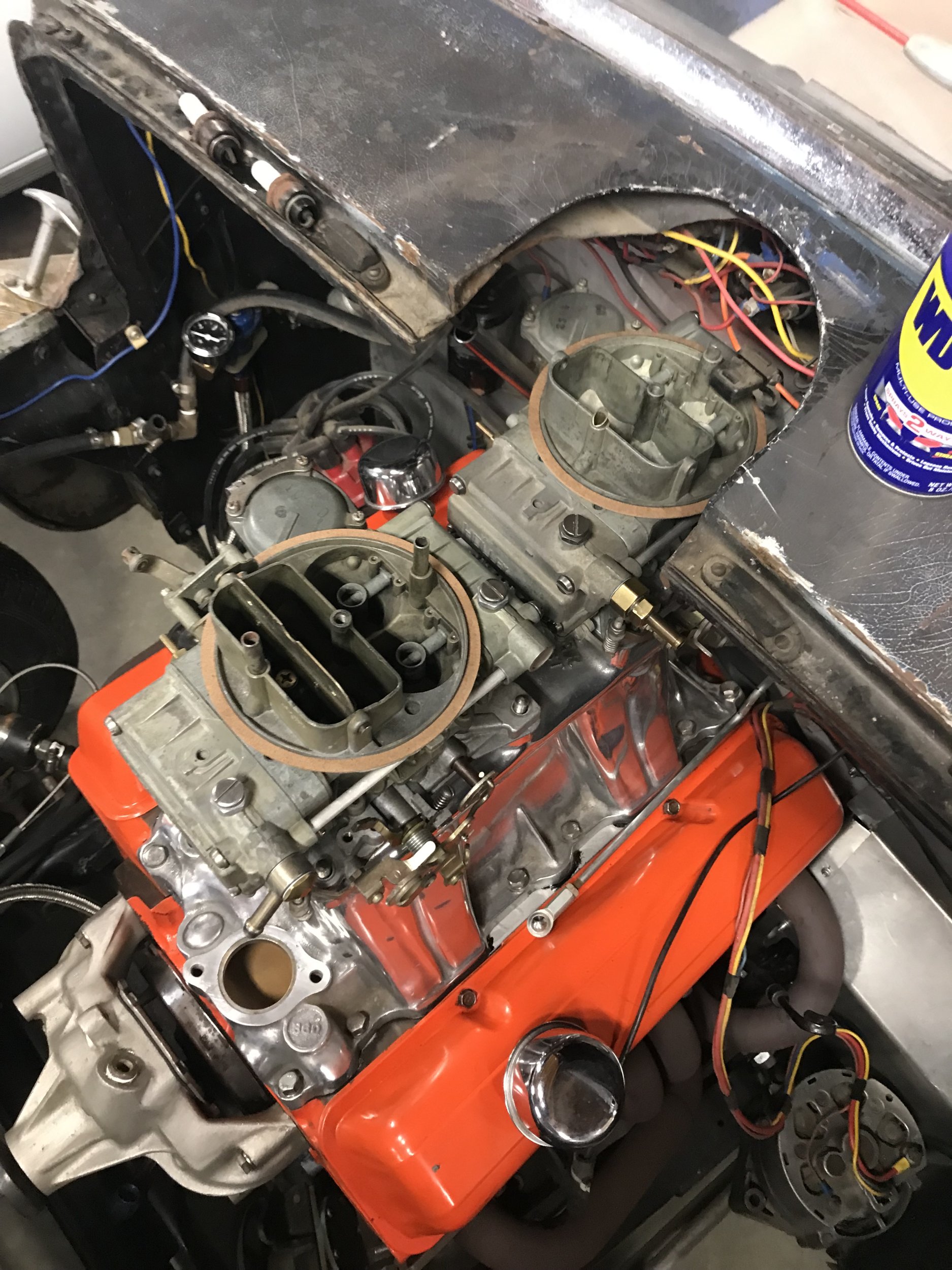

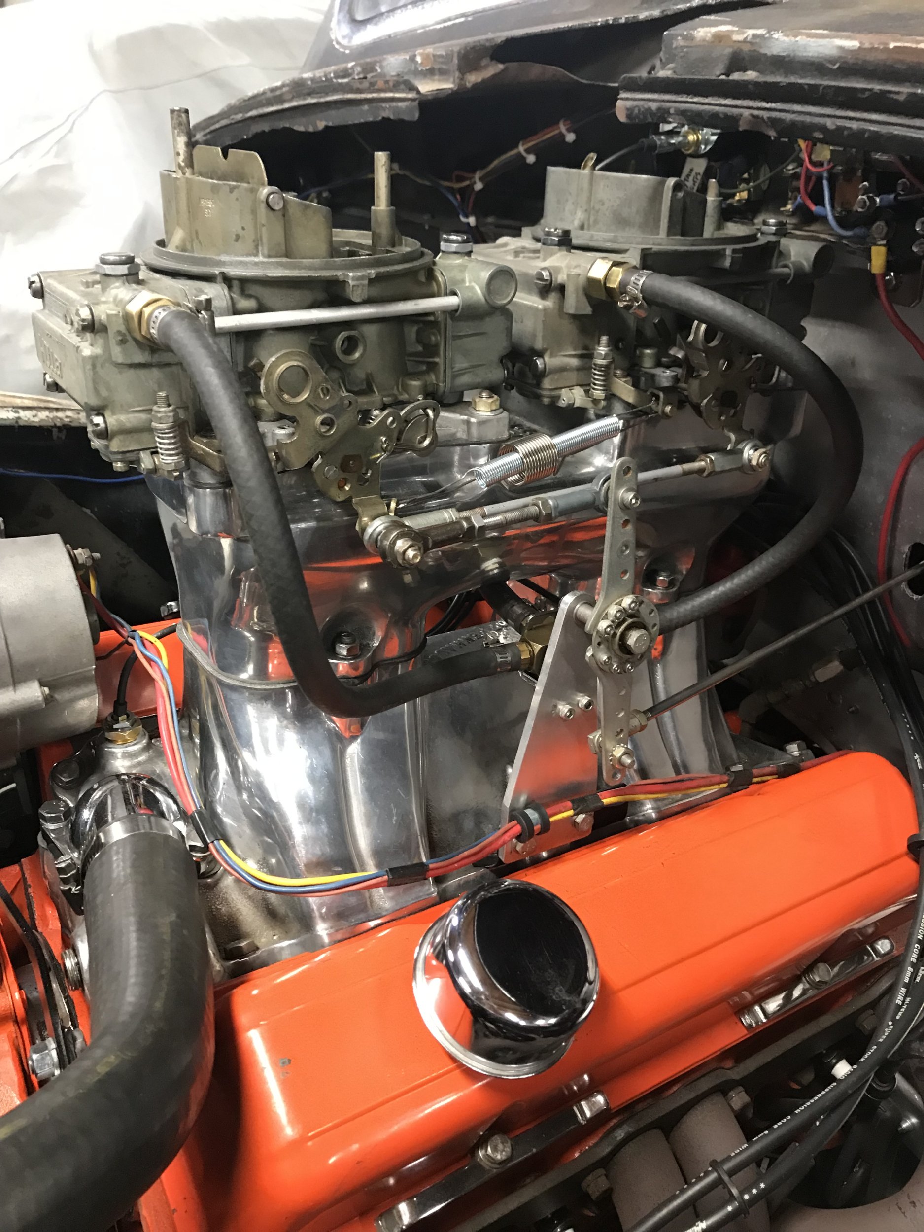

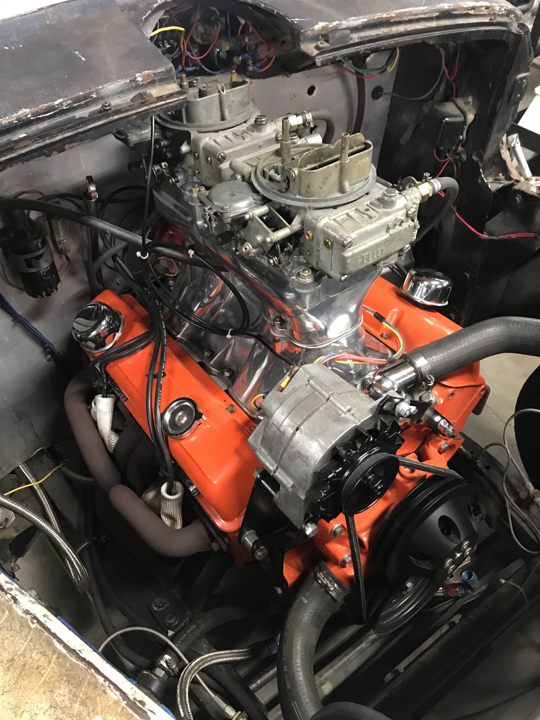

    I completed a couple projects around the house and got back on the Austin. I pulled it into the shop for an intake swap. (The wife caught me working instead of sitting and watching the drags on tv)
    Off with the huffer….
    and on with the tunnel ram.
    Things are a little cramped with the ignition switch and wiring. I think I have a way to relocate the switch away from the carburetor with a minimum of rewiring.
    I should have moved the engine forward when I installed the blown motor but it meant lengthening the driveshaft and building new headers. I was in a “minimal changes” state of mind at the time so I left it alone. Now, even with a long water pump, the fan is 7-8” away from the radiator. I’m going to try running it with just the electric fan I guess.
    Taking tomorrow off to go look at another bucket list acquisition. Unfortunately it’s a year outside of the HAMB guidelines - a big block ‘67 Ranchero. The madness continues…..
    BigJoeArt, catdad49, enloe and 10 others like this.

    Ha...the rear carburetor, to back of dash / wiring, looks like the mess that I recently bought !
    At least you have two carburetors, I can only fit one.

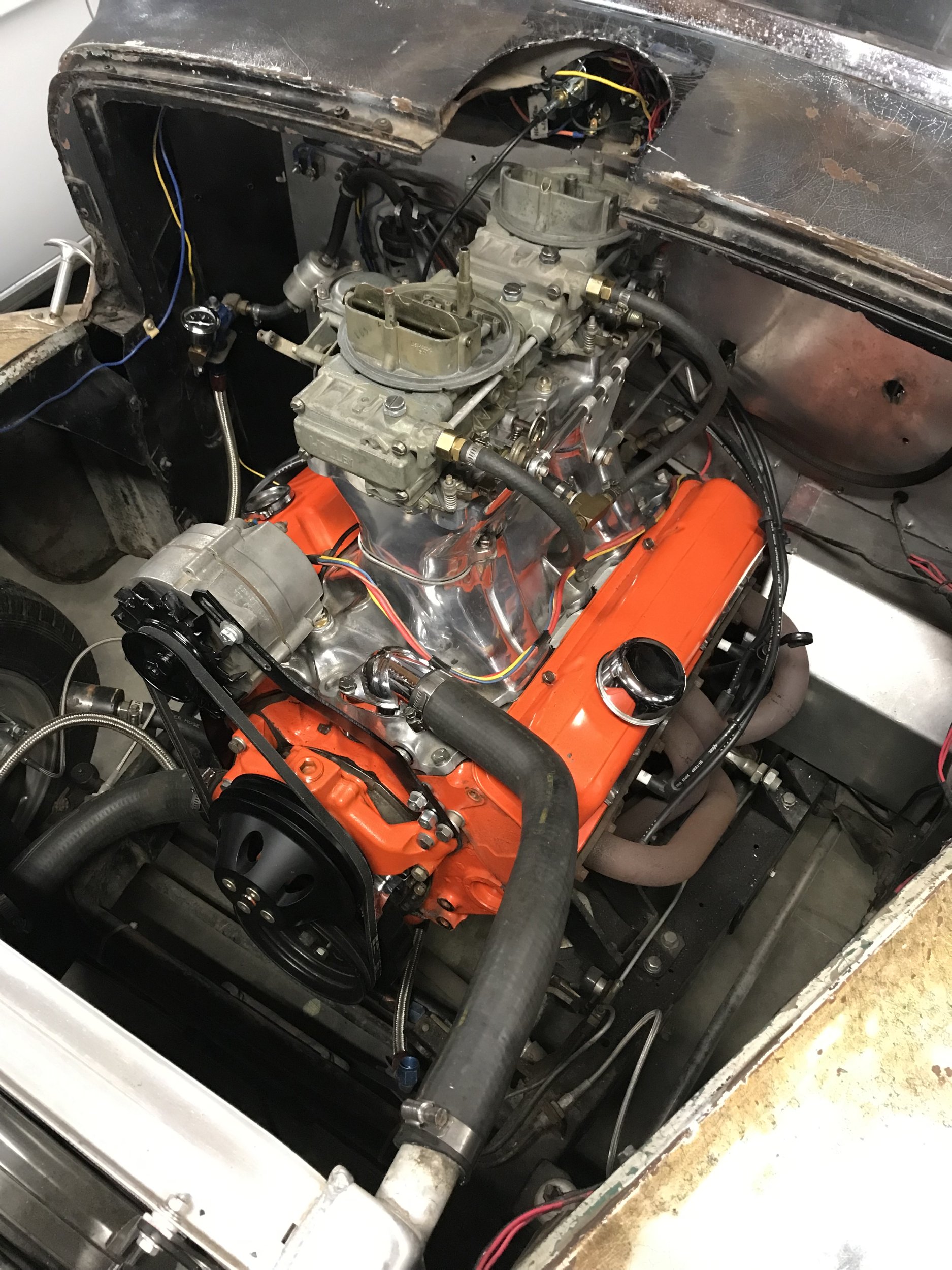

    I moved the ignition switch from the middle to the far left, made the Headlight switch a toggle instead of the big push-pull switch and made a fascia plate to spruce it up a little. The wife has been watching “The Crown”. I guess it got to me subliminally ‘cause my plate came out looking a little crown-ish. Well, it is an English car. I didn’t have a big enough piece of engine turned material to cover all the way to the ign switch.
    After some redressing the wires clear the carburetor much better.
    The intake and carburetors are installed, distributor, linkage, everything is back on. I did have to make brackets to relocate the alternator.
    I’ll do a sanity check tomorrow, hook up the battery and hopefully fire it up. I have no idea how close the tune up will be, the #1850 Holley carbs have factory jets. We’ll see.
    Nothing amazing, just progress…..

    It runs!!! It fired up instantly and ran pretty good right off the bat. A little ear tune up and it was idling well and seems very responsive. As usual, there were a few leaks but they are fixed now.
    Looking forward to taking it for a little spin. Gotta build a battery hold down and check a few things. After messing with the wires, the headlights don’t work. There’s power going in and out of the dimmer switch but it seems to stop there. I’ll fix it.

    the S/W 970 series tachs require a sending unit called an ignition monitor
    https://www.ebay.com/itm/135086718248?chn=p***kevt=1&mkcid=28&google_free_listing_action=view_item
    BigJoeArt, catdad49, enloe and 4 others like this.

    Well damn Mark, I think he had that unit sitting right there on the table! I didn’t know that I needed it. The seller didn’t seem to know much about anything he was selling.

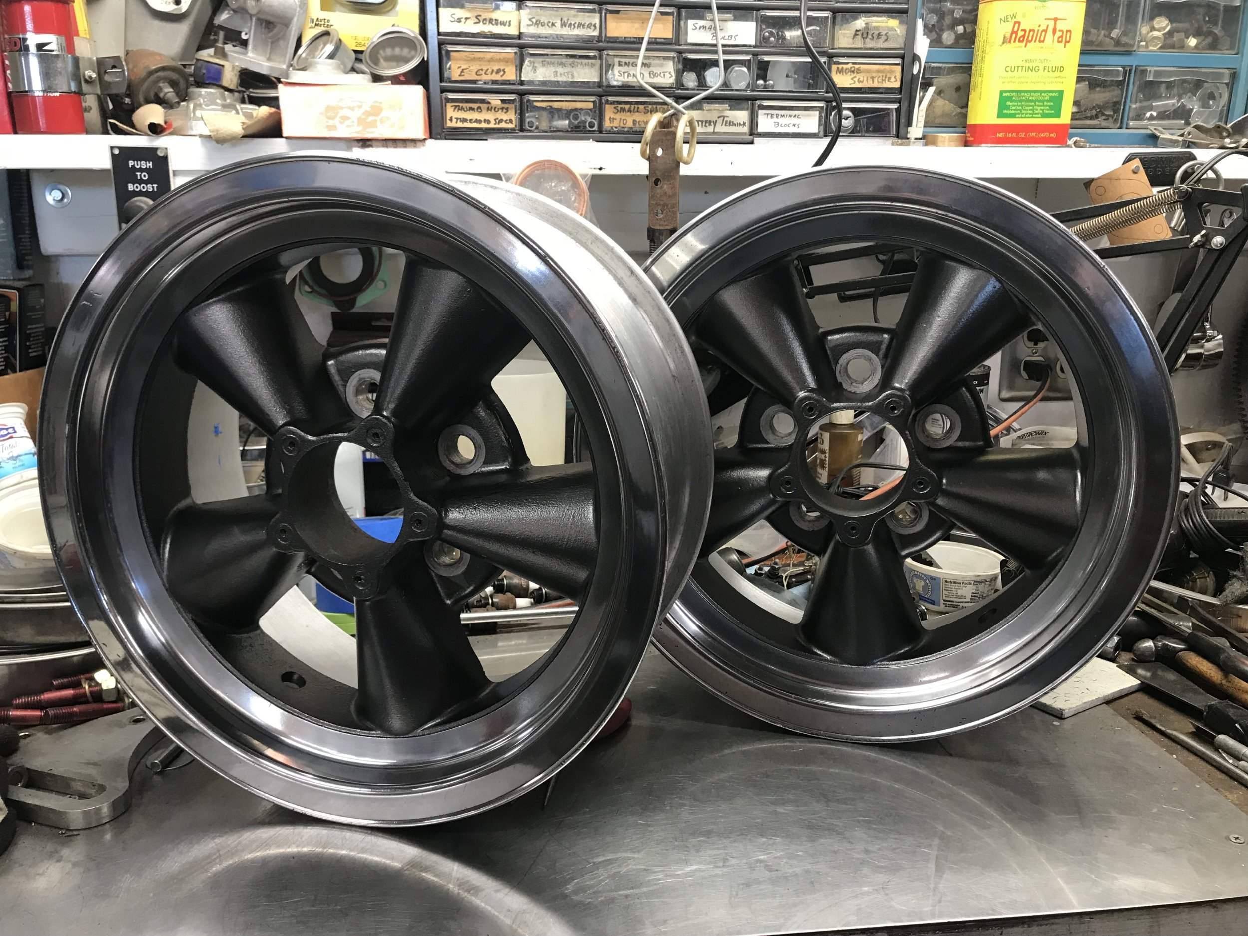

    I dragged some old wheels out of my stash and spent a little time cleaning them up to use on my latest acquisition.
    Ford factory 15x7s.
    Real American Torque Thrust wheels from the late 60s. I finally get to use them. The color is a little dark in the picture, better outdoors.

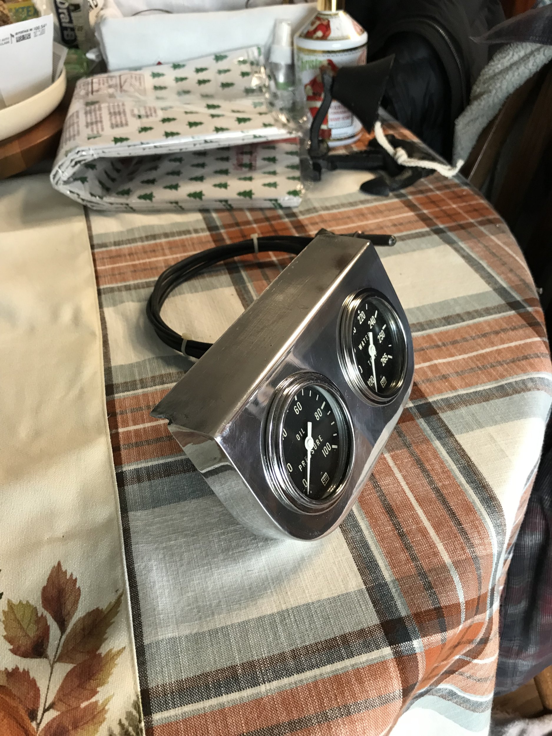

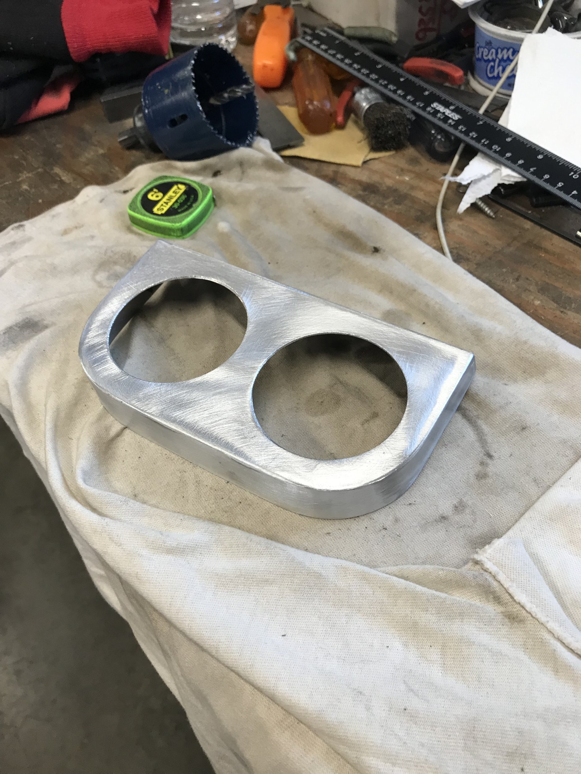

    After searching the internet for a suitable under dash bracket for two 2 5/8” gauges and not finding anything that I would spend my hard earned money on, I decided to try my hand at making one. One piece of s**** aluminum and a few hours later, I had what I wanted.
    I put some angle into the mounting surface so it will be facing the driver instead of the seat bottom.
    After a little sanding and polishing…..
    I had to swap parts with a couple oil pressure gauges to get one that matched the temperature gauge, it was worth the extra effort.

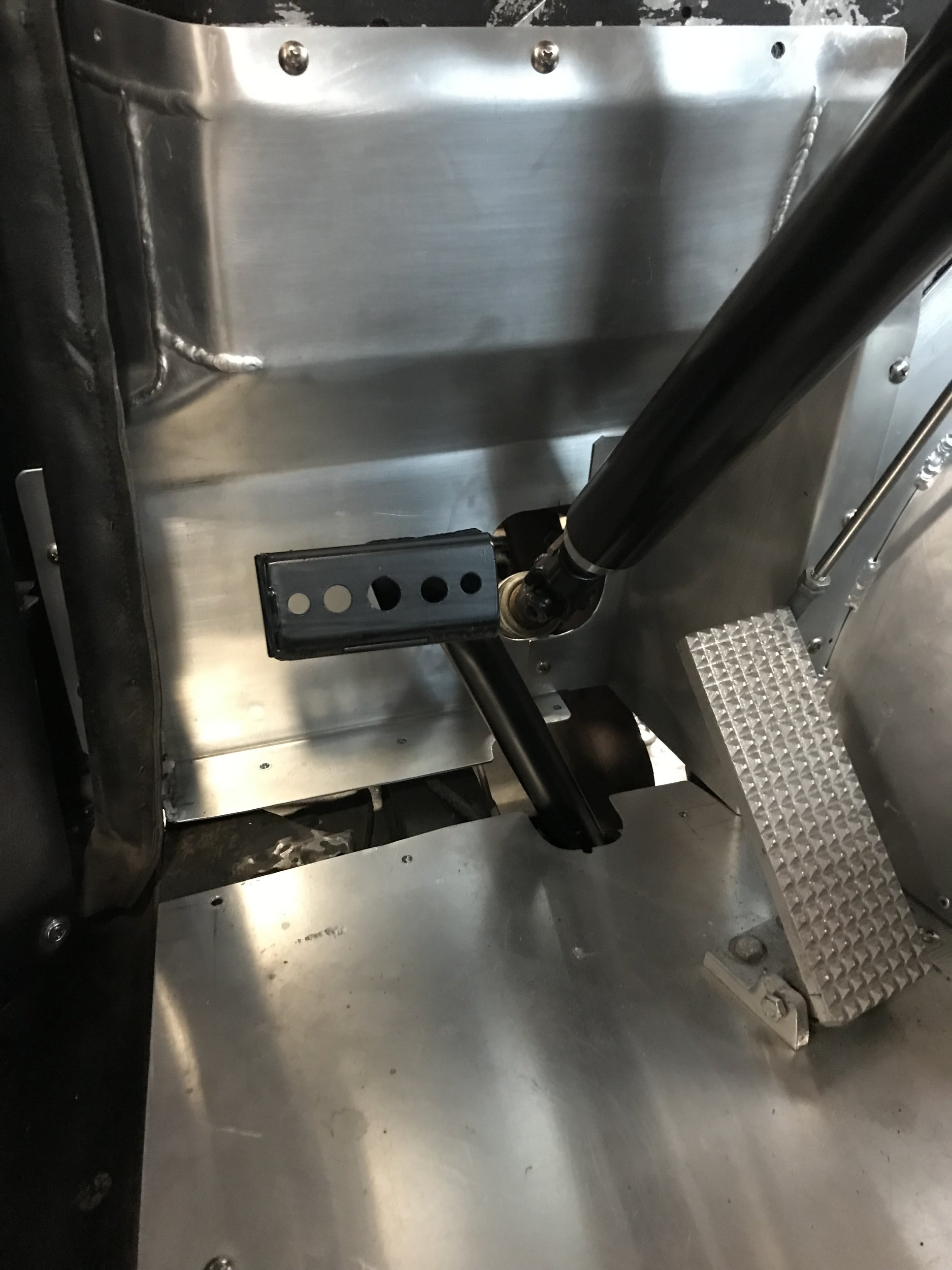

    The Austin is running and driving again. The first drive revealed that the gas pedal was too hard to push and the brake pedal needed some work. I reinstalled the throttle linkage that worked well on the blower. Much better….
    I added a piece to the brake pedal to make it bigger and slightly closer to the seat. It’s better, but still not quite right.

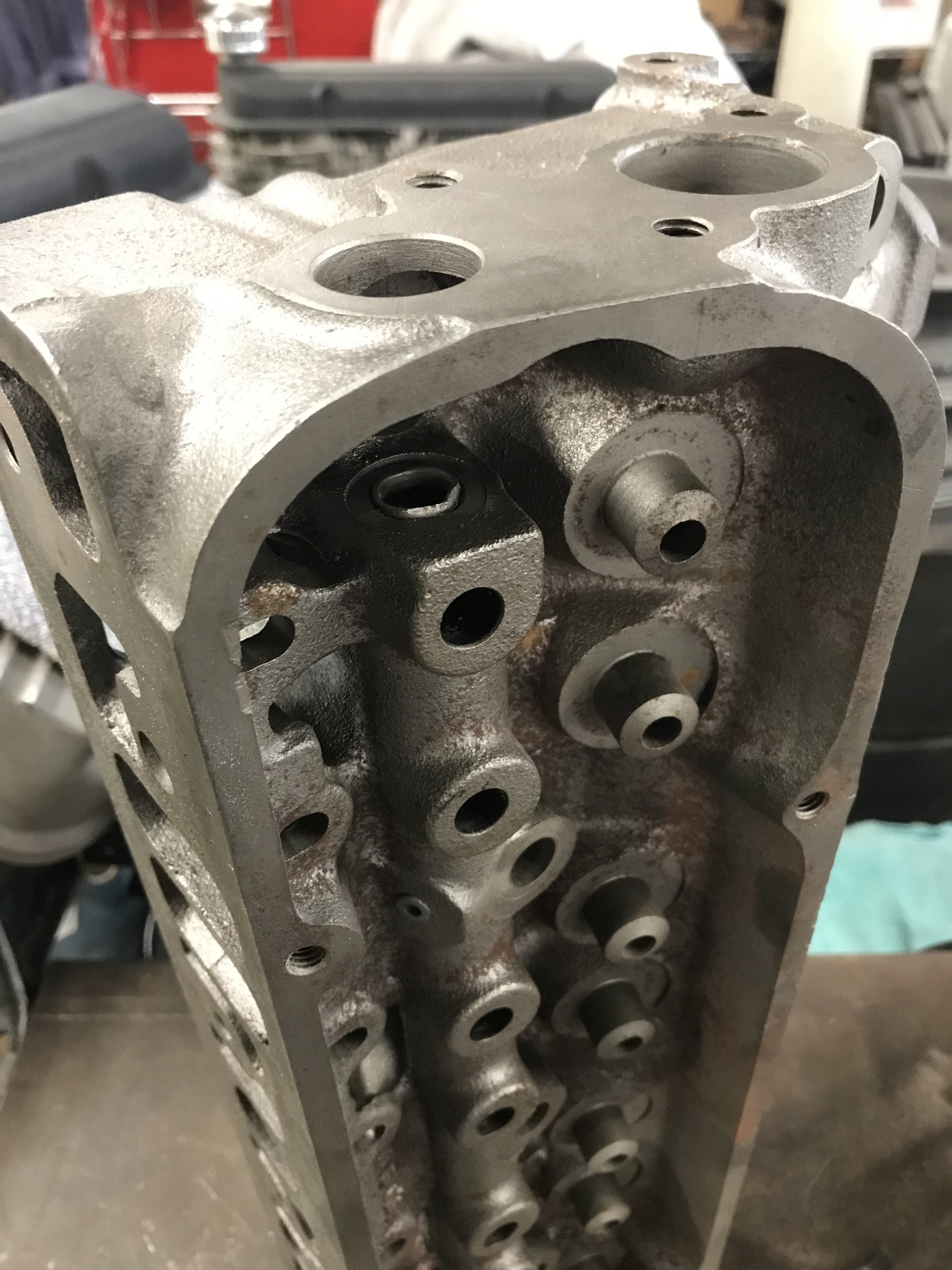

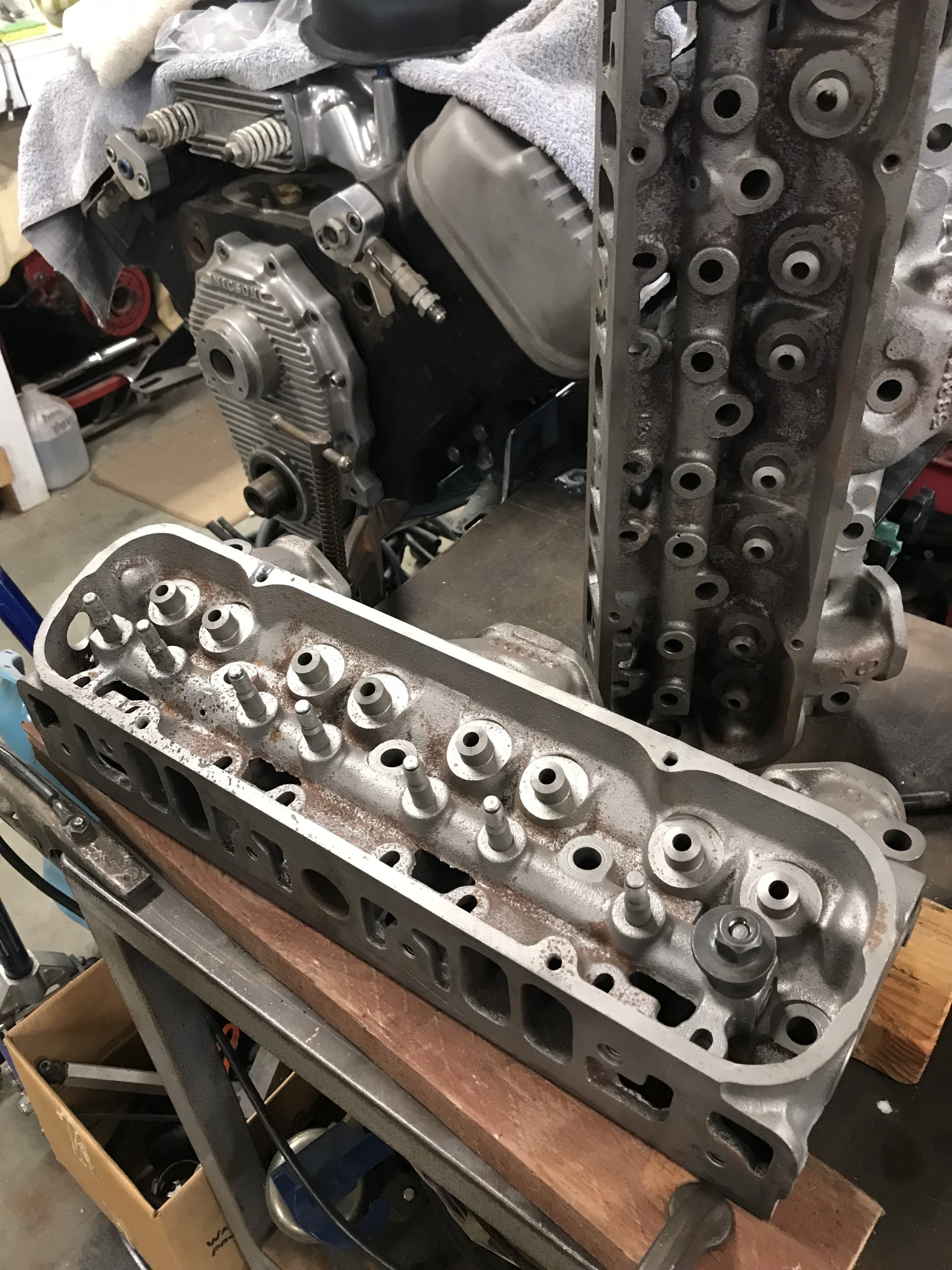

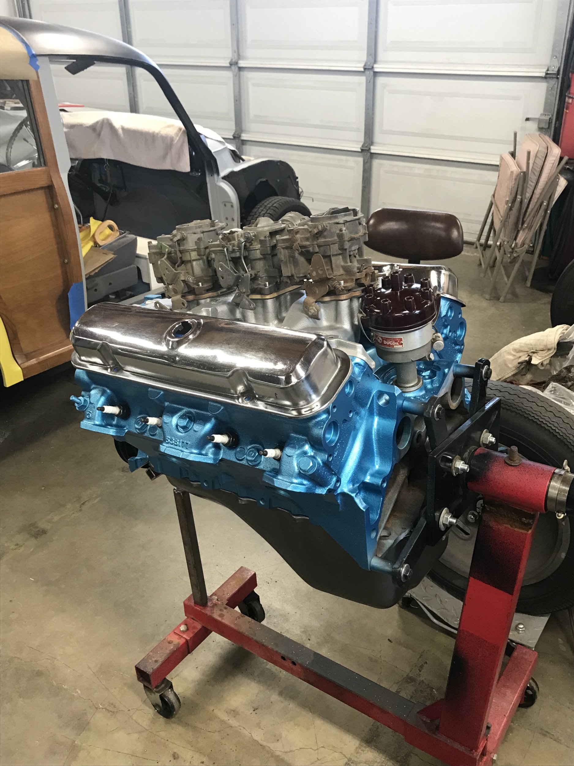

    I continued with the ***embly of the new Stude engine (‘62 389 Pontiac). It’s just mocked up in these pictures. The timing chain provided with the engine kit was pretty loose so I ordered one from Butler. It came just as I was leaving for a short vacation in LA (some vacation, maintenance on the LA house).
    I finally got the heads on, all of the freeze plugs in and painted it. It’s ‘70-‘72 Olds 455 blue. I like it.

    I’m piecing together another TriPower. I got the thermostat housing the same day as the timing chain. The valve covers are temporary, I’m hoping to find some old Moon or Offenhauser ones at the Bakersfield swap meet next month. I just scored a better set of these chrome factory ones, I kinda like em. I’ll put the rear freeze plugs in when I transfer the engine to the run-in stand.
    I’m going to have to really upgrade the old Stude’s engine compartment now. lol.
