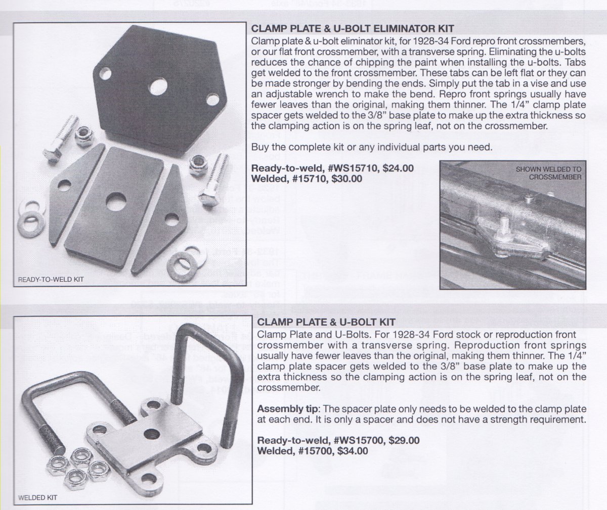

  11. goldmountain
    Joined: Jun 12, 2016
    Posts: 4,831
    goldmountain
    Everyone seems to be picking on poor Pete. His setup saves a few bucks. Scan-200528-0002.jpg

    While I don't think that's the spiffiest looking clamp in the world, the only thing it is doing is holding the spring up into the cross member. The cross member is carrying the load of the vehicle. The most load the clamp would carry is when the front tires clear the ground. How abruptly they left the ground would probably maximize and concentrate the load. (Physics students?) The clamp also goes across a very short and flat chord of the arc of the spring. If you wanted to test for fit against the bottom of the spring you could torque the clamp bolts with the wheels hanging down and then check how far the bolts rotate to attain the same torque with the full weight of the car on the spring.

    Wasn't trying to save a buck, I want to gain clearance above the crossmember since I raised the center.
