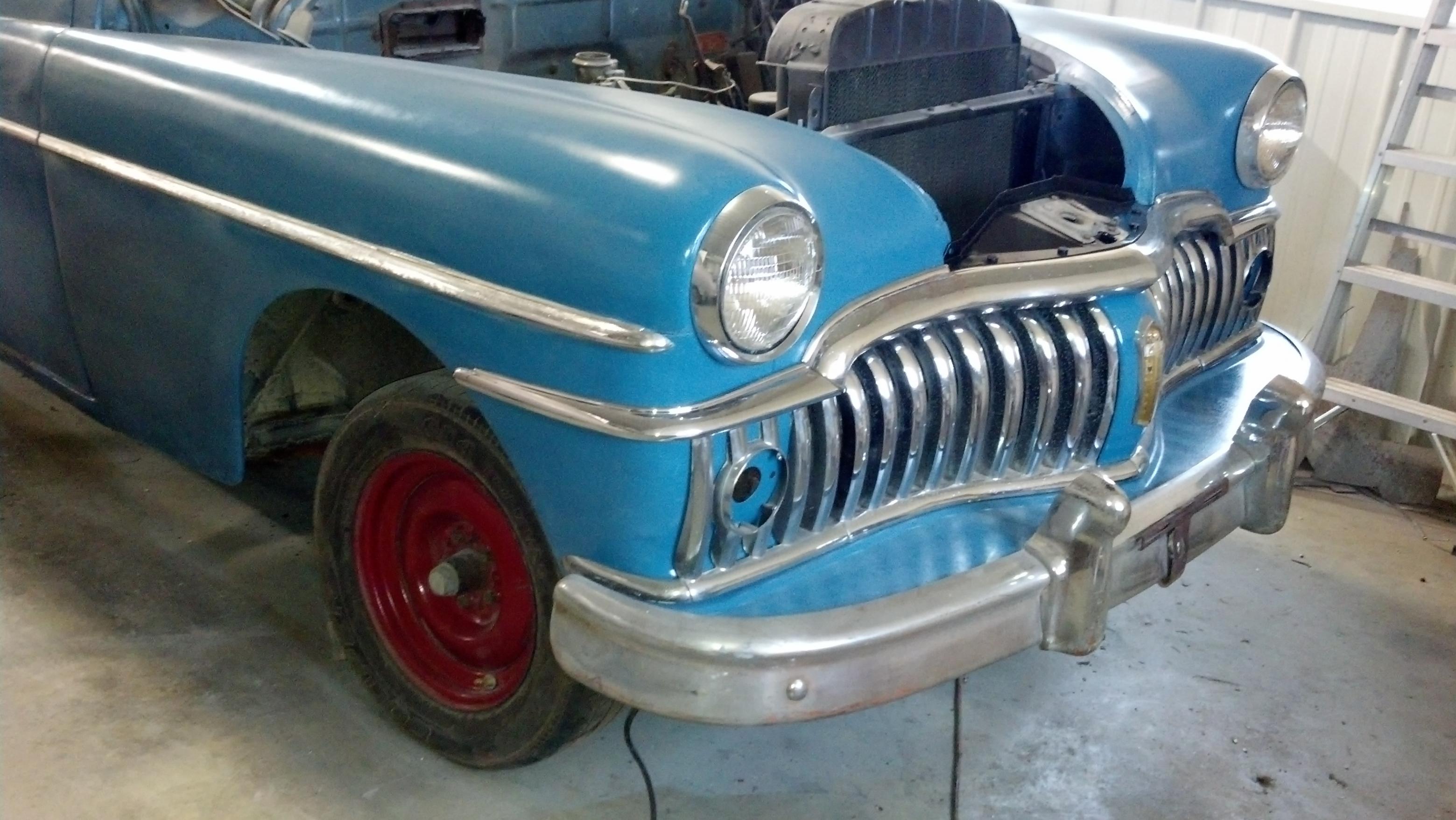

    The headlight buckets were toast so after searching around my shop, I found some spares from my OT '79 Jeep. Ironically, the mounting holes lined up with the existing ones on the sheet metal! I also installed the chrome bezels from the Jeep. Being that they are not tapered to match the body lines at the top of the fender, they look pretty sharp.

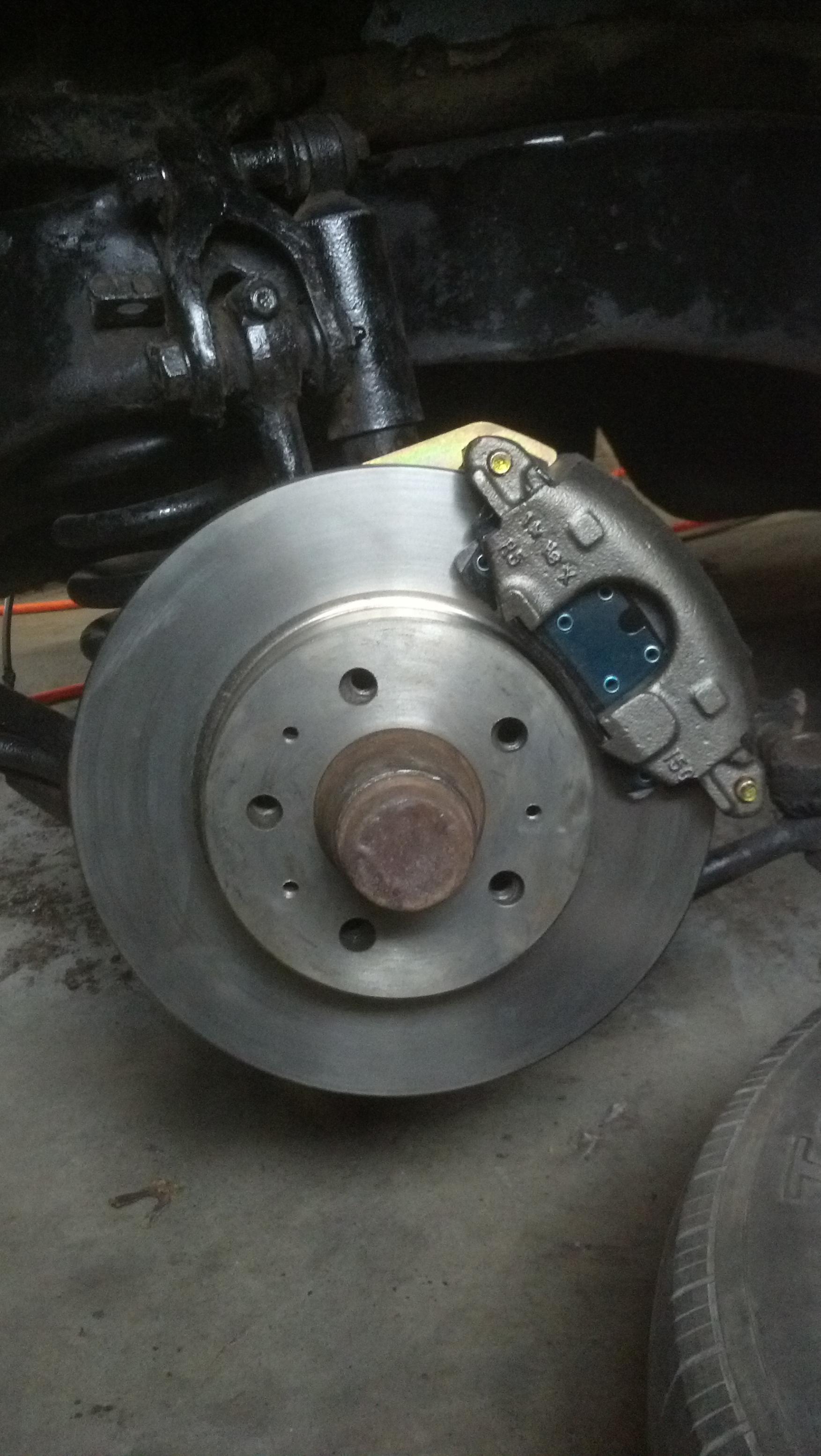

    The front brakes were in need of rebuilding (wheel cylinders, shoes, hardware, and hoses) so why not get a Scarebird conversion :D Yes, I do have the stock wheels and it does rub but I am going to use a 5/16" wheel spacer until I can get new disc-friendly wheels.
    The master cylinder is a dual pot which is located under (but not entirely :eek:) the floor and is mounted behind the factory unit. I gutted the factory unit so I can run an extended pushrod through it. Yes, when I get tired of the lump in the floor, I'll get one that fits under it.
