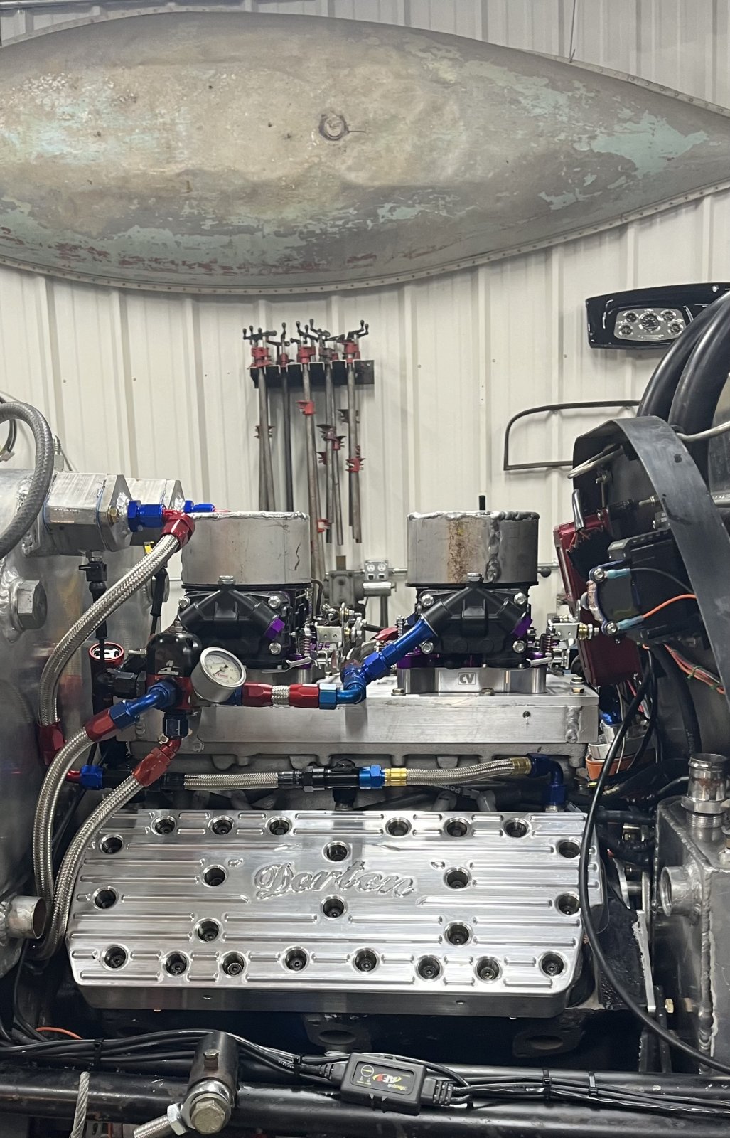

    People get way to wound up about the 3 main bearings in Flatheads.
    See the engine below. This is quickest flathead dragster in the world. Makes close to a 1000 hp on a 60% nitro load. 3 main bearings and a girdle out of Flathead Jack's catalog. As far as I know, it has never put the crank down onto the track.
    Flathead cranks are very stiff (weigh a few lbs more than a 428 FE crank), and the main bearings are very wide and support a large surface area. They will take more abuse than most armchair internet experts give them credit for.

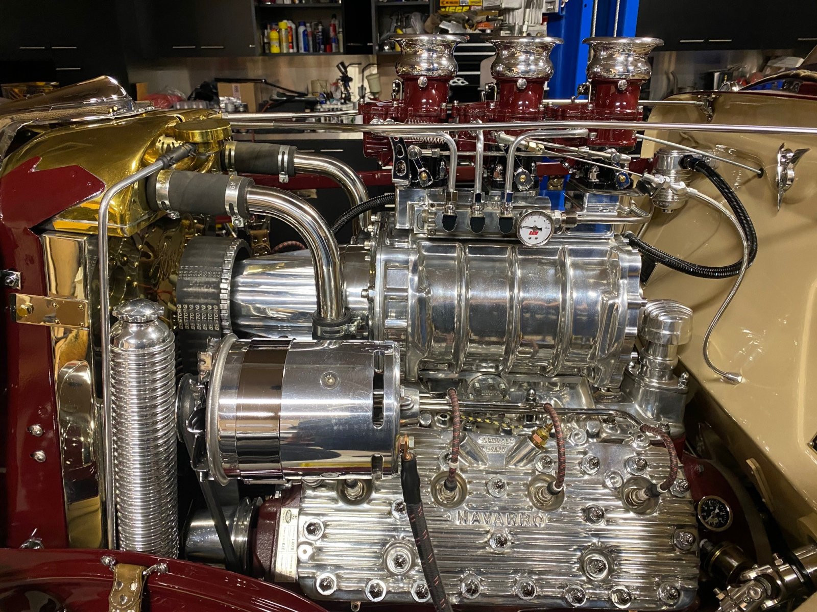

    My old hotrod friend Russ Meeks just finished this. Pretty exotic. He’s a master 3885F2AB-CEC7-4582-B662-72B1E80133E8.png
