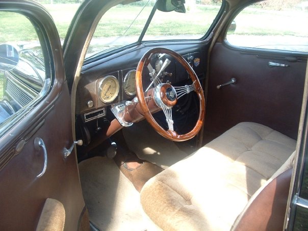

    not a good straight on pic...my stock dash i plan on woodgraining this winter..and a custom banjo i had built...thinking of making an extension also woodgrained below the dash to hide the a/c vents,etc.

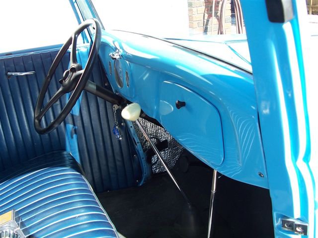

    Here is the dash on my 34 Ford 5 window Coupe. I like the oval guages.And the young one is my tag along goes were I go

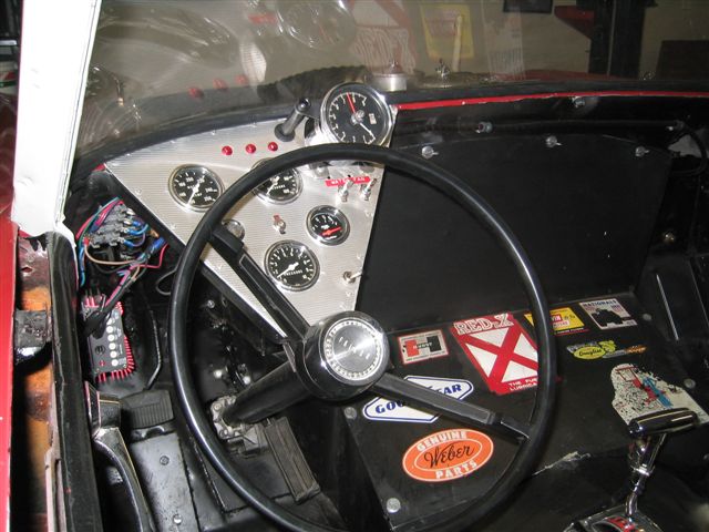

    Your basic AFX dash as in the Wild Child.

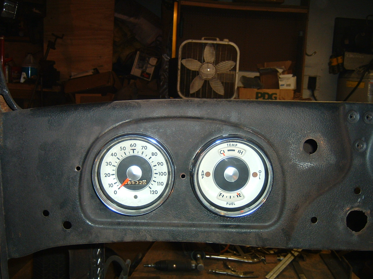

    I wanted to large gages to fill the existing holes in my 32 essesx terraplane gage board. So I found 2 stock gages from 62 studebaker lark on epay. Only had to increase the existing hole ID by 1/8 inch for the lark gages to fit. I will have to cut holesfor a small oil pressure gage and volt gage in the upper left and upper right of the large gages. I payed less then $100 for all four gages instead of $300 for aftermarket gage set. Here is a mock up picture of the lark gages in the dash.

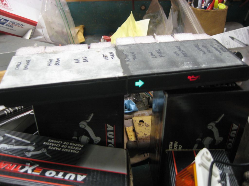

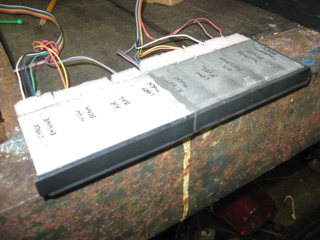

  24. Putting a 49'ish Dodge truck body onto a 95 Dakota ch***is & floor pan. I decided to try to keep everything "Dakota" as I could because a) finances wouldn't let me buy all new stuff b) makes it easier to troubleshoot when something breaks.
    We made bezels & retainers to hold the Dakota's gauges into the 49's housings, and I mounted the original Dakota gauge carrier and circuit board above the steering column support. We fabricated a small "extension harness" to plug into the backs of the gauges that fastened onto the original pins on the circuit board. I wanted to keep the idiot lights, so a buddy of mine made a small harness of LEDs that we glued into little foam blocks that we stuck into the original idiot light housings that we pirated out of the gauge carrier. The LED's wires are stripped and folded over a piece of bakelite and jammed into the little plastic light bulb bases on the circuit board to provide power. I JB welded the housings together, painted them, and glued the "film" with the pictures / words of warning onto the front of the old housings. The idiot light bar is going to hang under the dash just below the control knobs in the center of the dash. I'm also very likely going to paint the needles for the gauges off white to eliminate that fluorescent orange color. PM me if you want any better photos or explanations of how we did it.
  25. If you look carefully in the second photo, you can see the 4 center gauges sitting on the transmission hump and the extension harness connecting them to the pins on the circuit board on the (white plastic) instrument cluster carrier mounted inside the dash. This way all of the factory connections on the circuit board remain as is.

    i really like these gauges, easy to read has everything you need.. i like a tach but i can live with out one.. great score.

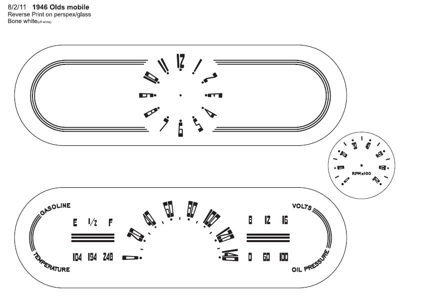

    OEM dash from a 46 Olds. Keeping it looking original however upgrading movements. The amp gauge will be changed to volts; oil pressure changed to 100psi, water temperature changed to 240, speedo to 140mph and clock converted to quartz.

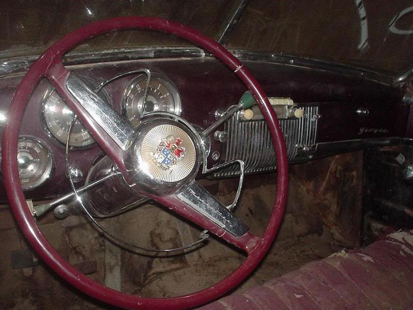

    47-48 frazer/ kaiser dash's I think would look pretty sweet in a mid 30's roadster or coupe. anyone seen this done? these are the 2 best pics I can find on the net
