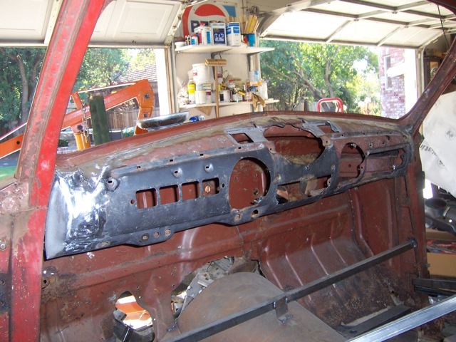

    I used a 48 Ford dash for my 51 Ford wagon. I had to stretch it 4" and reshape the leading edge, but I think it was worth it.

    you think it was worth it? no it was more then worth it! an Eye Popper!
    I'm going to shut up now and go back an look at the photos again.

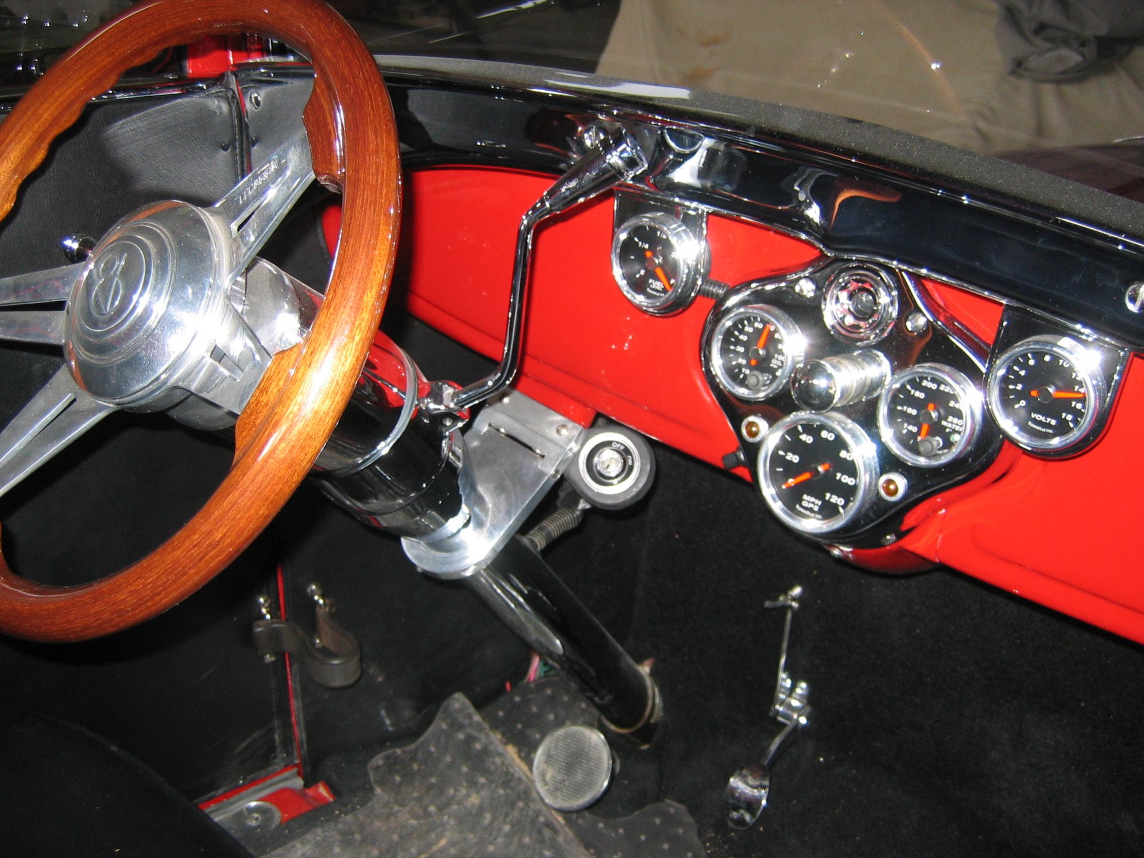

    Here is the dash in my 27t roadster p/u.

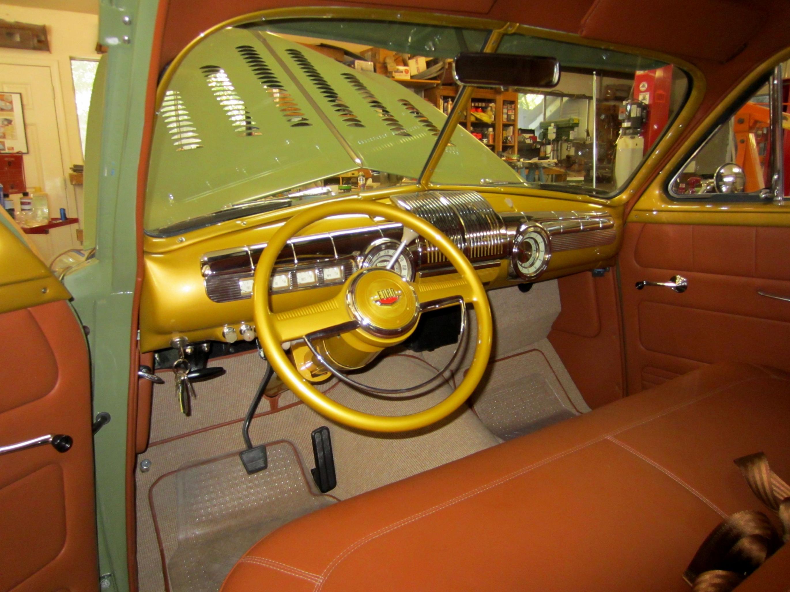

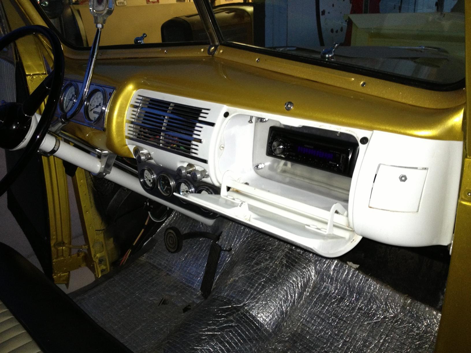

    Here is the dash in my 40 coupe. And the custom glove box to hide the modern radio.

    Thanks, guys. As with most modifications it was more work than I expected it to be.

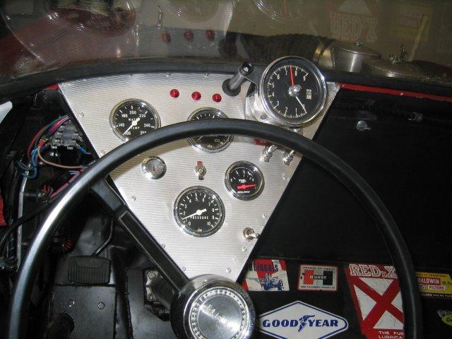

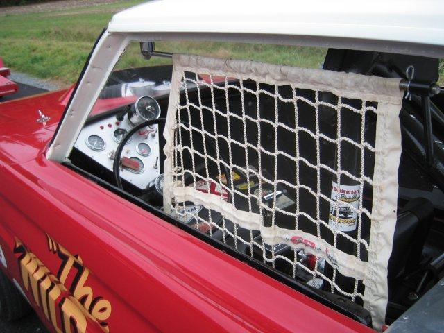

    Its not the prettiest but it is quite functional. This is the dash in my AF/X Falcon, the Wild Child. The original dash was hacked out after the 65 race season so the engine could be set back. The boys at Rankin Ford just grabbed a piece of textured aluminum and fit in between the steering column supports.
    I made a few minor changes when I restored the car and rewired it. One big change was after blowing up a motor at IRP; I added in a shift light but wired it to go on when the oil pressure drops below 20 lbs. Thankfully it only goes on when cranking the engine over and its building oil pressure.

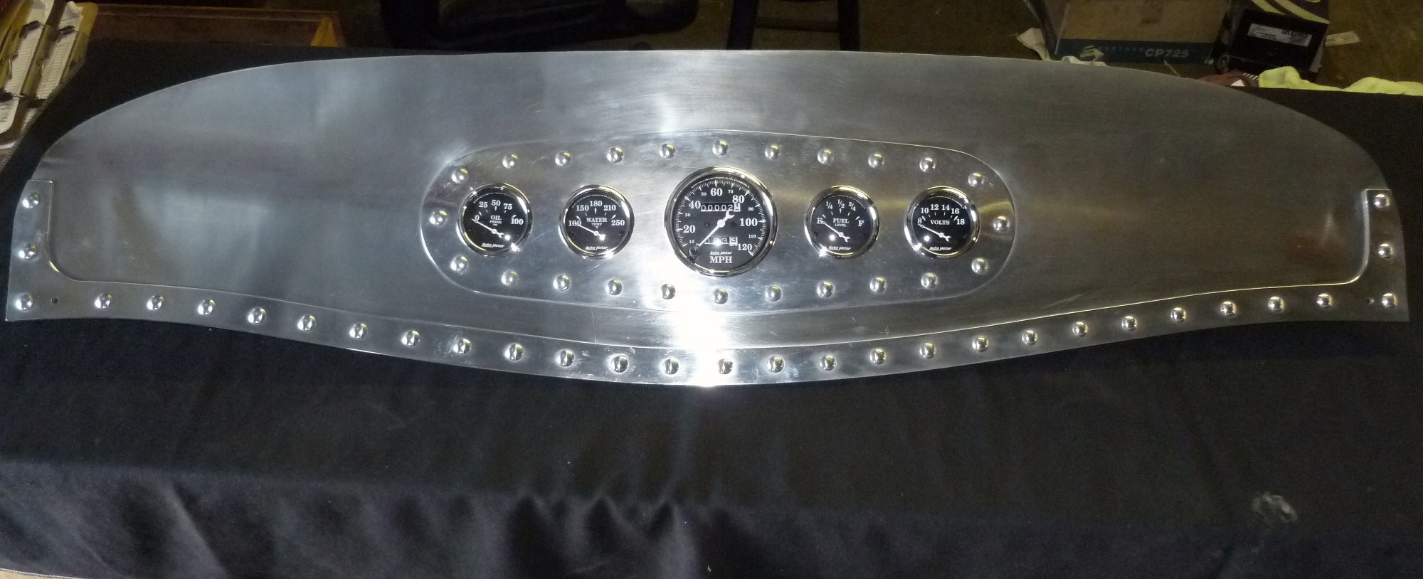

    This is a dash that I made for a Model A RPU that I am building. Fabricated/Riveted Aluminum.

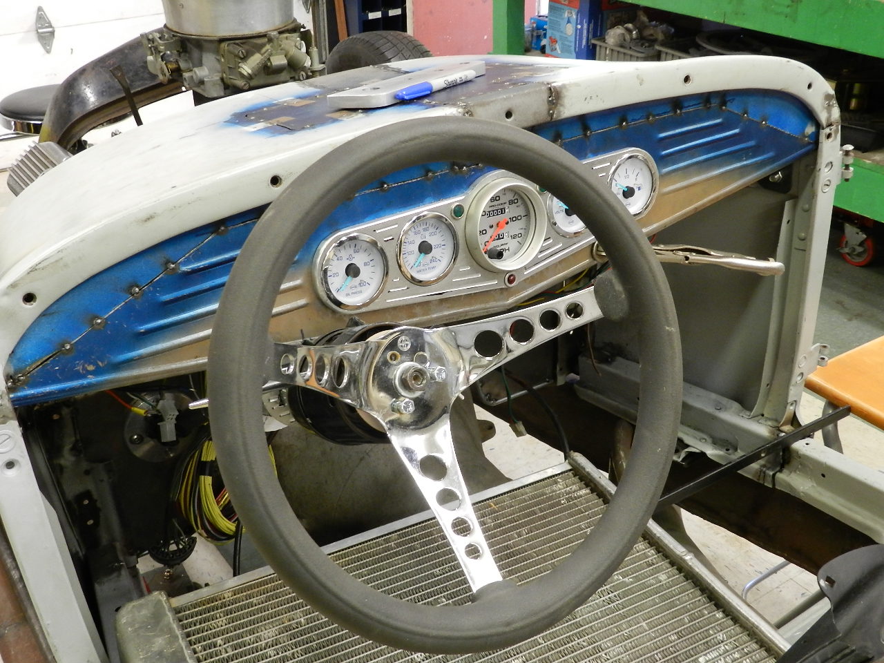

    better halfs model A in progress...found an electrical cabinet that had heat sink shelves that looked like flathead heads. i measured out the stock cloverleaf and added 1/4 inch all the way around so all the gauges would fit....used the same stuff for the face of her console, which is an old tropic aire heater
