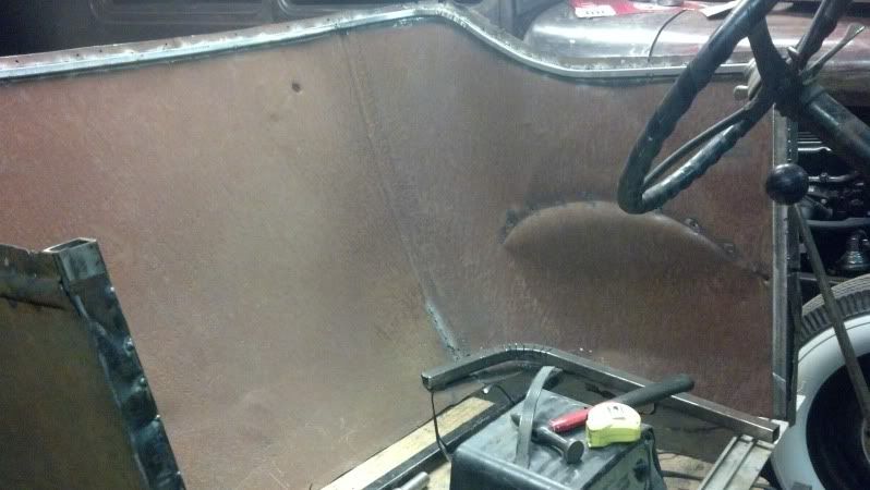

    I started to trim down the back of the car along with starting to build a structure for the body/cowl out of square tube.

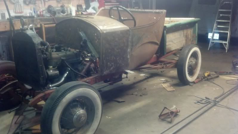

  18. Vintage Vandal
    Joined: Oct 3, 2007
    Posts: 720
    Vintage Vandal
    Got a good start on the body today. A bunch of of welding tears and hammer and dollying dents and creases. Along with bending square tubing(usually in my lumber rack,vise, frame etc.)

  27. Vintage Vandal
    Joined: Oct 3, 2007
    Posts: 720
    Vintage Vandal
    As far as the Chevy bed being worth something, its not. 60's Chevy stepside beds are not very desirable and this one is beat up, the bottom was cut up for some 4wd tire clearance and had a couple gallons of Bondo in the fenders so I wasn't worried about it. I ended up sectioning the width of the bed 11 inches and taking 32 inches out of the length and 6 inches out of the height.

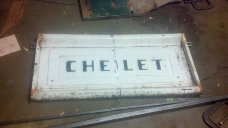

    I finally figured out what brand the body is! Its a Chelet!:D At least until I replace the letters with flat metal.
