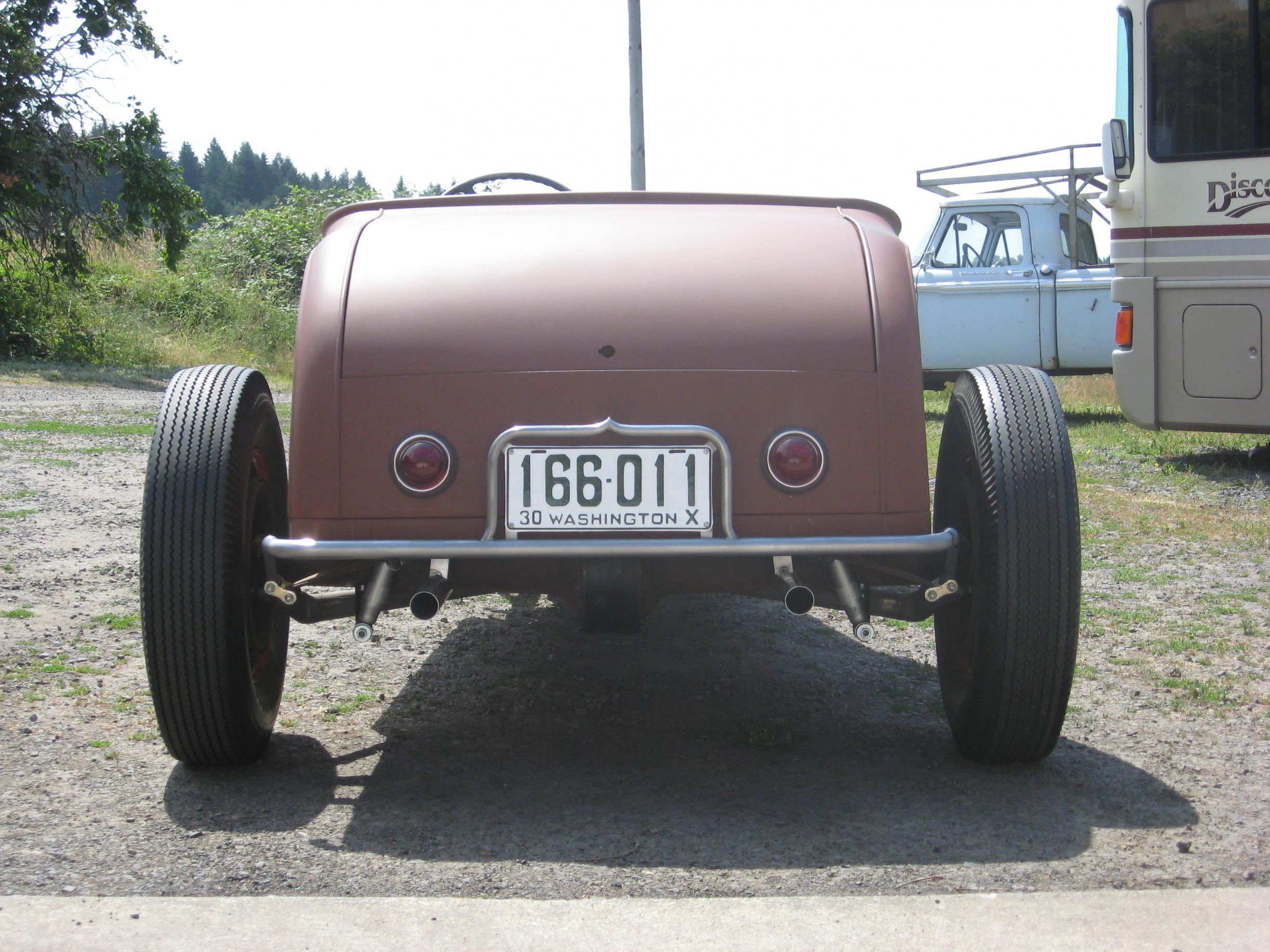

  4. Simple.........

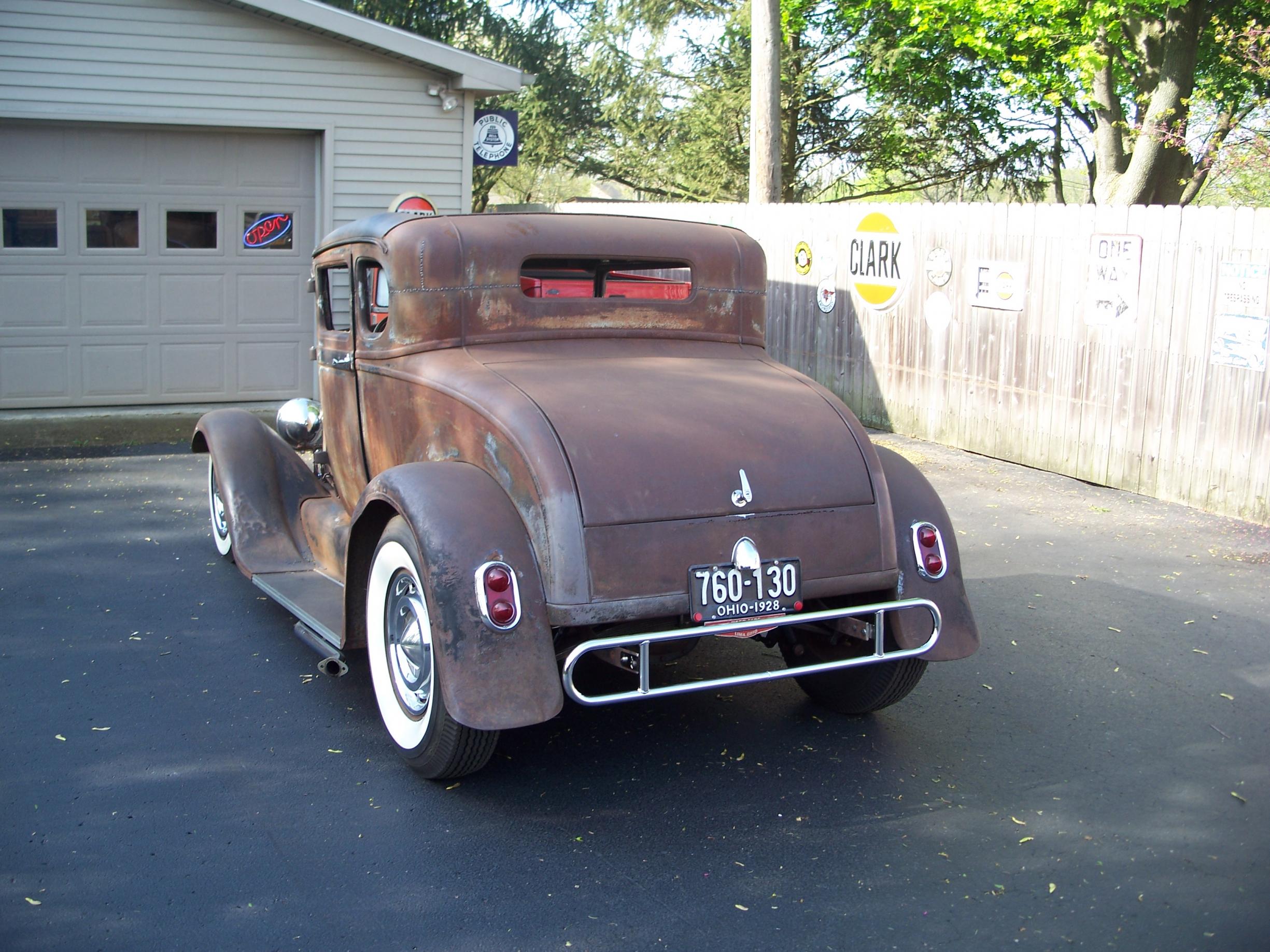

  5. I love nerf bars! I made these for my truck this summer...

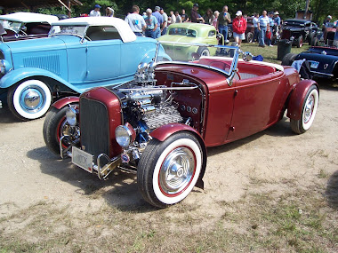

    I really like these.......Rus Daily, in the red shirt, built them and everything else cool on the car.

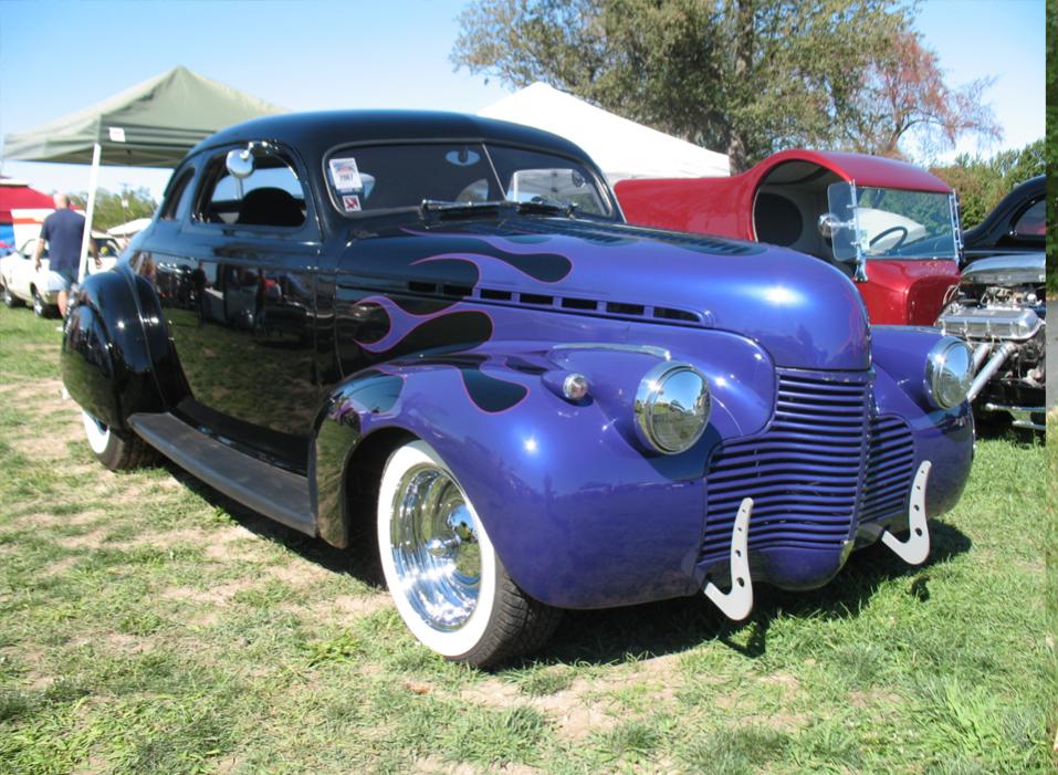

    I put these on my old coupe just before I sold it...

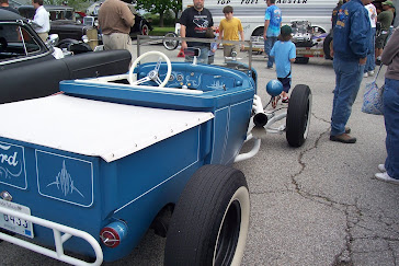

    These are a couple more of mine.

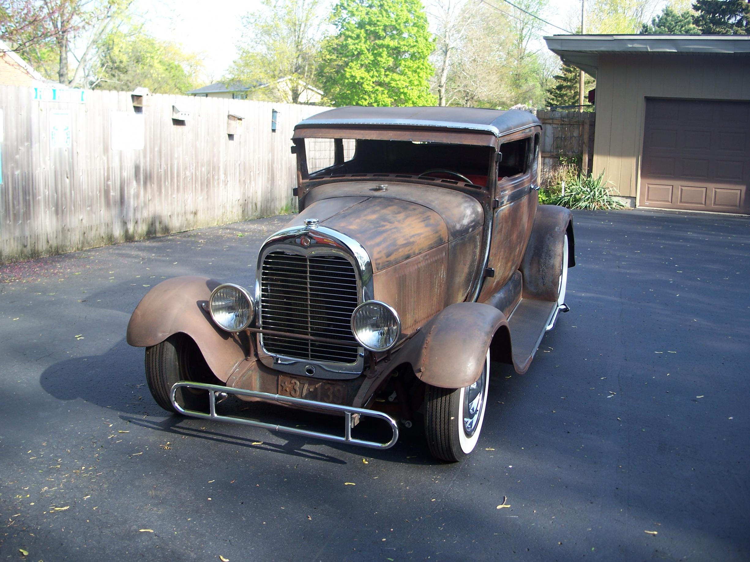

  24. We need to get this thread going again. I'm building mine for my 31 tudor, and have had to s**** two sets so far. Trying to make something that looks right and doesnt look like an afterthought.
