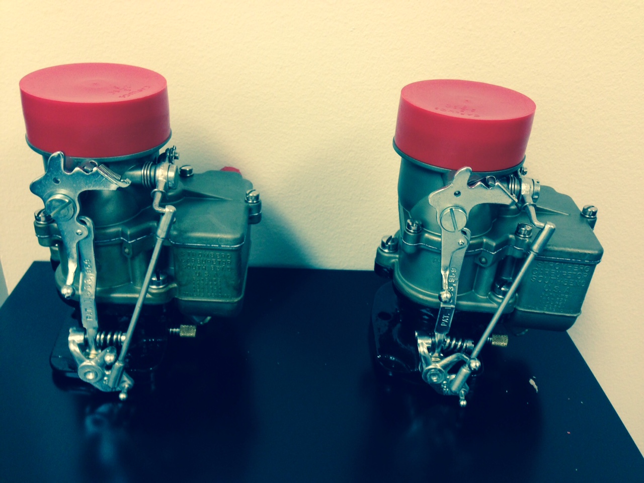

    Slow but sure..... 2 81's from Uncle Max.
    volvobrynk, waxhead and Hotrodmyk like this.
