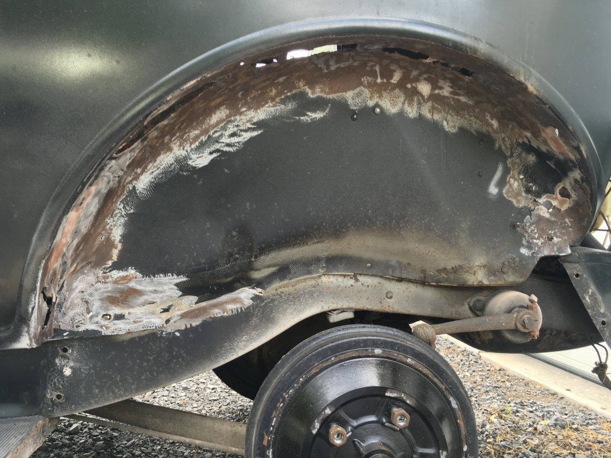

    1. Ford A and B speed

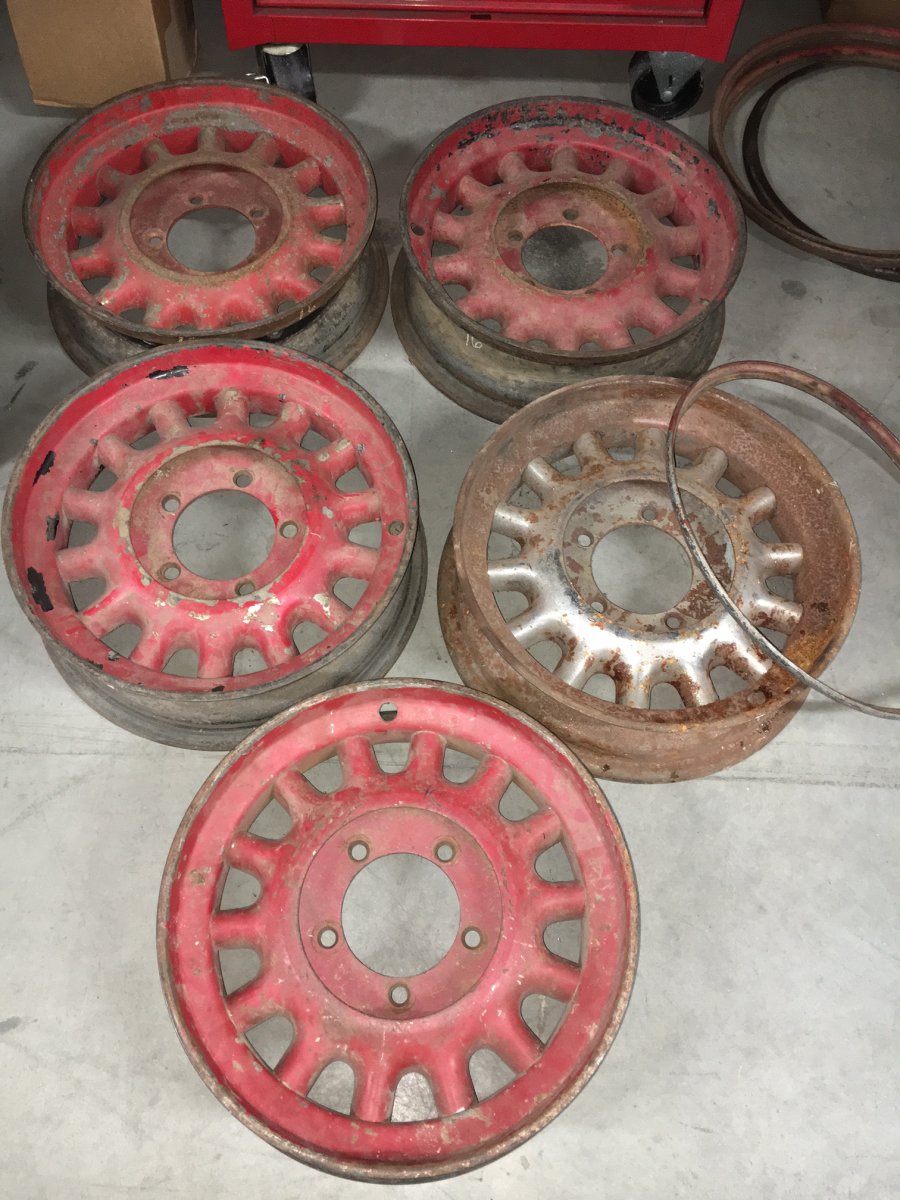

    Bought the wheels today. Got to figure how to make a Ford Hubcap fit the 7" hole. Looks like they were originally Chrome. may take the chrome off and co with the red. Not sure yet. Head and intake are ready for paint. Research says dark green with yellow letters. IMG_3163.JPG IMG_3161.JPG IMG_3160.JPG IMG_3159.JPG
    Felipe Toltecatl and waxhead like this.
  18. I hate to say it but you may end up welding a ring into reduce the diameter of the hole to 5 5/8 to fit the Ford hubcap.

  19. jim1932
    Joined: Jan 26, 2011
    Posts: 1,158
    jim1932
    The stock 32 won't work. Hoping ot find one from another year that is larger and modify the back to fit

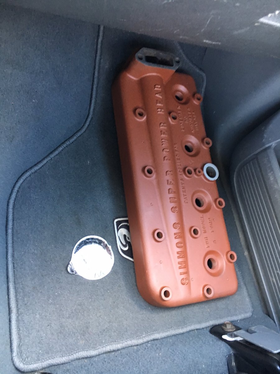

    1941 looks like a good candidate.....

  22. I still like the welded in ring idea. We used to do that with Cadillacs and Chrysler wires to run early Ford caps. Later they came out with snap in adapters.

    jim1932
    I guess the Lugs would be just as accessable as they are with the current wheels. I guess it's not like they are crazy valuable. Only issue is that spoke section is cast.
  24. The lug nuts are a little hard to reach with the stock Ford wheels. I usually use a u joint with my torque wrench.
