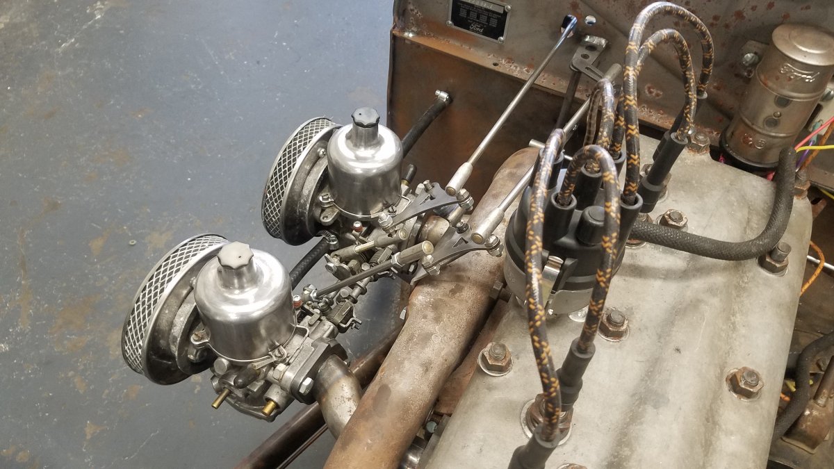

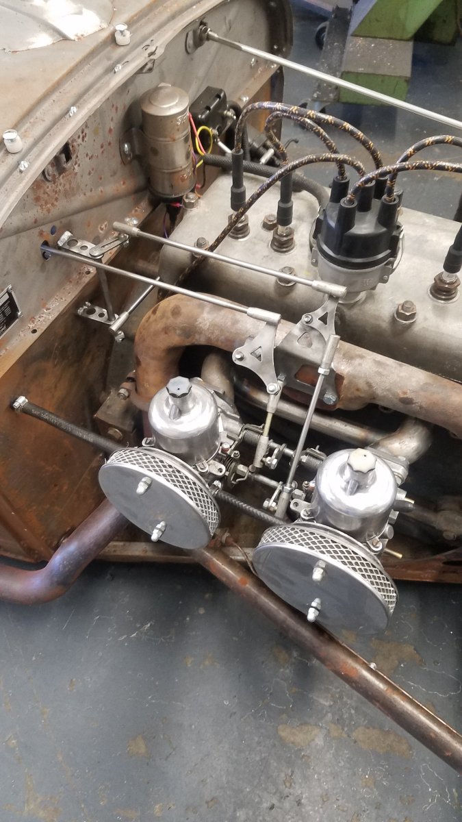

    Seemed to much like summer to cut the car up, so i back burnered the rear end in favor of some other upgrades. When the engine warmed up it was not idle down and seemed to have a vacuum leak, I suspected that the manifold wasn't real flat and the aluminum gasket was leaking.
    So I pulled manifolds and machined them flat ending with a little fine-tuning on some sandpaper

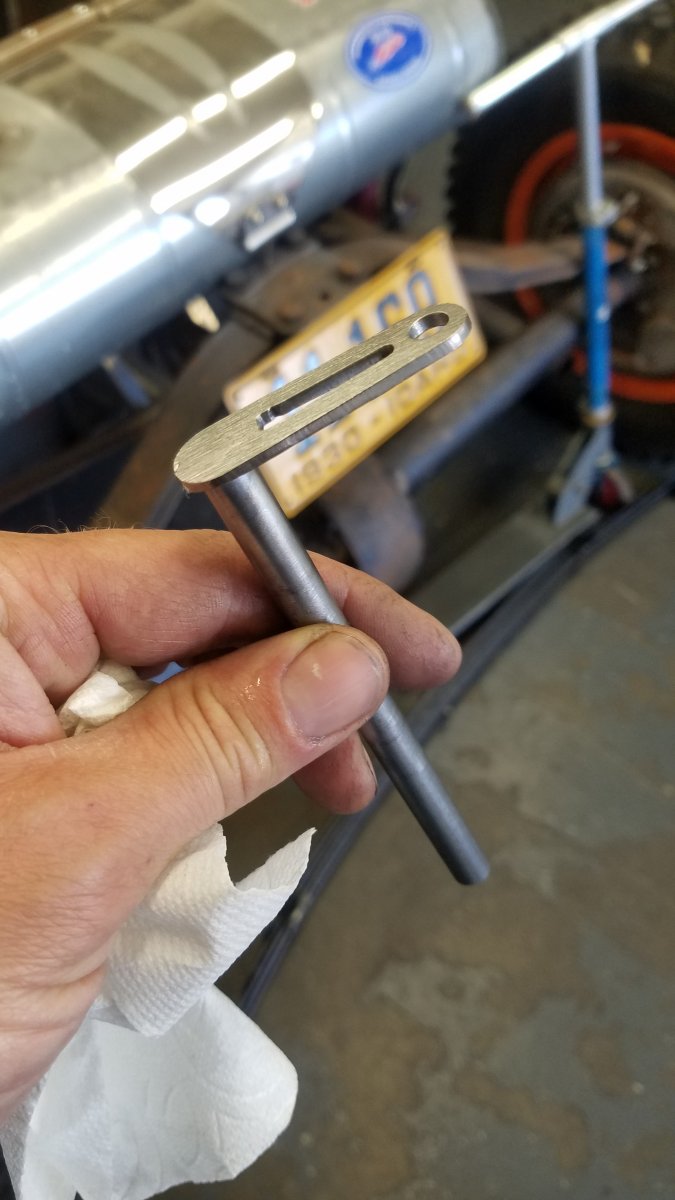

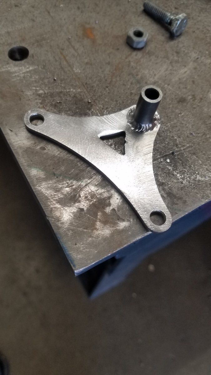

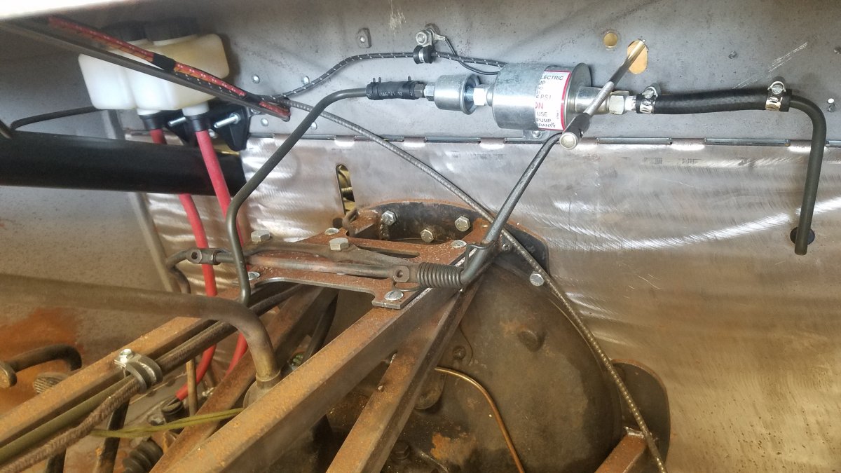

    The other major problem was the homemade throttle cables, they just didn't work smooth enough to shift the non sincro trans effectively.
    I had a box of 1/4 rod ends, picked up some stainless round stock and went at a new design. I like the mechanical look it took on. 20200616_155843.jpg
    The choke will be ran off the column lever, I can't remember if it controlled the timing or throttle on the Model A originally.
    20200721_104512.jpg 20200721_161402.jpg 20200721_161402.jpg 20200721_154036.jpg 20200721_154050.jpg

    Spark on the left Throttle on the right is the way they were originally built A & T were the same.
    I like the throttle and choke controls there look period perfect. Frank

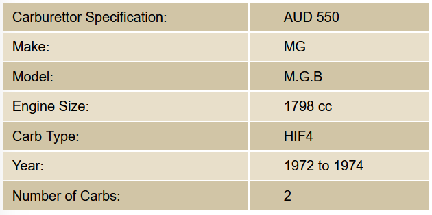

    I should probably know that.....but i don't 15954330847765590894757635522473.jpg

    No Worries, a quick search yielded this:

    So what does the 38 or 44 refer to?

    Maybe that is 38 mm or 44 mm throttle bore?

    Yep, **** has it right.

  14. 38's I reckon. I'm sure 44's have a four bolt flange to the manifold.

    The 38 and 44 are just the metric equivalents of the imperial measurements. So 38.1mm is approximately 1 1/2 inches and 44 ( 44.4) is 13/4.
    SU measures the carbs as 1" plus a number of eighths. So a H4 or HS4 or HD 4 etc is a 1 1/2 inch carb and a 6 is 13/4, and a HS8 etc is a 2" carb.
    So the listing shown says HIF4 which is an inch and a half carb.
    They moved to metric measurement later in the piece so some carbs are listed as HIF 38 etc.

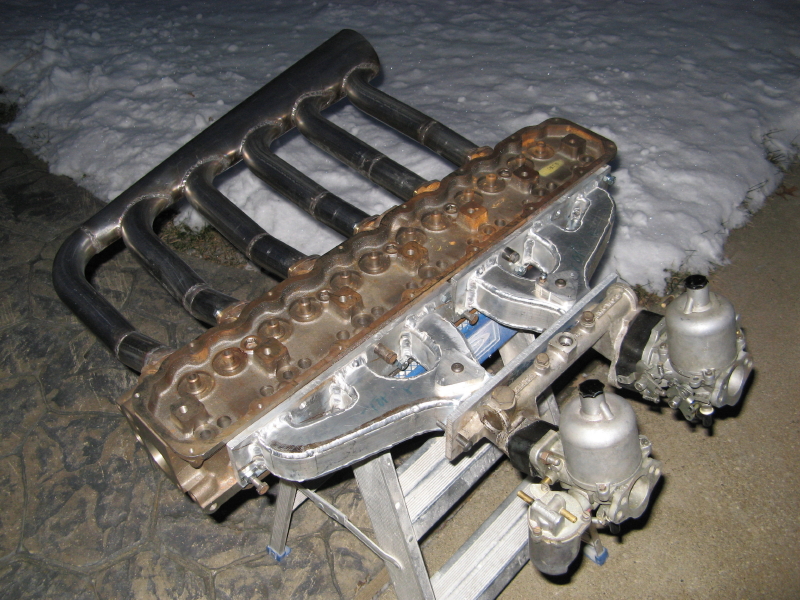

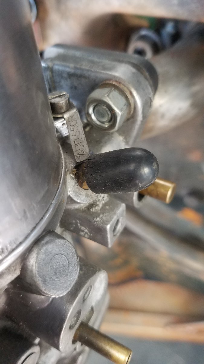

    I just discovered this thread and find it very interesting, particularly the recent SU discussion.
    I am in the process of doing a champ car replica using two SUs on my five liter inline six. I know little about these carbs. Not to muck up your thread by hijacking it to ask questions about these (HS6?) carbs I will be starting my own thread seeking help with these carbs, about which I know little. Your carb linkages are really elegant looking.

    Those are not 6's. HS6's and above have 4 bolt flanges to the manifold. You have HS2's or 4's. Measure the manifold side. HS2 is 1 1/4", HS4 1 1/2". An HS2 will flow 90cfm., HS4 142cfm., HS6 (1 3/4") 210cfm. Mike

    I know the carbs pictured are not HS6s, Those are not the carbs I will be using. The carbs I am using are 1 3/4" on the manifold side, but alas, I cannot see any numbers on them so I am sort of at a loss as to where to turn for specs. The ones shown are HS3s (AUD 35R) 1.375" and the ones mounted up on the car measure 1.70" and have 4-bolt mounting flanges. Other than that I'm stumped. Then have a goofy mfgrs insignia, no numbers.
    I'll take better photos and start a separate thread.

    In 40 plus years of carburettor work I have yet to see a HS3! ,2,4,6,and the one I would recommend for you HS8 or HD8, for twin carbs HS6 or even HS8s for triples , or one carb per intake port then I would say 6 HS4s.
