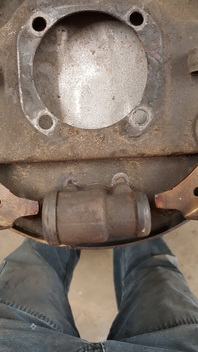

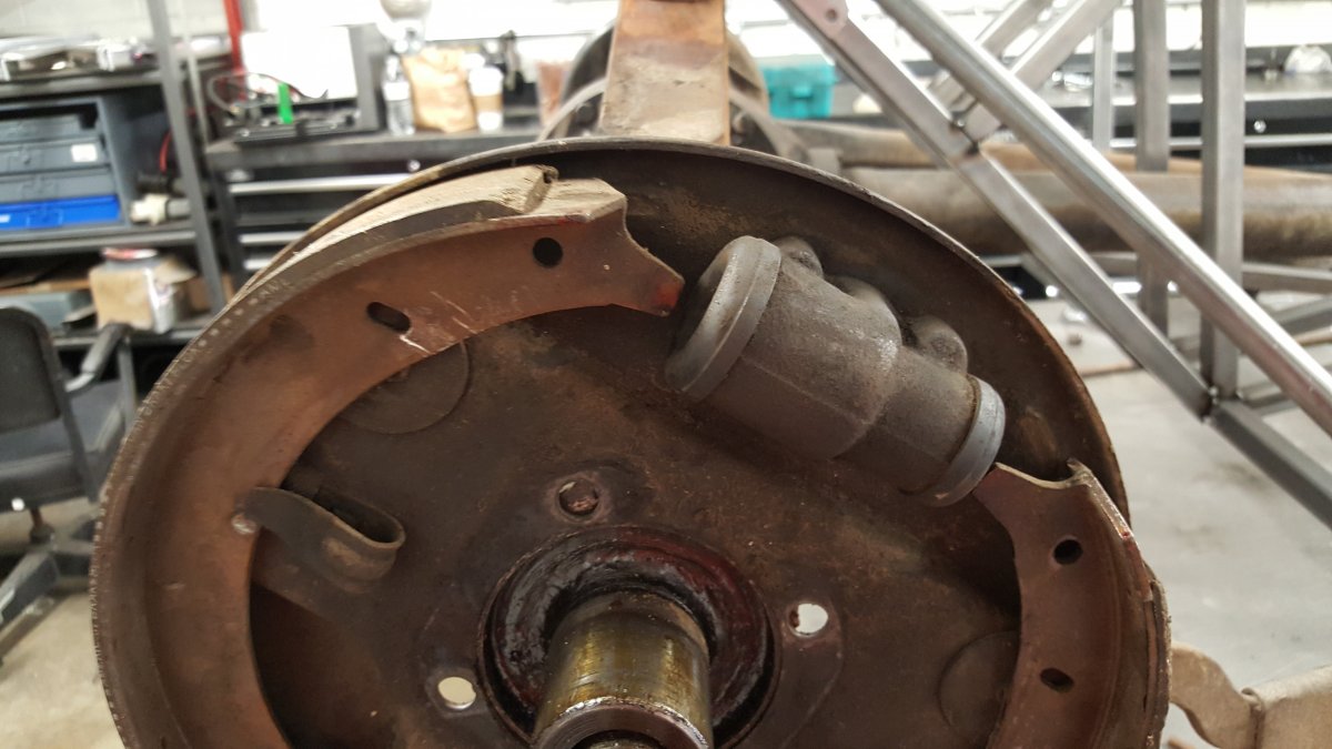

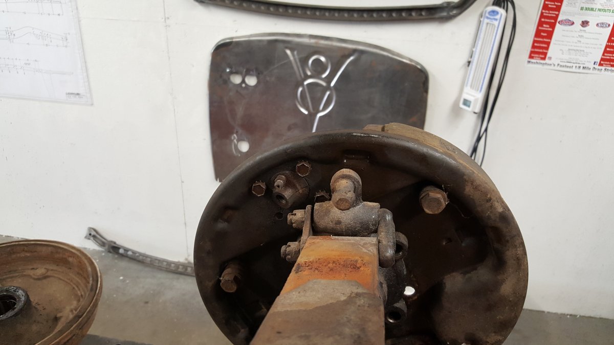

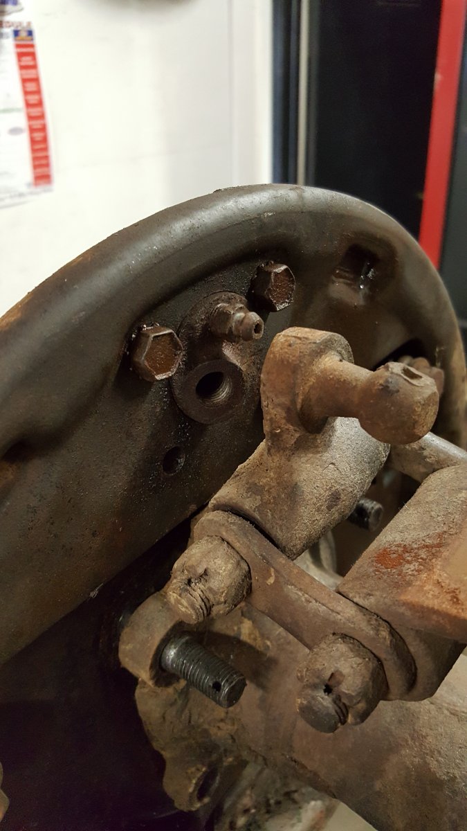

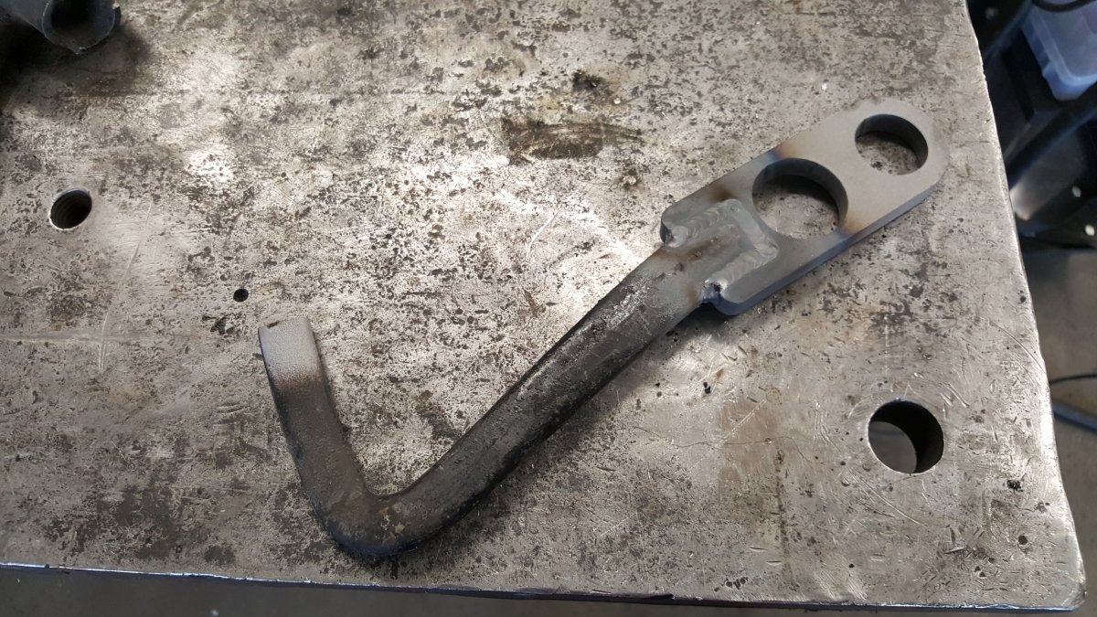

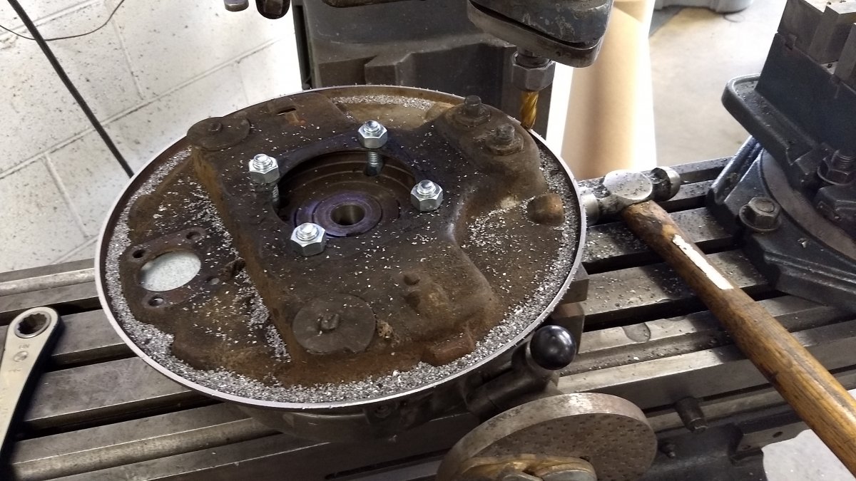

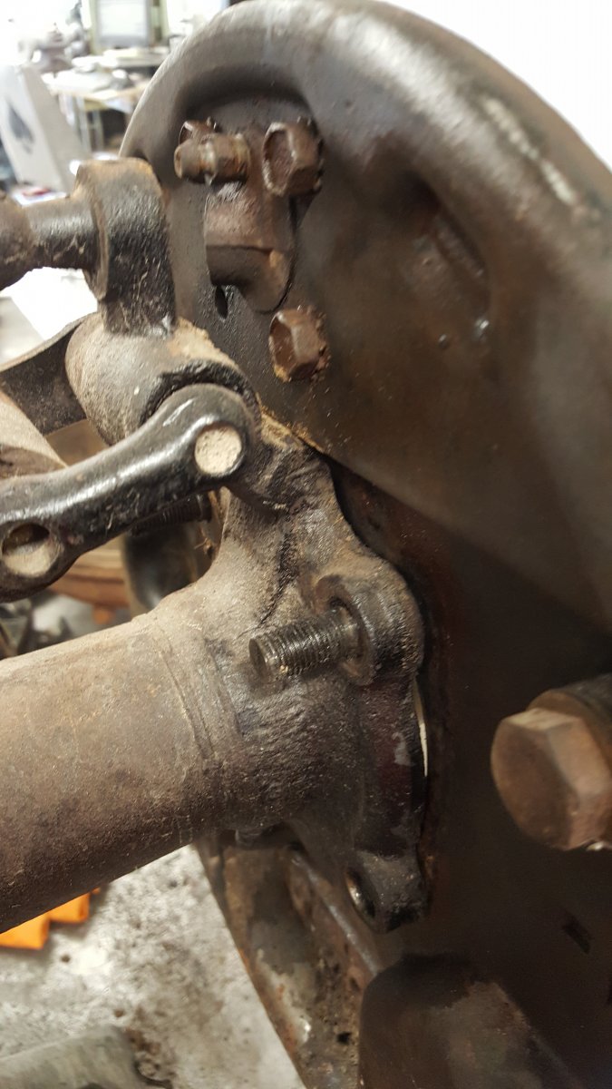

    I had this 48 Ford F1 front end that I could steal the brakes off of,
    I have heard this would work but I have never personally done it, so here is my experience with it. Some people say to just Mount the brakes upside down and then roll the wheel cylinders over. They mount up okay,
    But the wheel cylinder mounting is not concentric with the center line of the wheel cylinder bores. You would have to alter the mounting in the backing plate in order for it to work as it also throws off wear the shoes meet the wheel cylinder.
    Another option that is talked about is redrilling the four mounting holes on the backing plate in order to rotate the wheel cylinder ahead of the spring mount. This could work too, but what I can see is it rotates the wheel cylinder to an angle and it looks to me like there's going to be problems getting the air out of them. I'm sure it could be dealt with but didn't look like the best option to me.
    The most viable option in my mind is to mountain straight up as they should be, and this causes an interference with the springmount hitting the backing plate, but there isn't much t******* that needs to be done to get everything to fit together. It seems to leave plenty of room for the brake line to p*** the Spring Mount, and really the only issue is that the bleeder screw comes into contact with the Shock mount. I believe you could find a shorter bleeder screw if the shock mount was needed, in my case I'm not using the shock mount so I just cut it off and blended it in.
    20171013_104127.jpg 20171013_104115.jpg 20171013_122900.jpg 20171013_123030.jpg 20171013_123238.jpg
    It all fit together nicely, unfortunately I forgot to take a picture after I put it on. I will grab one when I'm back down at the shop.

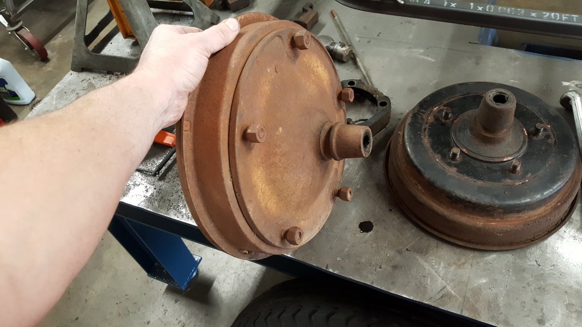

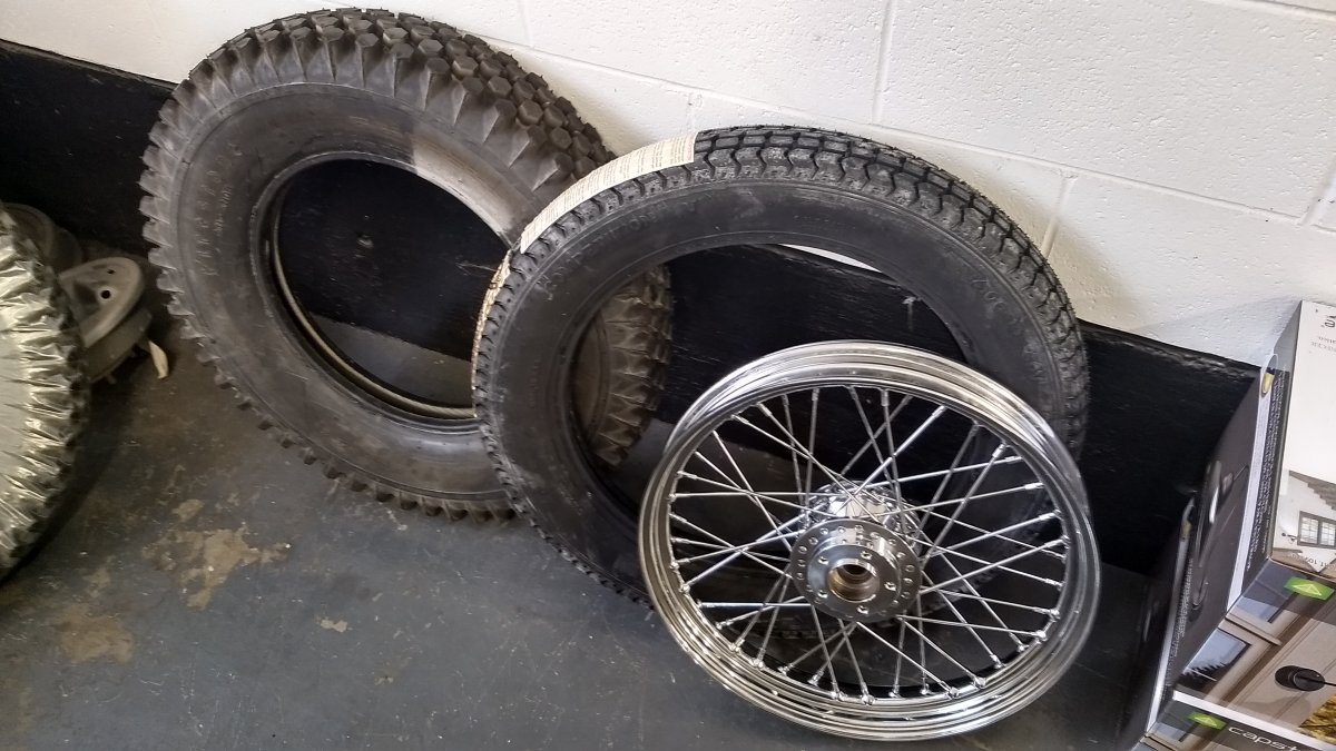

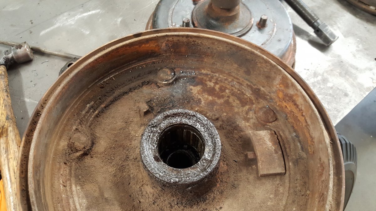

    As a side note, I will be using the 37 to 39 hubs and wide 5 Wheels, however every set of wide 5 drums I have seems to be well beyond using. If someone has a nice pair please let me know. 20171013_101813.jpg 20171013_114406.jpg

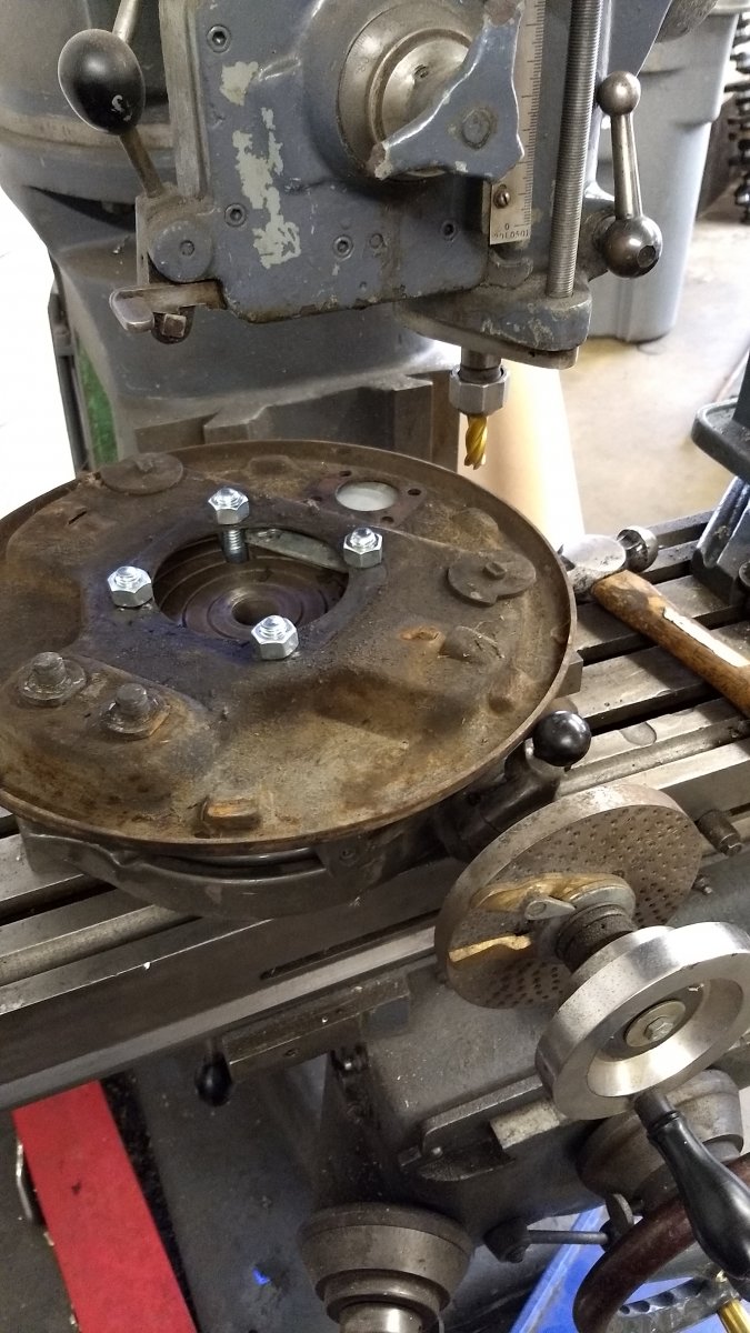

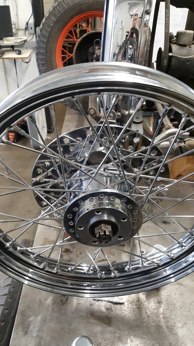

    As the plot thickens, the rear wheels are down for a nasty sand storm and powder coating, the front IMG_20171019_164051106_HDR.jpg IMG_20171019_164541734.jpg s are 19 inch Harley. Currently building fixtures and leaning some G code from my old man to make it all jive.

    Tell me more about the Harley wheel idea. I have been contemplating making some hubs to lace to some 19" rims for my Continental star speedster. What would you be using for brakes?

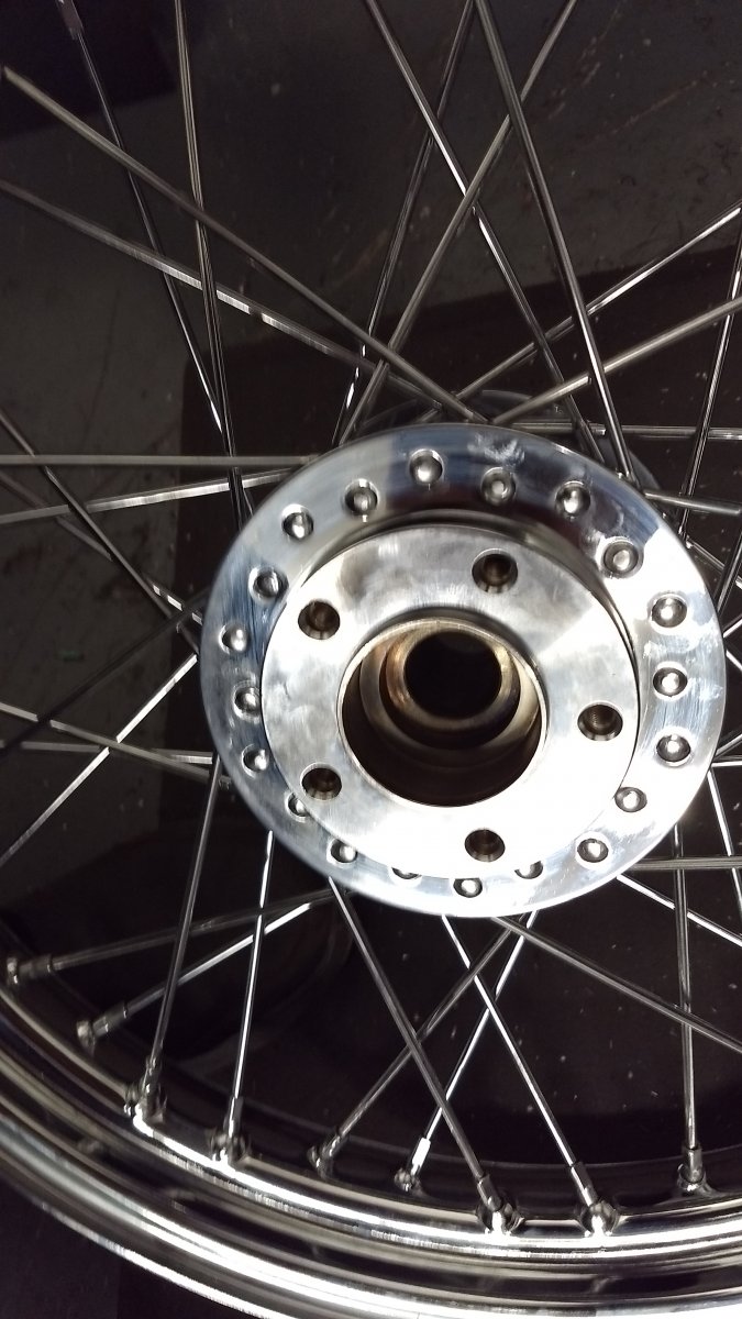

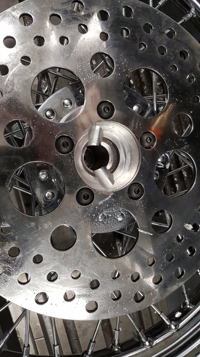

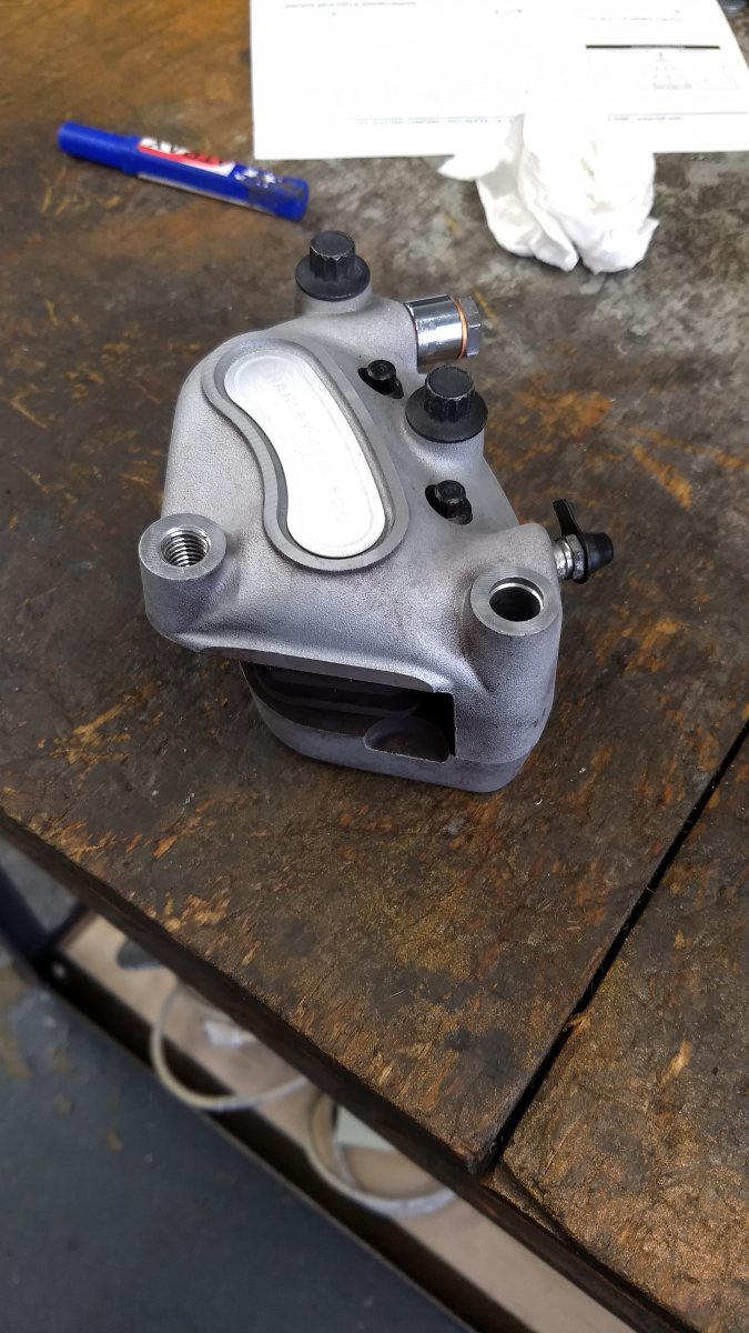

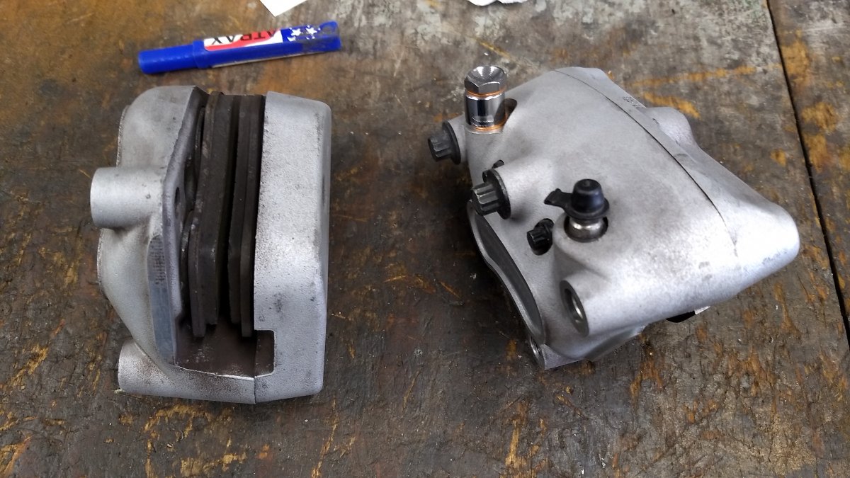

    We had used Readily available Harley wheels on our North West Vintage Dragster along with Model T axle and spindles. Like most Harley stuff the wheels are way over built, makes them a good candidate for light hot rod. I did the drawings for both Model A spindles as well as 32-48 spindles. They use the corresponding wheels bearings that came stock with the spindles. The model A does require the later nut to hit the cotter key hole as it is a little thinner. Just as the path of least resistance I am going to use the Harley brake rotors and I have a set if front calipers coming from a Dyna.... Stay tuned to see how that works out.

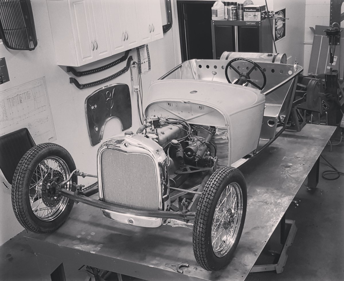

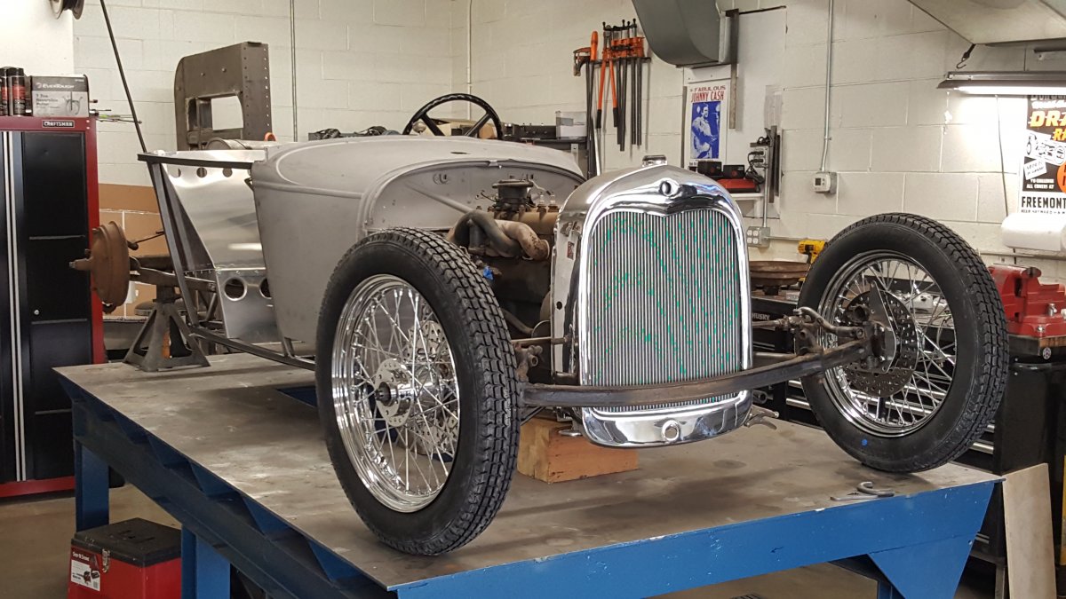

    Finished up the machine work on the wheels, and had the Excelsiers mounted up. I absolutely love the look. We can do this for model A spindles and 32-48 spindles, pm me if you are interested in a set. Made some progress on the seats, then had to put the cowl on for some glamour shots. 20171023_144032.jpg 20171023_145257.jpg 20171023_145305.jpg 20171024_150121.jpg 20171025_110421.jpg 20171025_110959.jpg 20171025_111043.jpg

    Here is what it would have looked like 50 years ago ;)

    No these are reproduction sportster front wheels, they have a boat load of fat in the hubs (like most Harley Parts) I made up a mount and bored a larger hole in one side to accept the Ford bearings.

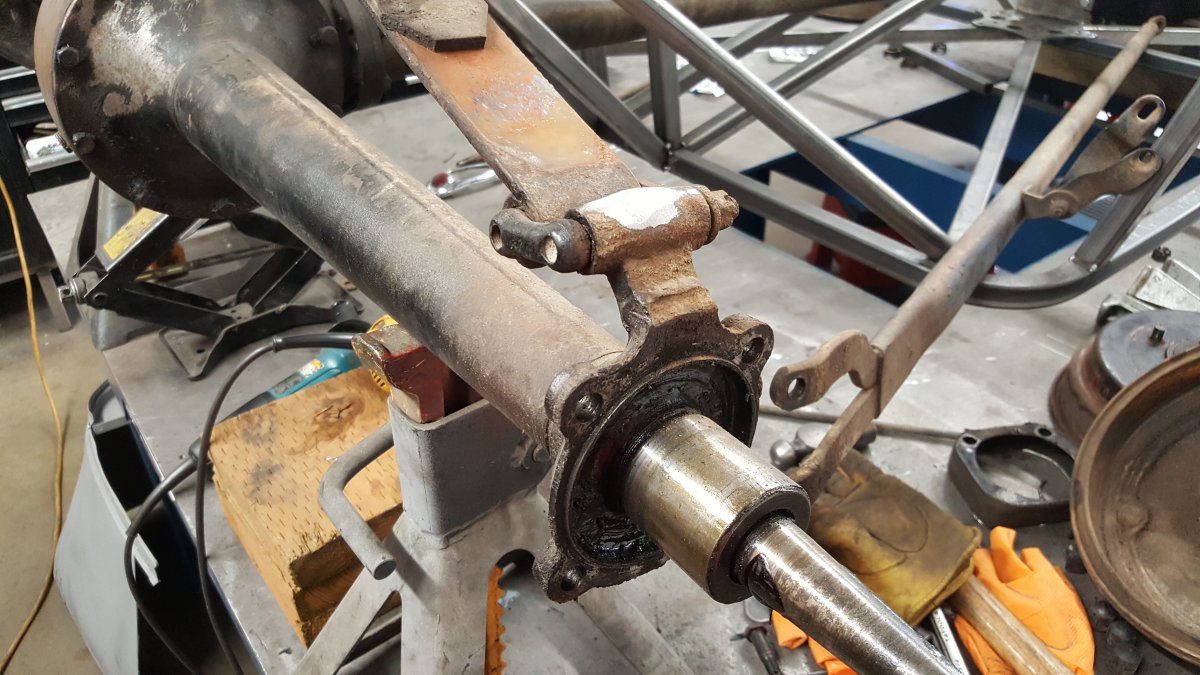

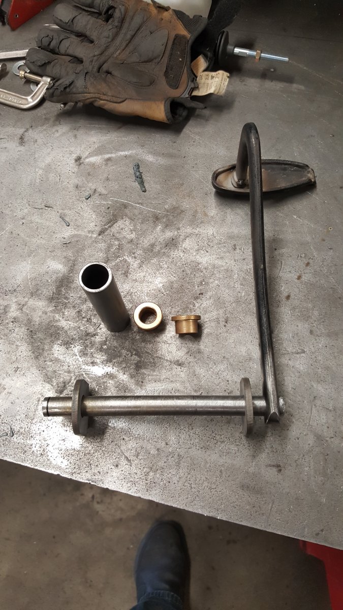

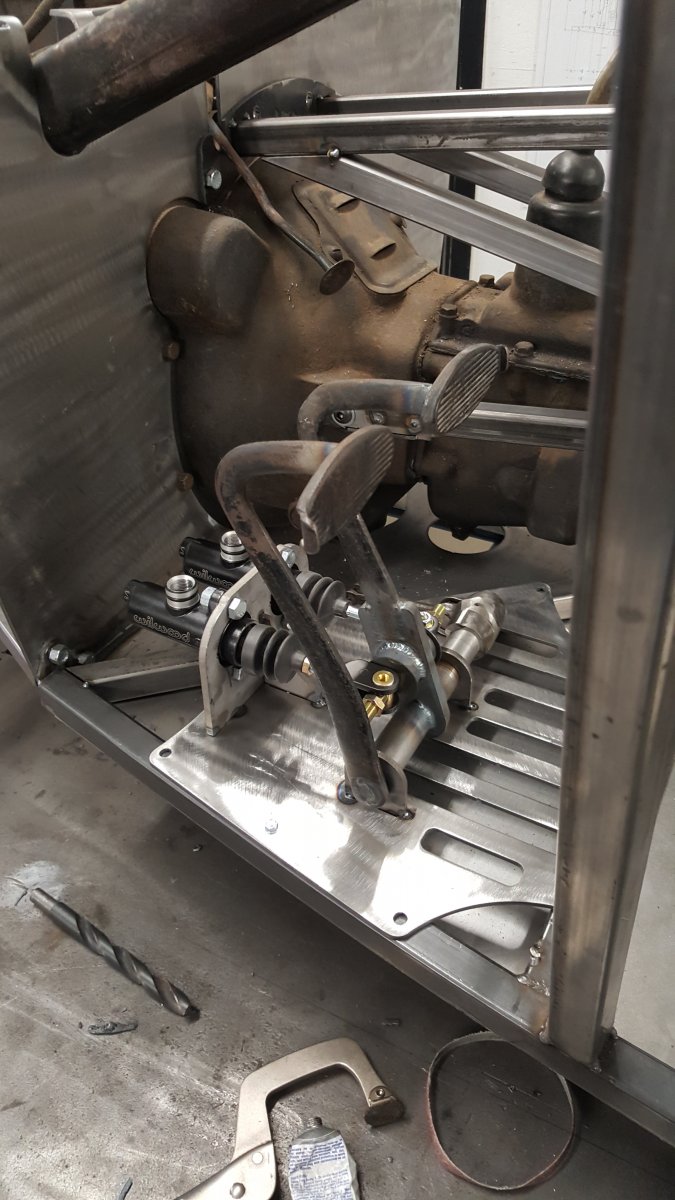

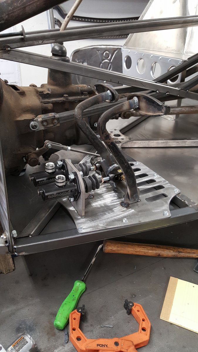

    After sitting in the car I could tell that one of the crossbars was going to be right where you wanted to put your foot for the gas pedal. Solution was to cut it out and tap the end of the shaft where the pedals originally pivoted. Then reattach the bar there to carry the load forward in the bellhousing. The next pictures show the process of Designing the pedal ***embly, you will notice that the lower plate changes partially through as I found that I could not reach the pedals even though I am fairely long-legged. This allowed me to bring the master cylinders in side of the cowl which I like and I am using a Wilwood balance bar which will be nice for setting the Brake bias 20171025_112924.jpg 20171025_131457.jpg 20171025_145601.jpg 20171026_102201.jpg 20171026_151914.jpg 20171026_155026.jpg 20171026_163731.jpg 20171027_153135.jpg .

    The clutch shaft runs through the brake pivot tube to the right hand side of the pedals and mechanically actuates the lever as it did before, I just had to re-index the arms on the shaft.
