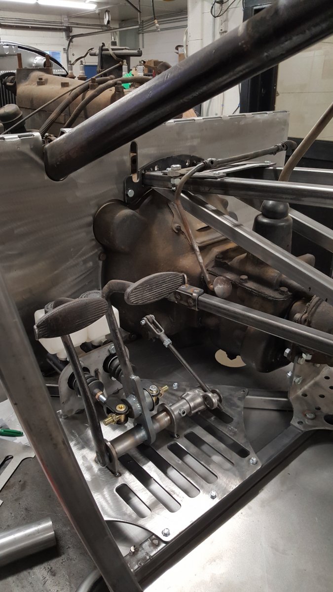

    That it the beauty of the space frame construction, to get this low with a channel job you loose all of your leg room.

    Is the gas pedal going on top of the clutch linkage somehow?

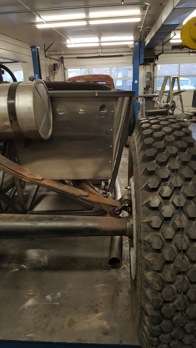

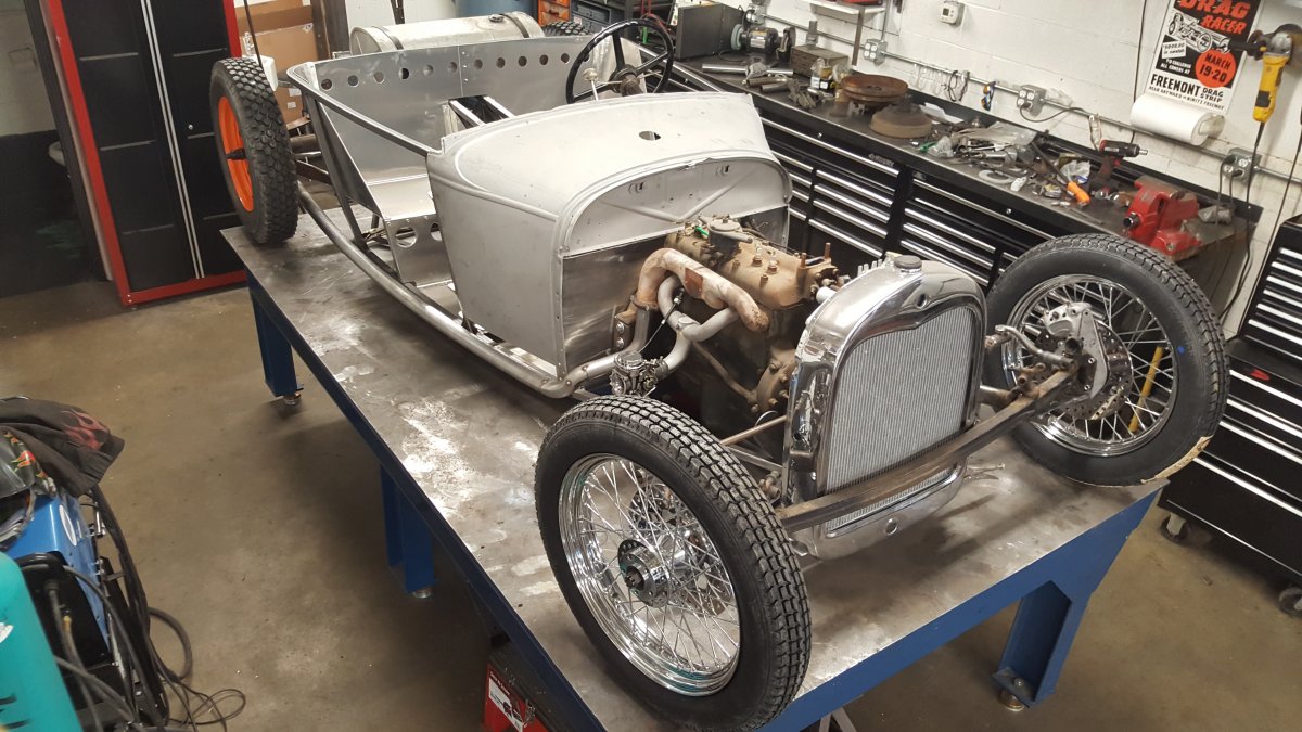

  11. rottenleonard
    Joined: Nov 7, 2008
    Posts: 1,993
    rottenleonard
    Over it anyhow

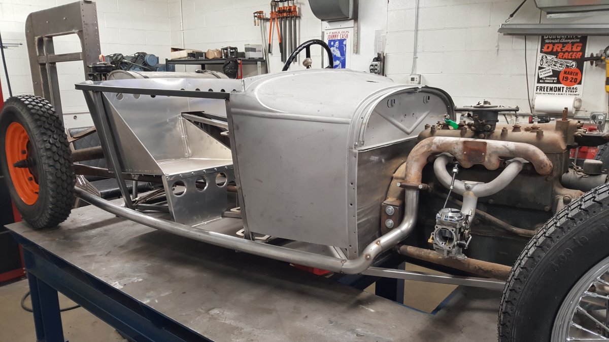

    20171031_163429.jpg 20171101_091655.jpg 20171103_082221.jpg 20171103_082235.jpg
  12. gnichols
    Joined: Mar 6, 2008
    Posts: 11,425
    gnichols
    from Tampa, FL

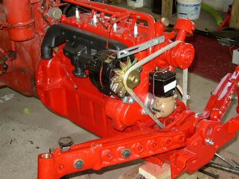

    Hate to ask... but is their any doubt in your mind that that old flattie will hold up as a stressed member? Gary
  13. rottenleonard
    Joined: Nov 7, 2008
    Posts: 1,993
    rottenleonard
    Really not too worried if you look at something like an 8N ford tractor which has a B motor, the engine is the frame, we did A LOT, of stupid stuff in those and we broke lots of other things like wheels and axles but never a block. v75.jpg
    Kreepea_1, Jet96, ol'stinky and 3 others like this.

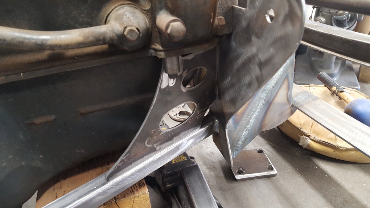

    rottenleonard

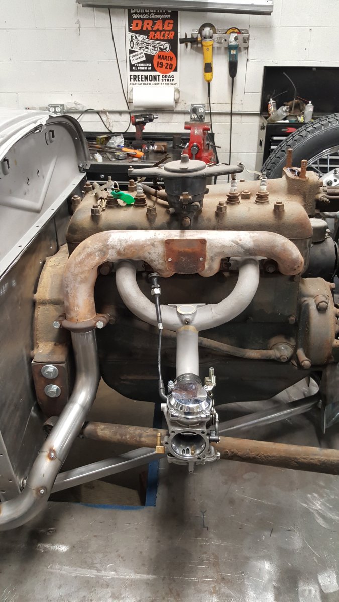

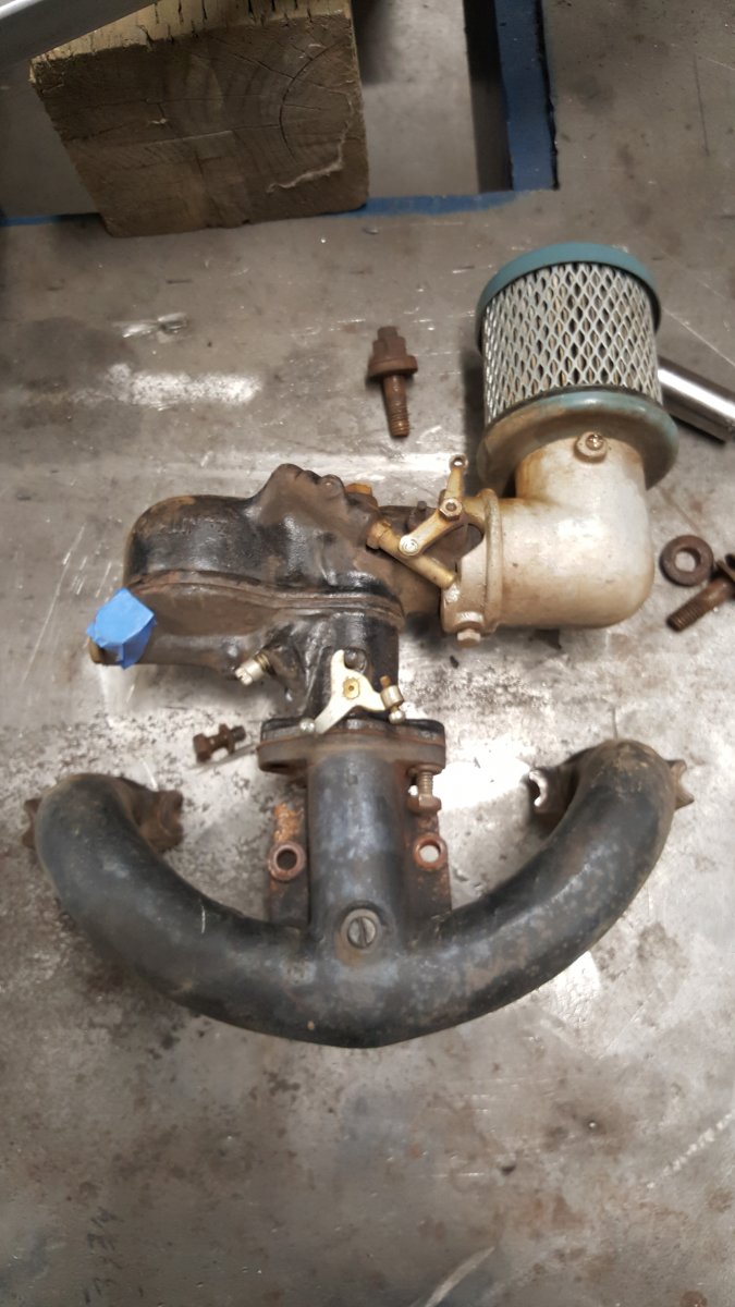

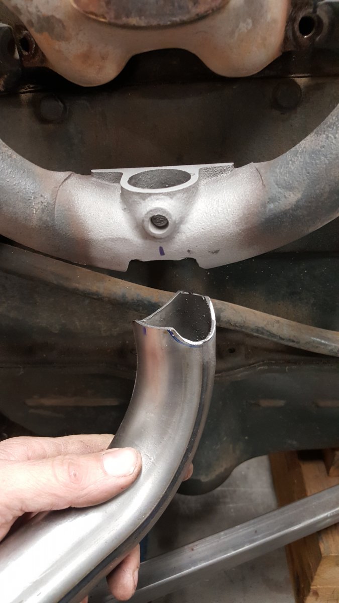

    I worked on the exhaust, intake, and front spring hangers yesterday. 20171101_105321.jpg 20171101_111052.jpg 20171103_083532.jpg 20171103_094609.jpg 20171103_162108.jpg 20171103_162054.jpg 20171103_161823.jpg 20171103_162118.jpg

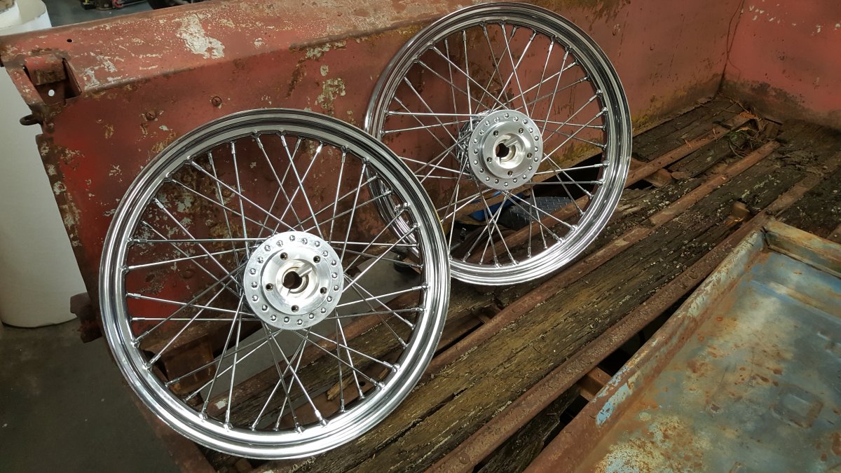

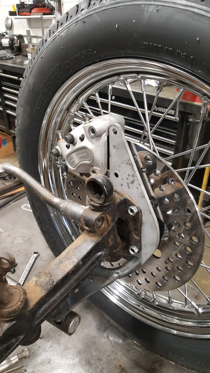

    I also machined up another pair of Harley wheels for Model A spindles, if anybody would like a set they are ready to go. $700 for the pair 20171102_140450.jpg

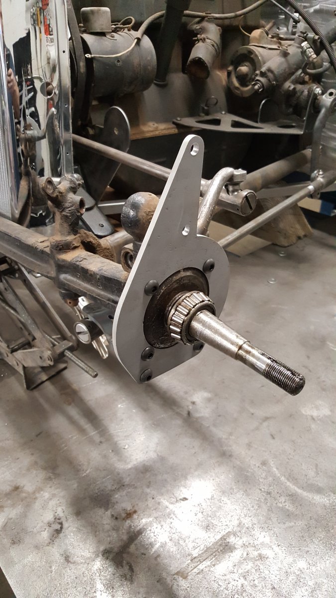

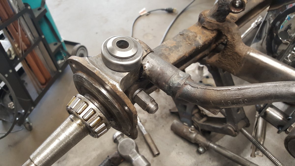

  23. rottenleonard
    Joined: Nov 7, 2008
    Posts: 1,993
    rottenleonard

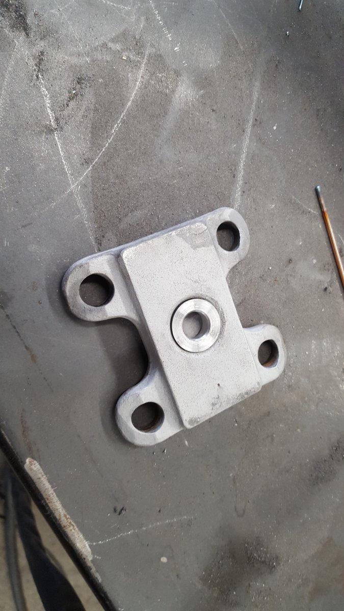

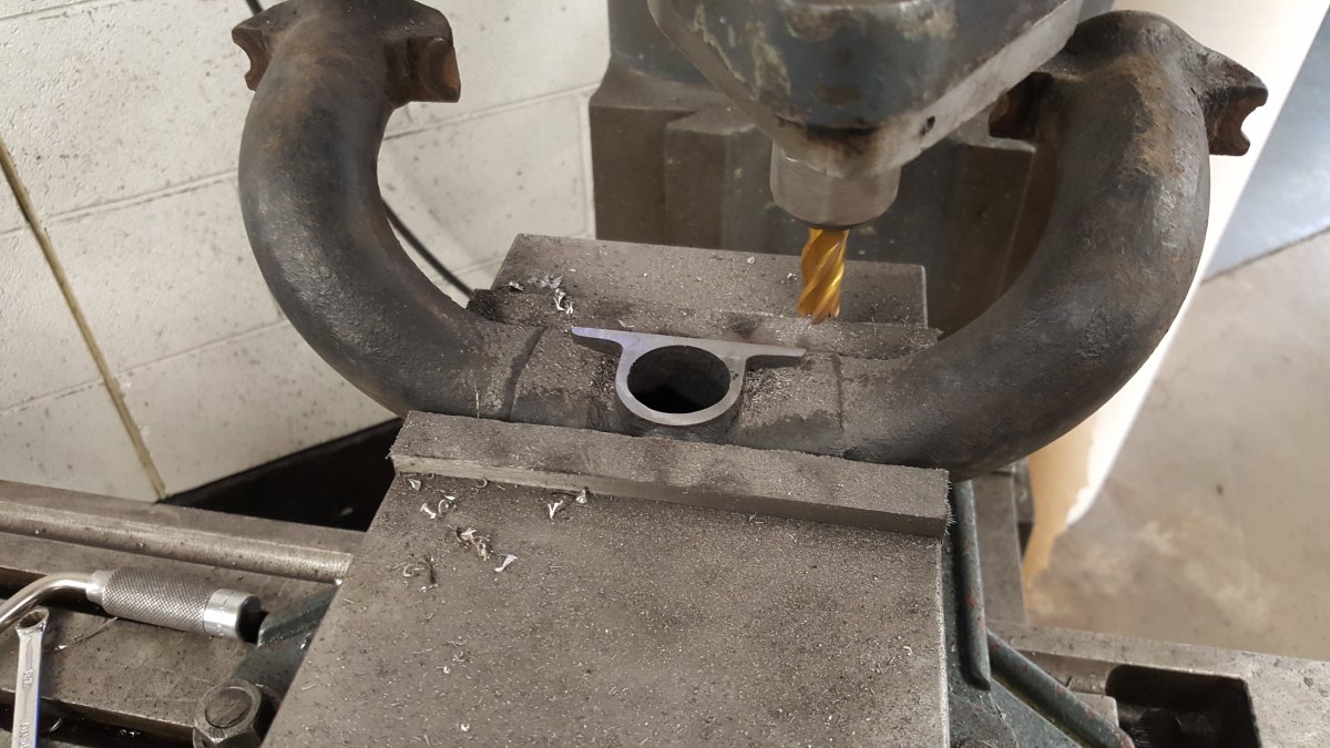

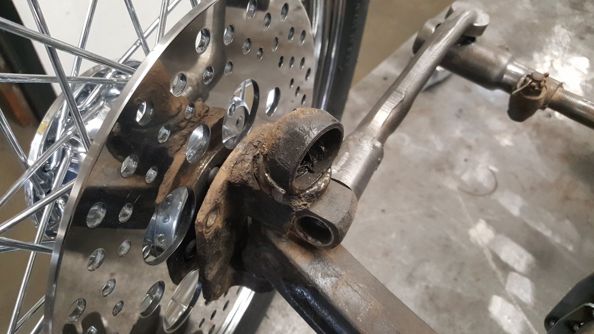

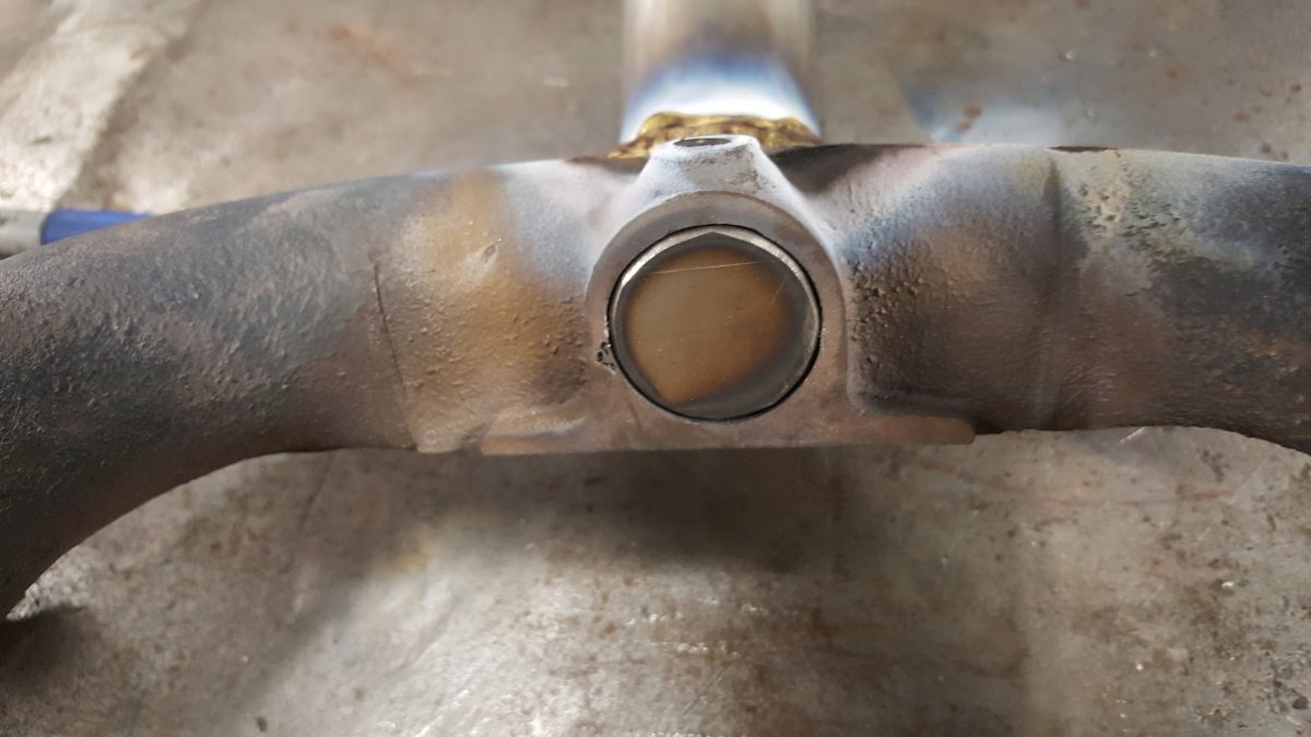

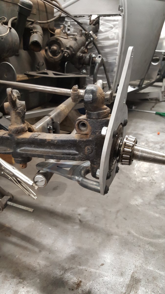

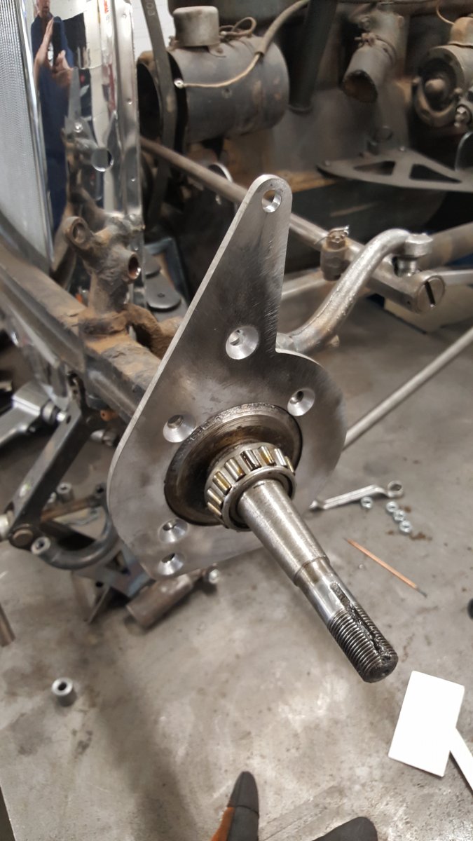

    I knocked the topps off thr king pins, required a little filler and lathe work
    Then reworked the brake brackets a little

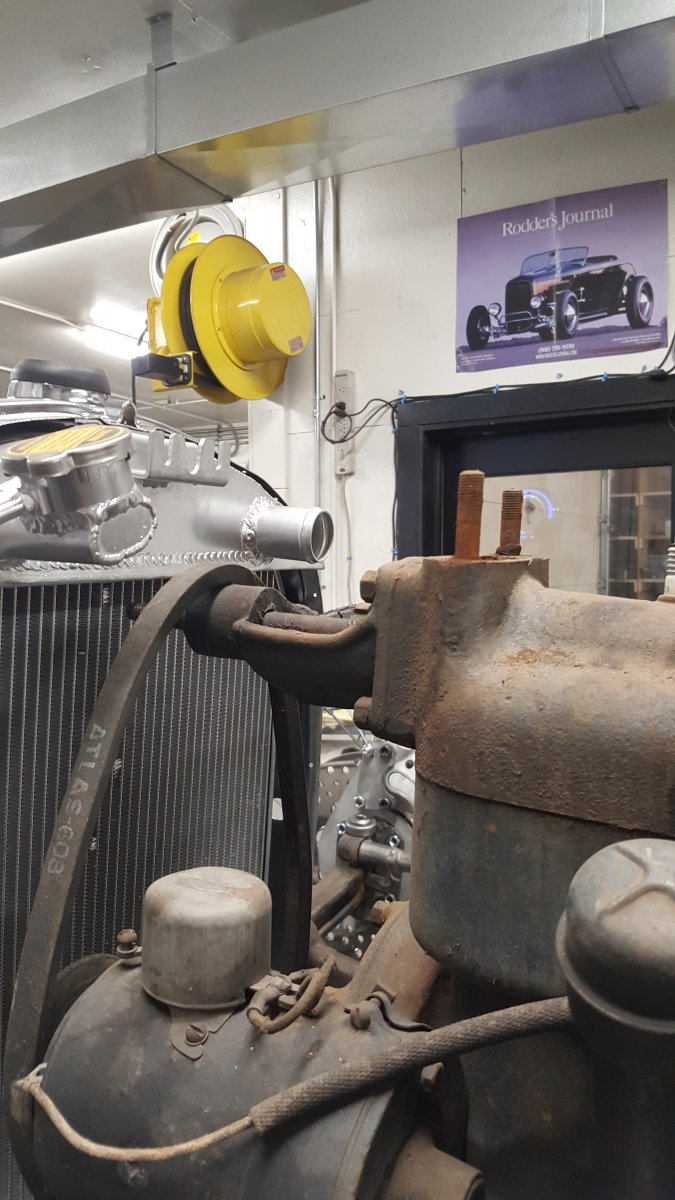

    Getting the coolig system to flow without an air lock was going to require a little modification

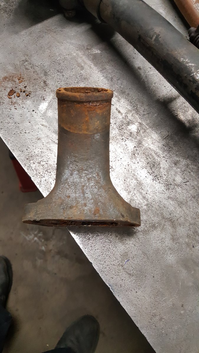

    20171113_154629.jpg stock upper water neck
    Cut off and milled flat
    Bored a hole in the front for 1.5" tube and tig'd it together with silicone bronze.
    That should let the air out and the water past.
    Stogy, AHotRod, Thor1 and 2 others like this.

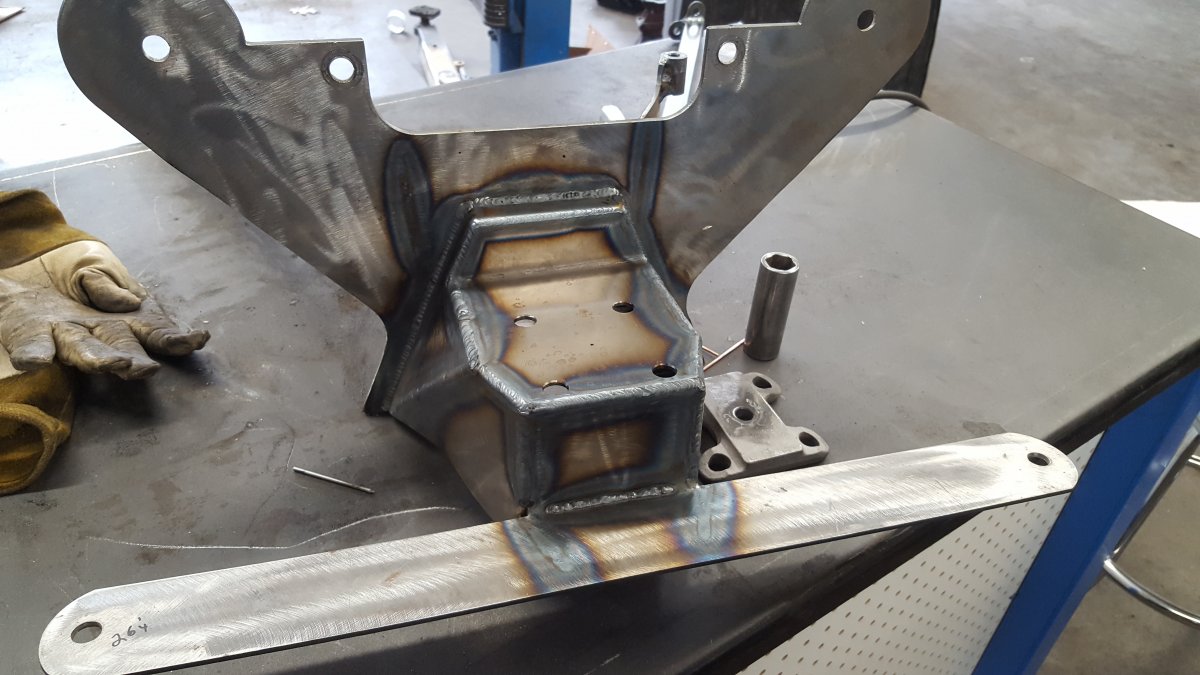

  25. rottenleonard
    Joined: Nov 7, 2008
    Posts: 1,993
    rottenleonard

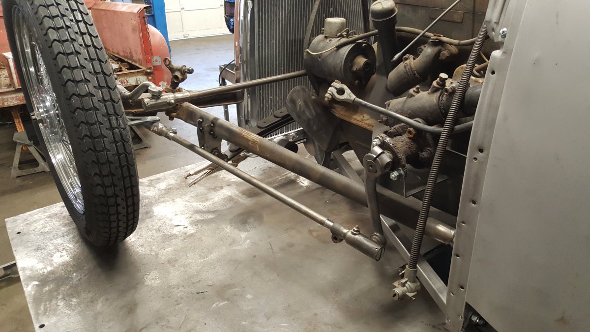

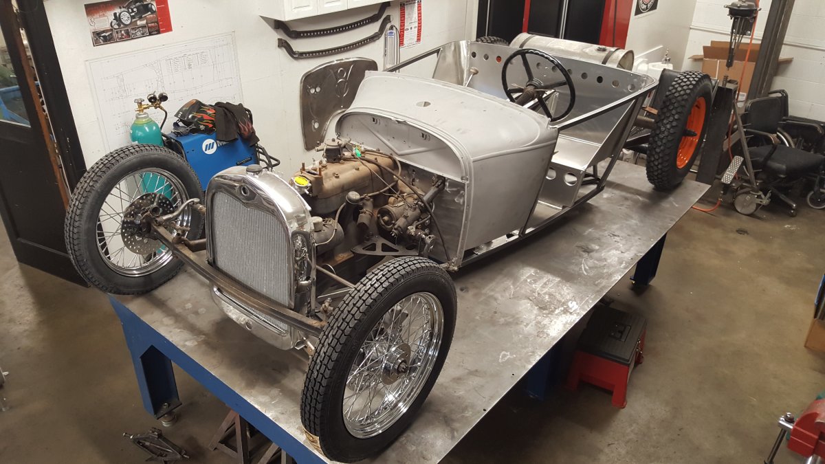

    I got back on the no frame model A last week, first order of business was gusseting the front subframe and also tieing it back into the bottom of the block at two more points.
    Trying to reuse as many Model A Parts as possible this spring spacer needed to be repurposed as a spring locator. So I spun up a sleeve and Tig welded it in. 20180327_113459.jpg
    While the car was together my guess at ride height was about an inch and a half too low. The solution was to section out the front spring Mount to bring it up so I have just a little drop front to rear.
