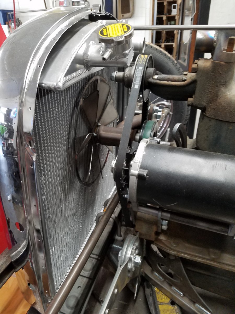

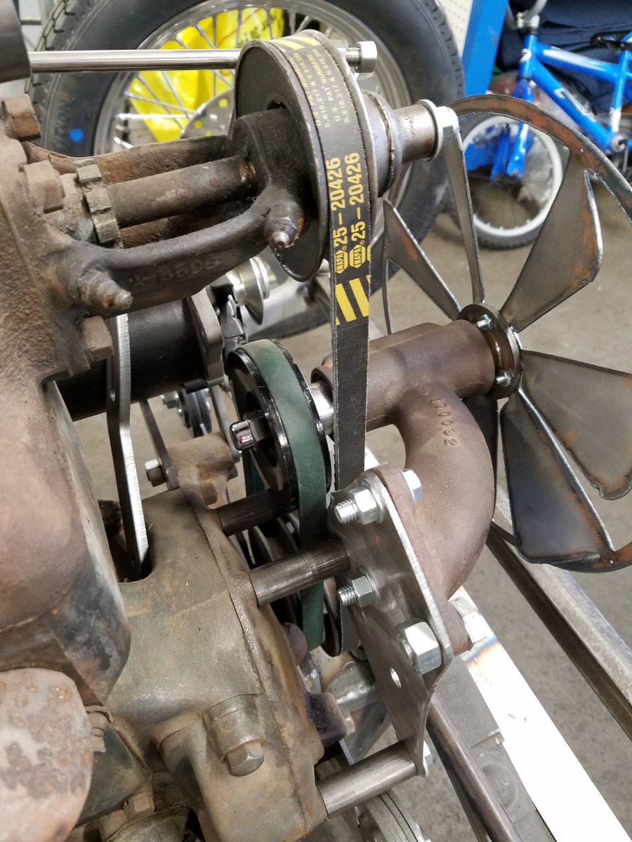

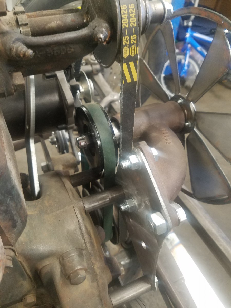

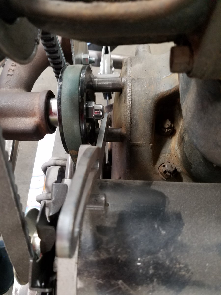

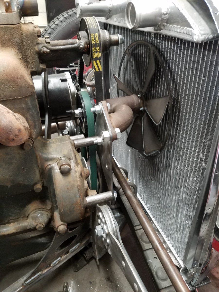

    I have been tinkering on it here and there, I bought 30 Acres of Timber near us and have been spending a lot of time there instead of playing with hot rods. But we will get back to it.one of the things I've got mostly done was adapting a Model T accessory cooling fan to the A engine by welding an additional pulley to the backside of the crankshaft pulley. I will make a new fan, the one on there was cut on my plasma bed and is a little too small but works for mock-up. I will have the final fan cut on a water jet and should be at least 2 inches bigger in diameter. Granted model A's didn't have much of a fan and this radiator I would think is much more efficient. I do plan on picking up one of H and H's touring Motors when this thing gets All Shook down.

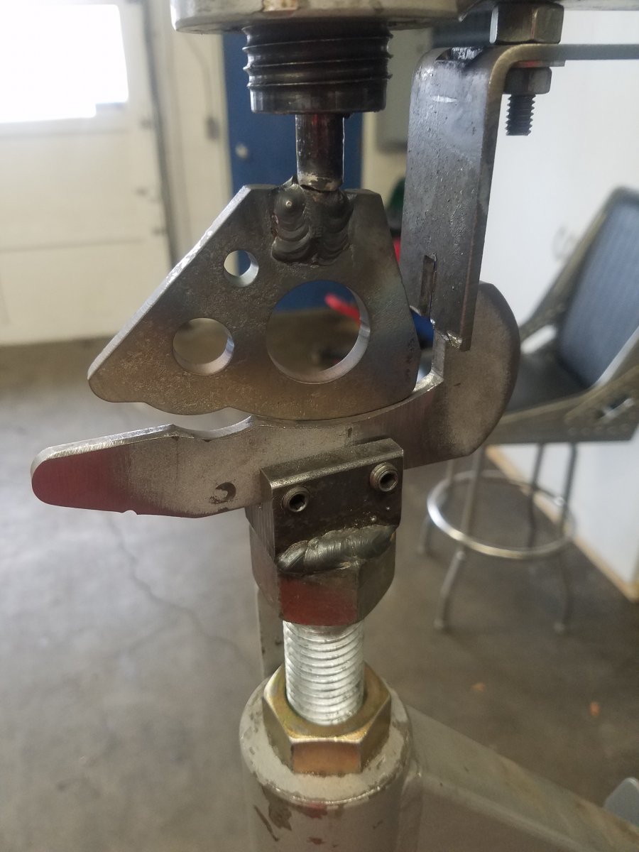

    Also been playing with making body lines using my Harbor Freight planishing hammer, has problems but shows some promise 15339392119051332619759650114595.jpg

    Do you have any more pics of how you mounted that T fan ***embly? I need to do the same thing on the B motor in my T, because the stock fan location will hit the radiator top tank, and the electric fan is fugly...

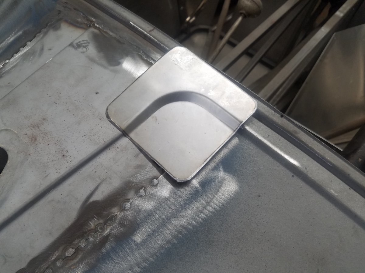

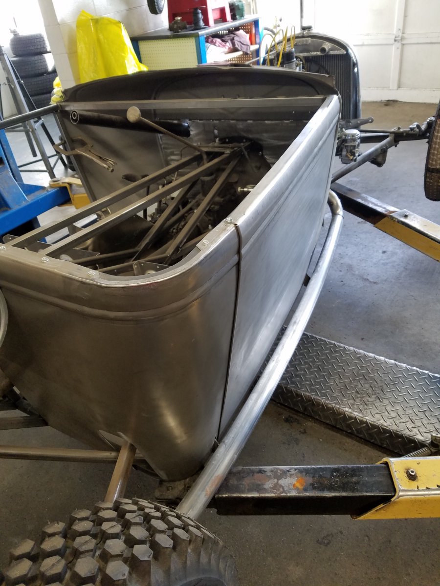

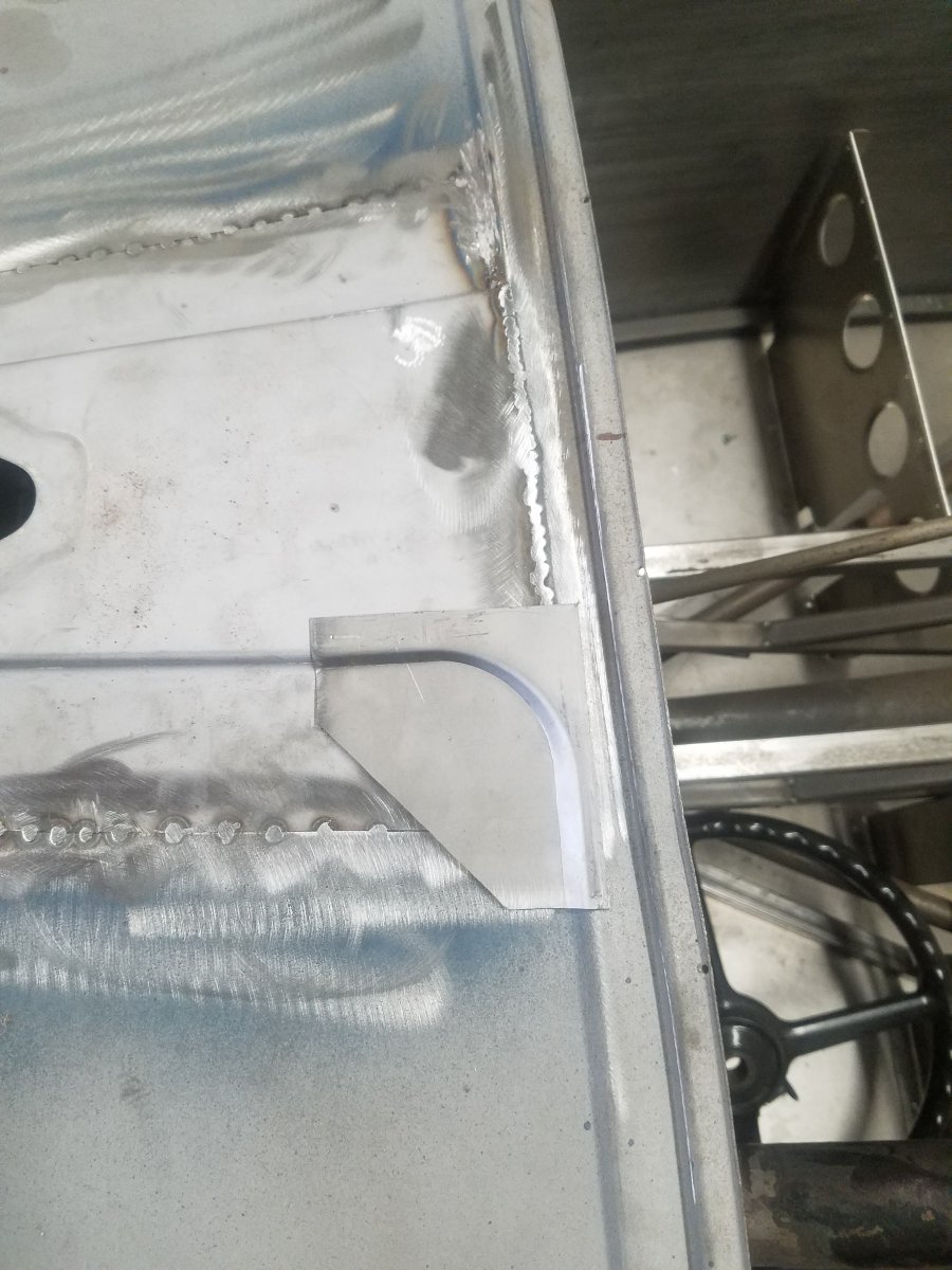

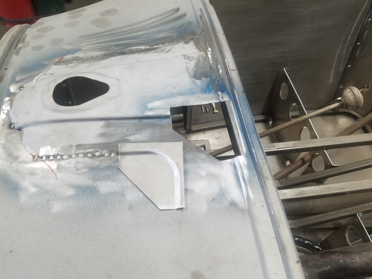

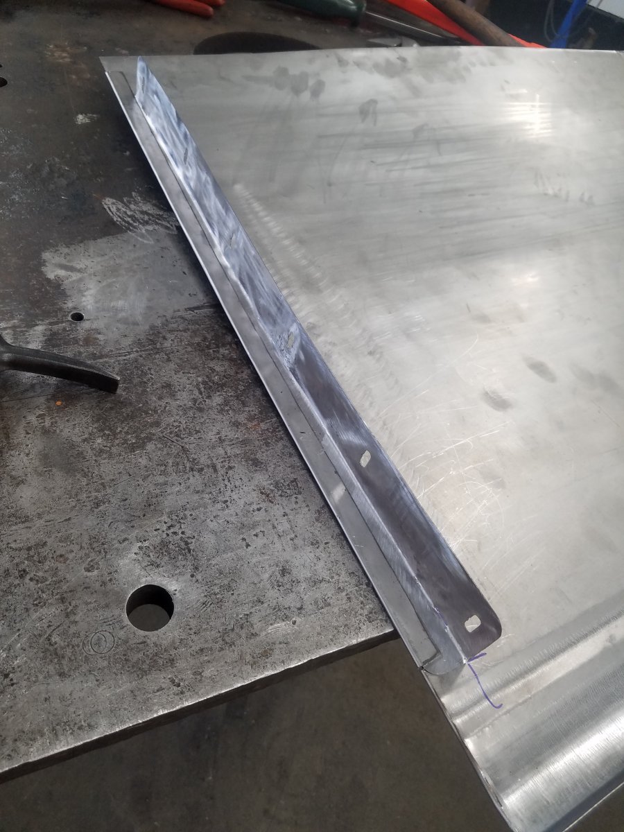

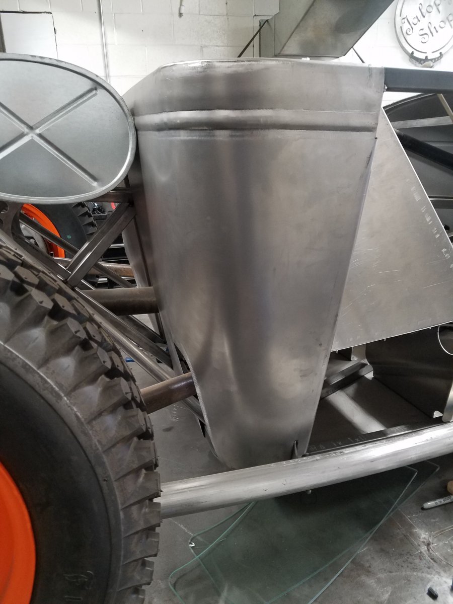

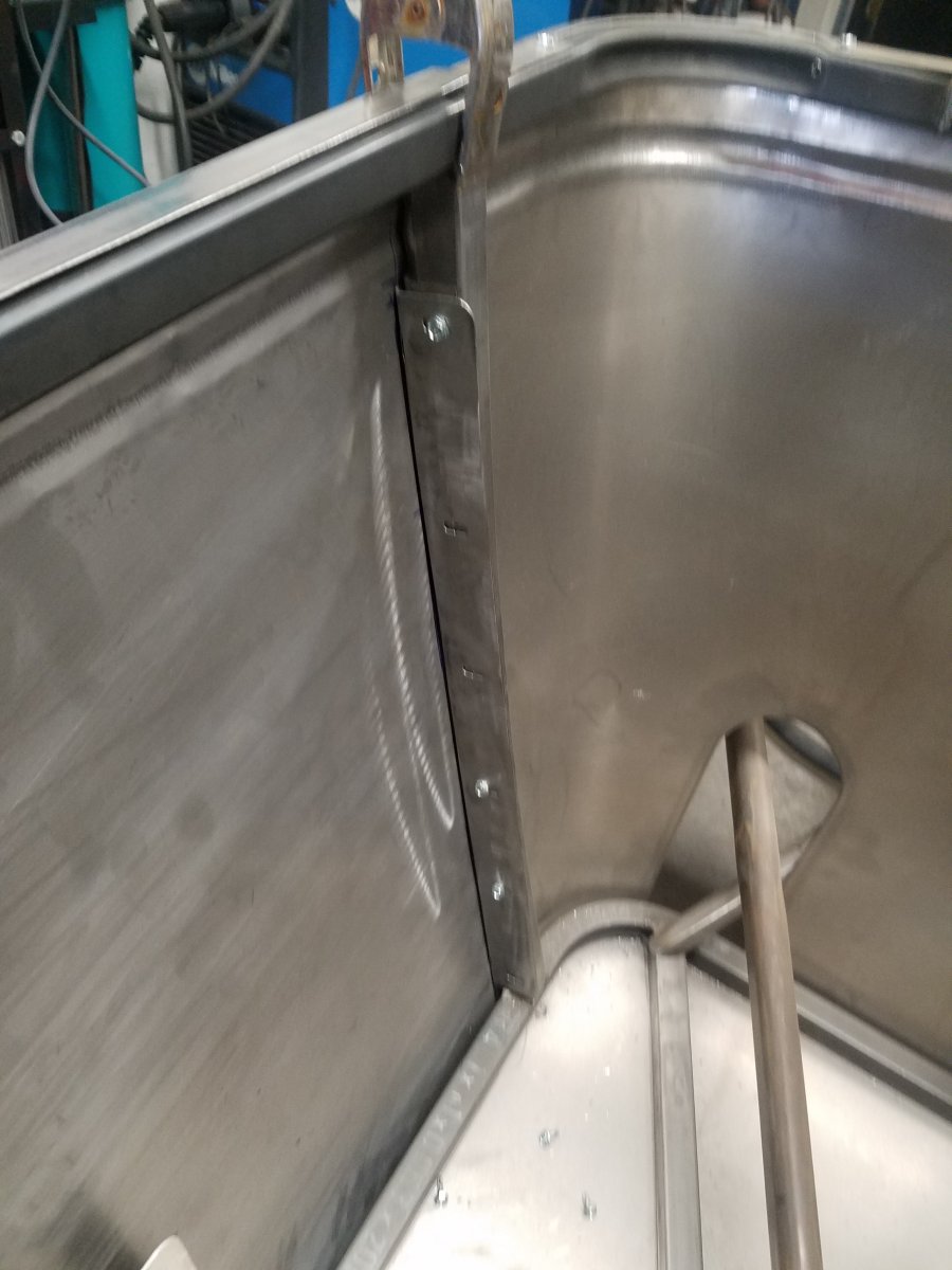

    Little photo heavy post, worked on the No-Frame a little last week. Roughed out a p***enger door skin, the Harbor Freight plannishing hammer was working pretty good until the mild steel shaft gave up. I also did some machine work on the accessory drive. And whipped up a licence plate bracket to mount up a plate from my old man's Idaho licence plate collection he gave me last week. 20190111_103240.jpg 20190111_104416.jpg 20190111_161930.jpg 20190111_104832.jpg 20190111_120825.jpg 20190111_164348.jpg 20190111_135643.jpg 20190111_135652.jpg 20190111_103221.jpg 20190111_161209.jpg 20190111_161942.jpg 20190111_104842.jpg 20190111_161946.jpg 20190111_162508.jpg 20190111_120818.jpg 20190111_162525.jpg

    Thanx for posting the pics of your T fan adaption to the A motor

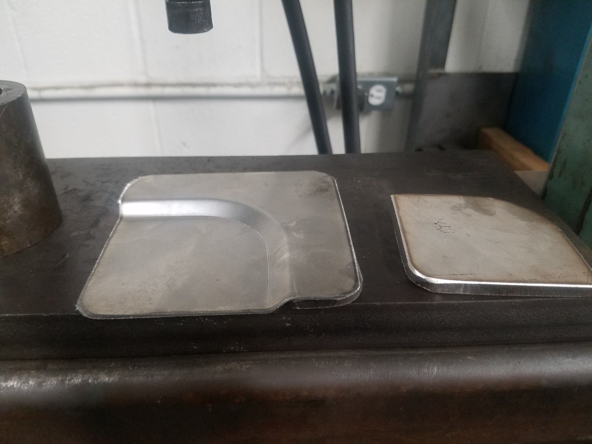

    More or less just to see if i can do it. If i can make this work i can whip out custom dies on my plasma bed in a short amount of time for very little cost, turning custom rolls is pretty time consuming. It shows promise, just need to finish making all the mistakes

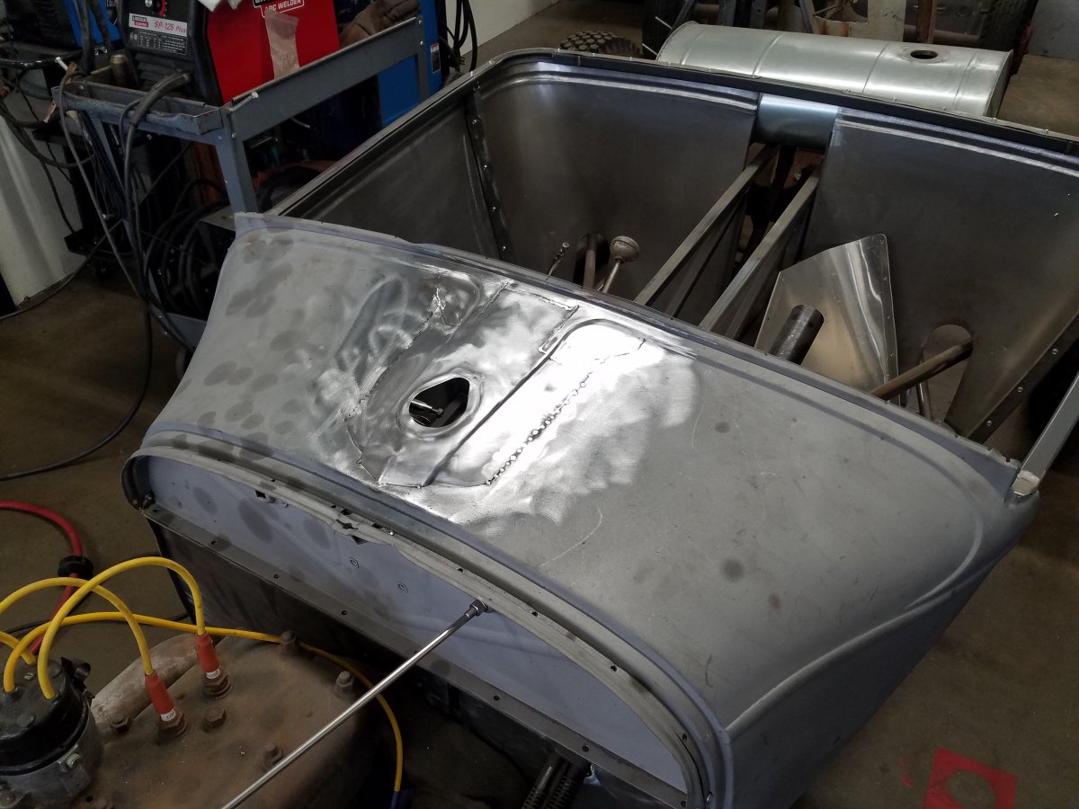

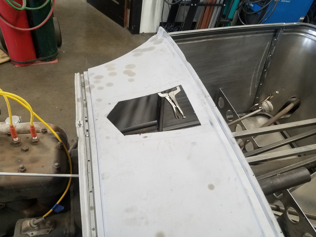

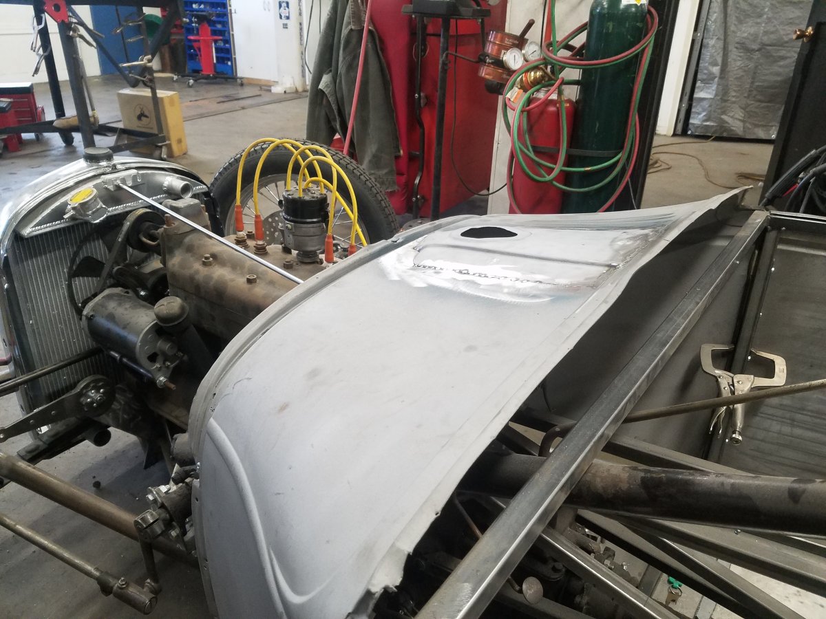

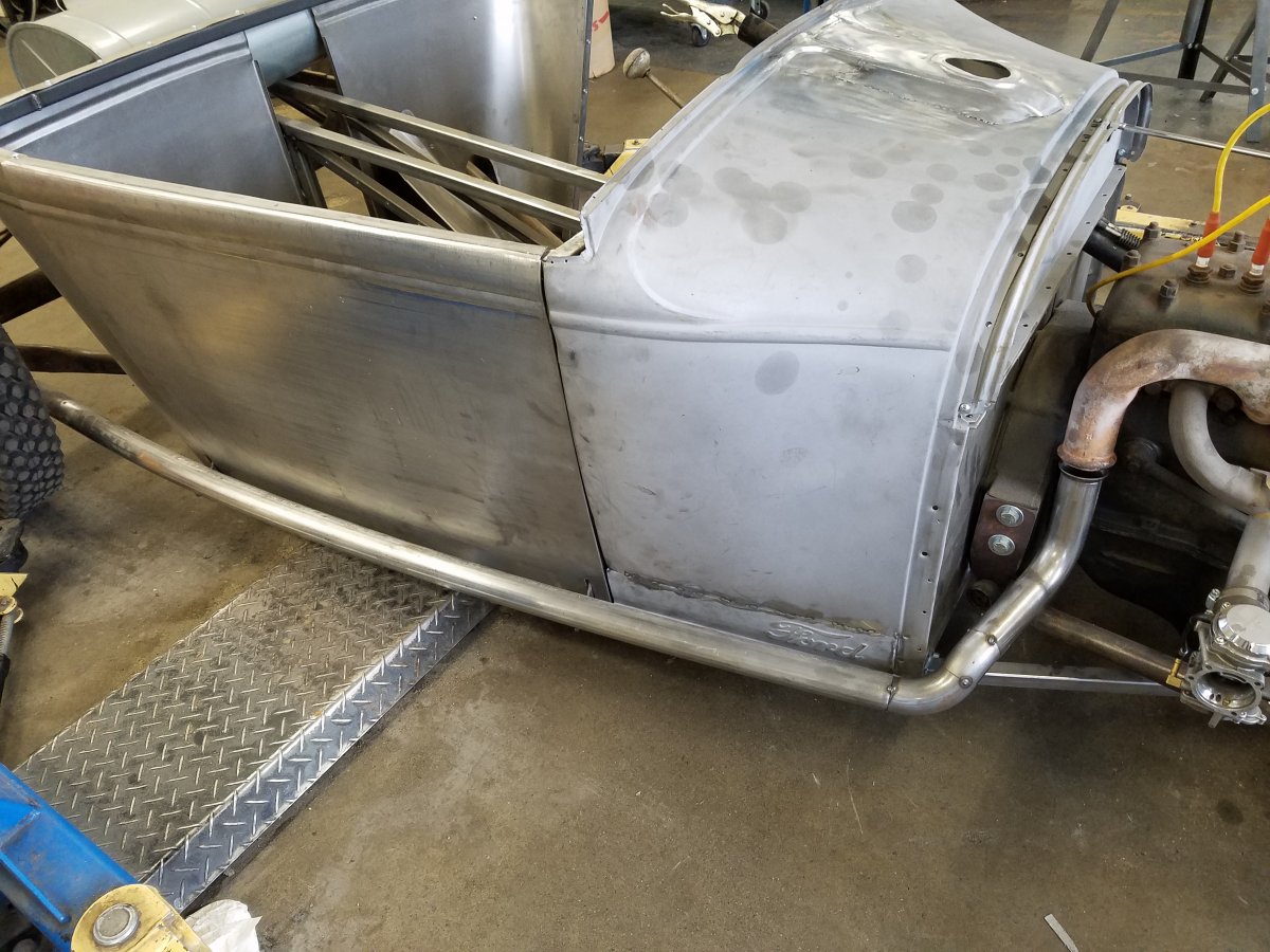

    I had a buddy give me this old 8N Ford tractor hood for a donor.
    After it sitting around the shop for a couple weeks i just had to use the radiator cap surrounding, my cowl top was rusted out where dirt had been trapped between it and the gas tank.

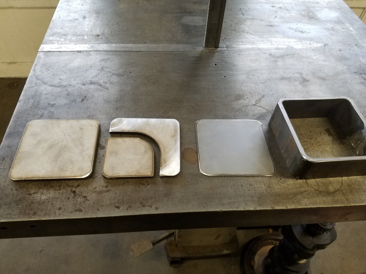

    I didn't care for the way it transitioned into the windshield step, the square joint looked out of place.
    So i got on the plasmacam and cut out some press dies and a blank that fit inside of a section of square tube. This really worked fantastic I was able to cut different punches to get it to transition from one profile on the cowl to another on the hood piece.

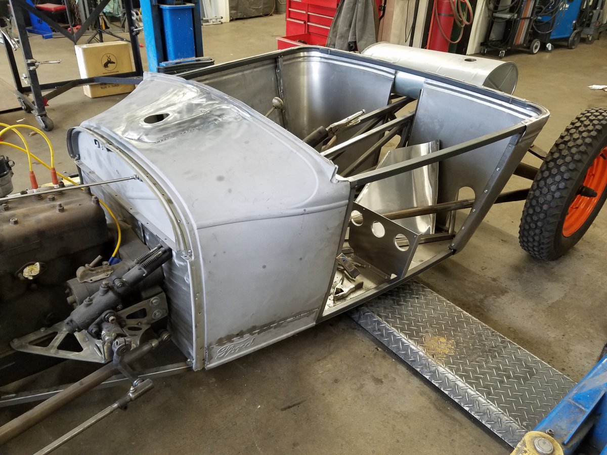

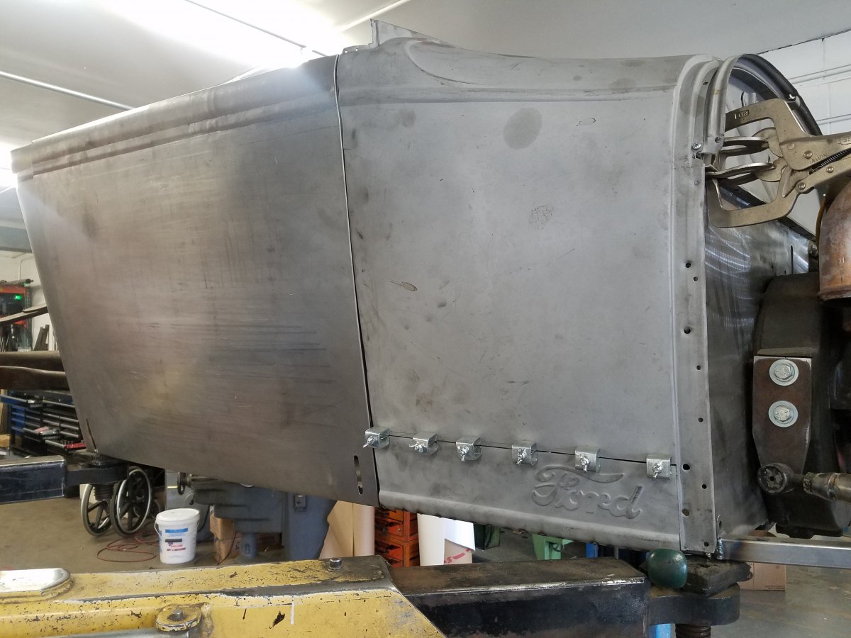

    then it was on to the reason I wanted the hood in the first place, the 8N Ford hoods have these great scripts on both sides and the Beltline looks a whole lot like the bottom of a Model A Body.
    Keep in mind I am definitely not being at all OCD with these joints, rather basically doing a quick and dirty let's drive it this summer kind of a thing. I will work the joints to be a little better when I pull the cowl off next. But we're definitely going to need some filler. 20190212_161023.jpg
    20190213_133027.jpg 20190213_131904.jpg 20190213_143613.jpg 20190213_143622.jpg
