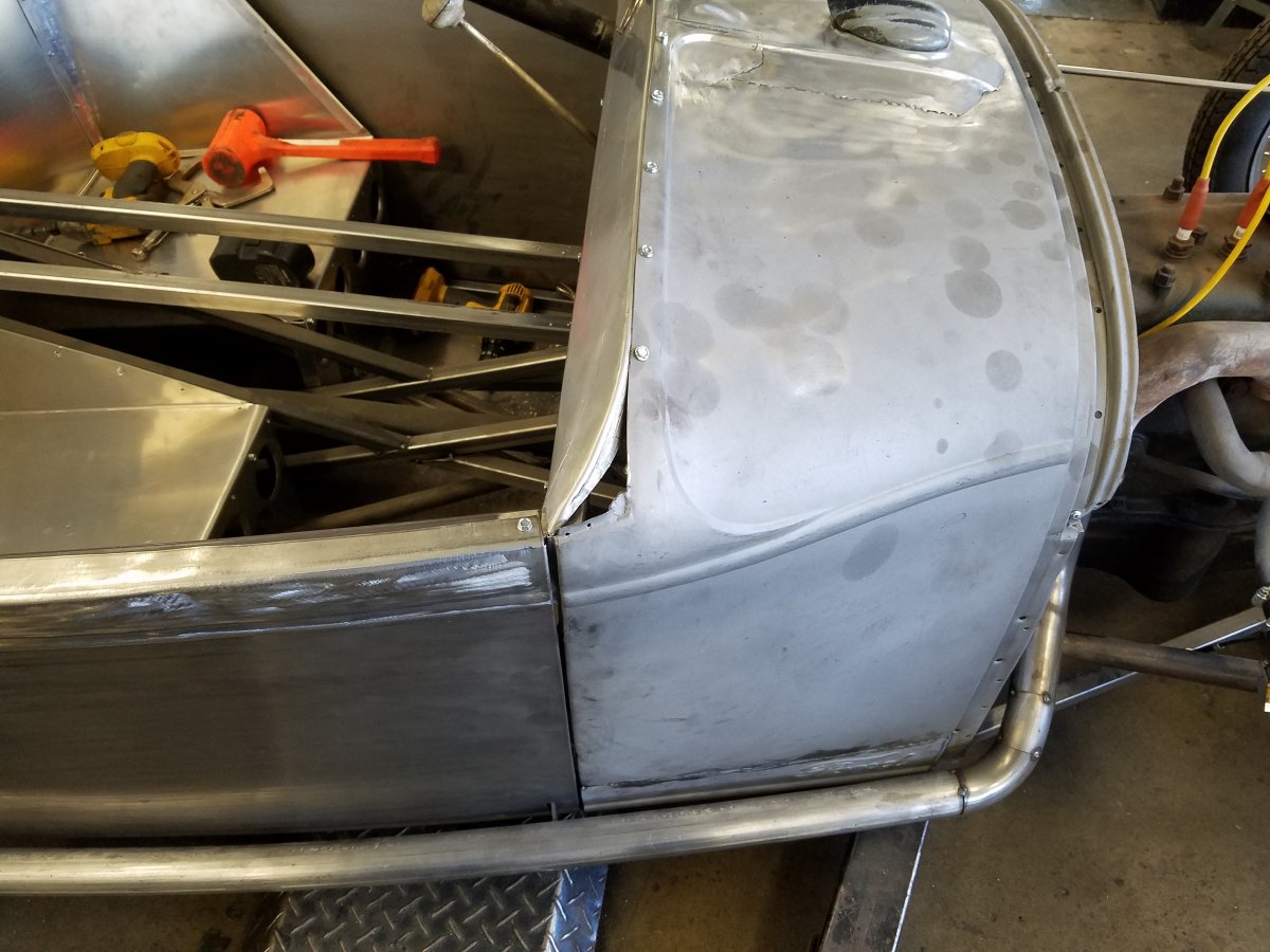

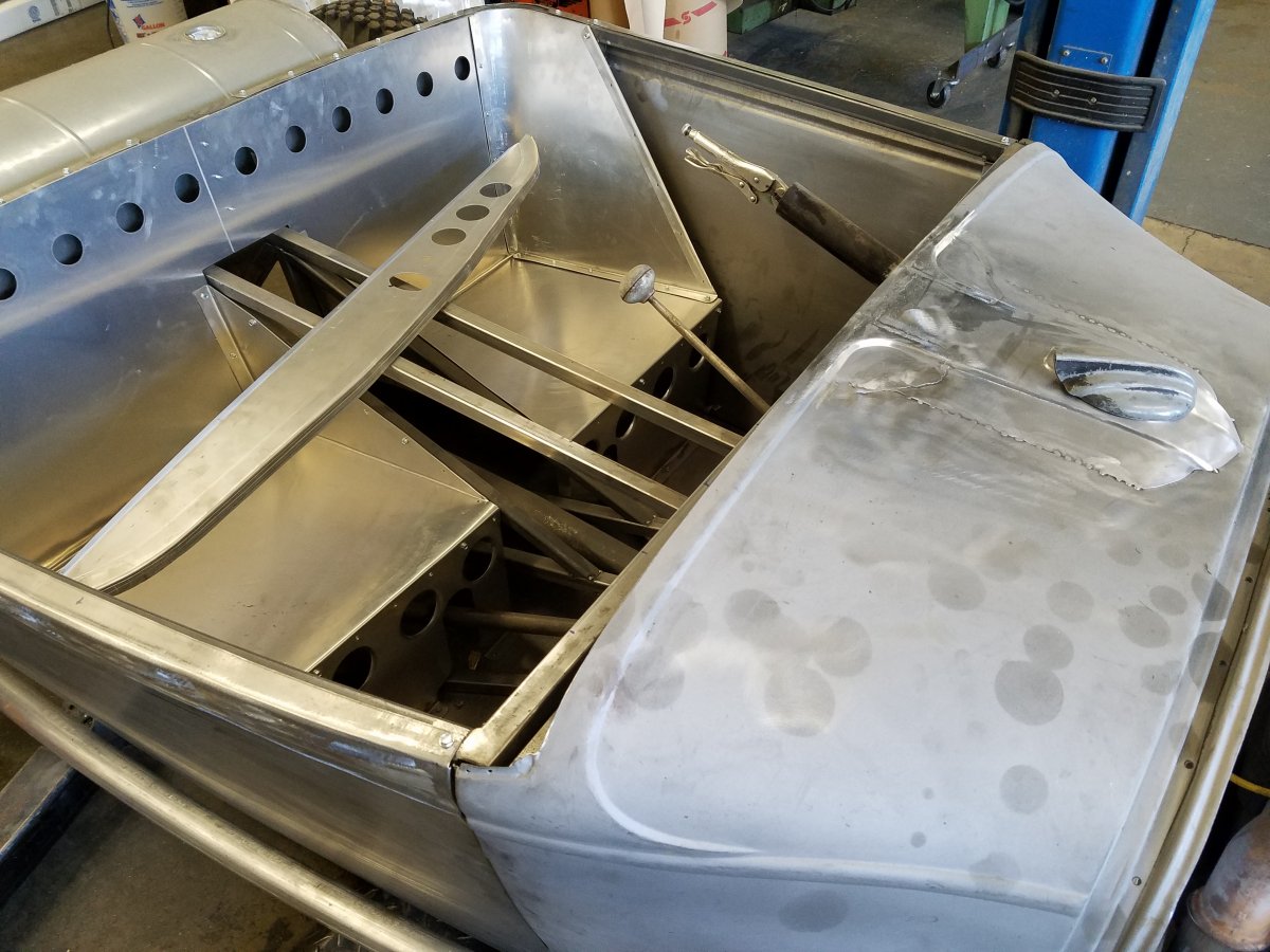

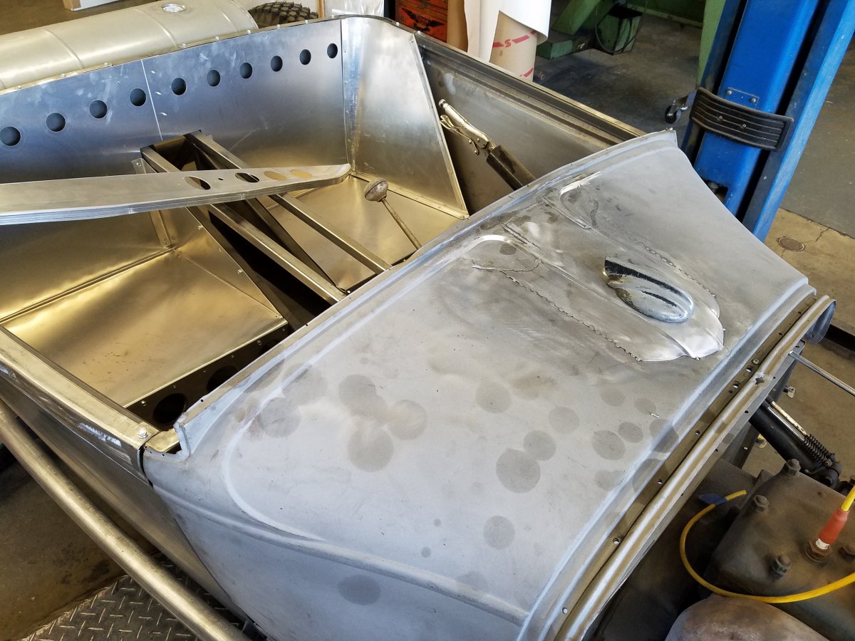

  3. rottenleonard
    Joined: Nov 7, 2008
    Posts: 1,993

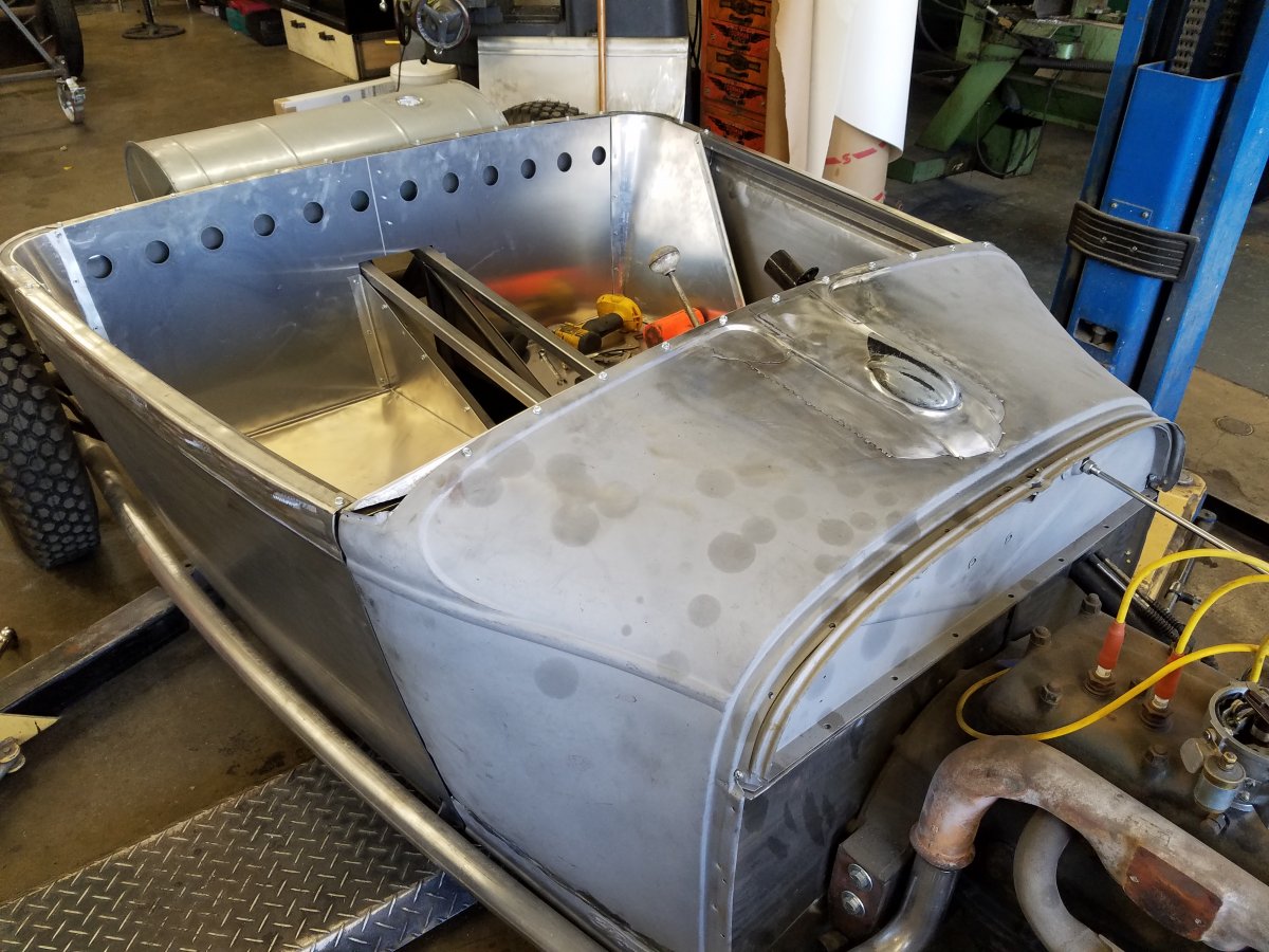

    rottenleonard

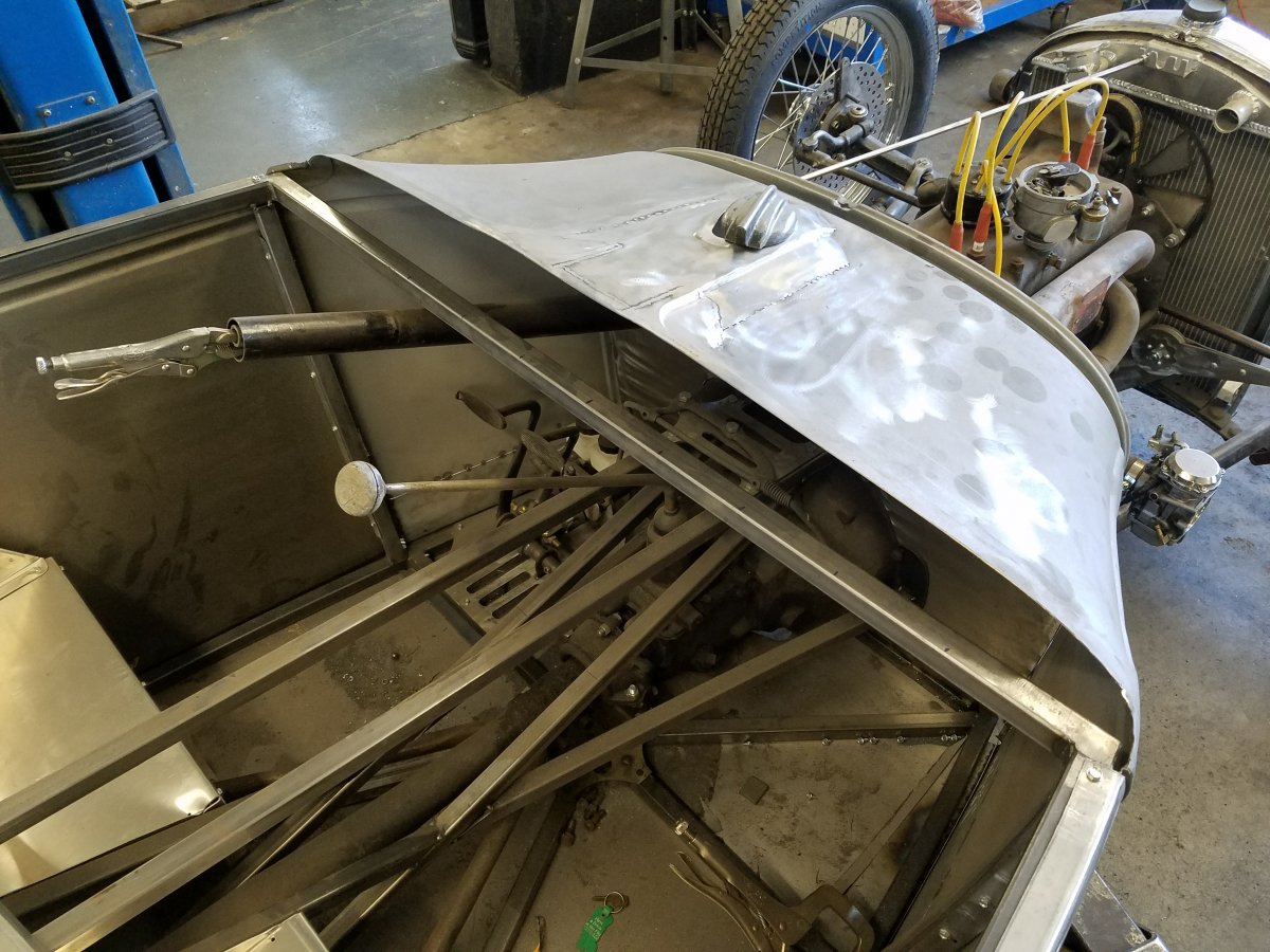

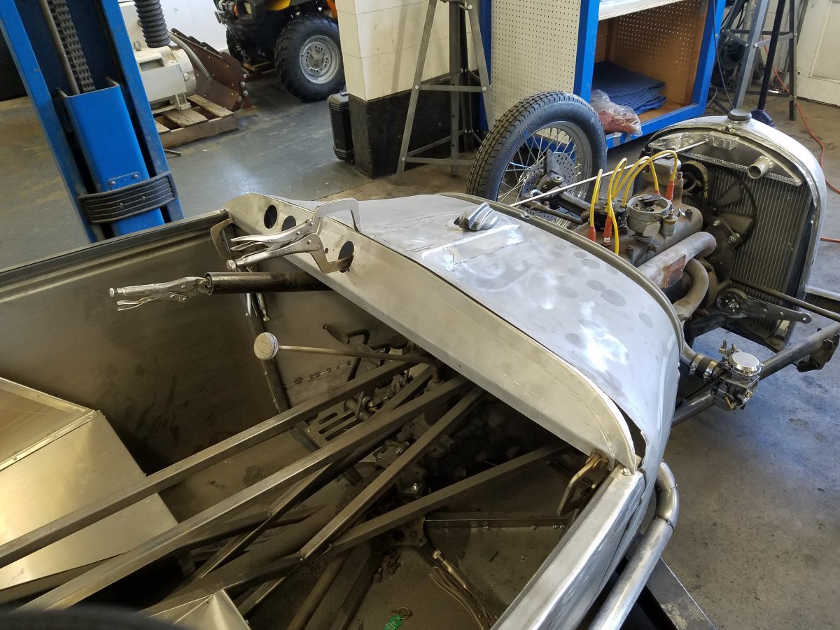

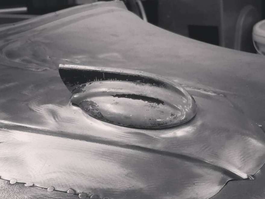

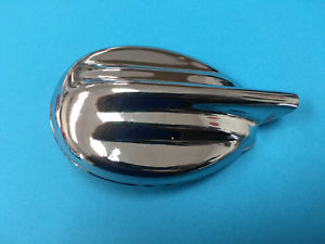

    The jury is still out on the top of the cowl. It may go away or not but i want to see it with the tonue(sp?) Cover. I need a way to fill the brake fluid remote reservoir and so im planning on adapting the 8N rad cap pictured into a cover over the reservoir cap.
    Might be cool might be cheesy we will see.

  5. Nostrebor
    Joined: Jun 25, 2014
    Posts: 1,337
    Nostrebor
    It really starts to work after you dropped in the formed radius pieces at the back edge. The "nose" portion of the detail might end up feeling a bit heavy... it would be easy to drop it down a step. Well, sort of easy:confused:
    Both details add a lot of dimension. It's like what a designer might have done before the bean counters got ahold of it.

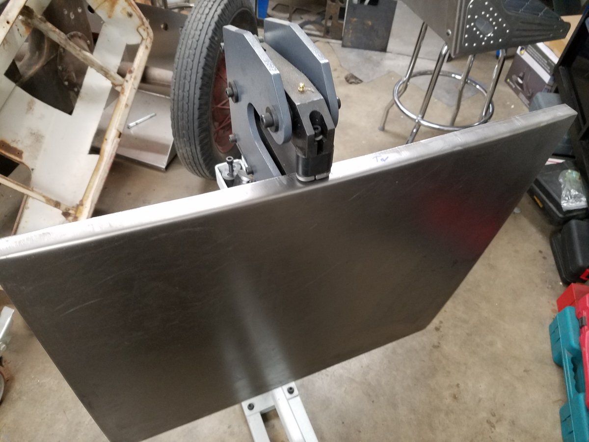

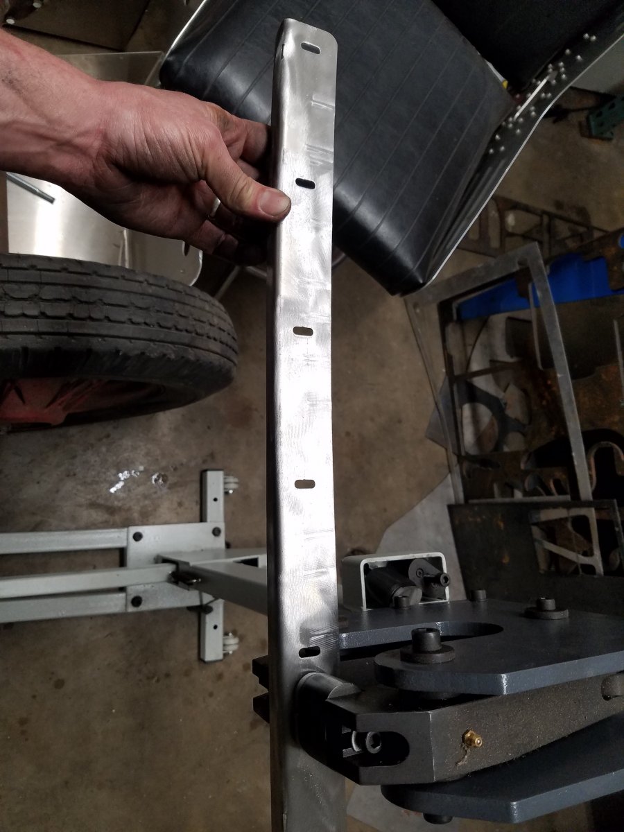

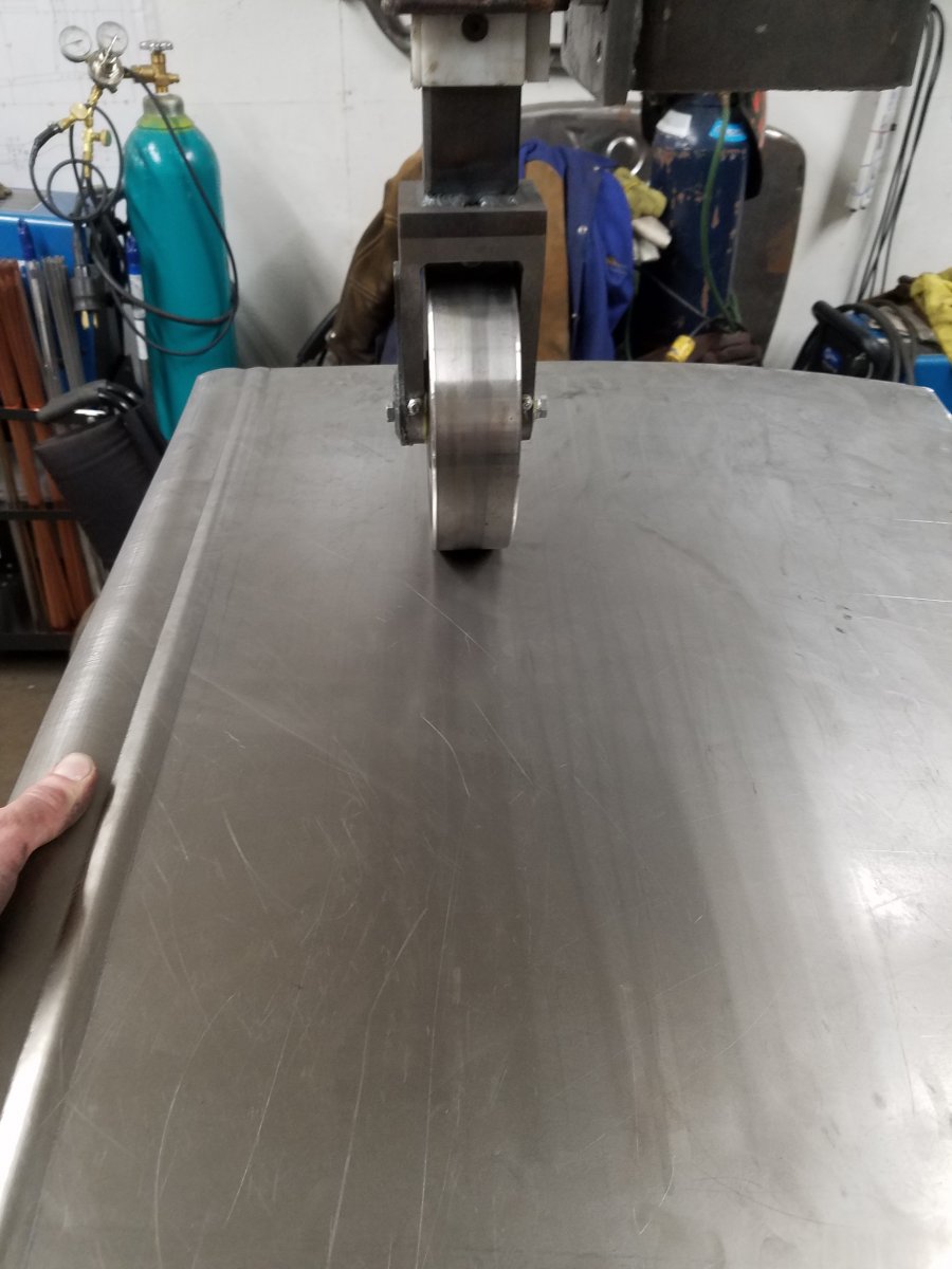

    The family is out of town for a few days so onto the no-frame to keep out of the bars...
    Cut a new door blank for the drivers door and shaped it up. Also had to re machine my lower bead dies to be able to put them on my bead roller backwards. 20190328_194129.jpg 20190328_185234.jpg 20190328_185332.jpg 20190328_190753.jpg 20190328_203446.jpg 20190328_193441.jpg 20190328_204448.jpg 20190328_204524.jpg
    flynbrian48, porkshop, Stogy and 9 others like this.

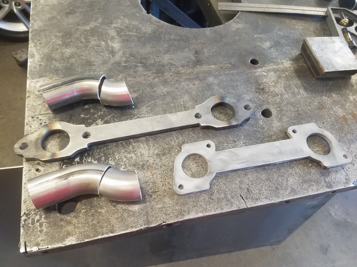

  11. rottenleonard
    Joined: Nov 7, 2008
    Posts: 1,993
    rottenleonard
    The brackets for the side exhaust p*** threw there.

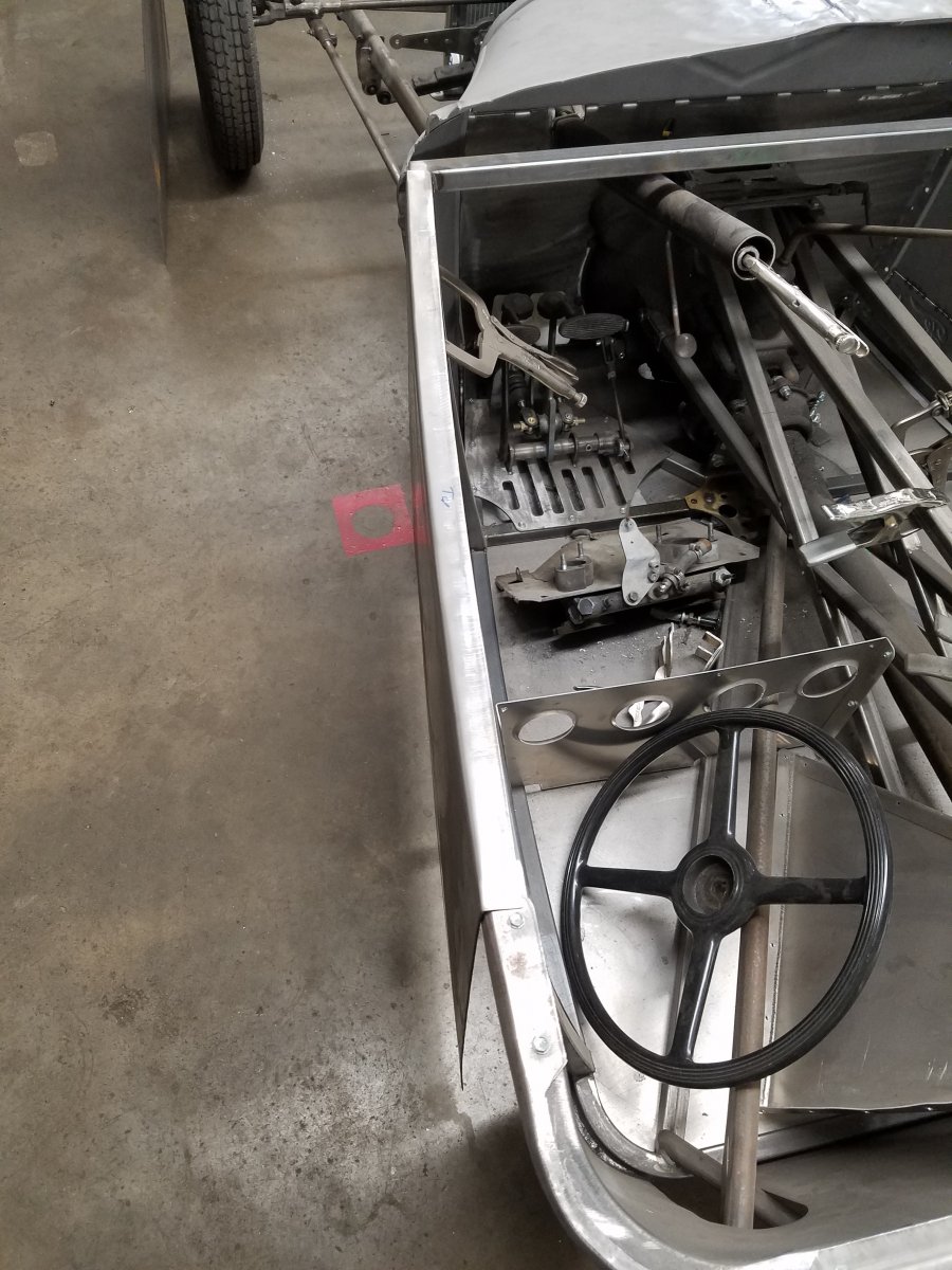

    Worked on the dash a bit.
    20190330_143533.jpg 20190330_131857.jpg 20190330_143527.jpg 20190330_145719.jpg 20190330_151524.jpg 20190330_143521.jpg 20190330_143501.jpg 20190330_163016.jpg 20190330_163650.jpg 20190330_163656.jpg

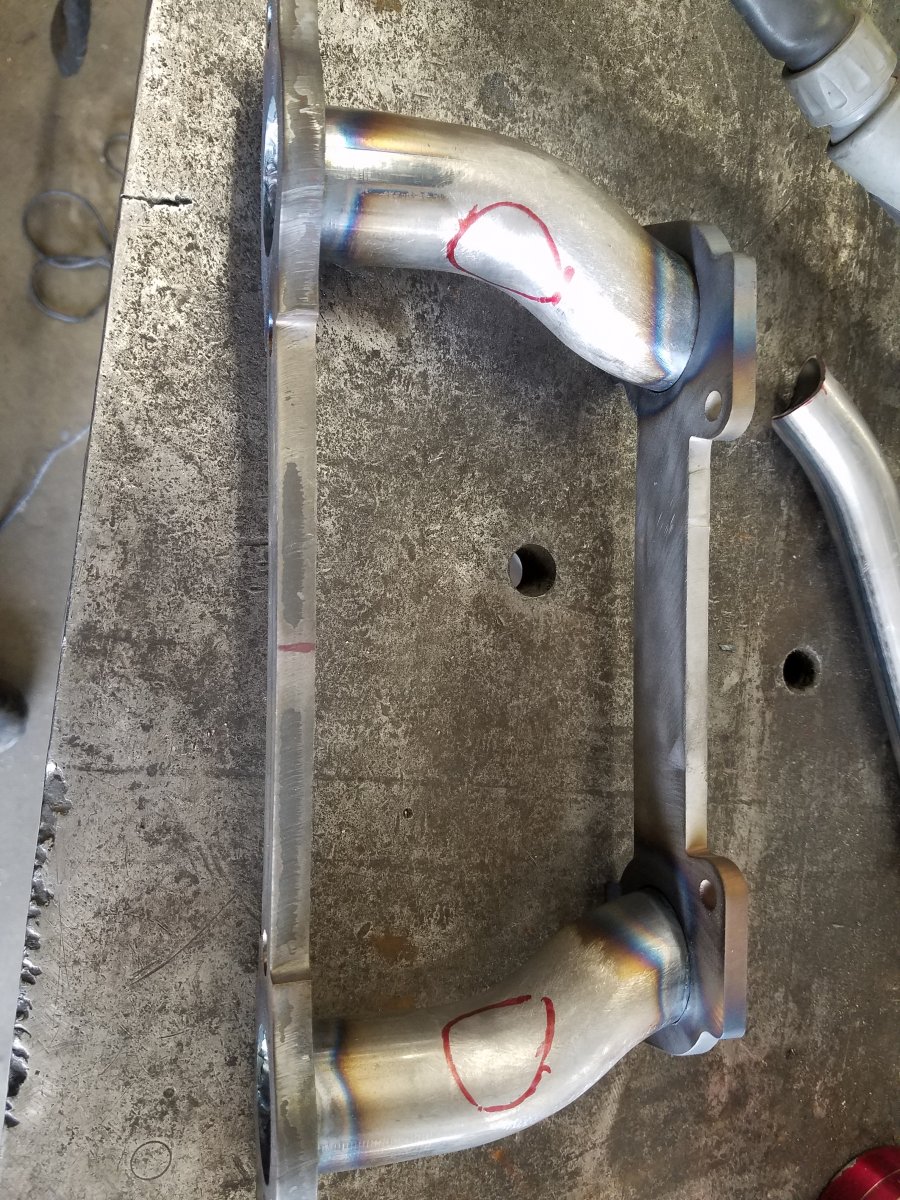

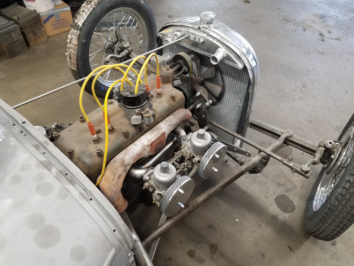

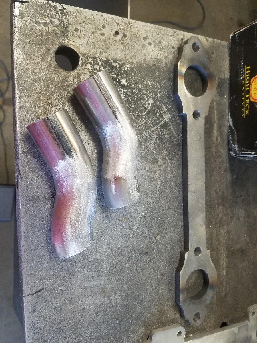

    Thanks guys, i appreciate the kind words, really been letting myself do whatever comes to mind on this one. It's really being built out of raw material and cast off parts so there is no need for guard rails like if you had a valuble car to start with. Just trying a few things and if I don't like it just round file and start over...Case in point.......
    The flaccid **** of an intake manifold that I put together, I haven't liked it since the day i put it on.

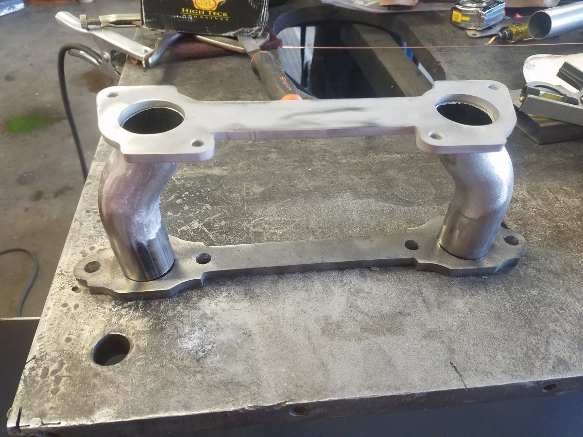

    A friend of mine that owns the local European repair shop in town gave me a pair of SU's off of an early 70's MG.
    So i cut some flanges on the Plasmacam. I left the flanges tied together to get the correct spacing then i will cut them apart after it's all welded up.
    20190418_142704.jpg 20190418_145429.jpg 20190418_151324.jpg 20190418_164008.jpg
    Still some fine tuning to go but I suddenly have new motivation.... Bonneville! I haven't been to speedweek since 2010 and this would make the perfect salt taxi, SEE YOU THERE!

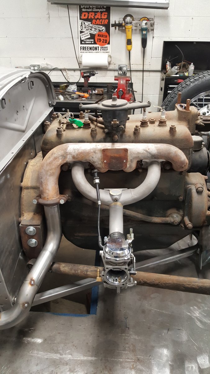

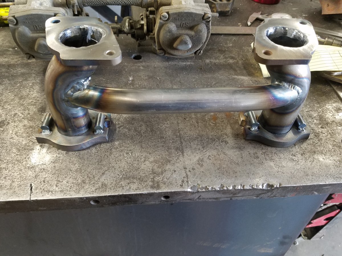

    The intake i got the carbs off of had a crossover tube, I figured it couldn't hurt.
    Here it is after cutting away the material that was holding the flanges together.
    I had way too much coffee to be tig welding tubing in tight places, definatly won't be posting it in the incredible welds threado_O but it will work. Also notice the bits of round stock tacked on to make up the thickness difference between the intake and exaust. I wanted a quick fix as I decided i would rebuild the exaust manifold out of tubing later to shed a bunch of pounds.
    Money shot, I bought some cheap air filters to get by but plan on dragging out my sand casting foundry later to do something cool. 20190419_135704.jpg 20190419_135130.jpg 20190419_165902.jpg 20190419_165856.jpg 20190419_165851.jpg
    Also picked up a new coil from ePay, need to get some new plug wires soon.
