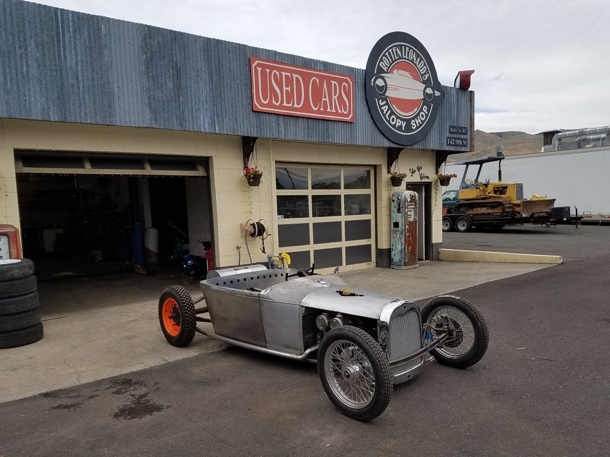

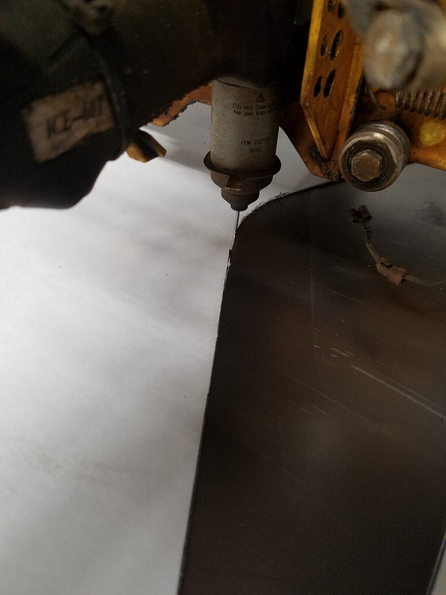

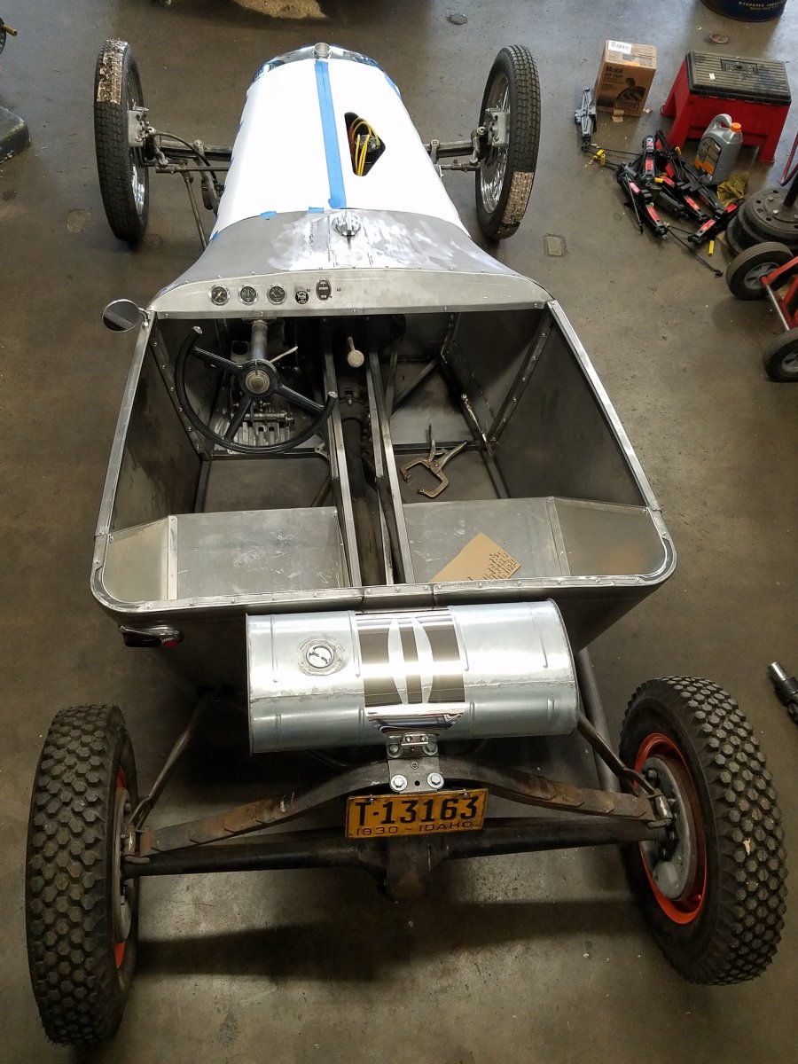

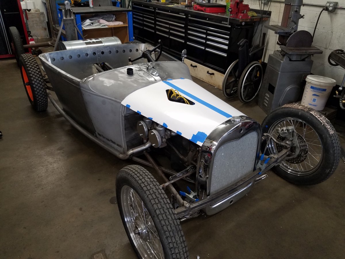

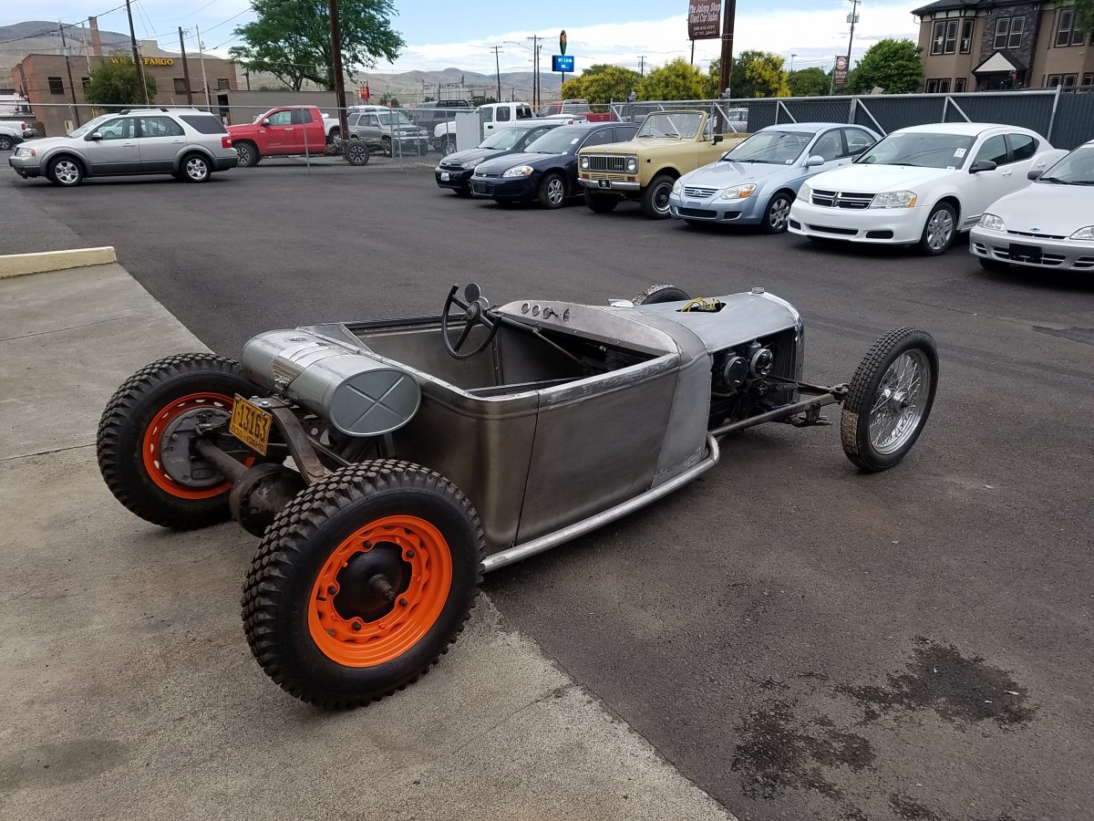

    I received back the fuel tank strap from the waterjet and installed it, pretty happy with it.
    Then pushed it outside to get a feel for the hood dimensions
    Made up some guardrails for the paper patterns
    Patterns made up with a cutout for the ignition. Still deciding on a cutout or a blister.
    So far I'm pretty happy with the direction of the car.

    I haven't seen a cut down steering wheel in a long time.
    I have enjoyed following your build. Can you find a 90% drive for the distributor so you don't have a hole in the hood. Frank

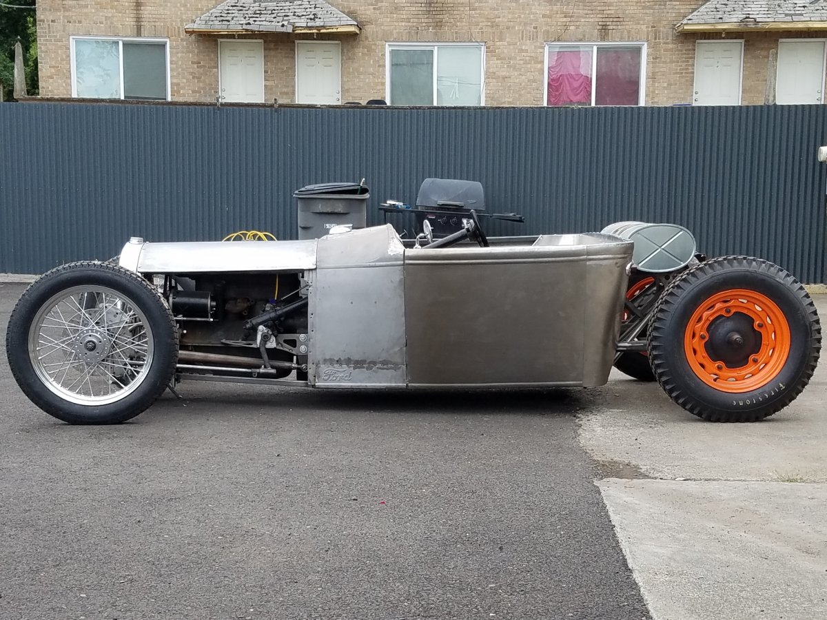

    I saw that first picture before the paper pattern and thought "he's gonna cut a big hole in the hood for the disto". And then it was there in the mock up. With some thought and balance, it could be a really different/interesting/whattheheck detail. :cool:
    Digging the outside shot... the body is just squared off and parallel at the base and the tire/wheel package is off the path but fits the car. So much forethought here. At first look I felt like it needs a turtle deck, but the exposed mechanicals really work from the back. It's going to be a car that you have to study and study and study some more as a casual viewer, if you're looking to find all the layers of detail.

    Thank Marty! Might make the blister a second piece and attach it with quarter turns so I can mess with the ignition when needed. Time will tell.

    Have you considered the idea of making the blister out of clear acrylic?

    Instead of disturbing the line of the hood, you could add an accessory drive , at the timing gear cover and shelf for a Mag or even the distributor if you don't want to use a mag..

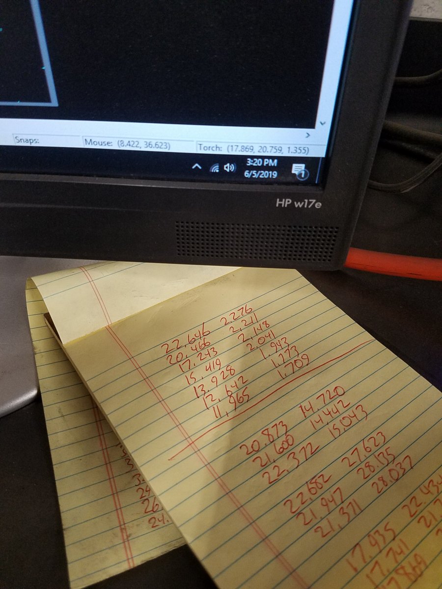

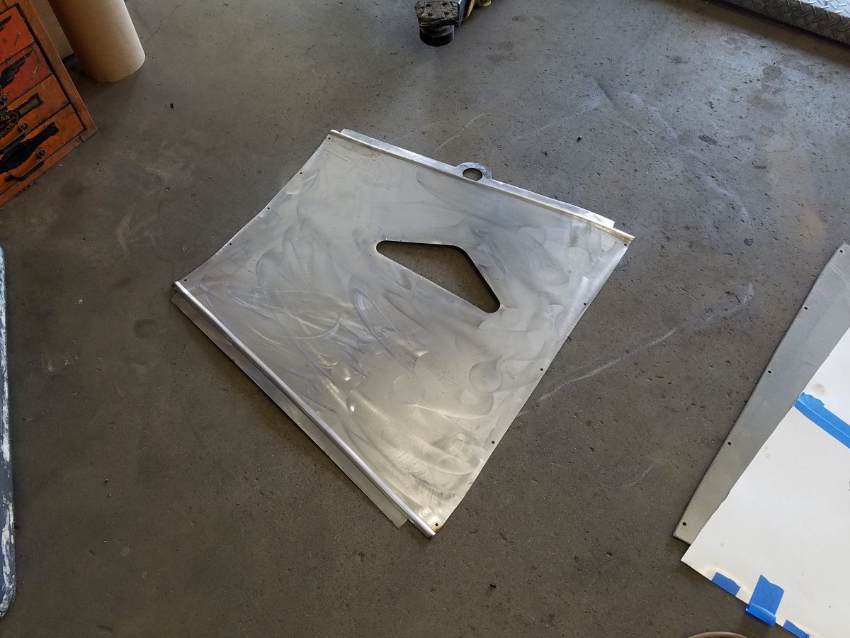

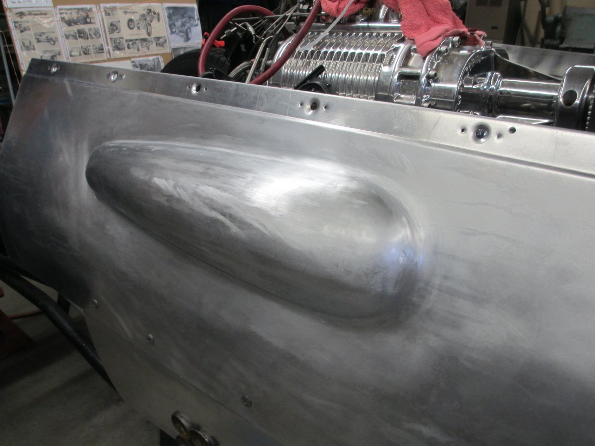

    I took the paper template and taped it down on my plasma bed. With a pointer installed i could pull coordinates from around the edge and distributor hole. After recording these I was able to draw a dxf file and cut it from 20 gauge material 20190605_152013.jpg
    After that it was just a matter of bending it over various round objects in the shop until I got proper shape. I did use the English wheel and stretcher shrinker to bell the rearward edge some to make it flow better. I then screwed it to both the cowl and the grill shell. This really stiffened up the grill shell and keeps the radiator from flopping around. 20190606_144220.jpg

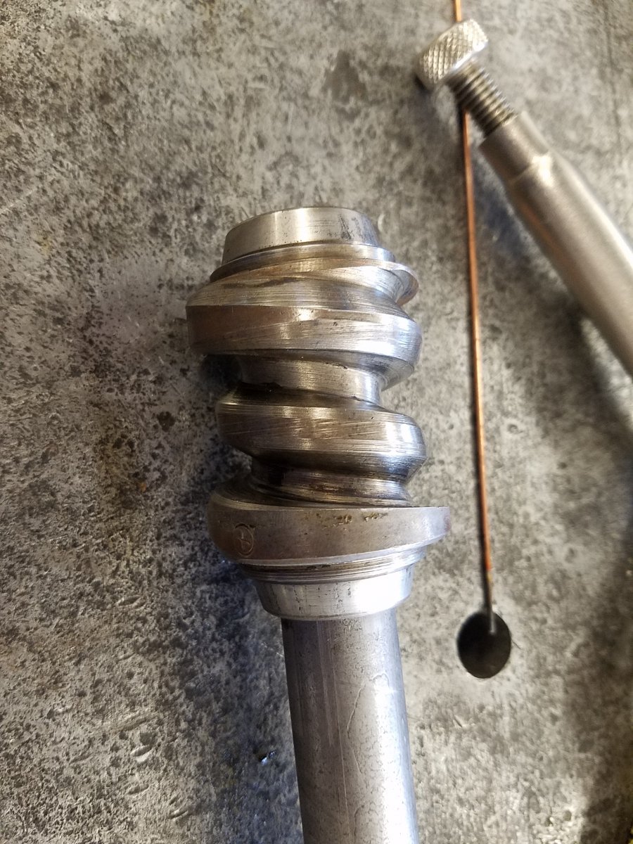

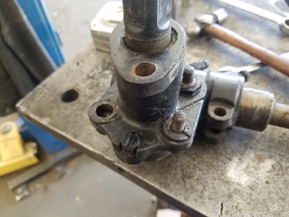

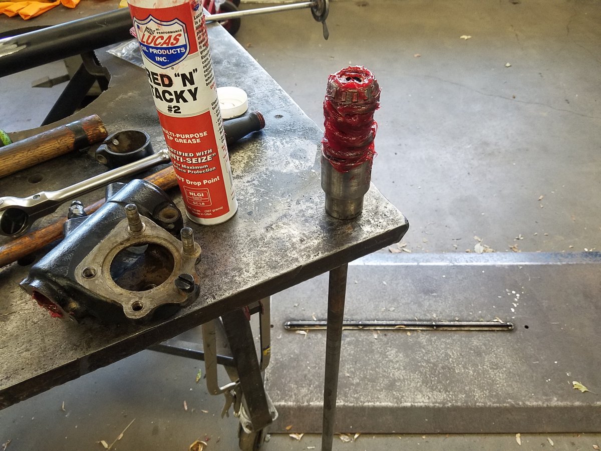

    Next up the steering column needed shortened 3 inches. Also there was a scary amount of slop in the box. Armed with a Model A manual i tore it apart. Looks like the wear is minimal but someone had been in monkeying with the adjustments, good news.... so proceeded with shortening the column and steering shaft. Changed it over to grease instead if oil, re***embled and adjusted. I'm quite happy with the result. 20190712_131818.jpg 20190712_090136.jpg 20190712_090942.jpg 20190712_125431.jpg 20190712_131241.jpg 20190712_113949.jpg 20190712_114319.jpg 20190712_125443.jpg 20190712_130631.jpg 20190716_182139.jpg

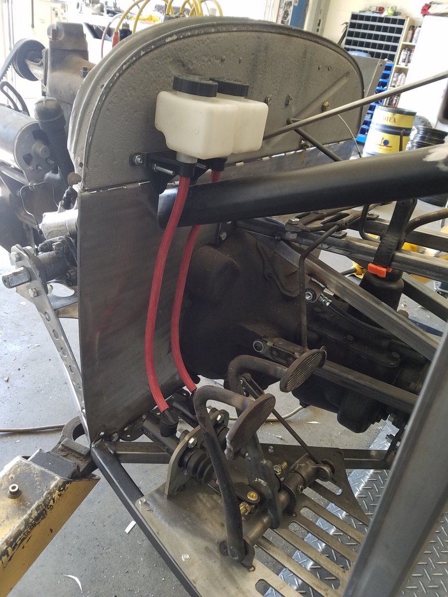

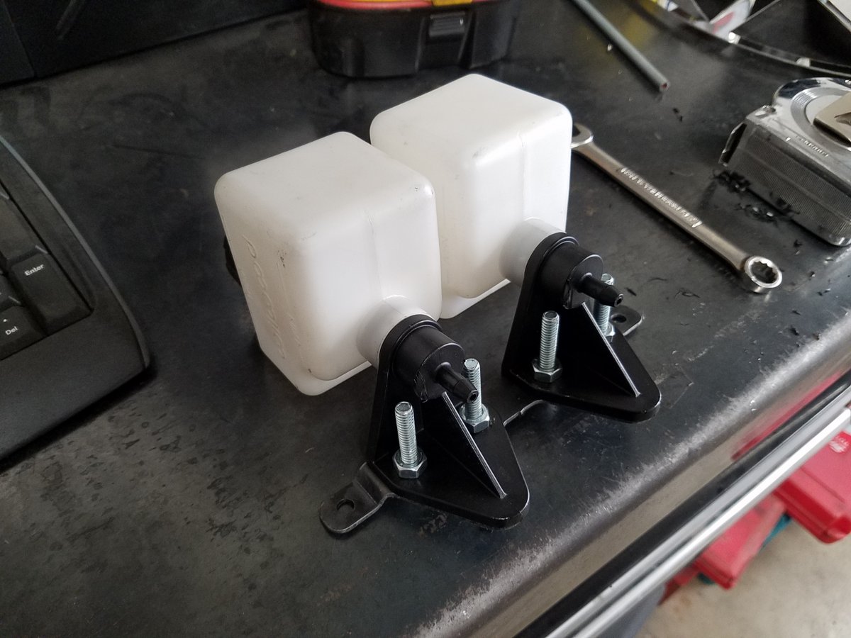

    Onto the brakes, while I have lots of big ideas for the brake reservoir, truth is I'm out of time so I'll have to come back to it. So I knocked together a bracket for the plastic remote reservoirs and mounted the high on the firewall.
    20190719_094510.jpg 20190719_095051.jpg 20190719_100032.jpg 20190723_141613.jpg 20190723_141600.jpg

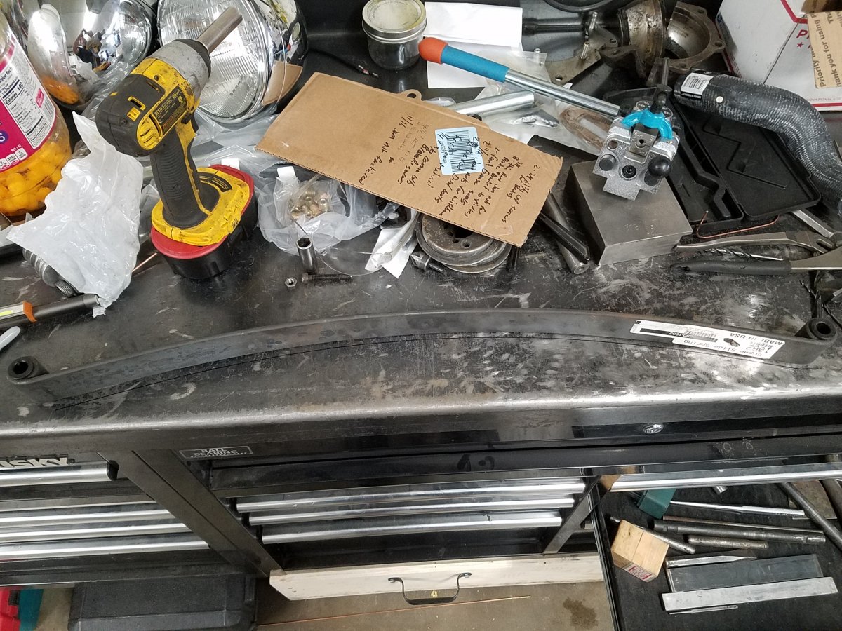

    While there is a time crunch i couldn't help but try to address the too stiff, too low ride hight problem. I had used a Posey (sp?) Model a lowering spring that I had on hand. So i took it apart, removed a couple of leafs and then un-reversed the reverse eye main leaf....ya I know.... the harbor freight ring roller does this very well.

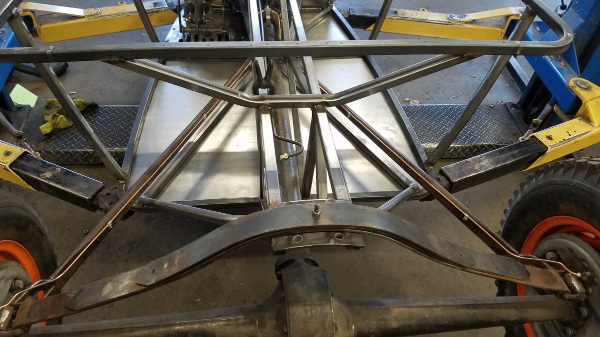

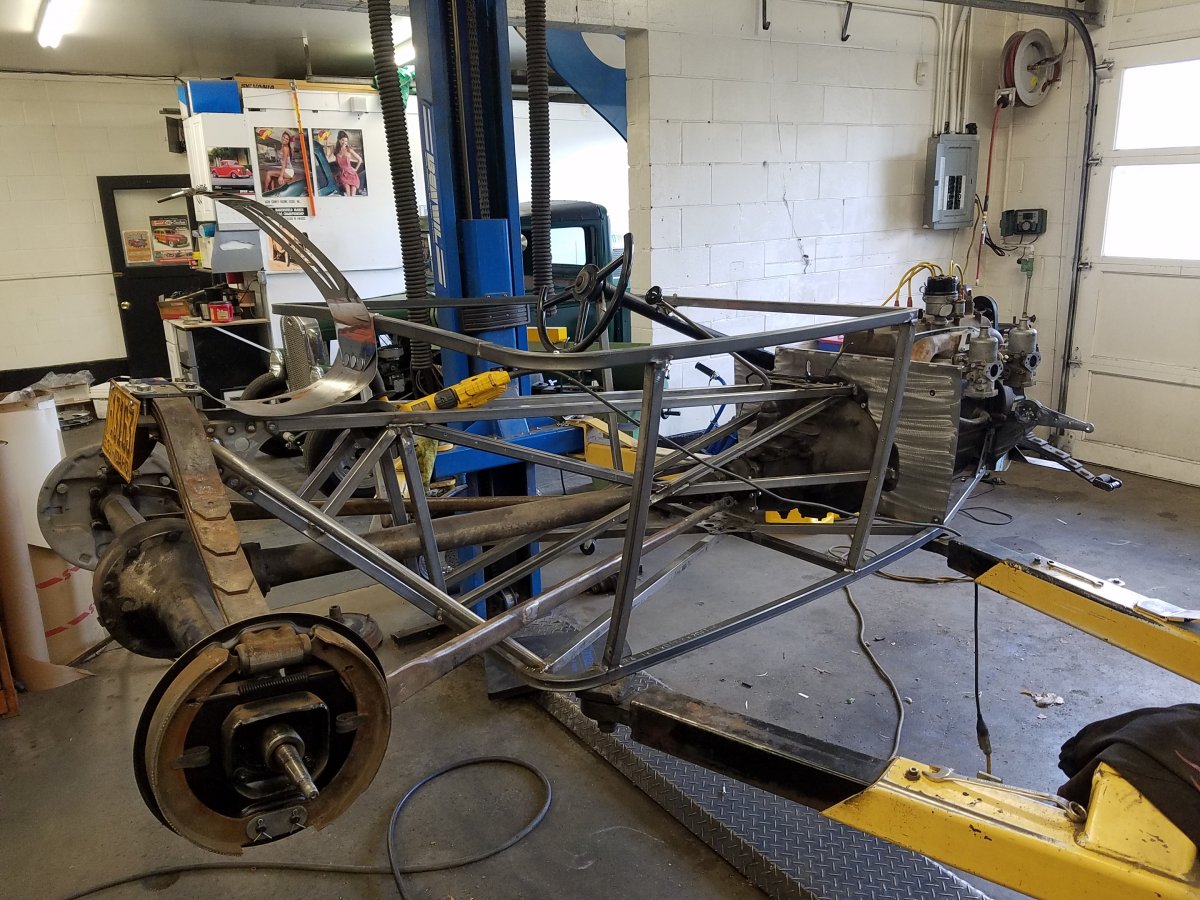

    That makes 2 of us, been a lot of corners I've had to cut so I'll be redoing a few things. I had planned on taking a few days to tig weld the ch***is together but instead I went ahead and burned it in with the mig in a couple hours, little sad about that but happy to think ill be driving it soon.

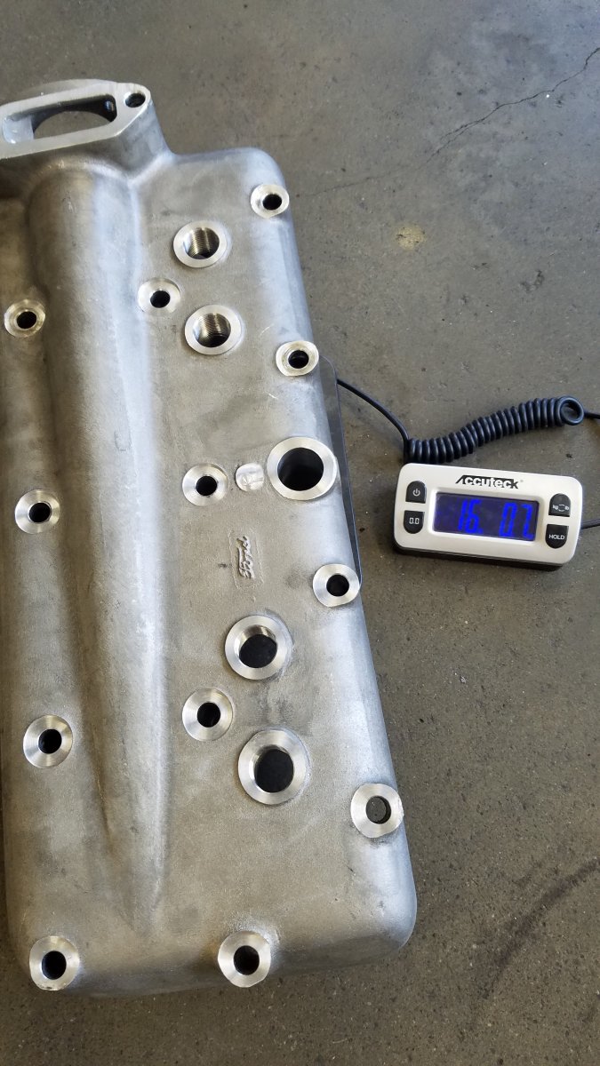

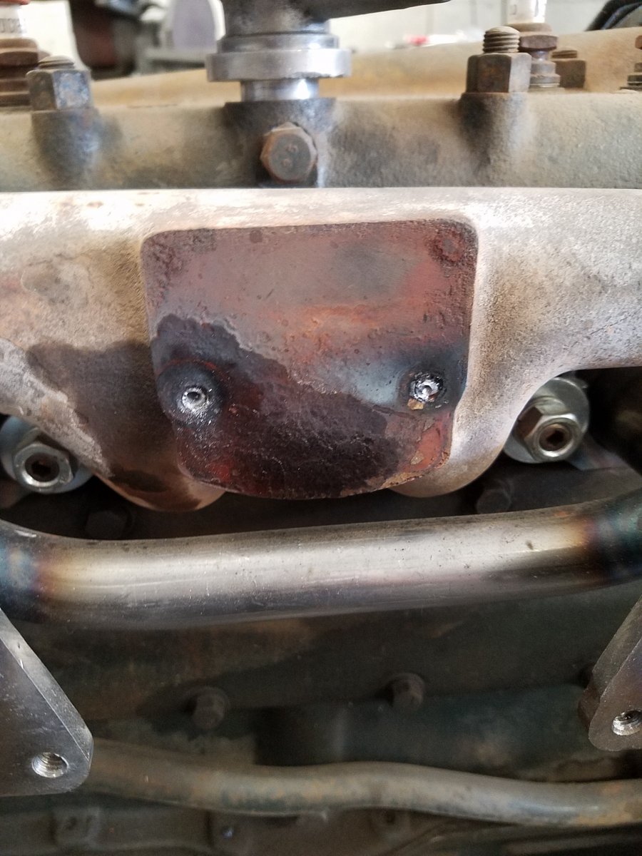

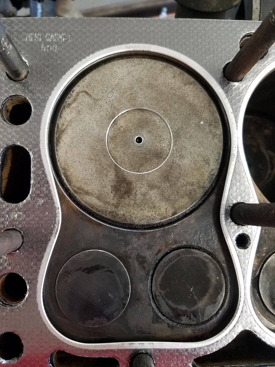

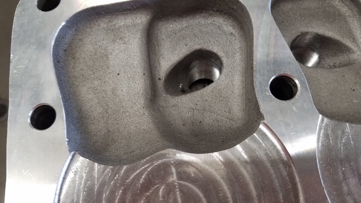

    I change the head out for one of H&H is Ricardo heads. The motor looks pretty good no wear through any crosshatch anywhere. The valve guide seem tight. Looks like a fairly fresh 80 over rebuild.

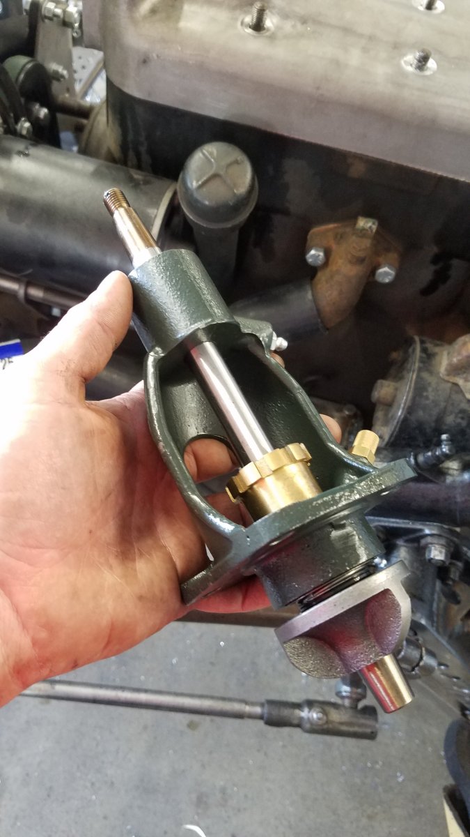

    Swapped in new leakless water pump. And got the radiator hoses sorted. 20190726_152408.jpg 20190726_152437.jpg 20190726_152924.jpg 20190726_152940.jpg 20190726_153441.jpg 20190729_170927.jpg 20190729_171011.jpg 20190729_170923.jpg

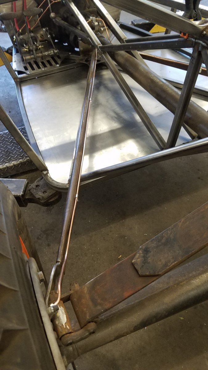

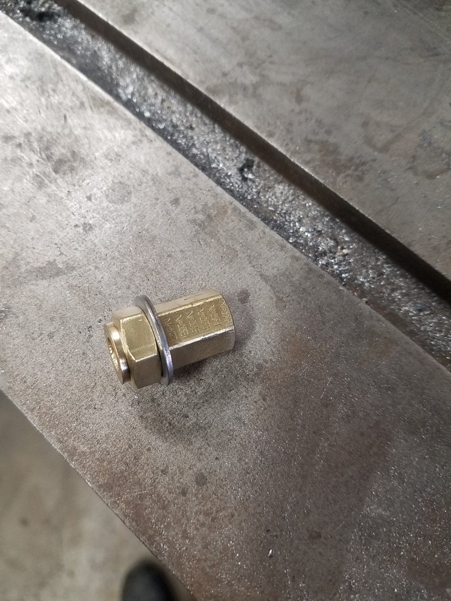

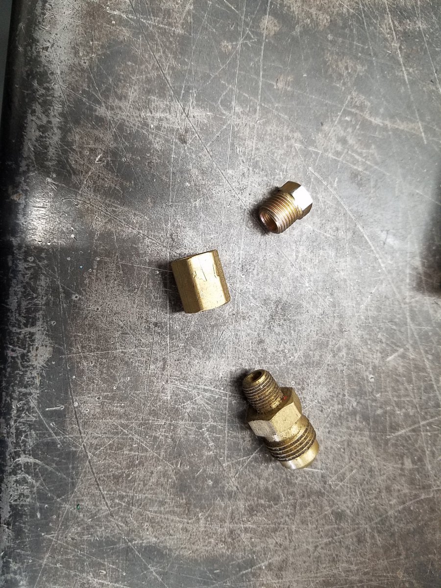

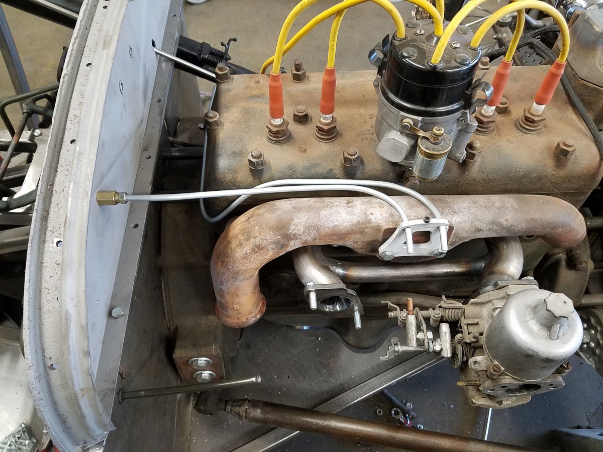

    Next up was finishing up the brake lines. 20190729_170859.jpg 20190729_170910.jpg 20190729_171019.jpg 20190729_171025.jpg

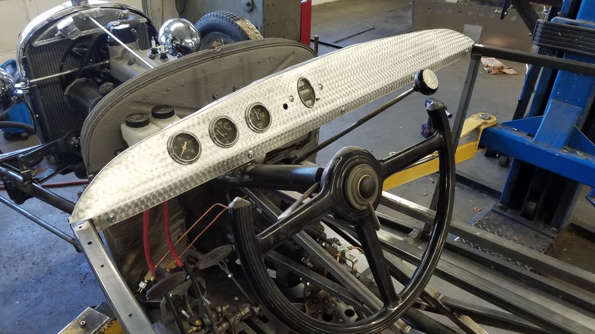

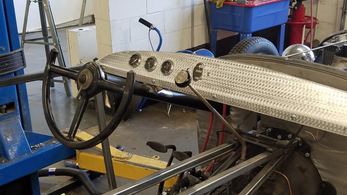

    And not that I had time but I couldn't resist putting the dash panel up on the mill and engine turning it. 20190729_153838.jpg 20190729_170939.jpg 20190729_171254.jpg
