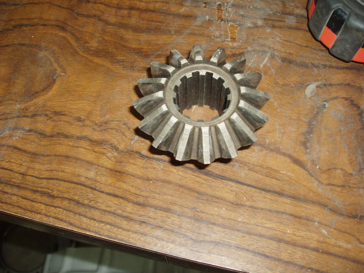

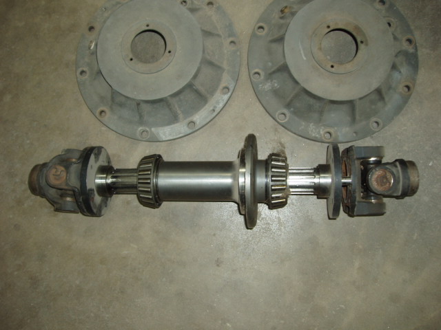

    The only updates i have is some parts I picked up from "Frames". These came off a Halibrand 201 QC. I need to get my hands on a 37-48 Ford car rear diff to use with them. Planning on re-using the ends of the model A housing as will as the current brakes and wheels. I gotta finish up another restoration before i can get going on it. Also a Mitchell sincro trans is in the plans as the "romance" of double clutching wore off pretty fast.

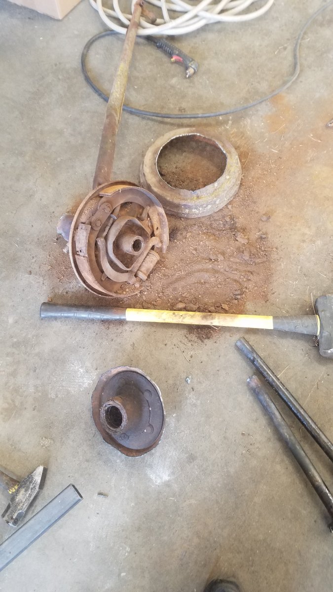

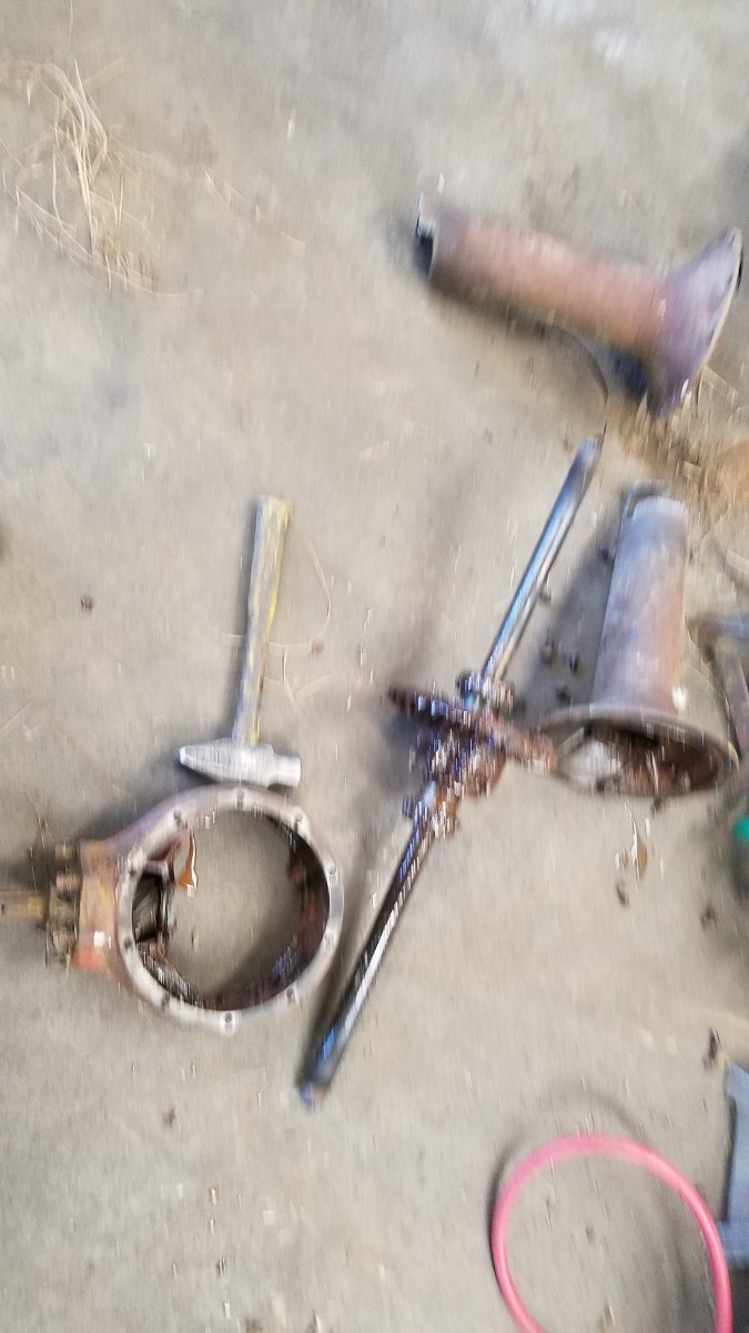

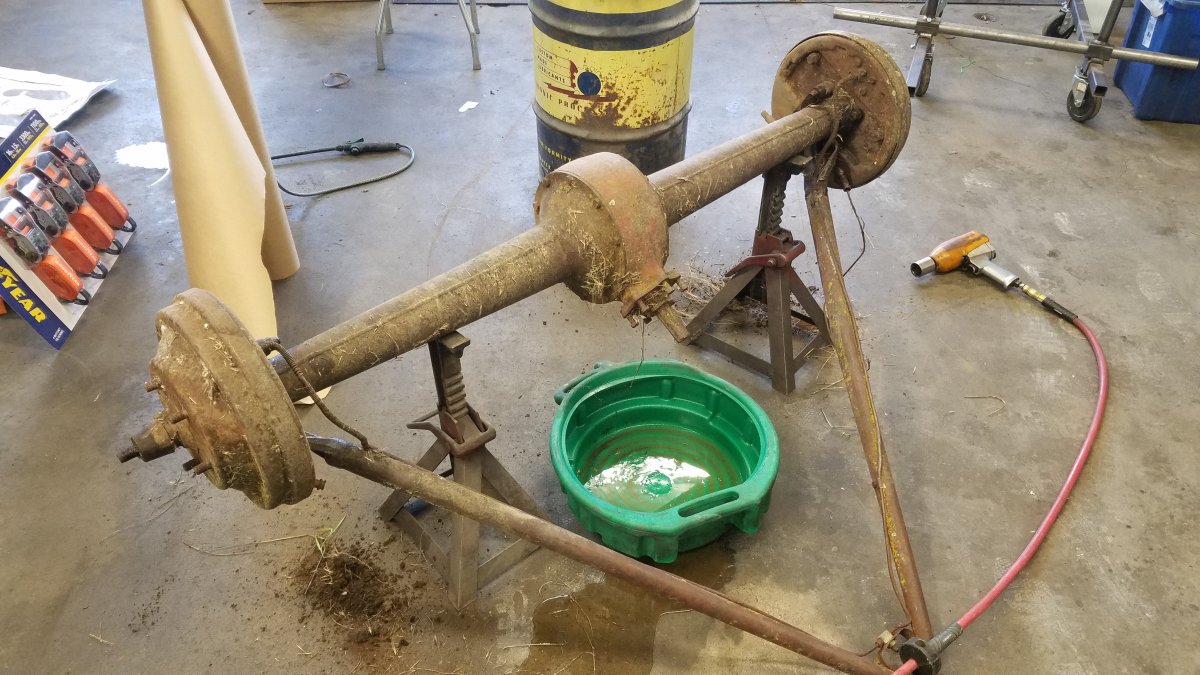

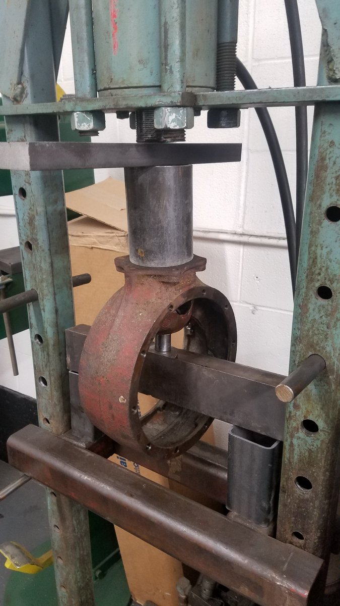

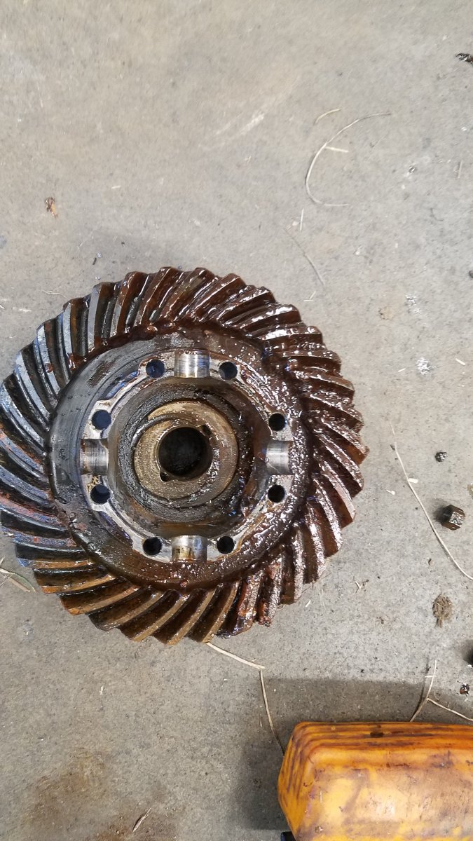

    I have been working on it a bit, my friend John gave me an 40 rearend that had been sitting out in the weather. It pretty well took every weapon I had in the shop to get it apart, but I was able to save the pieces that I actually need. I ordered a bellhousing that is an aluminum reproduction that mates a T5 to the Flathead and still uses the stock pedal ***embly. The novelty of a non synchromesh transmission wore off pretty quickly.) Another friend named Bo gave me a T5 from his Mustang which is much appreciated but seems awful heavy for the job. Anybody know of a full synchromesh Lightweight transmission that might be a good subs***ute? This would be the easy route. But I'm not sure It's exactly what I want. The pictures are obviously out of order Oh, but you get the idea. I ordered a new set of ring and pinion that are 3.54 gear set vrs the 4.11 i had along with the overdrive should make the drive to www.hotrodarama.us at the end of july much more do-able.

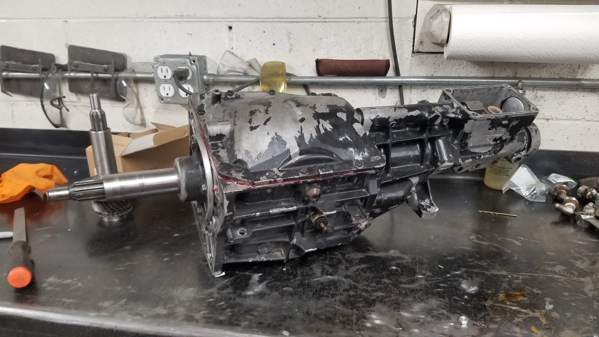

    Are you saying the Mustang T5 is too heavy "weight" wise or too beefy "strength" wise? I have a few T5s and they all weigh about the same amount.
    If you could scrounge up a T4, it might be a bit lighter. I've never bothered to weigh one, but I can pick up the T5 I'm running in my car with one hand if I can get a good grip on it. It's a NWC S10 version. (not saying it's easy to do one-handed, but it's lighter than a cast iron bodied trans.)

    It's a bit of both just large overall and fairly heavy compared to the 3-speed model A that came out of it. We're only dealing with maybe 50 horsepower this T5 trans came out of a 5.0 Mustang which probably had at least double the horsepower we don't need much and I'm probably splitting straws but thats a bit of what the whole car is about.

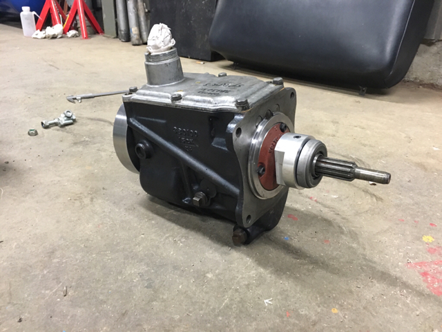

    I picked up a BW T50 (Chevy Monza et al), to attach to a V8-60 some day (Future Project No. 14). Five speed OD, normal GM bolt pattern, compact, and quite handsome (see picture). However, the shifter is set back quite a bit; I plan on fabricating a shifter ***embly to mount further forward, connecting through a rod with slots machined on each end (like a clevis), to the cut-down standard lever. Of course, this transmission is for open drive shaft; I'm ***uming your QC will be compatible.
    And of course there are dozens of foriegn units that should work. I'm not that knowledgable on late model stuff, but I think I'd look into Miata, and maybe Volvo, and Toyota/Nissan (including light pick-ups).
