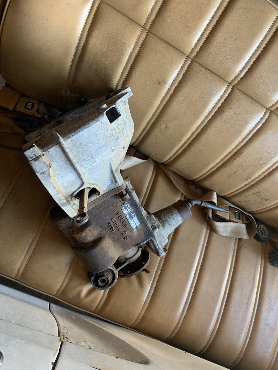

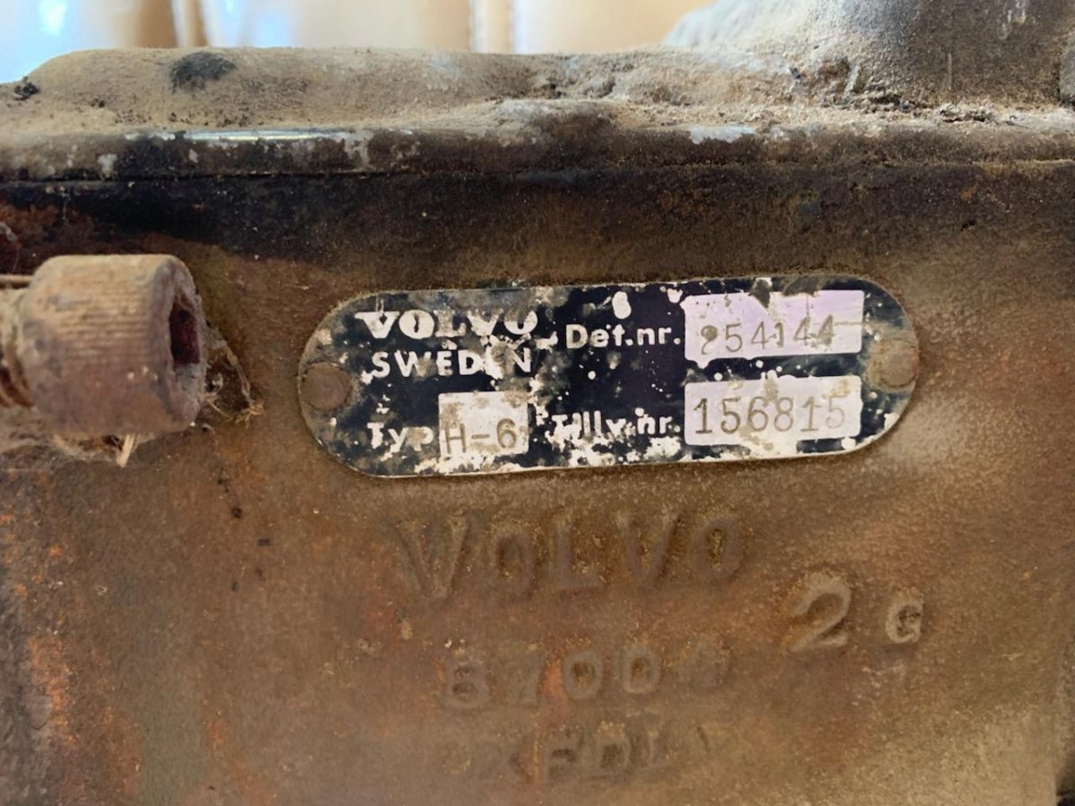

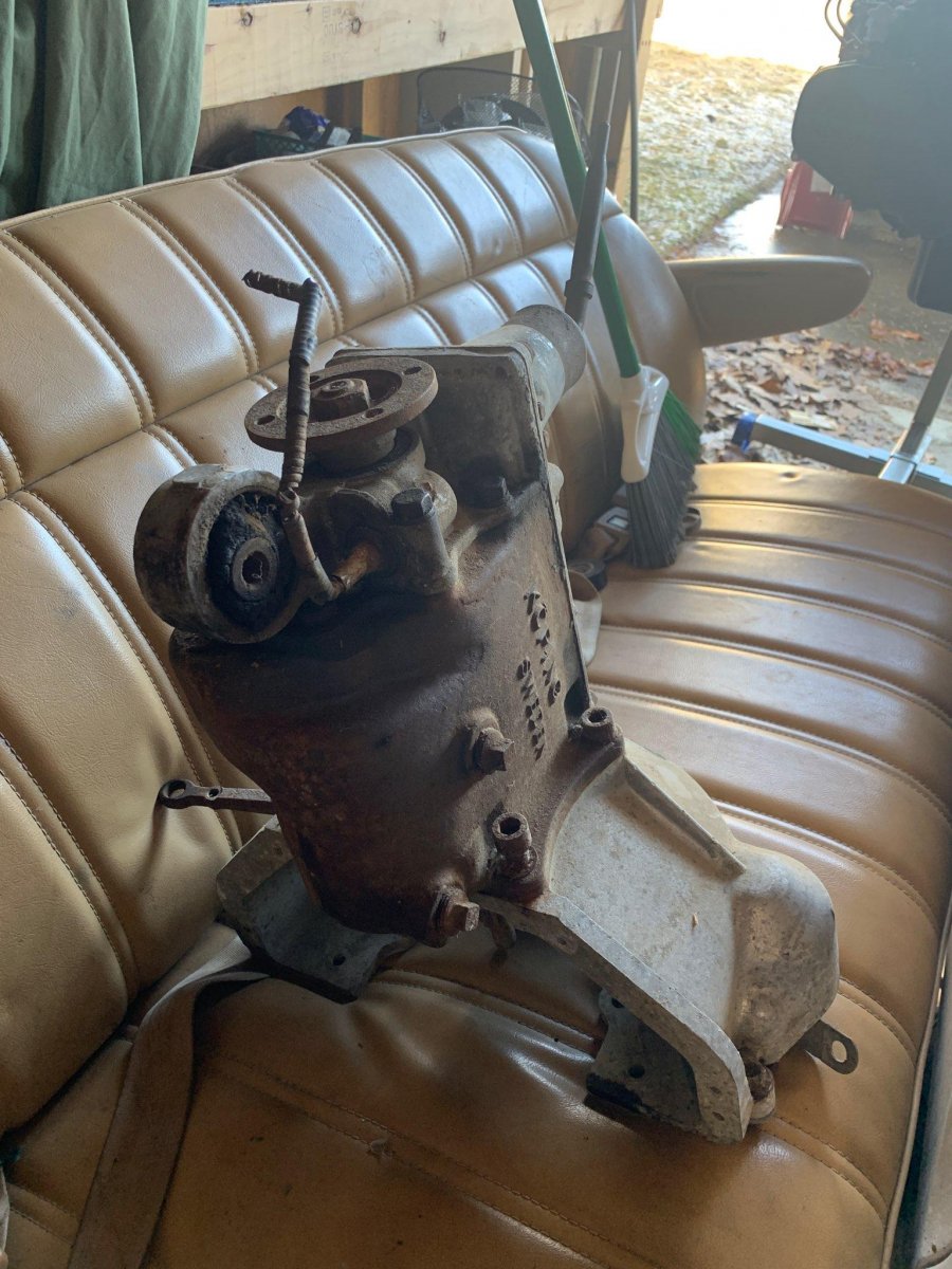

    I put an ad in the Spokane Craigslist and a Gentleman Just sent me pictures of this 603569363.jpg 603569391.jpg 603569415.jpg Volvo transmission, I'm thinking it's not the right one but I don't know what it is. Any Volvo experts on here?

    ... def' looks old AF huh' ? Can he give you a better picture of the tag .. for the cheat codes we obviously need ? :)
    @volvobrynk line 2 please.

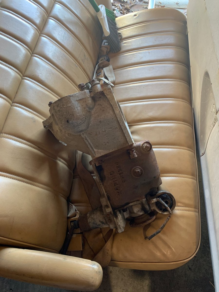

    kidcampbell71 likes this.

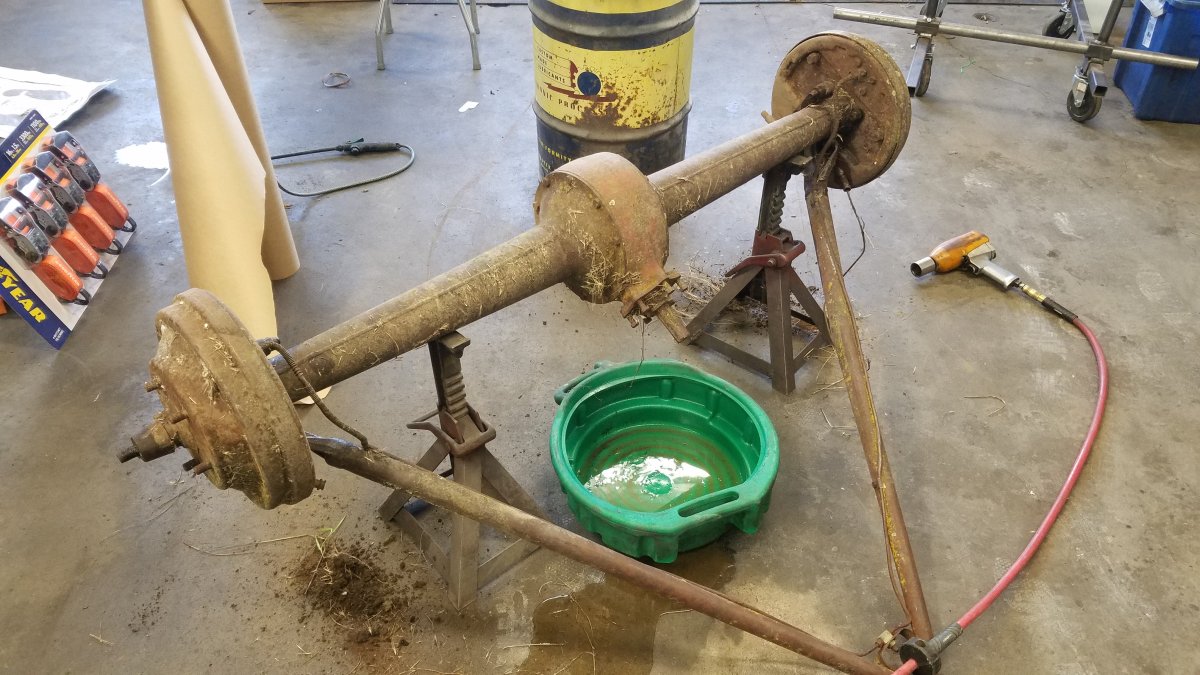

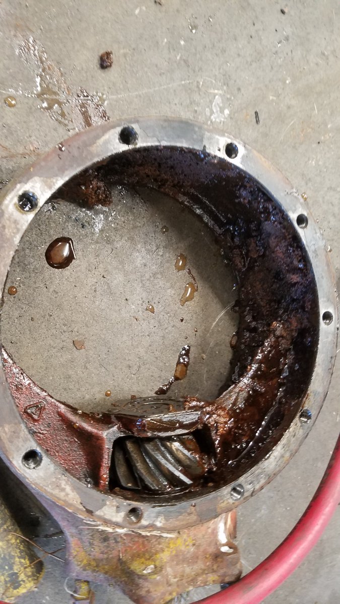

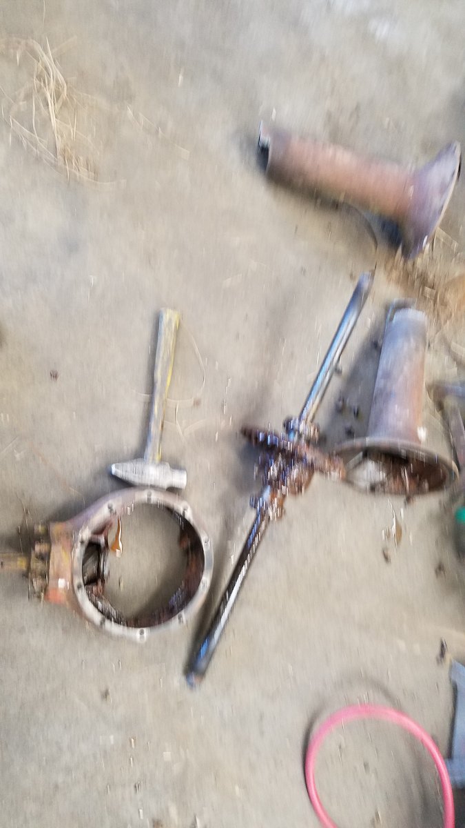

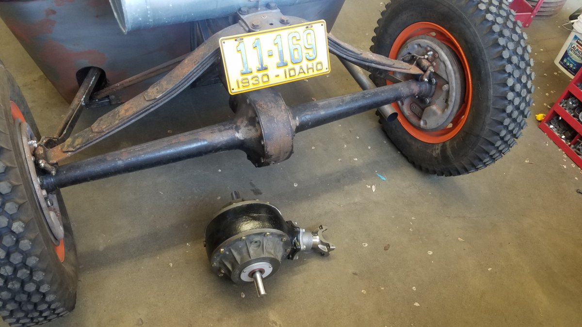

    A good friend of mine John Ulhorn gave me a 40's rearend that had been sitting in his pasture for God knows how many years and I got to tearing it apart. The brake shoes were frozen to the drums proved to be quite a workout, ending in butchery with the gas axe.
    The rear end has obviously sat with water in it for years and years but amazingly enough the parts I needed for this project were okay.

  13. 97
    Joined: May 18, 2005
    Posts: 1,983
    97
    two good period correct axle stands there
    Thor1 likes this.
  14. 1-SHOT
    Joined: Sep 23, 2014
    Posts: 2,919
    1-SHOT
    from Denton
    I have several pairs some short some tall, but they still work good for me
    Thor1 likes this.

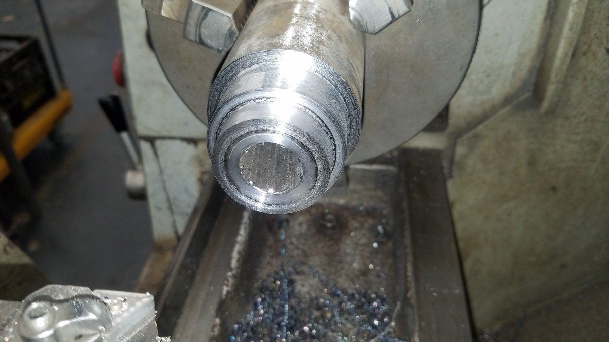

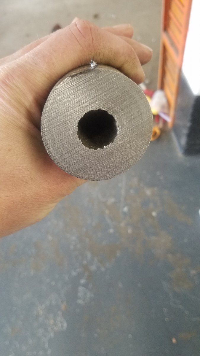

    I decided to go a different direction than the included U-joints as they required some odd machine work to make the 3/4 ton spider gears work in the model A housing. At first I was going to make some tapered hubs similar to what you would find on the end of the axle to connect to. I got most of the machine work done and was trying to figure out how I was going to cut a keyway in the outside taper at an angle, after some head scratching I decided it was mostly above my paygrade. 20200331_093602.jpg
    So I begged Another axle from a friend and ordered up some split tapered tubs like would be used in industrial air compressors. This way I only had to machine a keyway on the axle. Machined the axle down to 1 1/8 in, leaving enough material so hubs had to be lapped on for the final fit.

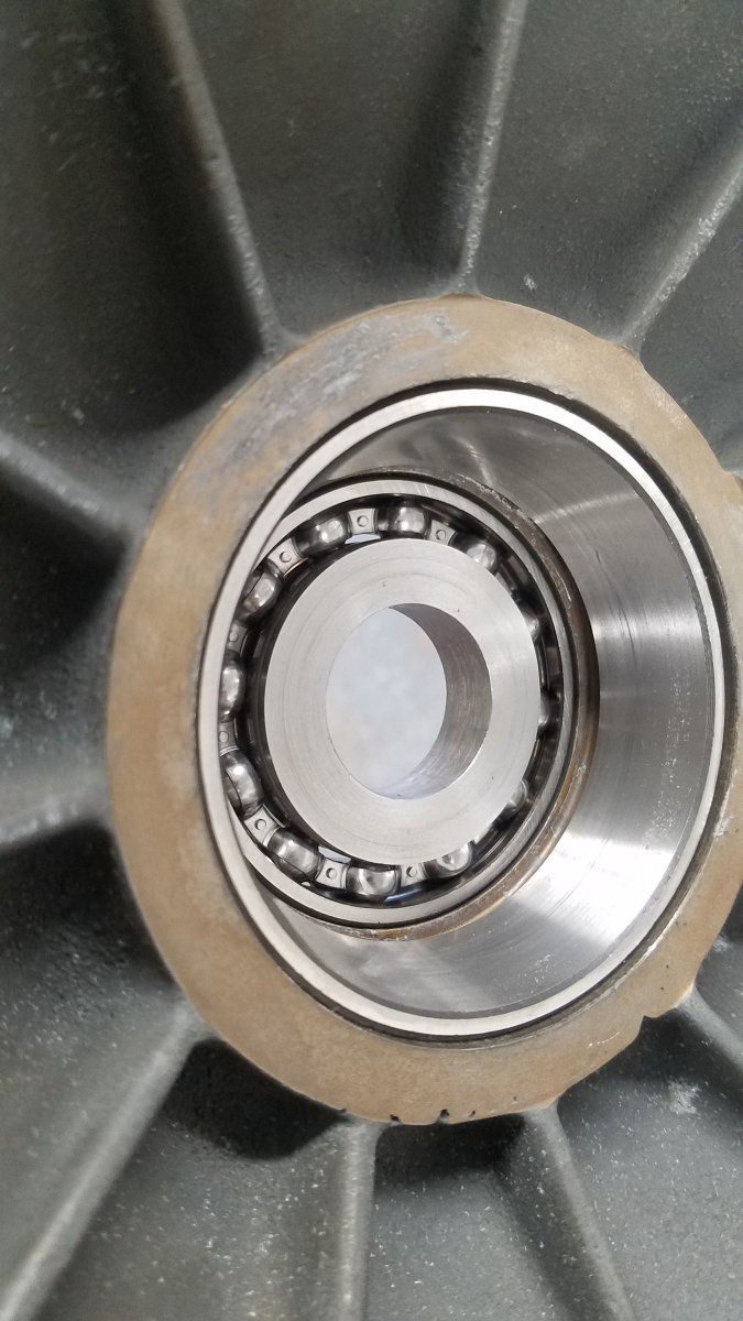

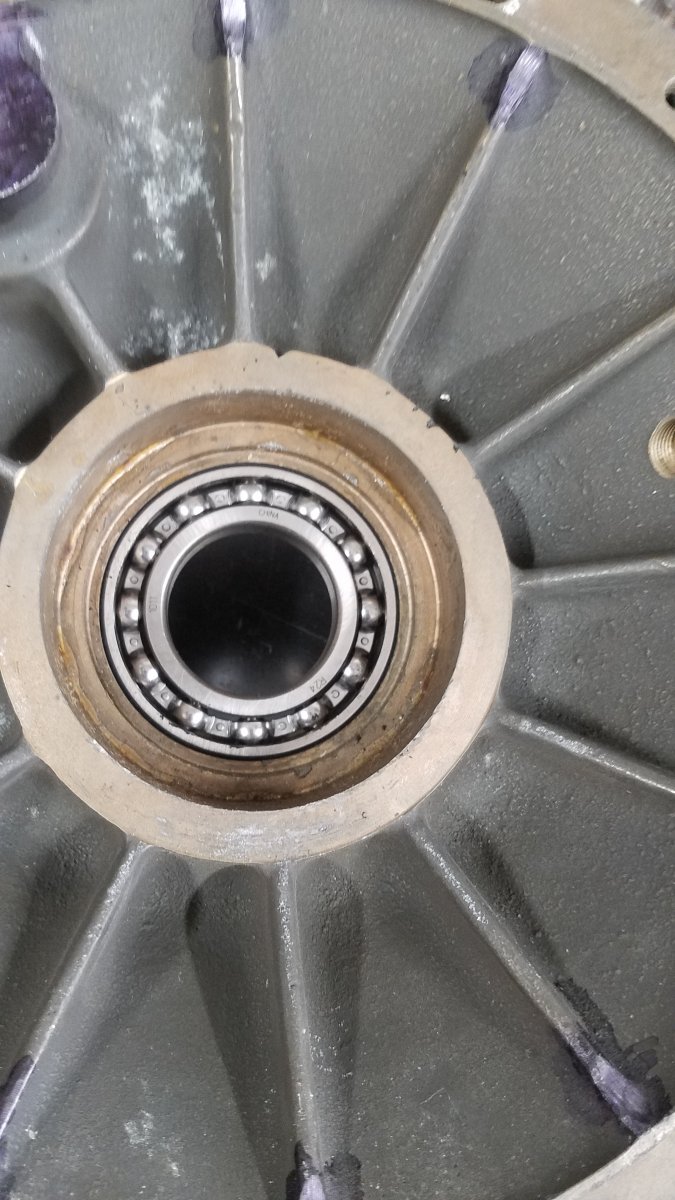

    Next up I needed some support for where the axles exits the Magnesium Bells, I sourced bearings that pressed into the Bells but much too large for the axle itself.
    To make up the slack required a machine bushing from a vintage cannon barrel....

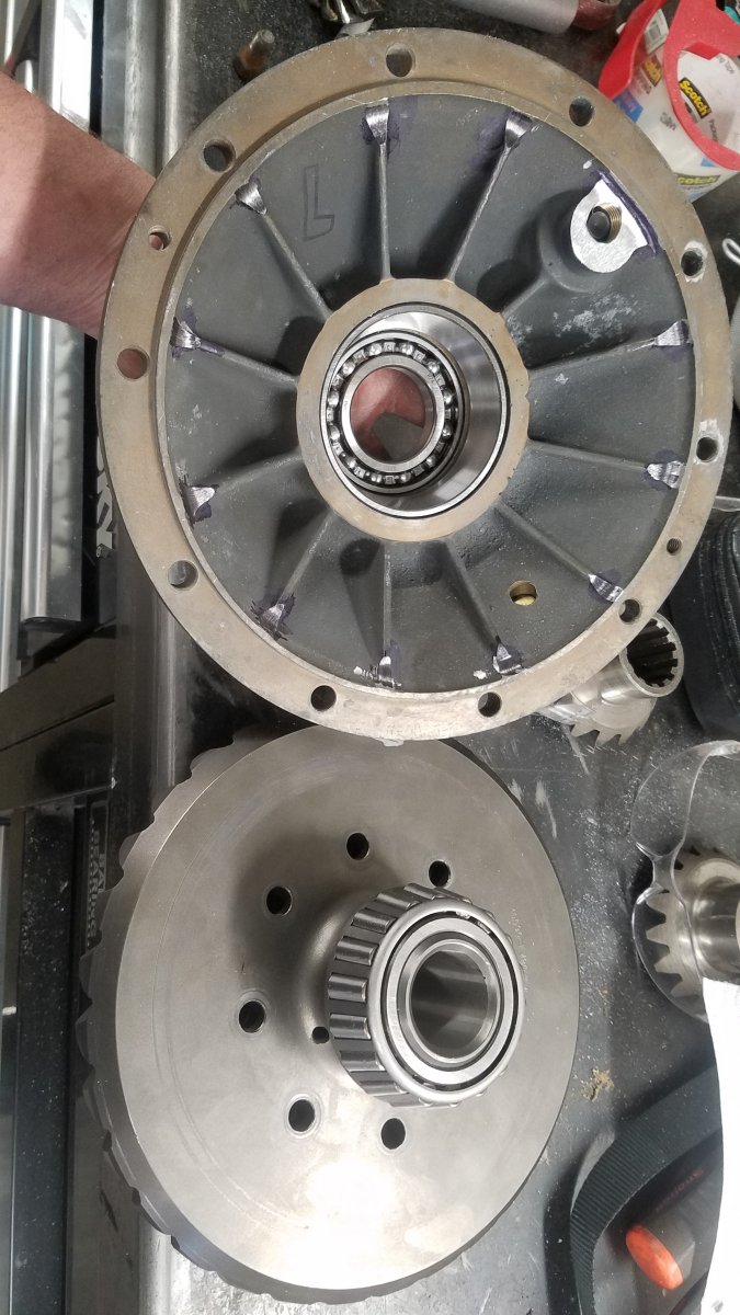

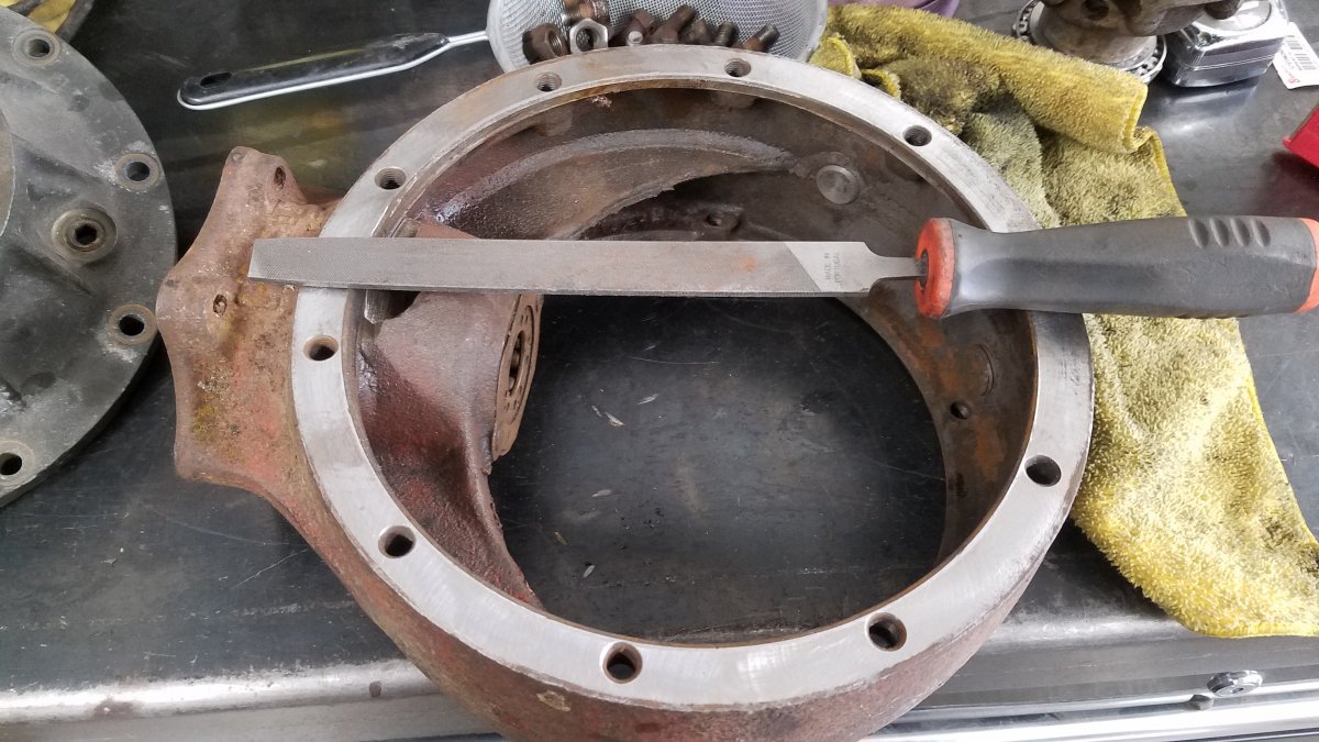

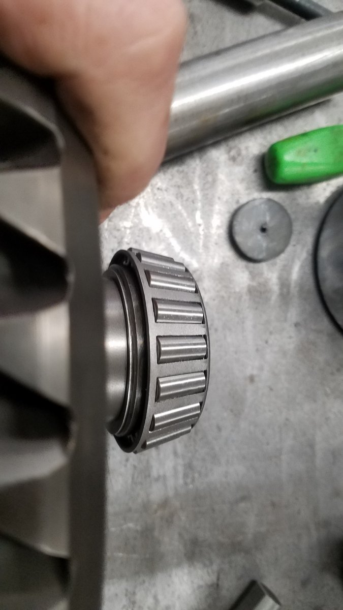

    I picked up a 3.54 ratio gear set from Speedy bill, I found after installing the new side bearings that the back of the gear was rubbing on the side bell. I used magic marker to locate whereit was rubbing and ground it out with my finger sander. 20200416_150824.jpg 20200416_100257.jpg 20200416_152352.jpg 20200416_144242.jpg
    Thor1, alchemy, Nostrebor and 4 others like this.

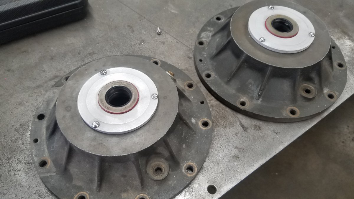

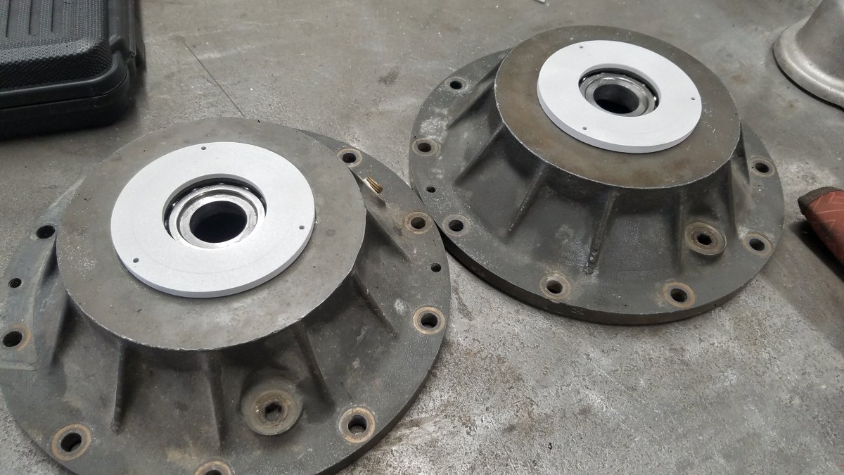

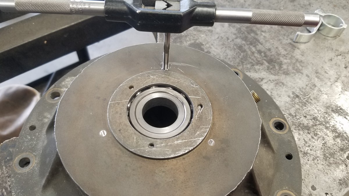

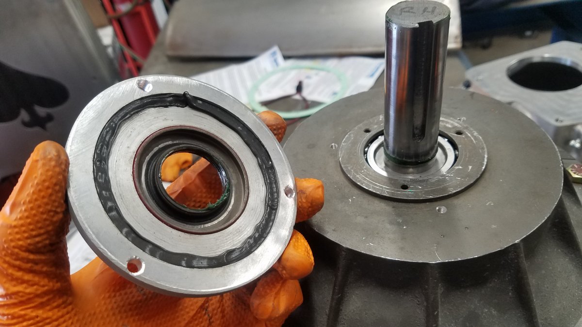

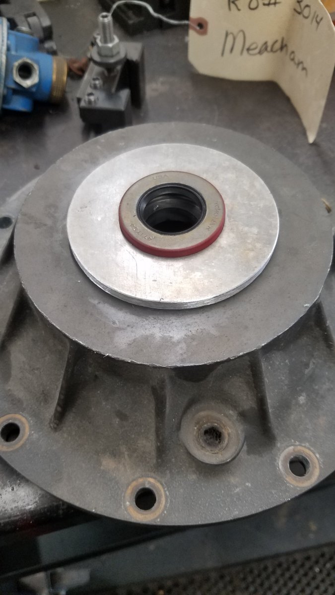

    Next up was spinning up some aluminum plates to house the output shaft seals 20200430_094519.jpg 20200430_095542.jpg 20200430_103921.jpg 20200430_142451.jpg 20200430_110947.jpg 20200430_143811.jpg 20200430_144133.jpg 20200430_143811.jpg
    Stogy, anthony myrick, Thor1 and 11 others like this.

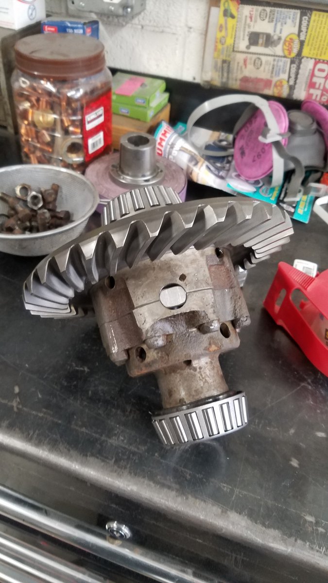

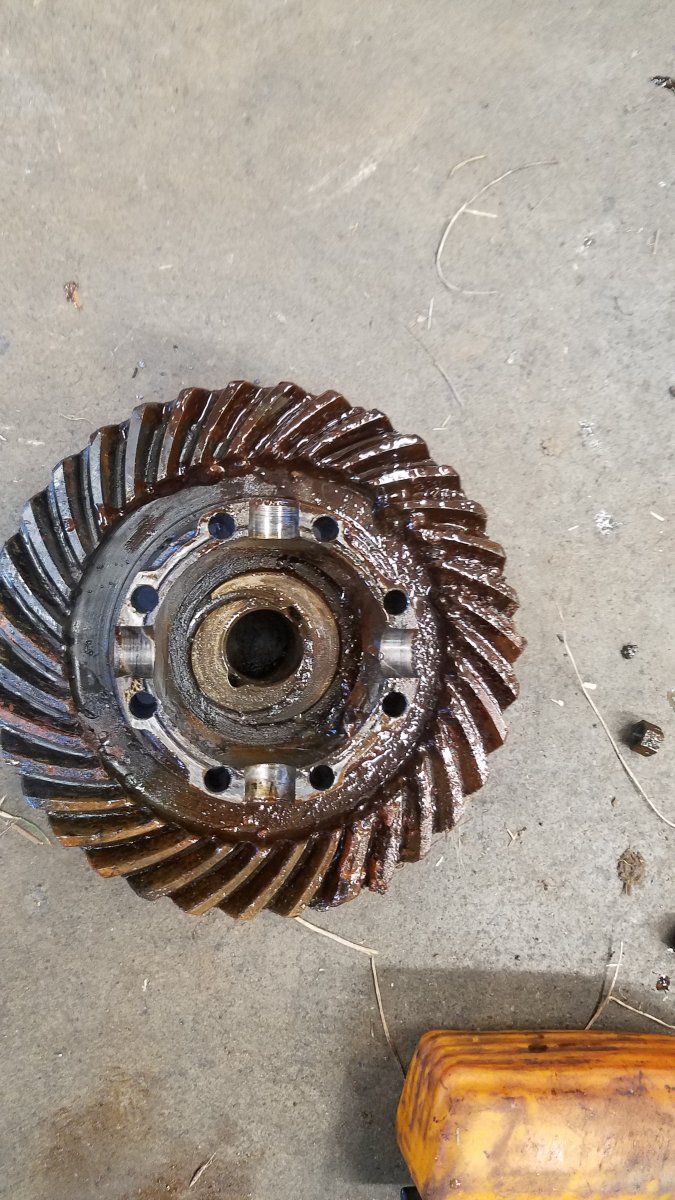

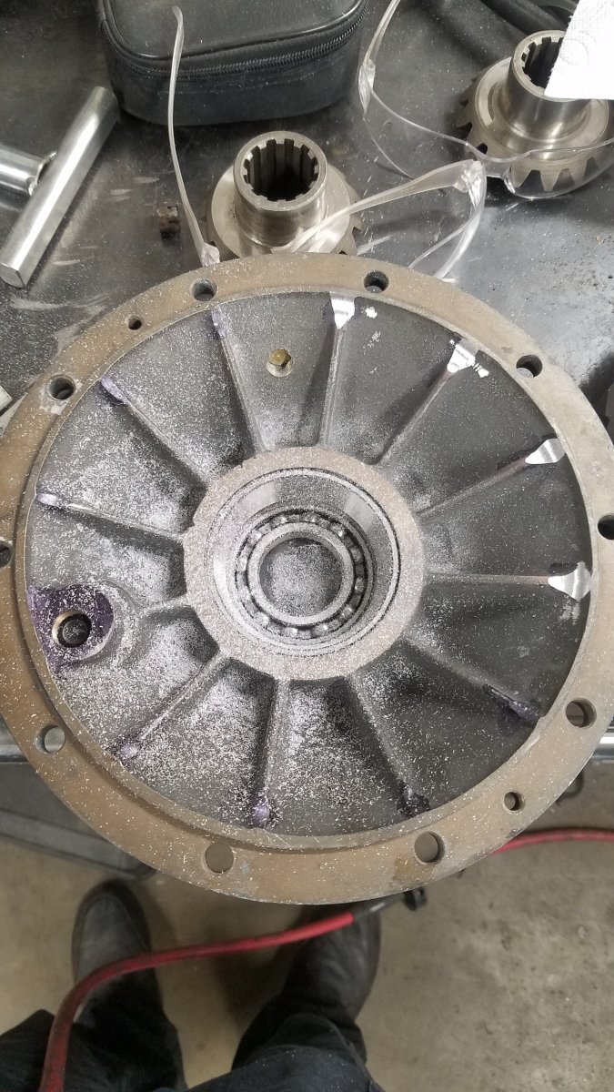

    With the fab work done it was time to start setting it up, I've rebuilt a ton of conventional differentials but this is a whole nother bird. Digging through websites I kind of got the gist of how go about it. First step was building a tool to turn the carrier through the side plates. I used a piece of 3/4 d steering shaft and an old Chinese spark plug socket. This tool goes in place of spider gear ***embly during setup allowing you to check the rotational torque of the carrier bearings. 20200416_095309.jpg 20200416_100257.jpg

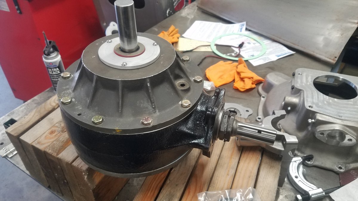

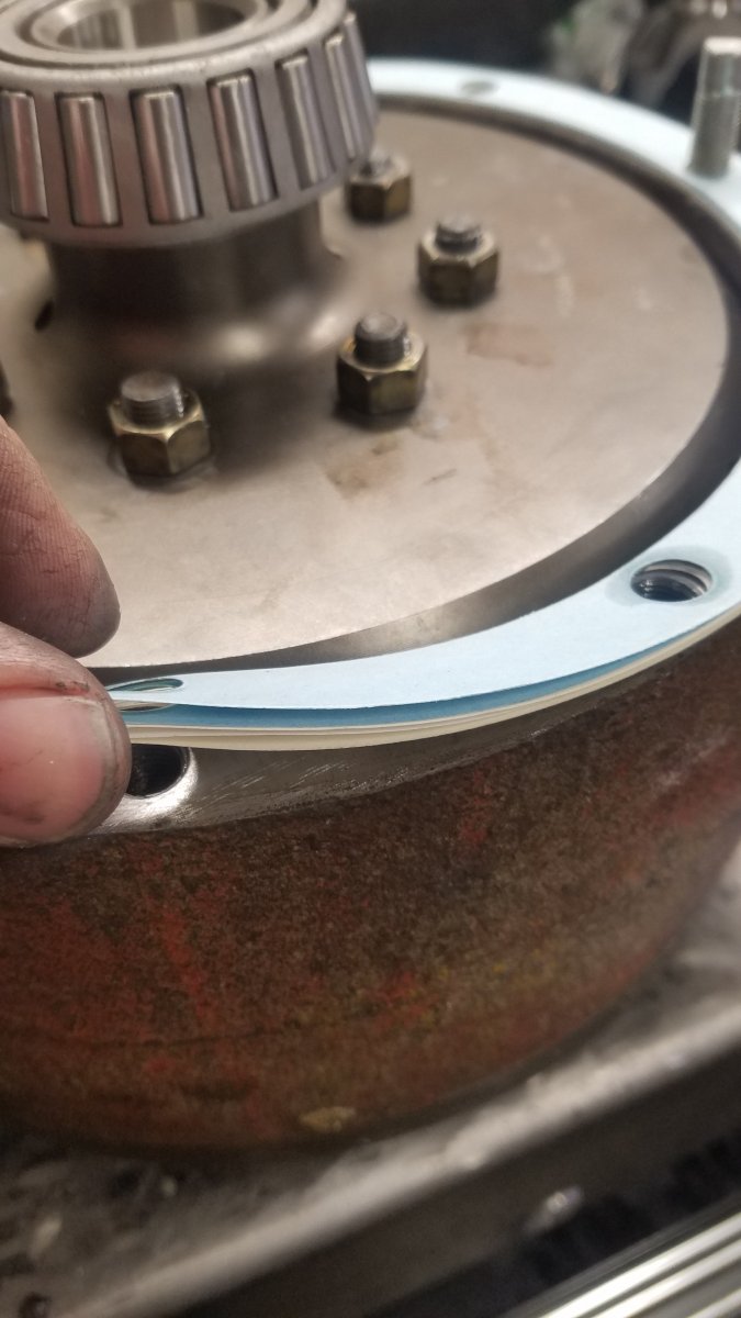

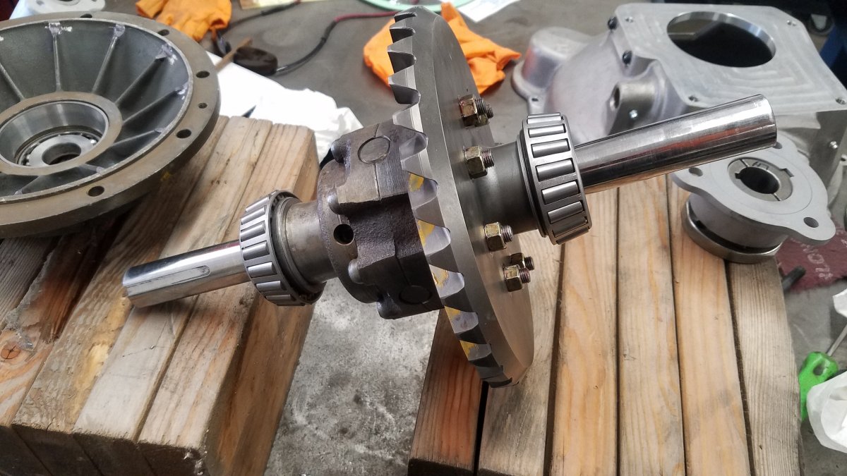

    On the first try of ***embly I found that without any gaskets on the side plates I had a little more than .080" slop, so I made a puller to pull the carrier bearings and added in shims under them to space the bearings out. It took some trial and error but eventually I got it set to where I had a fair amount of side cover gaskets needed to get the correct rotational torque . This allows for backlash adjustment by moving gaskets from one side to the other. 20200506_141240.jpg 20200507_135237.jpg 20200506_095126.jpg
    Stogy, Thor1, fiftyv8 and 5 others like this.

    I used the open drive conversion yoke as an ***embly fixture to set the pinion bearing preload to 20 inch pounds (yeah I know continuity problem)
    After pressing in the pinion i rechecked the rotational torque and verified 20 inch pounds.

    After some trial and error have moving the gasket side-to-side I got a backlash that I was happy with and a gear pattern that is acceptable. Next I installed the stub shafts and spider gears then installed the seal housings with a bit of ultra black sealant. Then the housing was off for a couple glamor shots. 20200506_162952.jpg
    20200507_102334.jpg 20200507_103331.jpg 20200507_132708.jpg 20200507_134215.jpg 20200507_134203.jpg
    Bonneville was pretty hard on the car as I had taken so much time off the shop in oreder get it ready to go last year that when I got back I had to dive into work and it just got put away. The car will be coming apart completely for paint and re***embly. 20200424_085244.jpg 20200424_085919.jpg 20200424_103103.jpg

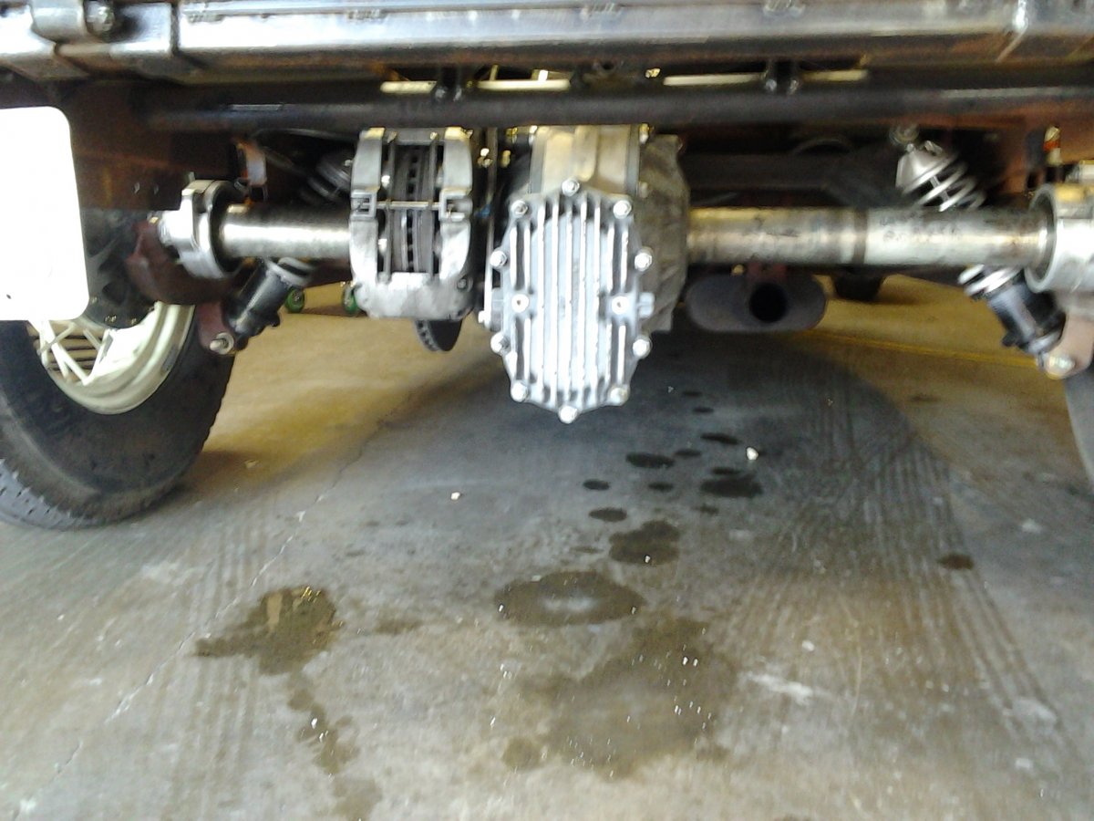

    I saw this diff setup on the internet.
    Is this what you plan to do or are you building an IRS??? 95791242_10218202193980295_8342777069704314880_o.jpg
    Thor1 likes this.

    Thats a 3 inch open tube rear end ,with disc brake for a sprint car, no differential just a one piece tube.
    Thor1 and fiftyv8 like this.

    I'm doing an IRS, the unsprung weight ratio is ****ing horrendous, drives great on smooth pavement but if you hit a bump it shoves your kidneys out through your ears.

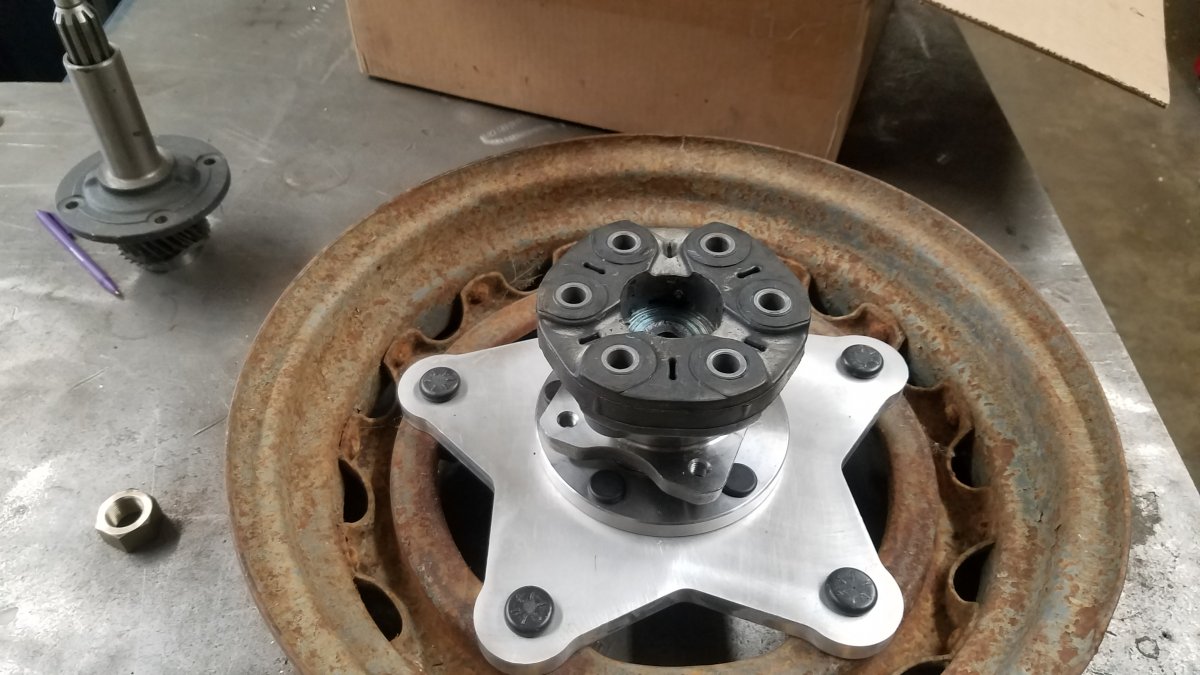

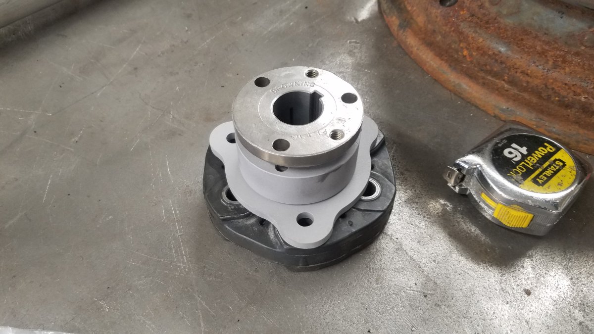

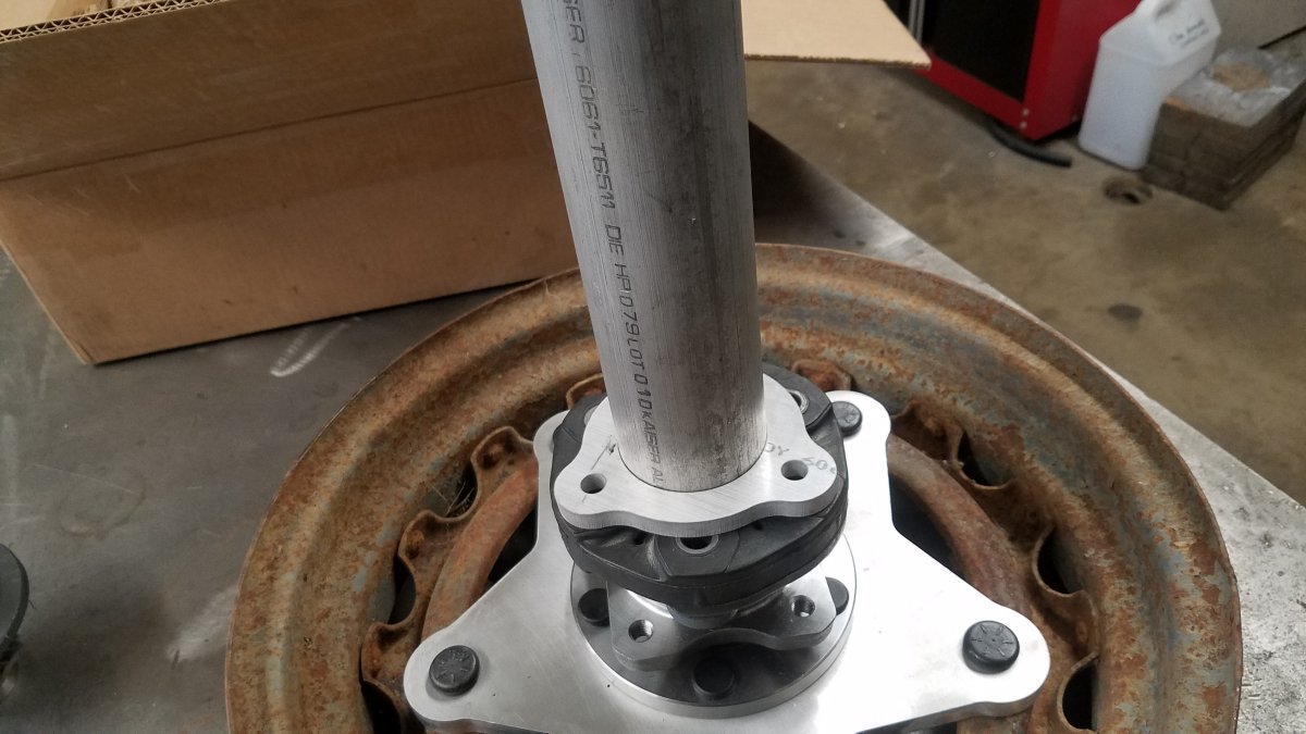

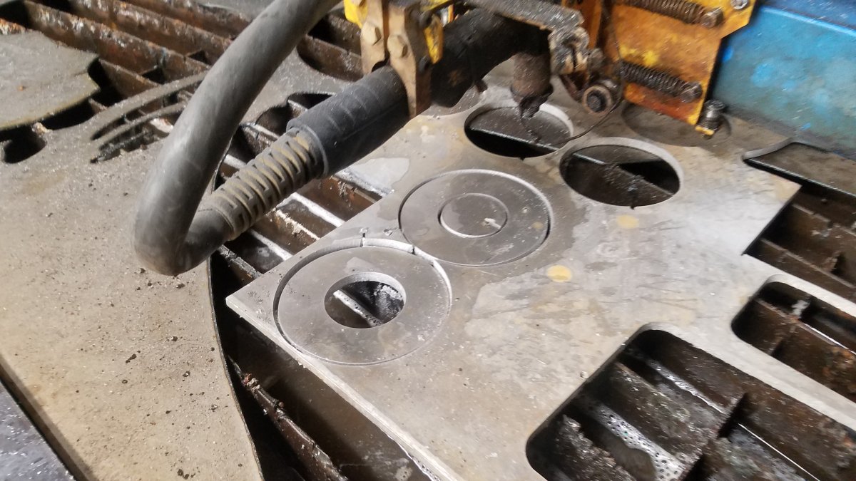

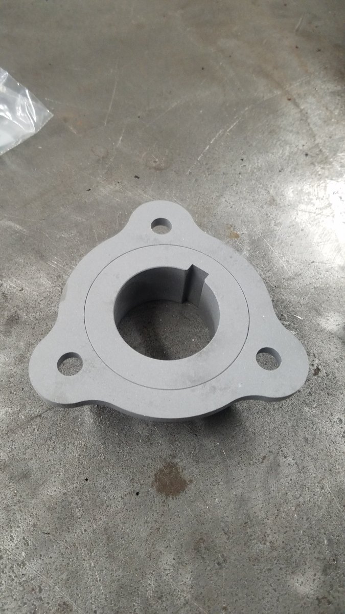

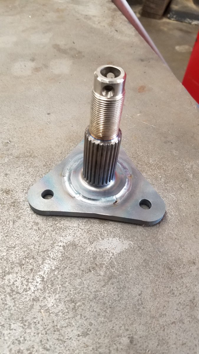

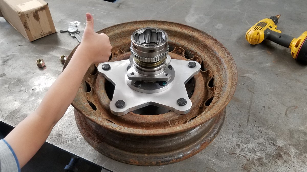

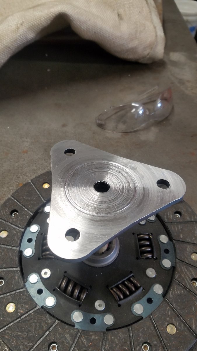

    It will have to be our little secret but in conjunction with a Sprint car adapter plate I'm using Dodge Caravan front wheel drive parts............:eek: oh and the kids are hanging out at the shop since the schools have been shut.

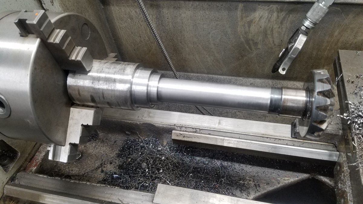

    I drew up some flanges and had our local water jet Guy cut them
    Trimmed and squared up on the lathe just the spline section of the CV axle. Then pressed on the flange and tig welded them together. Using euro parts too:oops: for the joint. Then sourced some 2.5" 6061 T6 for the half shafts.
    Here is the split taper hubs and the waterjet flanges for the inner portion of the half shafts.
    Stogy, El Hueso, brEad and 6 others like this.
