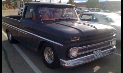

    What did you paint that with? Looks like the perfect matte / suede.

    I'm pretty sure markeb01 used john deere, blitz black on his truck.

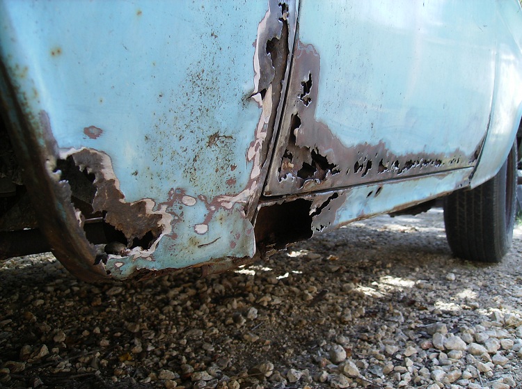

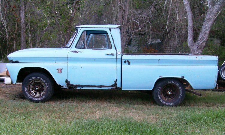

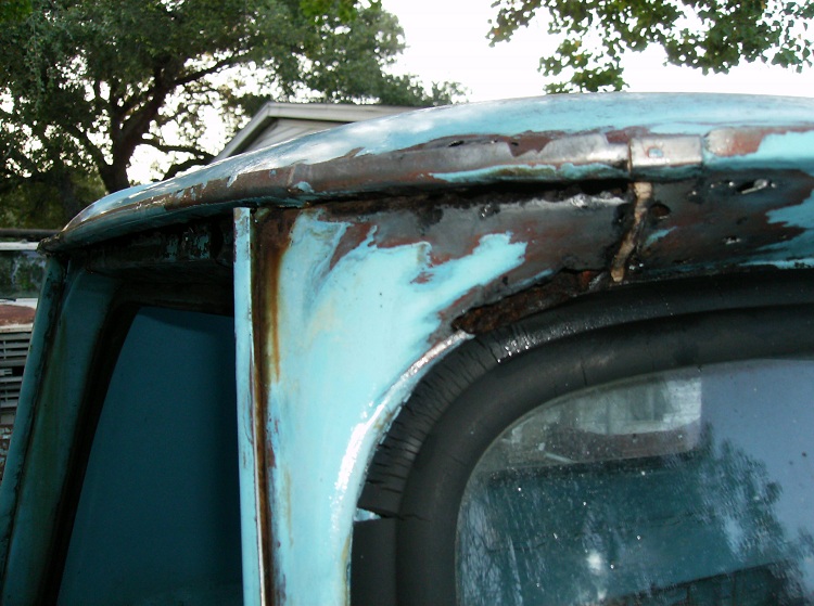

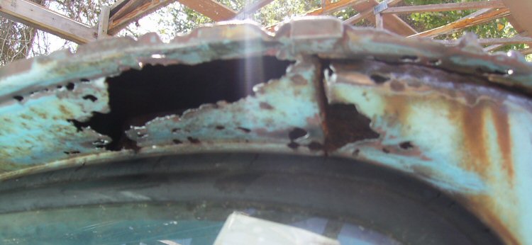

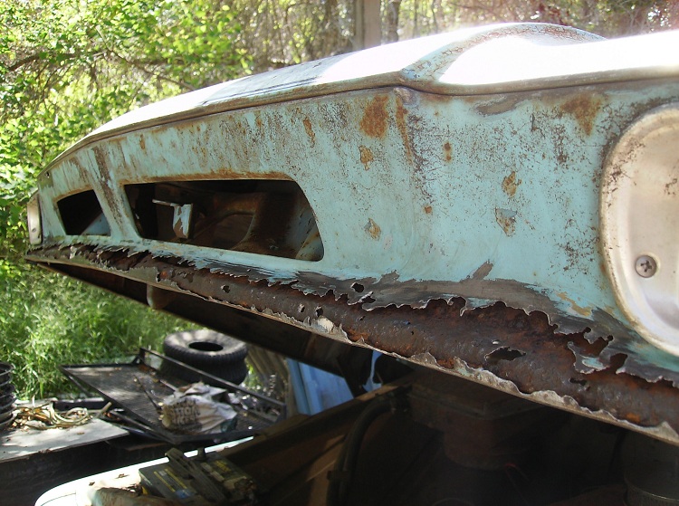

    I finally got some time to tinker with my C10 this weekend. Found lots of rust & discovered the fuel tank is garbage.

    I've never seen rust behind the door on the B pillar before. You've got your hands full. But it can be done. Best wishes!

    Yea, the rust there is really odd to me, too. There's some on the passenger side as well, but its not nearly as bad as the drivers side is.

    I'd check the sealer around the rain gutter. It might be rotting from the inside out.

    Yea, that is definately happening. I've just never seen it do that kind of damage there. As bad as the cab is, I need to invest in Bondo stock.
