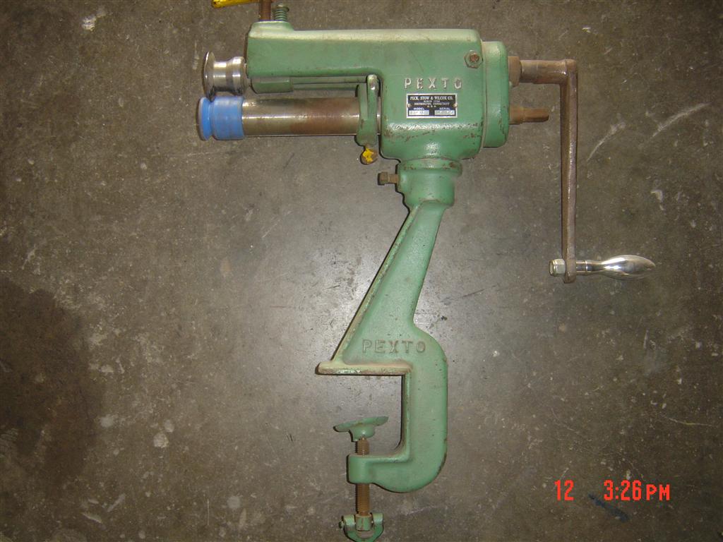

    here's mine. picked it up for a couple bucks at a sale. no real throat depth but ok for the price

    Mr chevrolet 2 beads at once and they are even you scored ! !

    Is that an old Pexto?

    The rolls are about 3" in diameter....make a 1/2" bead.

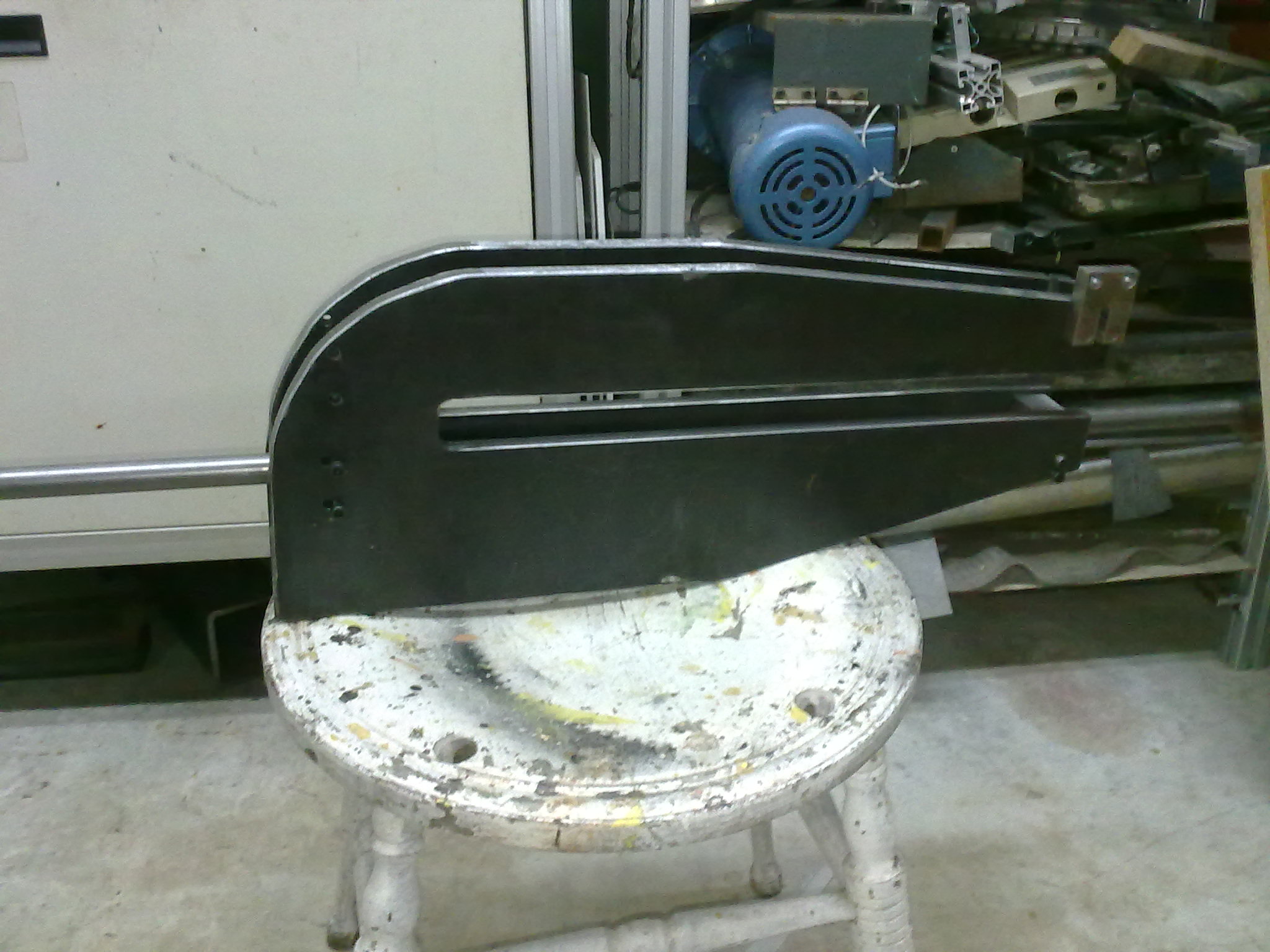

    Some pics of the advance in my Bead Roller build<input id="gwProxy" type="hidden"><!--Session data--><input jscode="leoInternalChangeDone()" onclick="if(typeof(jsCall)=='function'){jsCall();}else{setTimeout('jsCall()',500);}" id="jsProxy" type="hidden">

    A lot of thinking went into that one. Wonder how it would work for louvers, ever tried it?

    Sure, we can make louver dies no problem.

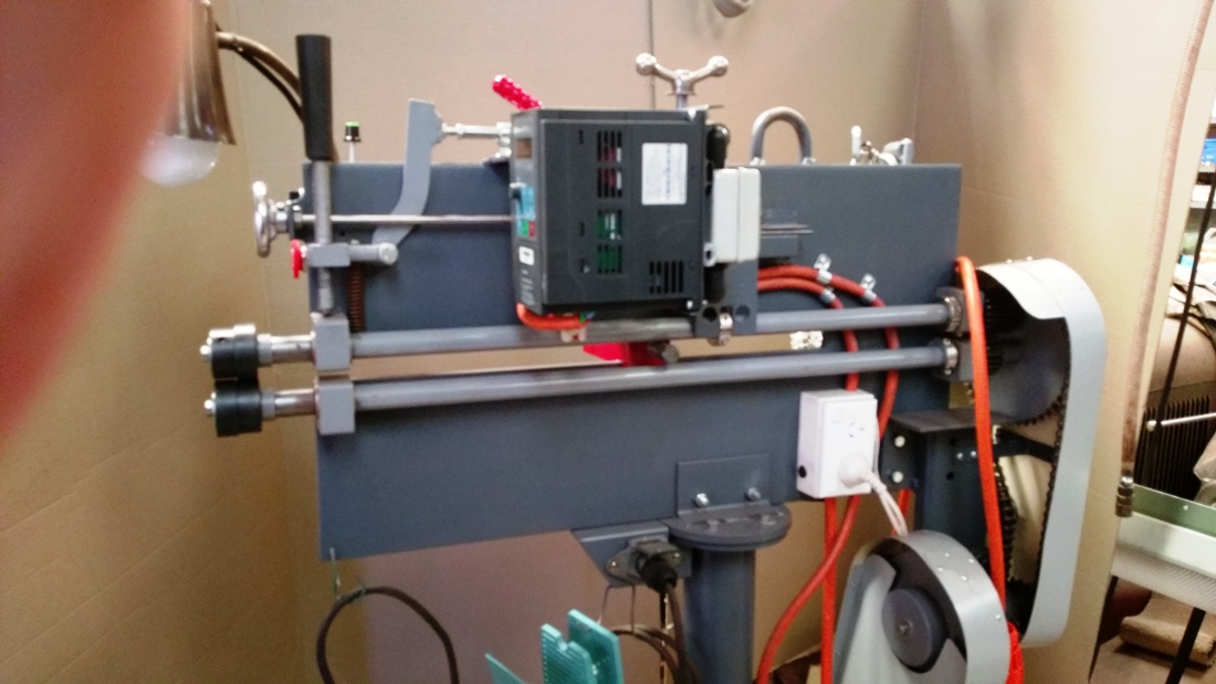

    Made mine out of s**** and added a VFD controller.
    Kept it traditional by using a Ford diff flange as part of my base.
    Has not done a lot of work, but was great when I did my hood.
    This is the hood inner that I made with it.
