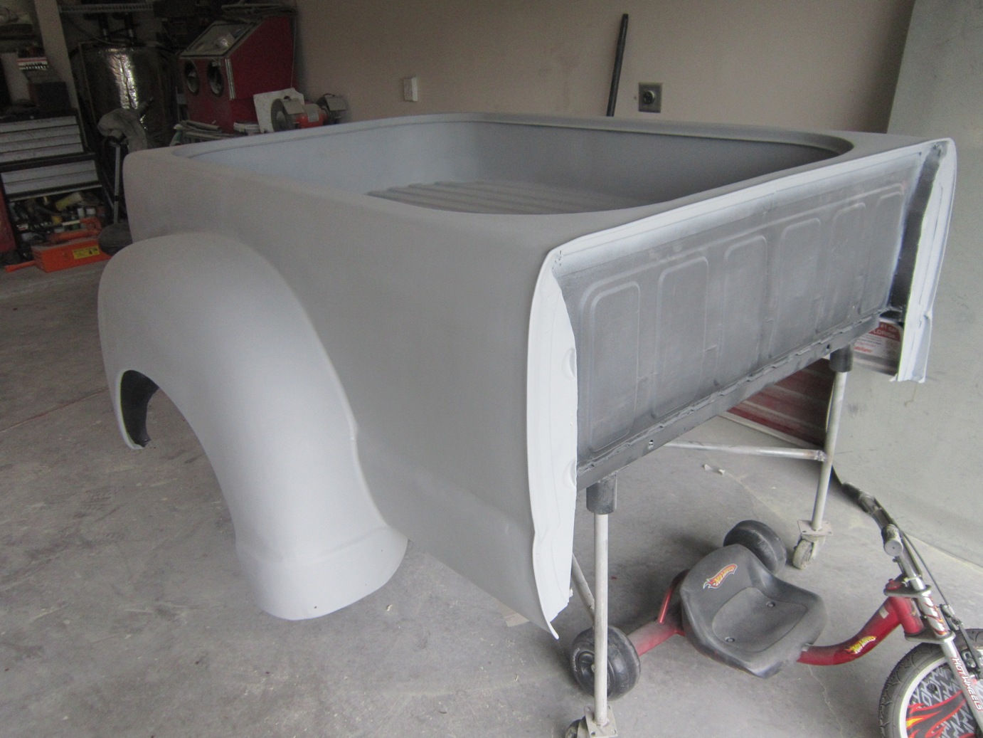

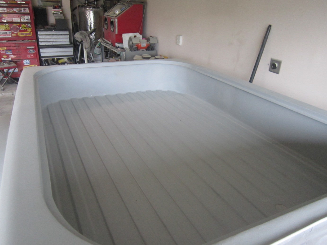

    alright, I've been a bit remiss at providing updates for the project, I HAVE been working on it, quite a bit actually but have been even more laxidazical about photographing things....time wise I've been eaten up with the balance of work, family and getting a good amount of work done on the truck....I'm sure you all can relate.
    That said, I Finally have the bed ready to block sand and will not be doing any more fab work to it. Though you cannot see it I shot sound deadener on the underside of the bead and then topcoated it with black... which involved a whole lot more than just that....grinding, smothing, epoxy primer, metal banging etc.....
    As a "oh by the way" I also fabricated and reversed the bodyline on the bed to resemble more closly the beltline of the cab....I really should have taken pictures of that as A) it was really hard, and B) I'm wiked proud of it and it looks awesome.
    Moving to what you can see I finished all the of the metal work in the bed and then got it into primer.....there is alot more work that went on there but non-the-less you can see the finished product.

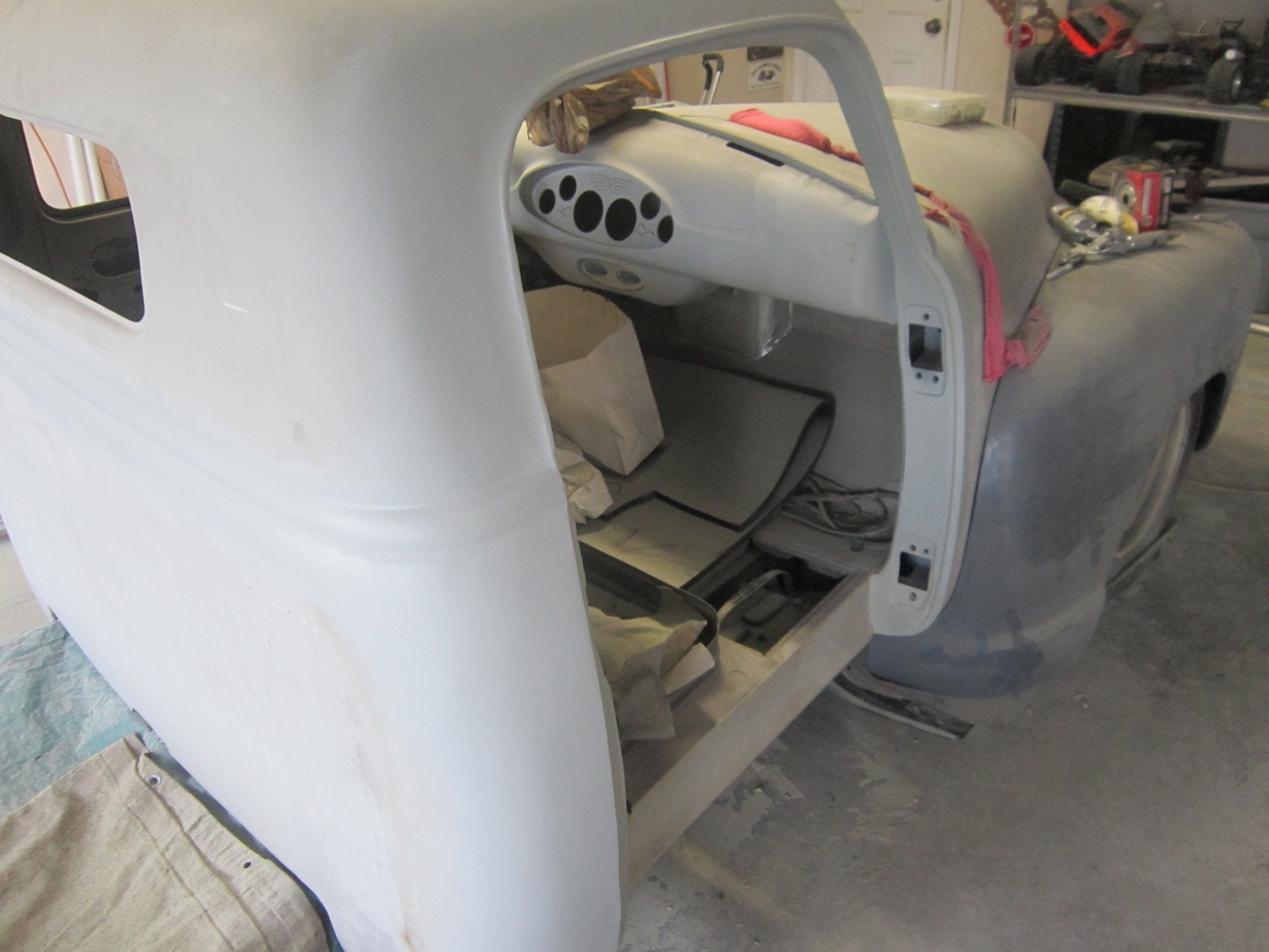

    Then I started to fine tune the doors and set the gaps....the first order of business was to square up the cab opening and smooth the inner door jamb which you can see here, (about 16 hours for the passenger side, I havent even started the drivers side.) This involved a porta power to open up a few spots that shrunk/moved when the truck was welded after being sectioned; a little slice and dice and re-welding for body lines that needed to be brought out (or conversly sucked in) to true things up; some metal rod to fill in the hammered shit rain gutters and a whole lot more welding, banging and cussing....then a skim of filler and primer.
    Then the task comes to fine tune the door to the cab....I just started that as you can see and haven't gotten a whole lot done.
    On the top part of the the door (nearest the B pillar and the top window) I had to take a bit of the door out....that of course opens up the door skin crimp so you have to take out twice as much as you want, then re-weld it and shape. the bottom of the door I had to add some steel.....too much to justify building it up with weld so I fabbed a chunk of steel up to the appropriate curvature and welded that in though I still have not finished it off as of yet....I still have about 8 hours of work on the passenger door to get it finished off then will move to the drivers door.
    Writing it out in words it does not seem like I got much accomplished, however as the guy doing it I can tell you there was alot more to it than I am articulate in the written word.

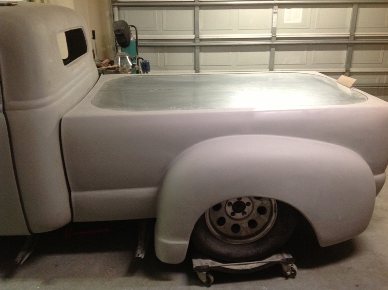

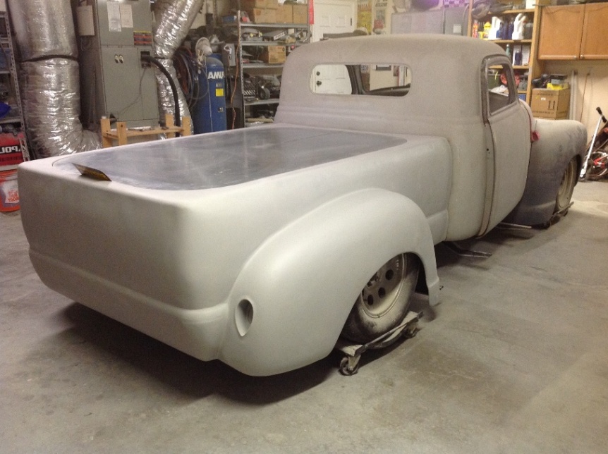

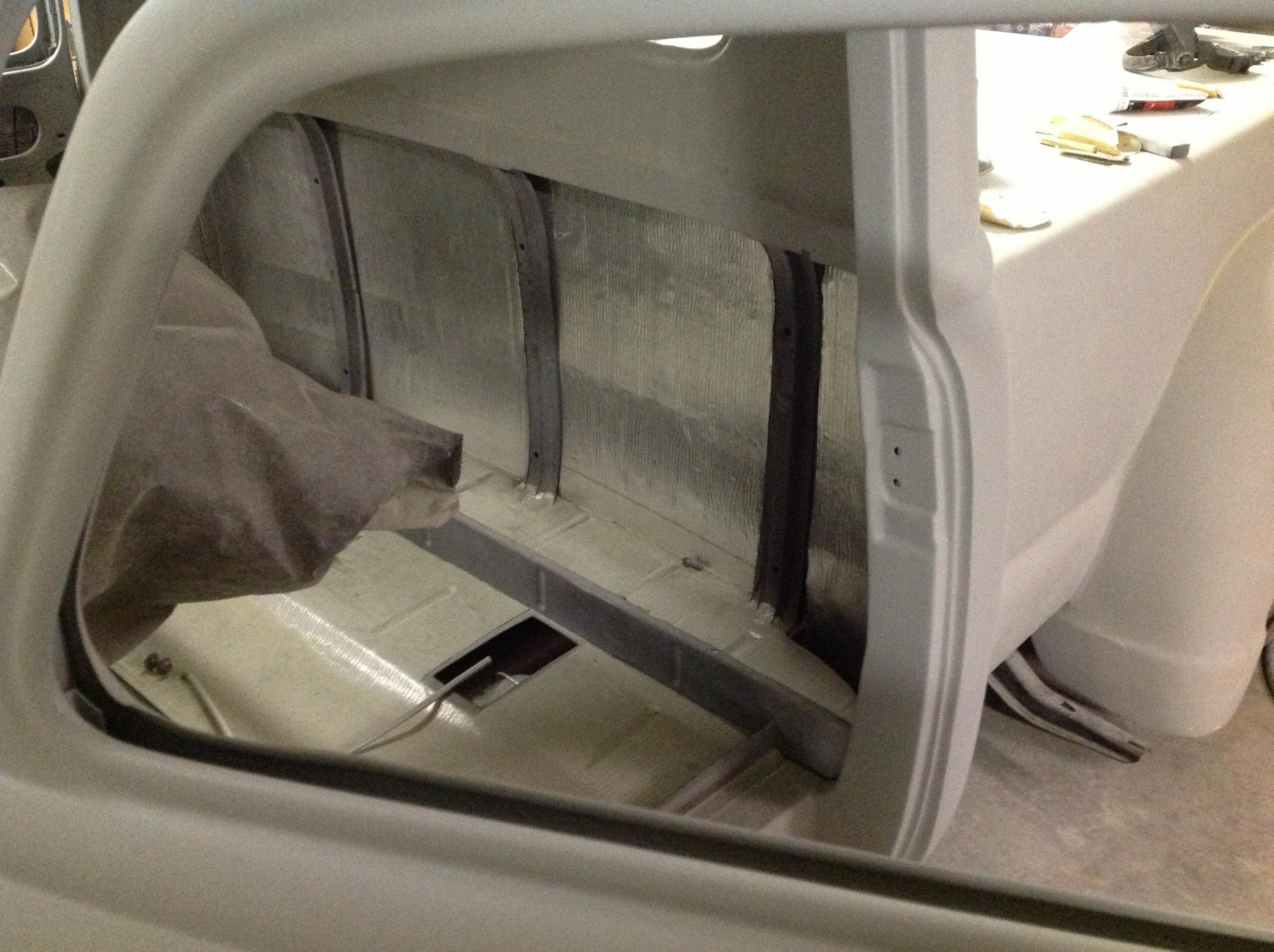

    I havent had time to do much to the truck BUT I have never seen the semi finished bed on the truck with the tonnoe cover on it....seeing as I'm getting ready to start the block sanding process (as soon as I finish gapping the other door) and I needed some garage space I figured I'd slap the bed and tonnoe cover on the truck and make it a bit easier to get around.
    Bottom line....I love the hell out of it.....the lines between the cab and the bed are corrected with the filler peice I put in the bottom of the bed.
    As the photos show there is a bit wider gap than normal as the bed is just sitting on the frame (unbolted) I've sense squared it up and bolted it downa dn the gap between the two is alot tighter but still elaves enough room for the flex space between the two body modules.
    OH and a by product of all that work was that the bed gained some weight....that bed used to be wicked light.....now it's a bit hefty (which is fine with me as it was always too squirly back there anyway.)
    here it is.....

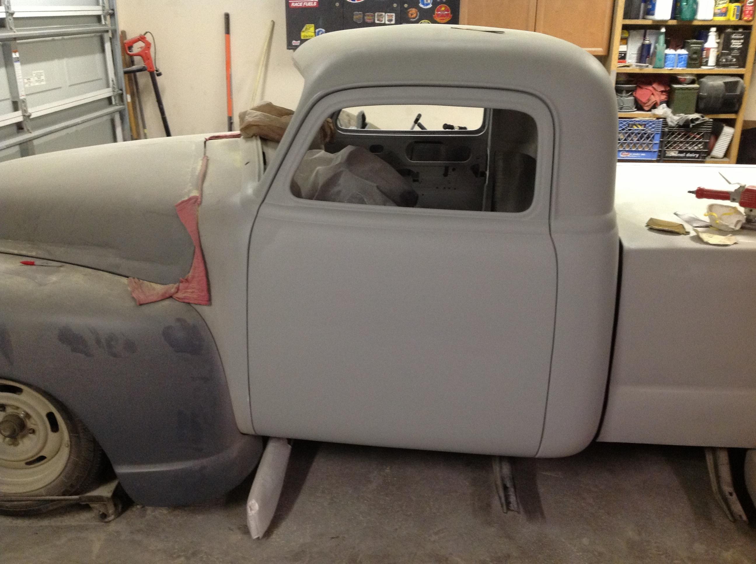

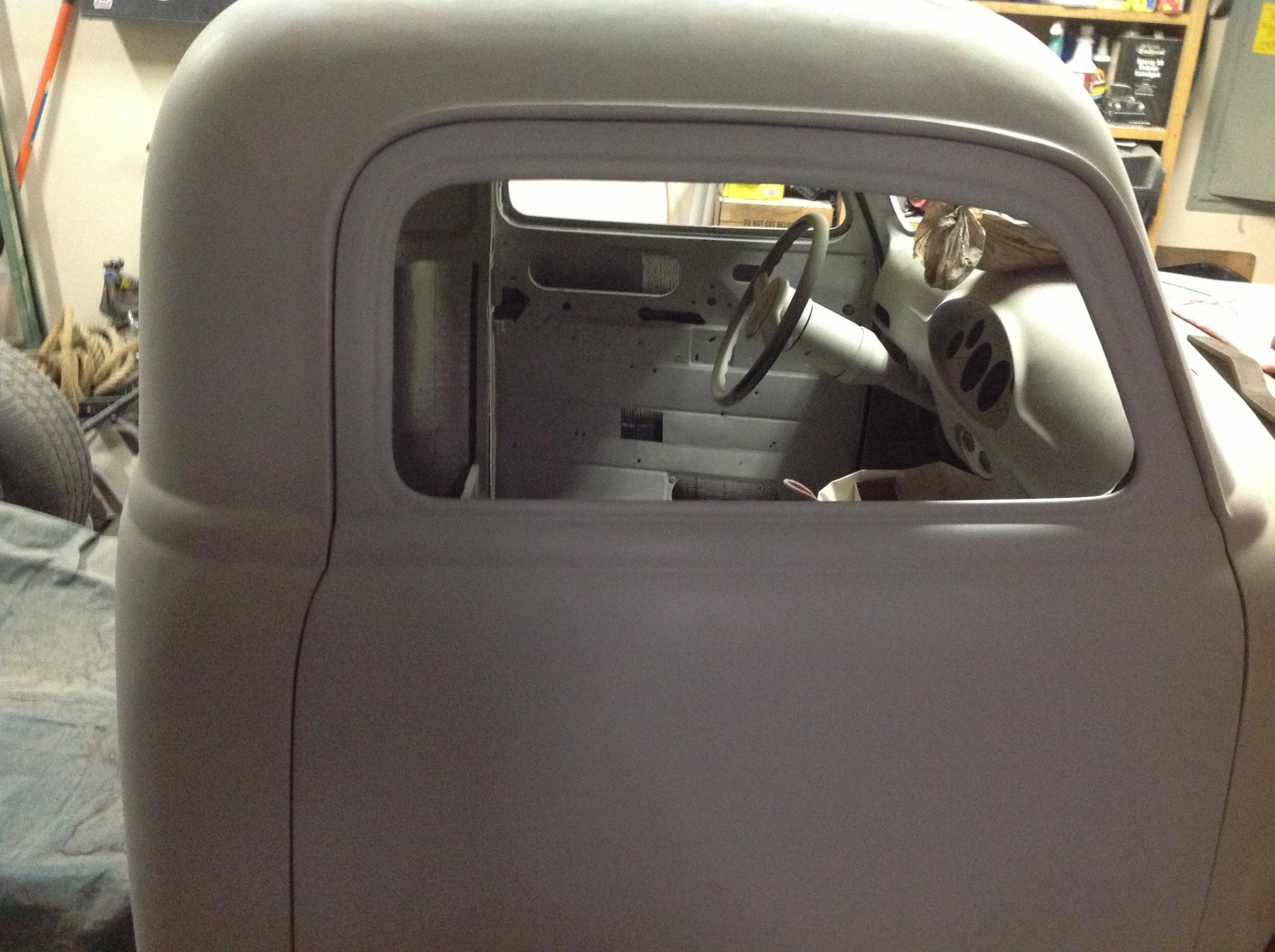

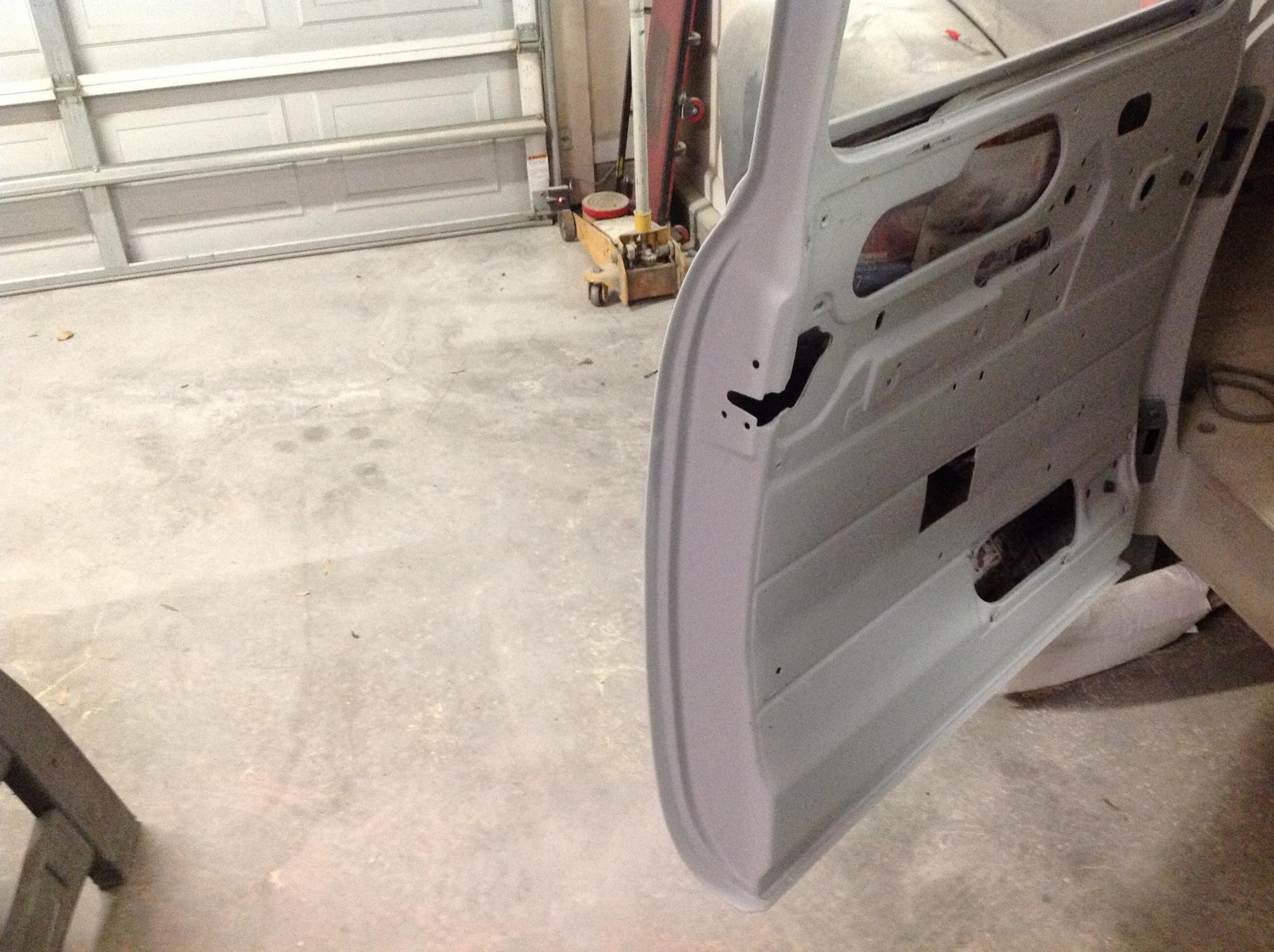

    Then I moved to the door.....I thought the driver door would be a lot simpler....as with anything on this truck I was sadly mistaken and where I thought it be straight forward as it was (seemingly) much better shape than the passenger door.....I was wrong, as I set the door up, every time I would set a gap and reset the door; everything would change and I would either have to add or delete metal from the edges.....this went on for too long till I finally I got it pretty close....smoothed everything out on the inside of the door frame.....it ain't perfect, BUT when I do all of my blocking the small inconsistencies will end up getting fixed by default....at this point I'm in it for about 24 hours just in the drivers door.

    Now it's off to fitting and gaping the front clip to the hood, that should actually be pretty straight forward seeing as when I had to cut the hood up and section it I set the hood up gapped to the fenders with welded spacers...we will see what actually happens....
