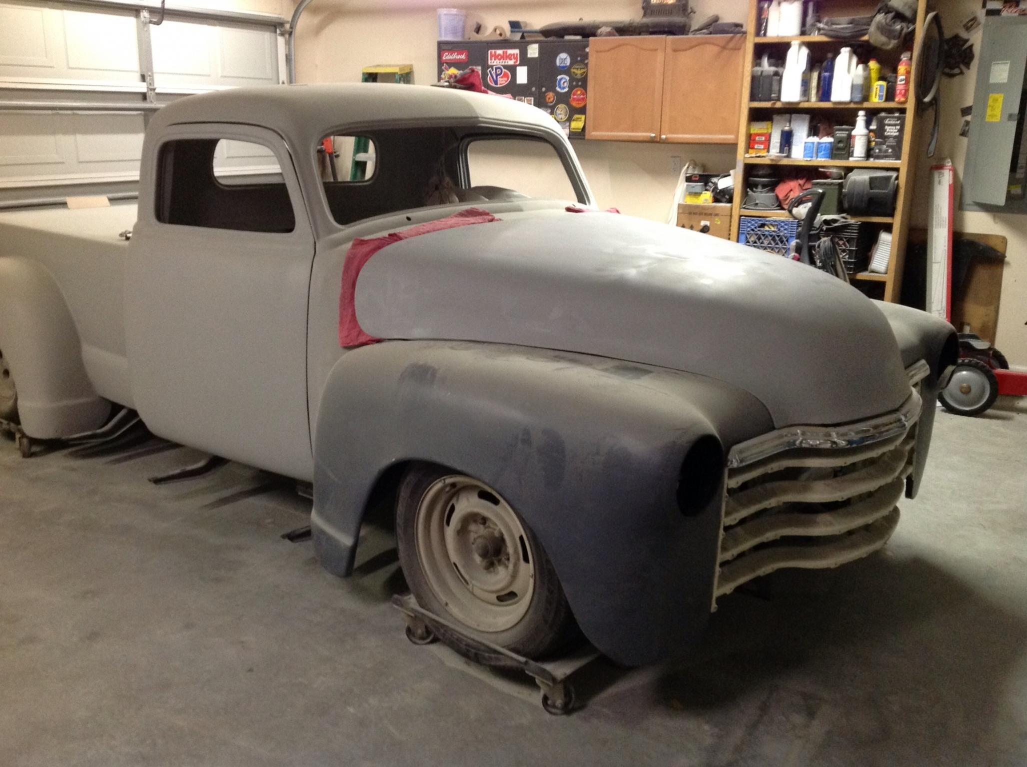

    Front clip fit and finish begins....the start of bolting the front clip in the way it will be in its final form to set the gaps on the hood to the fenders and the grill.
    Here goes nothin eh?

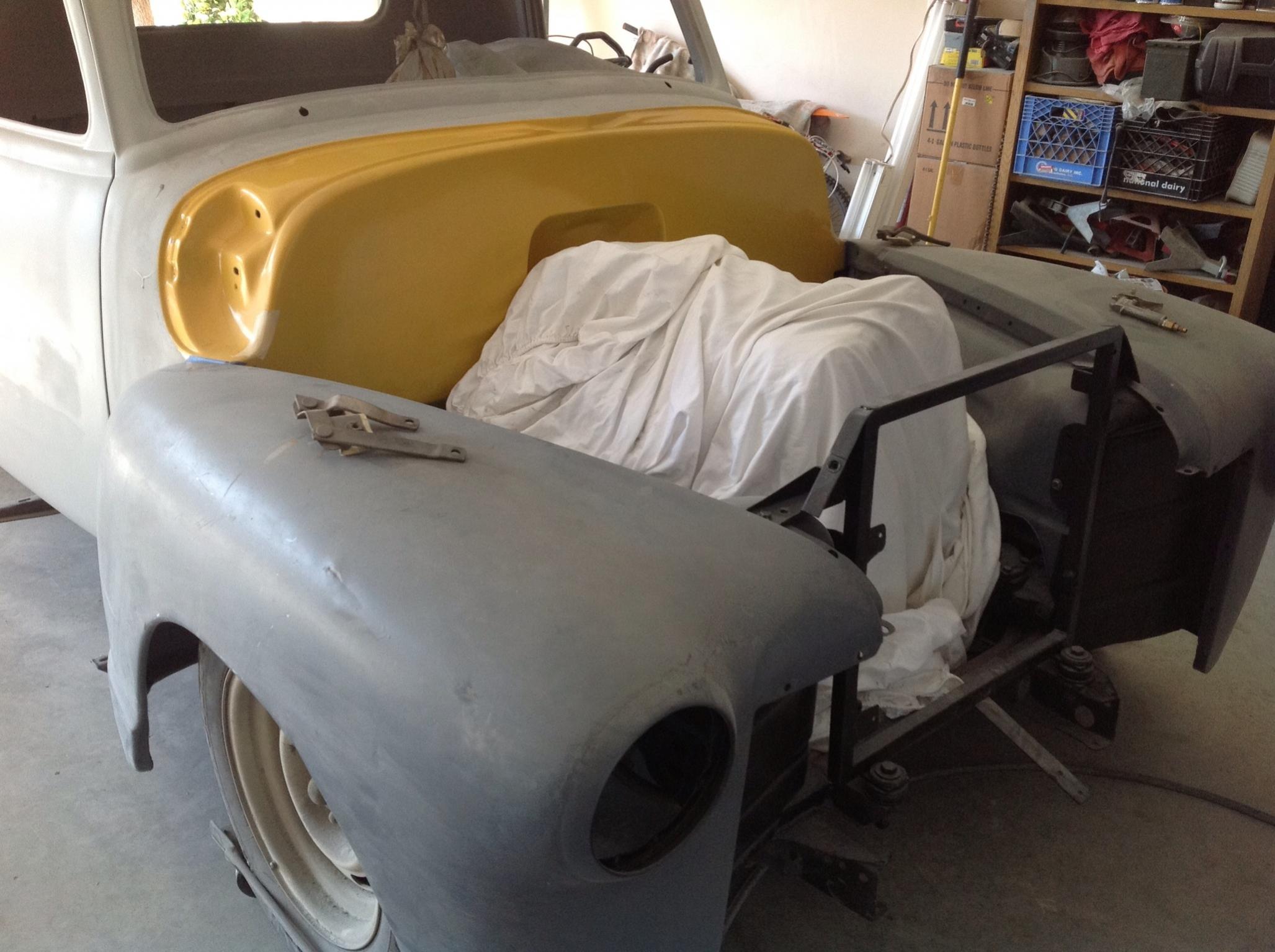

    Bear with me as it seems my iPad only wants to load one pic per post....

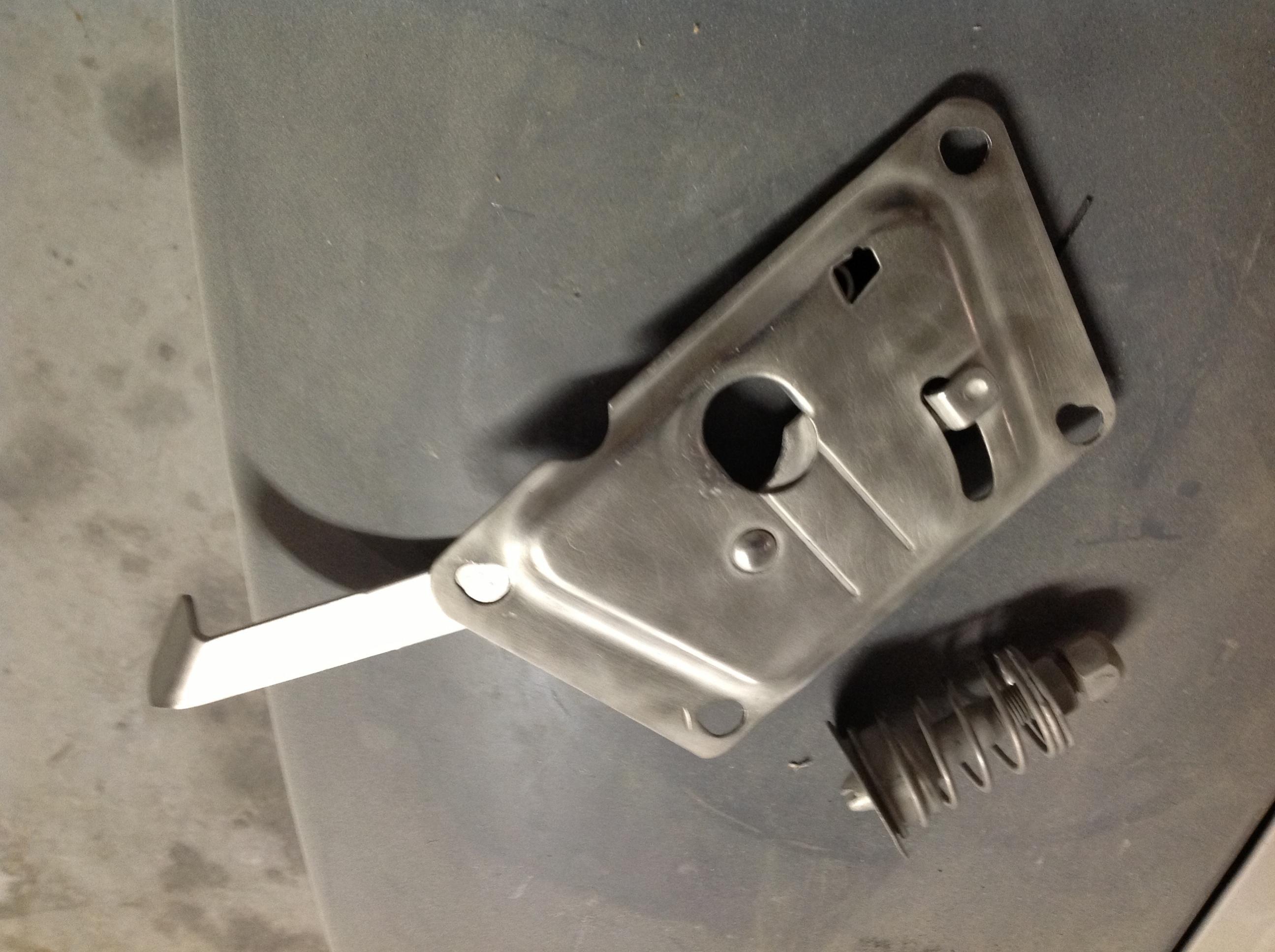

    This photo was is a result of an experiment...see I was trying to figure out what to do about the hood striker/spring ***embly as well as the hood latch mechanism...if I repainted them as it was done in the past, due to high use of the area as well as the metal to metal contact full time it would look like **** in short order....seeing as no one makes a stainless steel version, nor could I afford it if they did I did what I believe....is the next best thing (with out the trip to the chrome shop).
    I blew apart the ***emblies, sandblasted then, hit em with some sandpaper and nickel plated them in my little home nickel plate kit....they are not done seeing as I obviously did not go small enough on the grit and you can see scratches through the nickel....that said I learned a little something and will knock it down with a finer grit and re-coat them at a later date...
    Bottom line, after a few opening and closing a of the hood I believe it will hold up and look good doing it for a lot longer than paint.

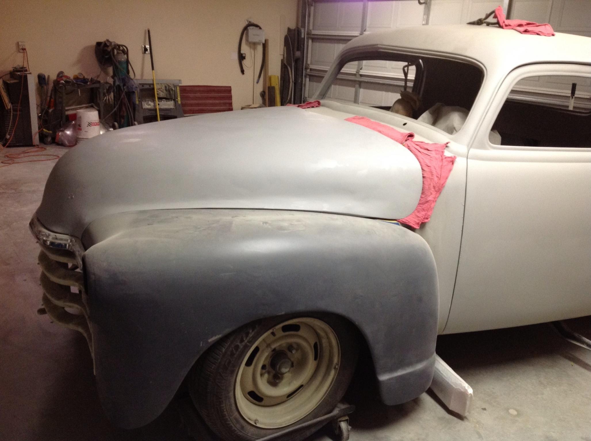

    It's is the a result of the metal finishing and skim coat of mud and subsequent primer after truing up the gaps.....did I mention gap fitment is a pain in the ***? (Don't fret....the hood is sitting there not hooked on to the truck with a layer of rags between the hood and cowl...therefore some of the gaps appear a smidge off....but they are not when everything is where it should be)

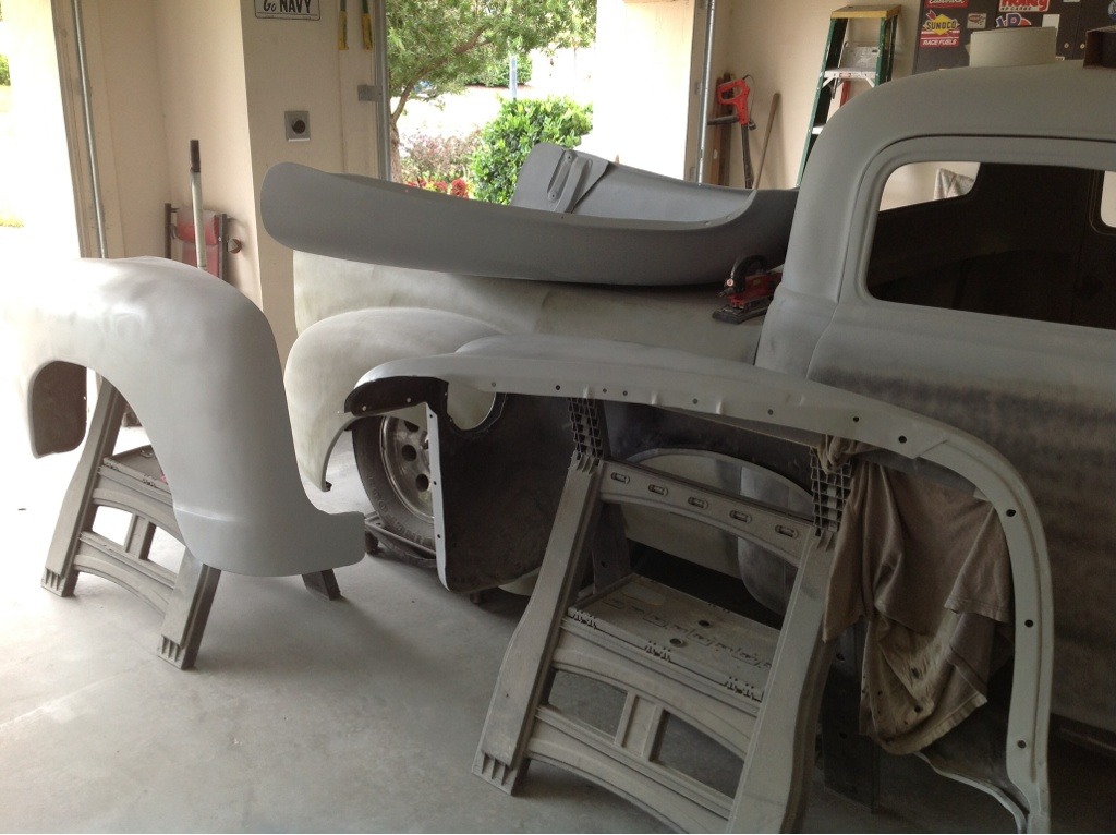

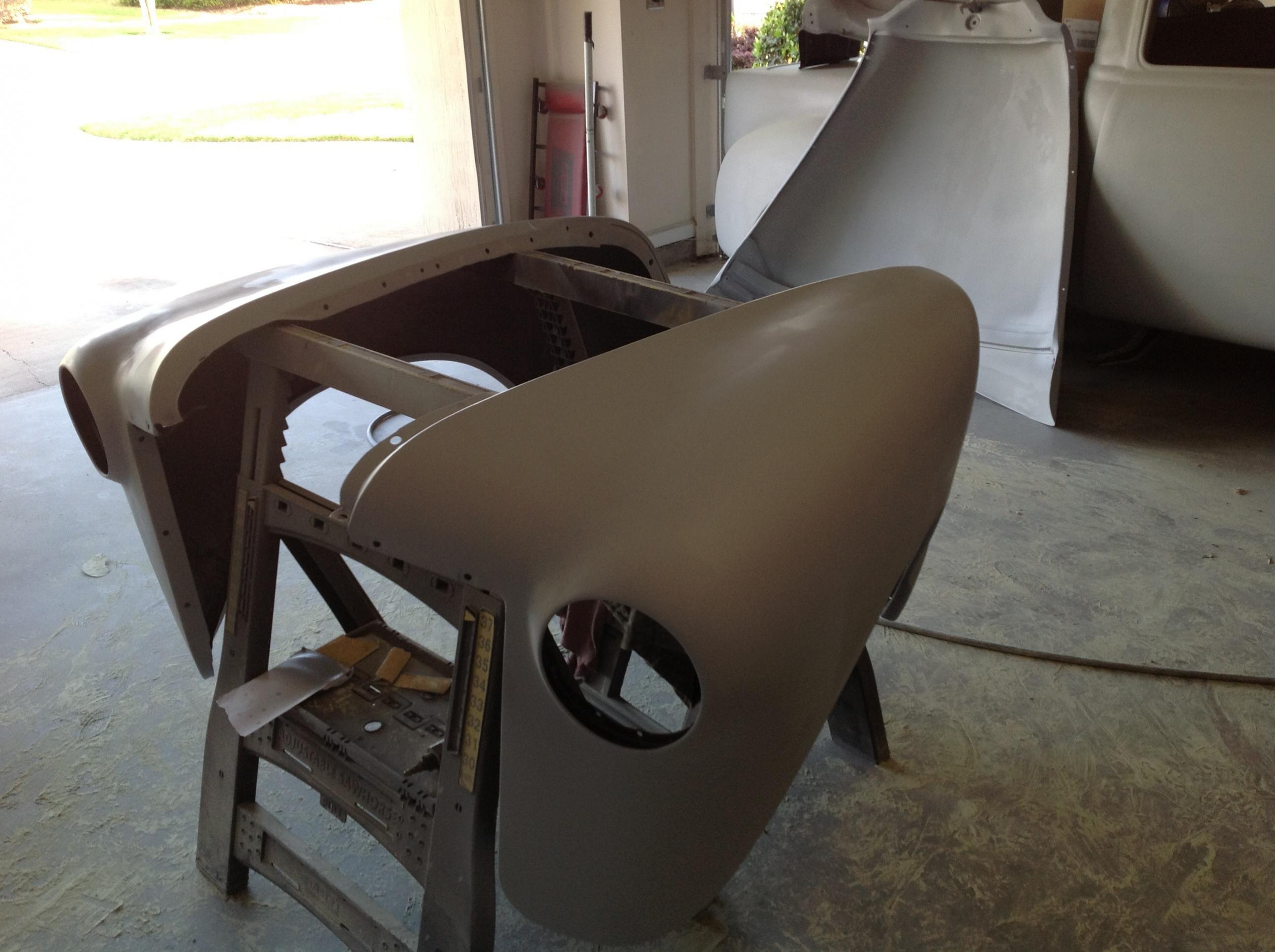

    It's been wicked busy and I haven't gotten a lot done....I just got the front fenders and radiator shroud in primer...
    Hopefully I can pick up the pace here after this month p***es

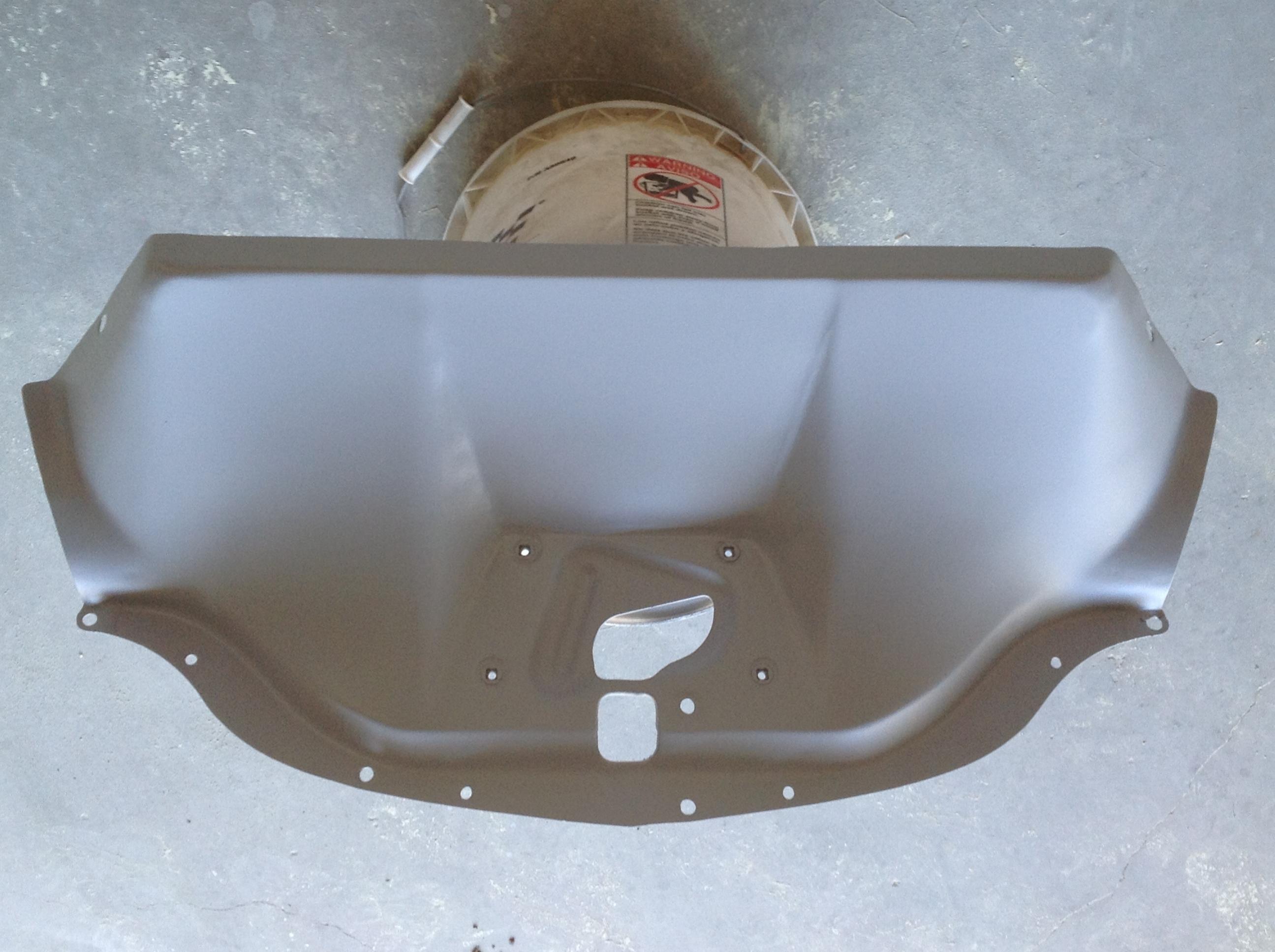

    Now I get to gap the tonnoe cover and put it in primer....
    Radiator shroud....

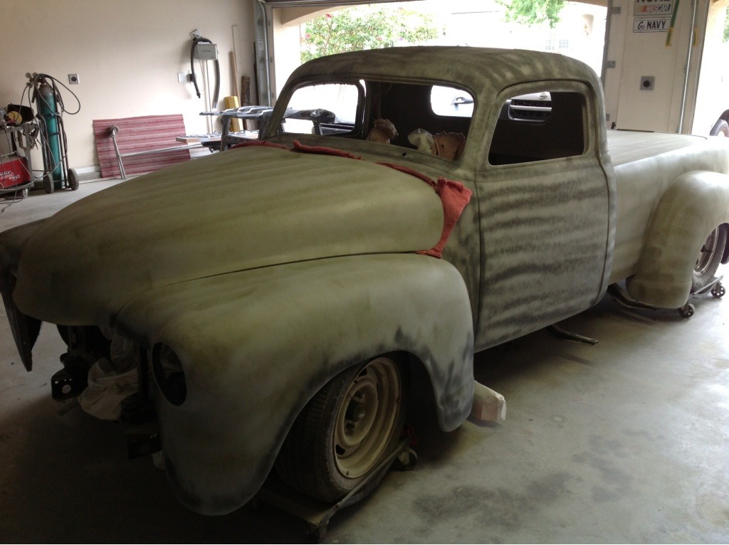

    Alright....I know I haven't updated in awhile....but officially the entire truck is in its first coat of primer, guide coat went on today.
    As you can see I ran out of black guide and found a bottle of olive....not that it matters as it will be sanded off...
    So here's to no fingerprints and sore ***ed shoulders....

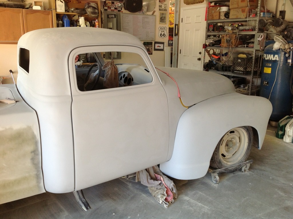

    97 hours of work...tailgate and driver bed side done....at this point the whole body is sanded once....three more to go.

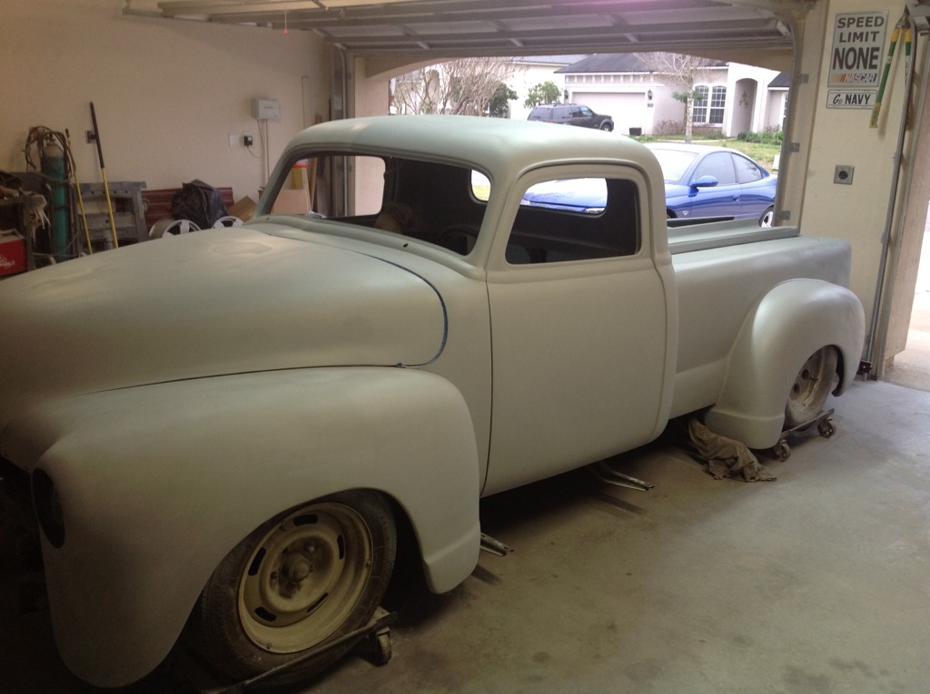

    105 hours in. Running boards completed which makes the first of four sandings complete...now to start over at square 1...the roof....I do like how well the second sand has started....150ish hours to go!

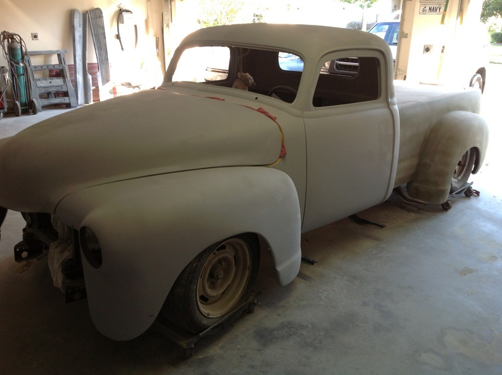

    Second sanding complete, truck re-primed....137 hours in...
