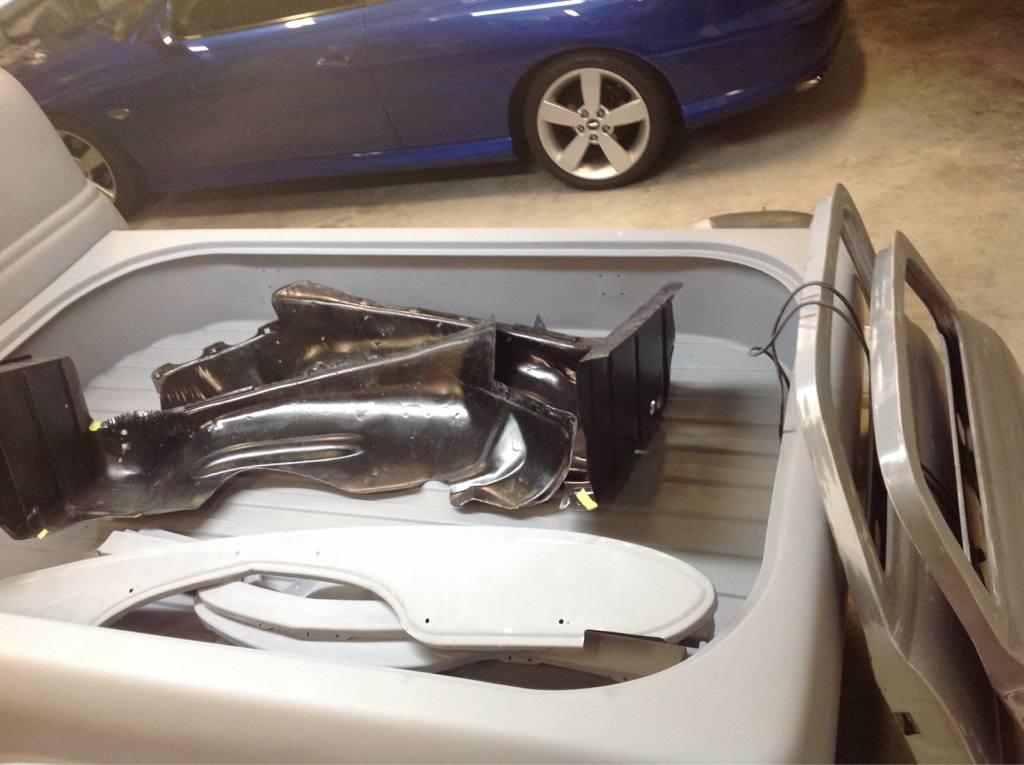

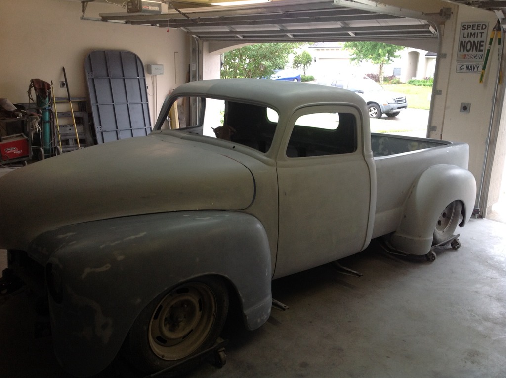

    ImageUploadedByH.A.M.B.1396034728.228200.jpg ImageUploadedByH.A.M.B.1396034738.951011.jpg

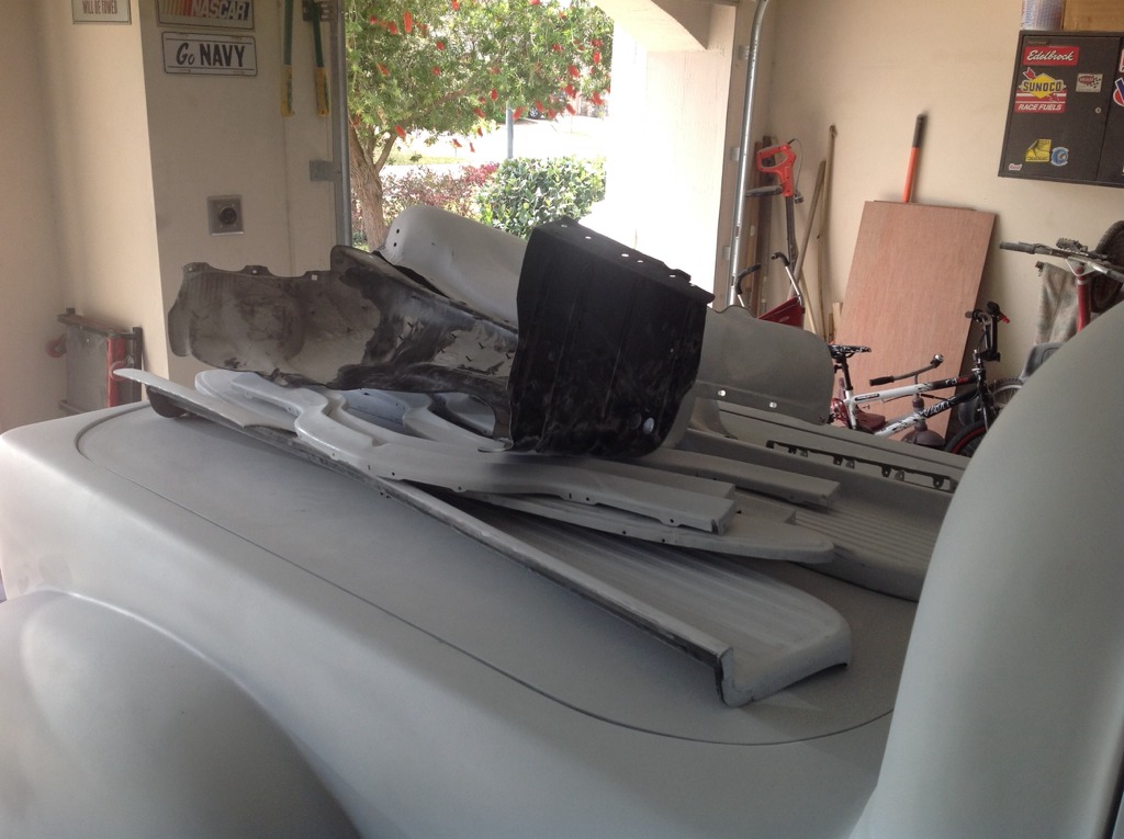

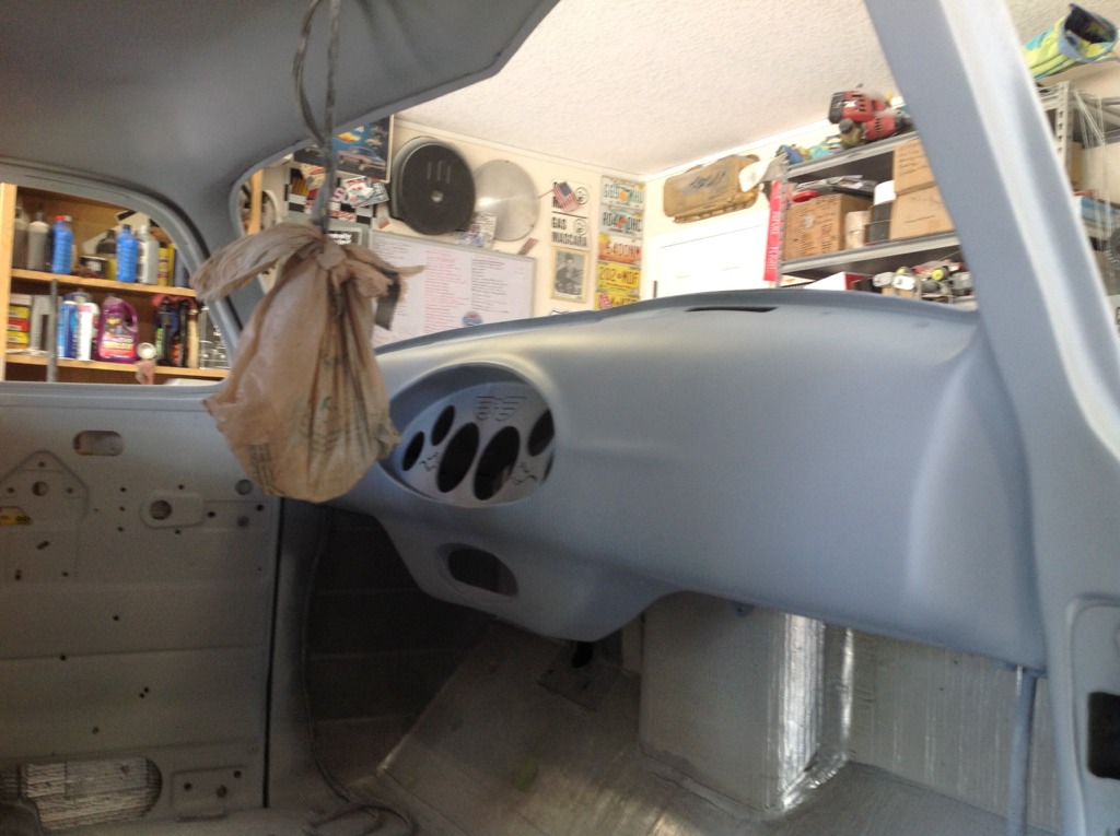

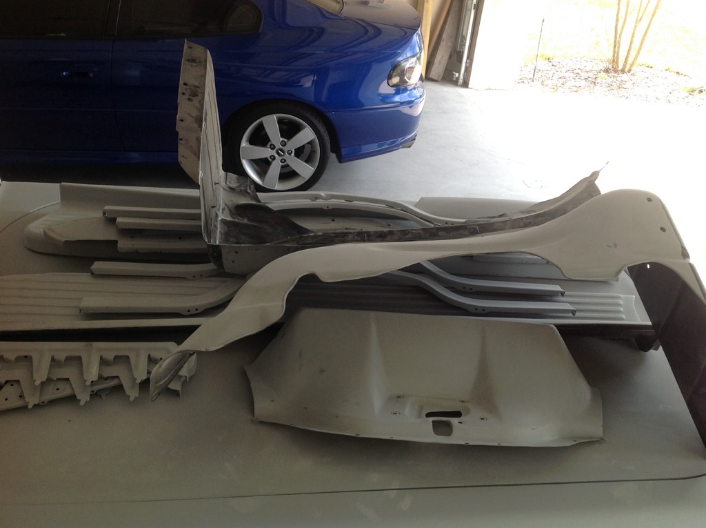

    About 15 ish hours hand sanding a bunch of small parts, grill spears (5) and corresponding pile of grill parts (4), splash apron, radiator moulding, running boards (2) and both inner fenders.
    Total sanding time 150 hours of mind numbing tedious dirty shiet work...I hurt....a lot.
    At least when you sand the body it seems like you make progress...now that all the small parts are done (these are luckily ready for their last thin coat of low build primer and then finish paint) I am officially done with the second sand....
    Now that all of the parts are out of the cab I'm going to sand the dash and custom made fibergl*** hard headliner as well as the inside of the bed...
    EDIT***erridently I haven't looked at the thread in awhile....so those that responded! THANKS! and to answer: James D, the color(s) are a waterborne base; Tequila Yellow bottom (with a light pearl added) and Candy Orange top (with a moderate sized metal flake AND a bit more pearl)...wheels and tires I haven't nailed down yet....I am leaning towards either a Radir tri-rib, or full chrome steelies with spider caps...(I posted examples of the colors a few pages back tho computer screen colors don't do it justice)
    I Smell Smoke: if you ever want to hate yourself....hit me up you can come soak up some of my OCD body working pain....

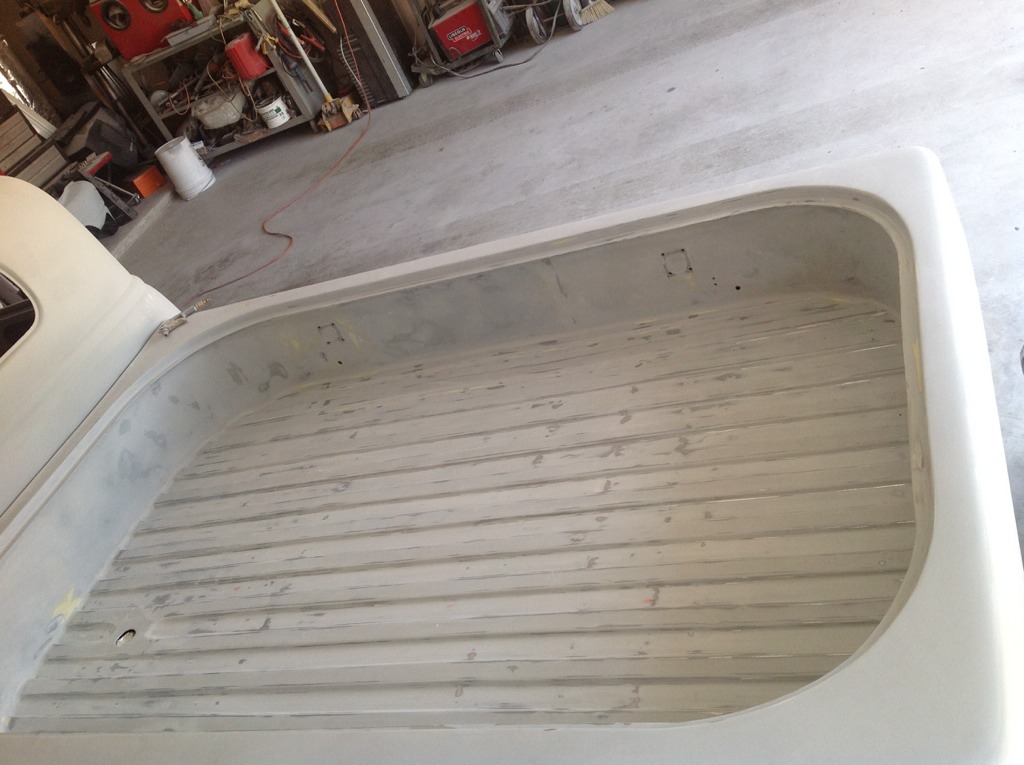

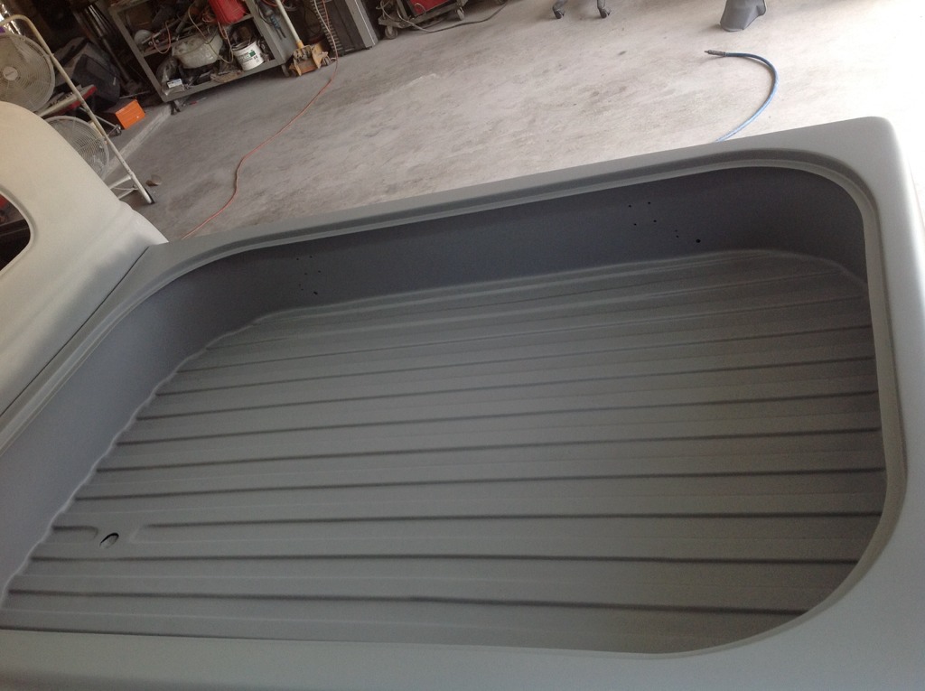

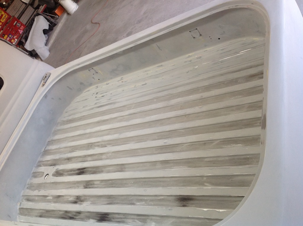

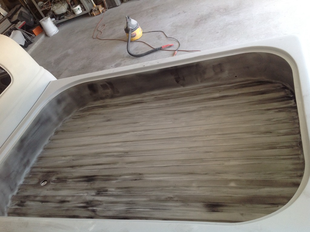

    ImageUploadedByH.A.M.B.1396639429.193315.jpg ImageUploadedByH.A.M.B.1396639452.841303.jpg ImageUploadedByH.A.M.B.1396639481.396898.jpg
    ImageUploadedByH.A.M.B.1396639492.808600.jpg ImageUploadedByH.A.M.B.1396639529.897979.jpg ImageUploadedByH.A.M.B.1396639540.196417.jpg

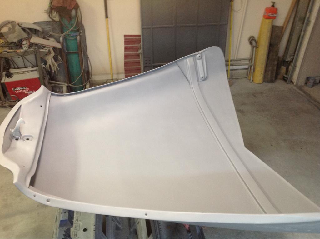

    Welcome to my hell, here is the process: top to bottom....
    1) what you start with
    2) apply a black powder guide coat (yes I could use an aerosol guide coat but it's expensive and you need a lot of it...therefore I use a canned powder guide coat, lots cheaper and works well....the **** gets everywhere)
    3) sand all the guide coat off destroying your hands in the process
    4) hell in progress
    5) what you are left with before you reprime
    6) the results of your hard labor...
    this job took 11 hours for a total of 161 hrs.
    Corrugated steel ****s; my hands went numb, there's a nerve in my left arm running through my elbow that has decided to wage war on my brain and for no explicable reason send an electric shock through my arm at inopportune times....I hate this bed....
    Now off to the inner roof and the dash...

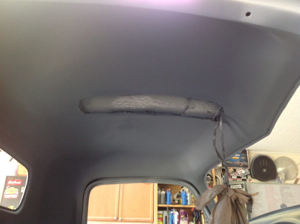

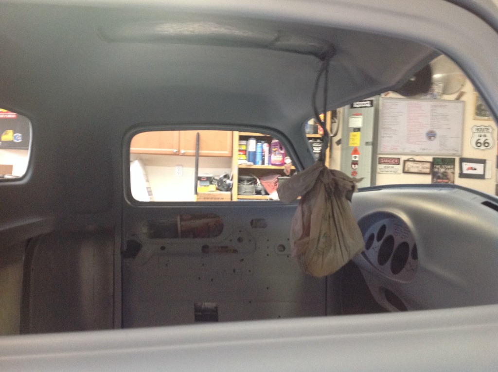

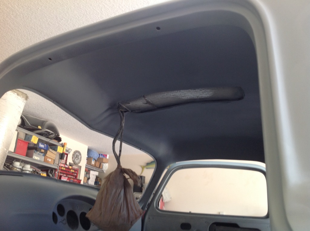

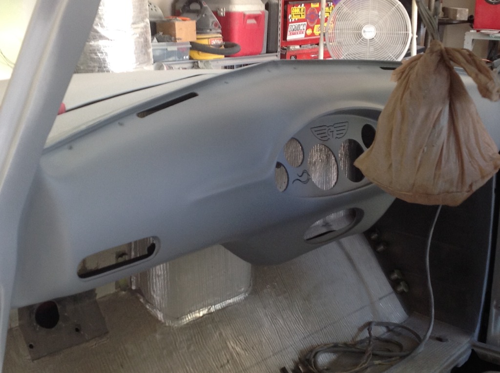

    I have spent the last 12 hours sanding a roof over my head...whatever I was imbibing on when I decided to make a custom fibergl*** hard headliner must have been wicked good...12 hours with a 6lb sander over your head is a long time...The dash is looking super sweet...front fenders resanded and reprimed...
    172 hours in.
  12. '51 Norm
    Joined: Dec 6, 2010
    Posts: 872
    '51 Norm
    from colorado
    The dash and headliner look great! It is nice when someone takes the time to design and build something that not only is different but really works.

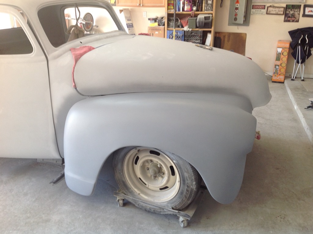

    Aight, block sanding log fourteen-teen and two thirds...
    In the last 15 hours (nearly straight) I have sanded the entire truck for the third time, all body panels, bed, doors, hood, cab, inner bed, dash and custom hard headliner (I will never do that again)....
    Now time to re-spray the entire effing truck...
    The results of my labors.....(AKA more freakin work...)
    ImageUploadedByH.A.M.B.1399068880.508317.jpg ImageUploadedByH.A.M.B.1399068892.132692.jpg ImageUploadedByH.A.M.B.1399068910.459452.jpg
    195 hours into sanding, my shoulders have revolted, fingers....they might be still there...I don't know, I can't feel them, wrists...who knew they could feel as badly as they do....I would switch hands for a few days but both have failed me...time for a Dr. Pepper...if I could only manipulate my fingers into pouring the beverage...
    In theory I only have one sanding left...and for the most part I believe that to be true, there is a few problem areas that I will have to address prior to sanding the last time; nothing major and all having to do with gap fitment in the doors....the smoother it gets the more the minor flaws pop...which is the point...
    After I realized what I had gotten myself into I revised my projected time to completion to 250 hours (just for block sanding that is) if all goes well I should be right on the money time wise.

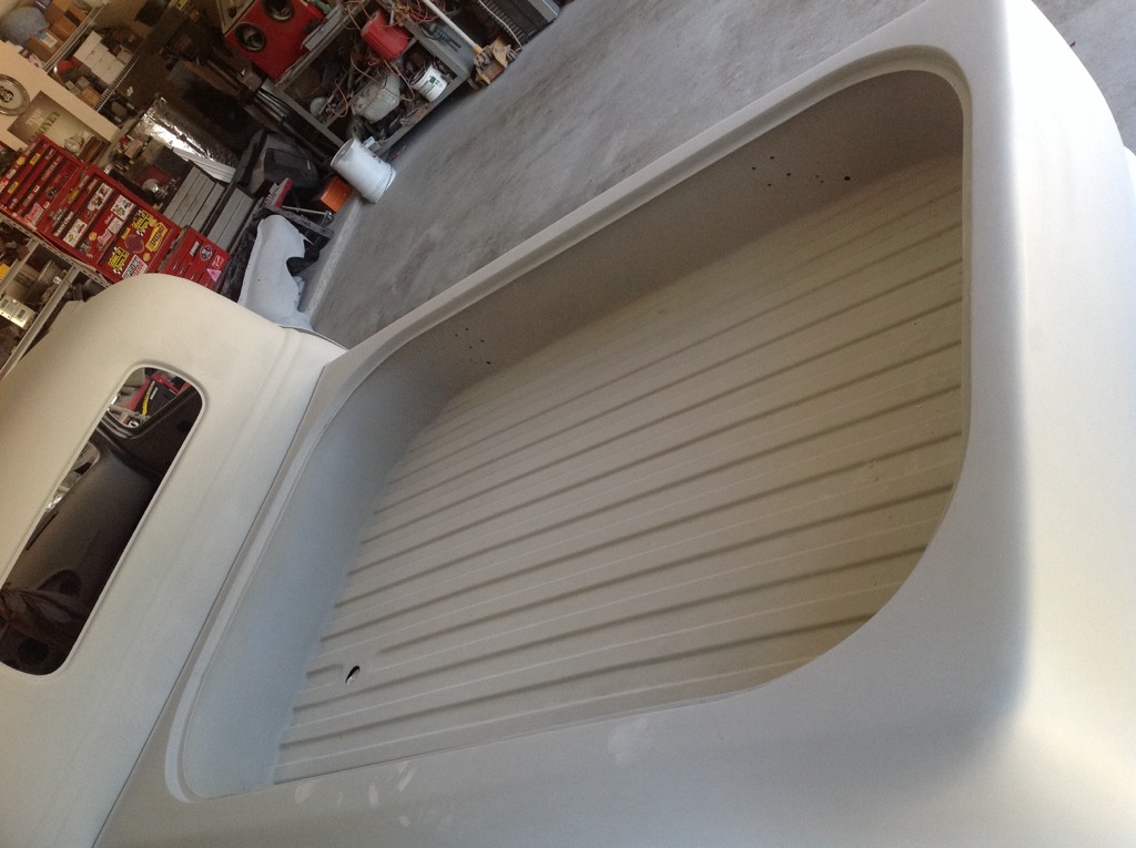

    Wet sanding officially in full swing...13 hours into pruney fingers...hood done once already and subsequently re-coated (not there yet), inner fenders, grill, radiator shroud, both fenders and both doors done and should be ready for sealer (gotta look at them in the light and make sure they make the cut...)
    cab and bed next...

    More block sanding...roof and bed again...nothing real remarkable other than a lot of dirty work....
    285 hours in...
    All needed areas have now been spot primed and one last going over with the ultra long board and one last guide coat and we should be ready for sealer....
    ImageUploadedByH.A.M.B.1409773516.591767.jpg ImageUploadedByH.A.M.B.1409773529.472799.jpg ImageUploadedByH.A.M.B.1409773544.800062.jpg

    The bed on that thing is an amazing piece of work!
